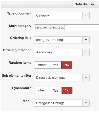

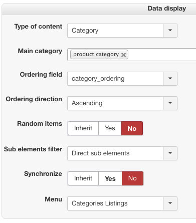

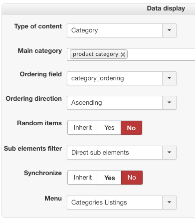

It appears if you navigate using the images, the menu displays. If you navigate using the menu, the menu doesn't appear and we get a different RURL to the view. Maybe we're talking about the same thing?
If so can you point me more specifically to that setting? I'm not finding it in the module
Under: Module/HikaShop Options/Data Display I see "Synchronize" — I have treid this in all 3 settings (Inherit, Yes, and No) and nothing happens. It was originally set to NO
Last edit: 1 year 11 months ago by dagroupinc. Reason: more info
  • Posts: 109
1 year 11 months ago #363150
Figured it out. We had a HikaShop and Module menu published. We unpublished the HikaShop ones and kept the module one.
