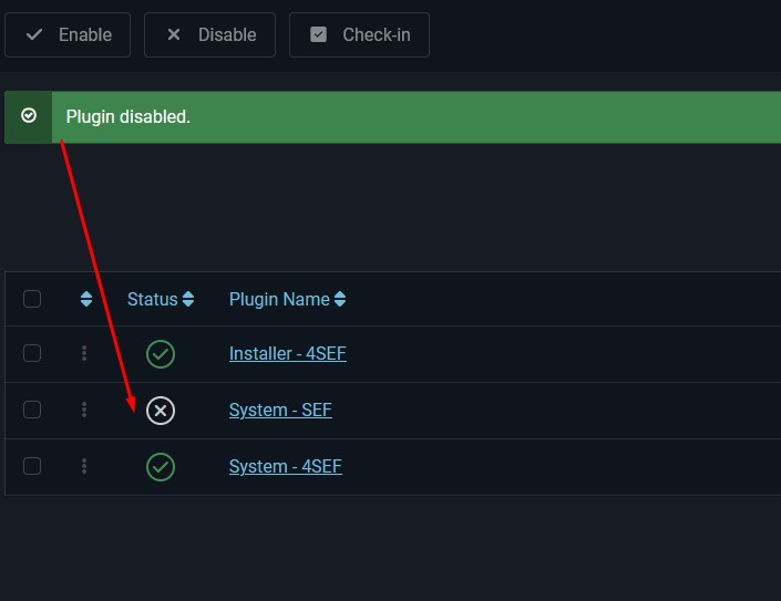

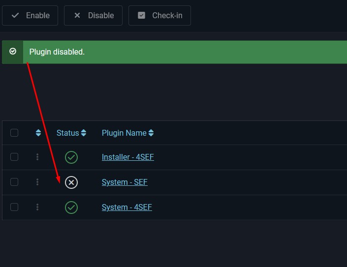

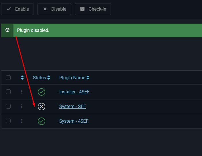

  • Posts: 39
  • Thank you received: 4
1 year 8 months ago #364866
Apologies, Joomla SEF was 'on' and should have been 'off' as 4SEF is active.
  • Posts: 86050
  • Thank you received: 14178
1 year 8 months ago #364867
Well, now the pagination works fine on your website as far as I can see.
So it seems this was the problem all along no ?
