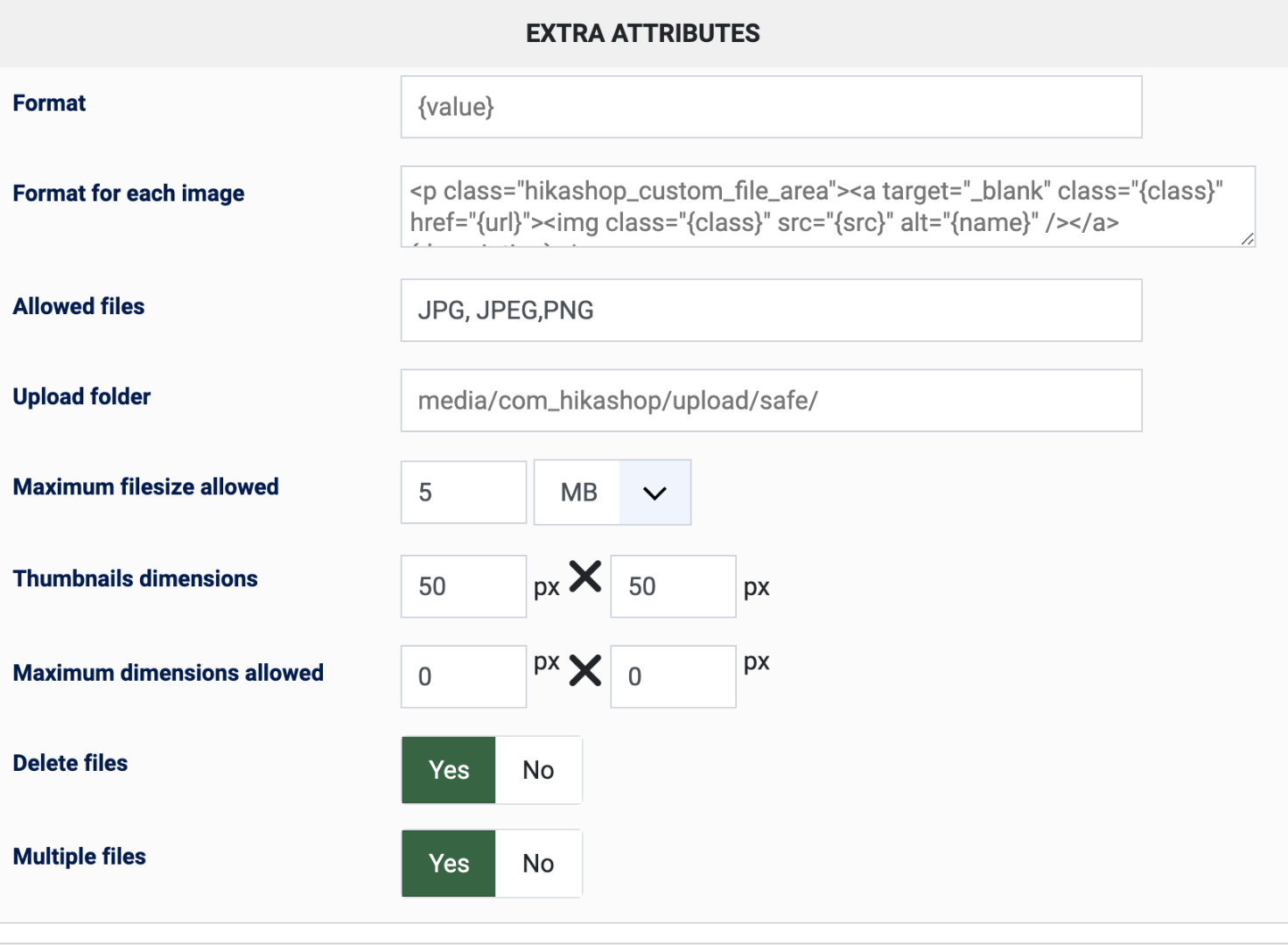

i dont see the option to delete the uploaded pic below is the URL
www.mailedbysanta.com/index.php/products...magnets-customizable
also i have attached the snapshot of settings

1 year 5 months ago #365814
I think that your problems comes from view overrides.
Can you switch temporarily to the default template of Joomla on your frontend, and try again with the default template ?
It should definitely help with seeing the delete icons. If so, it means that the issue comes from a file in the templates/YOUR_TEMPLATE/html/com_hikashop folder. Probably in the "upload" subfolder there.
So try renaming the upload subfolder to something else via FTP in order to deactivate the overrides inside it.
Also, on your link I was able to select several images and all of them were added. I was also able to select several images several times with the upload icon or drag & drop.

  • Posts: 86050
  • Thank you received: 14178
1 year 5 months ago #365882
Yes. Looking at it on your website, I think this issue comes from a view override in your template.
Because I'm not able to reproduce the issue on my local test website with the same configuration.
