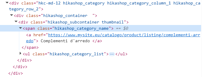

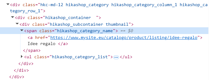

1 year 7 months ago #366194 by bellaidea
Sorry, I explained myself badly.
In my previous message "active" and "current" were adjectives, not classes names. :)
I meant that there is no distinction between a selected parent category and an unselected one, whatever the class to distinguish them. The class is always just "hikashop_category_name" (please find attached pics).
The distinction is only between selected children categories and an unselected ones.

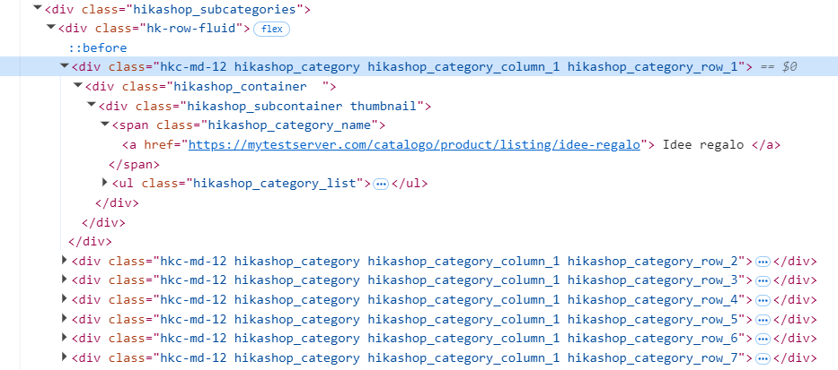

1 year 7 months ago - 1 year 7 months ago #366231 by bellaidea
there's no div with hikashop_current_parent_category class in the page, event clicking on "Idee Regalo". Where did you get it from? :)
Please, delete the picture because it contains the url of my test server.
Thanks! ;)

1 year 7 months ago - 1 year 7 months ago #366281 by bellaidea
Hi again Nicolas,
yes, I know that hikashop_current_parent_category is present in YOUR screenshot but I cannot find it in MY screenshots and in the test site I've set up for you.
That's why I asked you hou did you get that screenshot. Why my results are different?
Thanks!

1 year 7 months ago #366286 by bellaidea
Ok, I've realized that you are in the wrong category.
I was referring to MAIN categories (Idee regalo, Complementi d'arredo, etc...). :)
