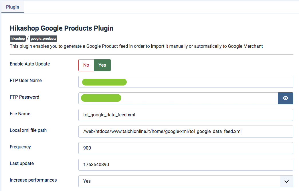

I've made a simple php file $path = getcwd(); and put it in the /google-xml/ directory and the result is here: https://www.taichionline.it/google-xml/path.php , so I've configured the plugin as attached.

The report you provided doesn't have any message from the Google Products Plugin.
This would indicate that either the frequency or the last update setting are configured in a way that skips the plugin.
Or it could be that the plugin is disabled, or its access level is not set to public.
You can temporarily lower the frequency to 1 in order to make sure that the plugin is triggered each time the cron task runs.
Then, open the cron task URL with your browser and see if you find any message relative to the plugin.
I tried it for you, but I got an error message about the articlesanywhere plugin:
i.imgur.com/dxosX1G.png
This might be linked to your problem but I would need to look at that page while the "debug" setting of the Joomla configuration page is activated to be sure. Could you try to do that on your end ?
