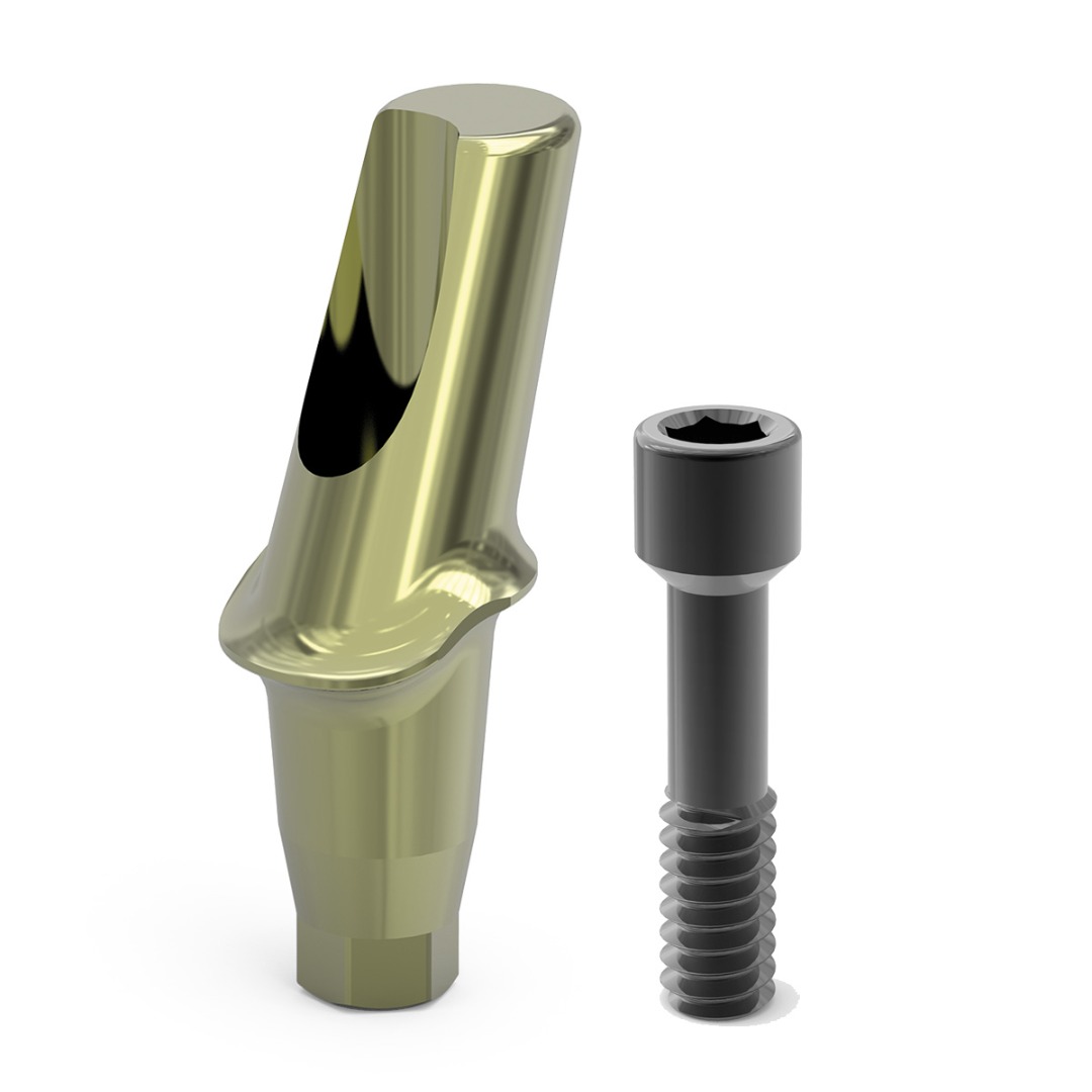

-- url of the page with the problem -- : nordicdental.dk
Hikashop cannot display this added picture in product.
Can you tell me why?

  • Posts: 86180
5 months 2 weeks ago #371378
Hi Peter,
I tested the image from your attachment and it works fine on my end with HikaShop.
This means the issue is likely specific to your server configuration. Please check the following:
1. Check your PHP memory limit in System > System Information > PHP Information. Search for "memory_limit". If it's 128MB or less, try increasing it to 256M.
2. Check that the GD library is enabled in PHP (also visible in PHP Information, search for "gd").
3. Check if your original image file is the same as the one you attached here, or if it's a larger version. If the original is a high-resolution photo from a camera, try resizing it to 1200x1200 pixels before uploading.
4. Check the file permissions on your HikaShop upload folder (media/com_hikashop/upload/). It should be writable by the web server.
If the problem persists, please enable the Joomla error reporting (System > Configuration > Server > Error Reporting > Maximum) and try uploading again. The error message should help identify the exact cause.

5 months 2 weeks ago #371380
Simply says that memory is set to 1024 mb.
If I take the photo from a folder, then it is not working. If I take another photo from another folder, then it is working. Strange.
If I drag and drop, then it is working and it is showing.
I generated the photos for this product group with Photoshop as a mass action. I think the files are ok.
The resolution on thise photos are 72
This is wierd.
It do not comes with any fail in back end on product when insert a photo.

Ziacom - Dental Implant.Galaxy®.TT. (Titansure) GLY3485

5 months 2 weeks ago #371383
I tried to make the photo manual...same same.
Wher do I make the choose photo window bigger, it is too small.

Hi Peter,
We have identified both issues:
1. Images from subfolders: There was a bug in your build of HikaShop 6.4.0 where images stored in subfolders of the upload directory could not be selected from the gallery. This was fixed in a later build of 6.4.0.
2. Deprecation errors on address.php line 576: This was a PHP 8.3 compatibility issue where a null value was used as an array key when no user is logged in. We have now fixed this as well.
Both fixes are included in the latest build of HikaShop 6.4.0. Please re-download and re-install HikaShop from your member area on our website. Your configuration and data will be preserved during the update.
Regarding the photo selection window size, in the latest build you can now configure it. After updating, go in your phpMyAdmin, open the hikashop_config table and add to it entries with the namekey gallery_popup_width and gallery_popup_height and the number of pixels you want for the width / height of the popup.
