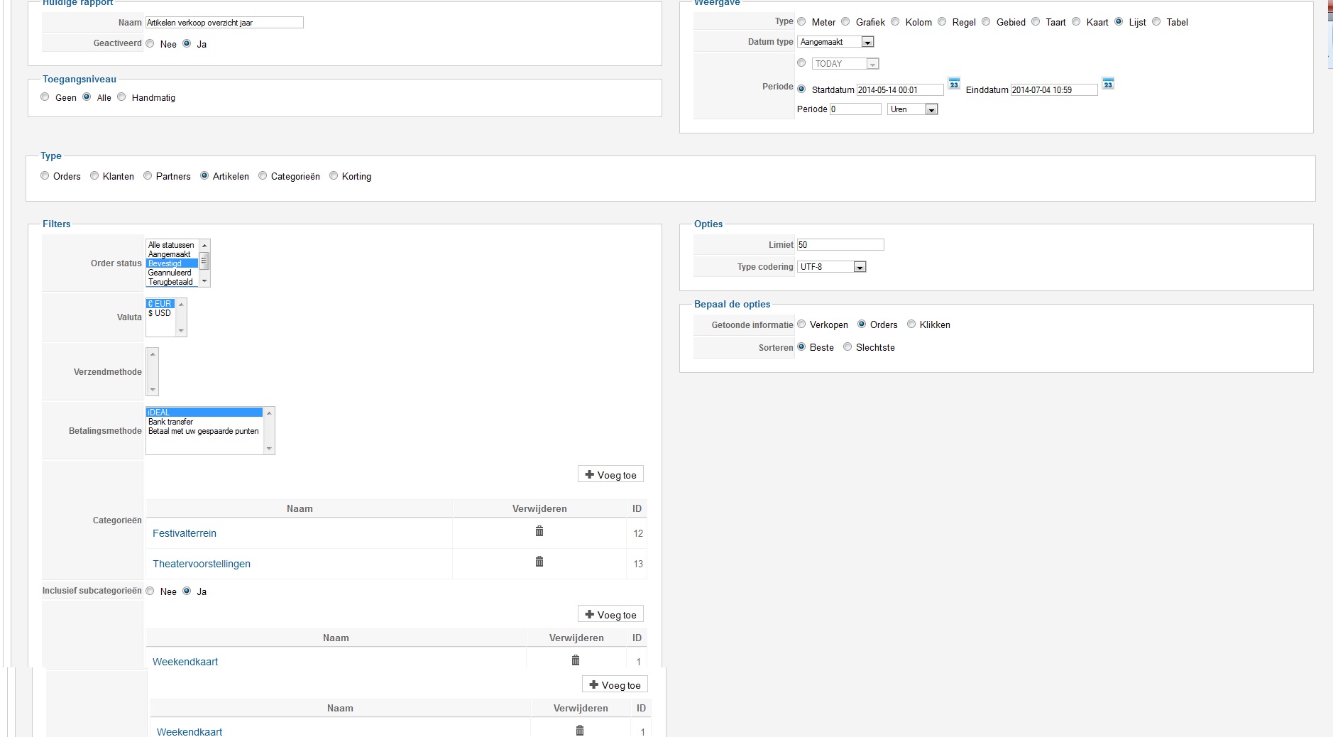

Facing an problem when visiting my report page. (See attachment for the options i selected)
The report i made shows how many times an product has been sold.
It seems that the system isnt checking the id's of the products and makes an result for every id. Instead i think the systems makes an result for every product name.
Cause i have 2 products with the same name, in the report page they get put together and show as one result.
You can test it yourself by making 2 products and give them the exact same name the only difference is to change the alias so you dont get an error. Then make an order and see what happens ;)
Is there any solution to this problem?
