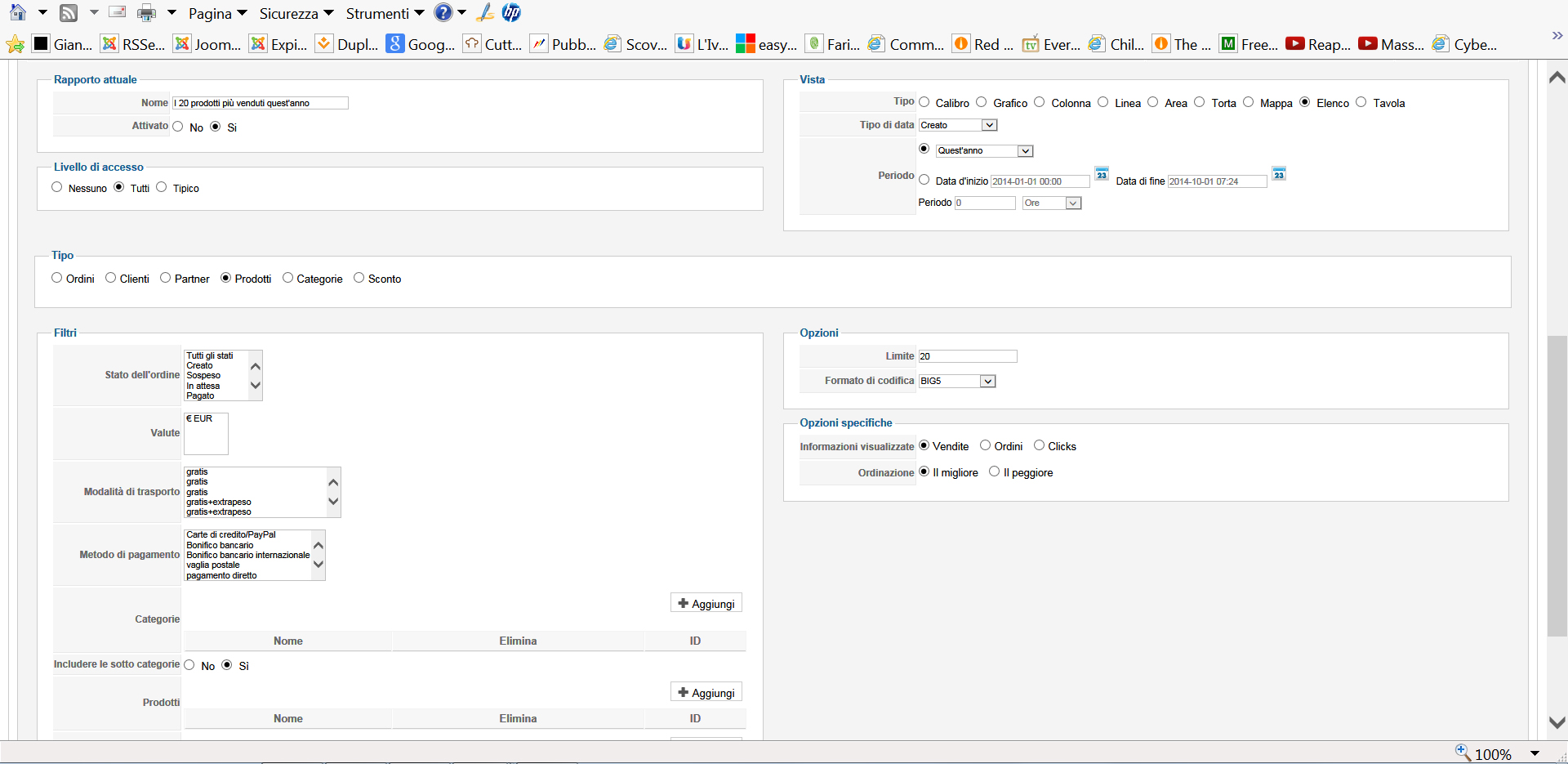

11 years 11 months ago #173701
Thanks to give us a screenshot of you report configuration in order to try to reproduce the issue on our end.
The amount should be updated once the order has a confirmed status.

11 years 11 months ago #173822
here you are the screenshot.

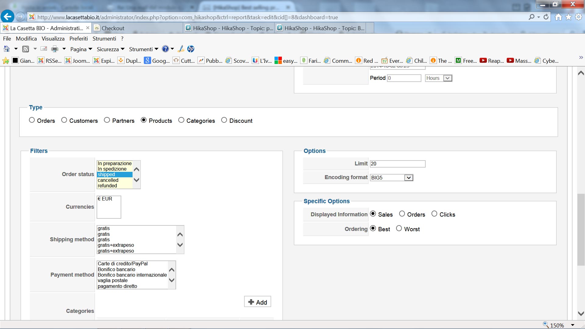

11 years 11 months ago #173934
In the filter of this report you don't have selected an order status, so all the products of all the orders statuses are displayed.
Even products in cancelled, or created orders, so as you said it don't represent the sol products.
You just have to add more conditions in the filters.
  • Posts: 719
11 years 11 months ago #174014
it was setted on shipped.
On the screenshot i did not scroll down the menù.

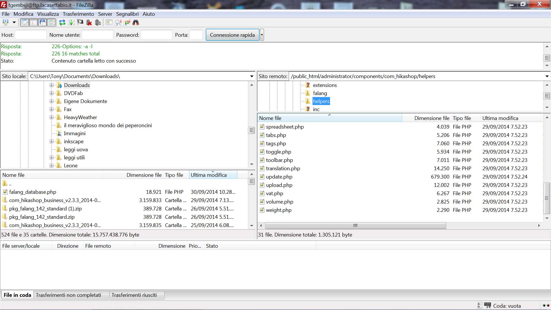

  • Posts: 719
11 years 11 months ago #174188
i'm sorry but i don't have that file, as you can see on the screenshot attached here.
If it can to help you, the product where i had the test is that: www.lacasettabio.it/negozio-online/prodo...libro-vendita-online

11 years 11 months ago #174201
Jérome was talking about the file "administrator/components/com_hikashop/classes/widget.php"
