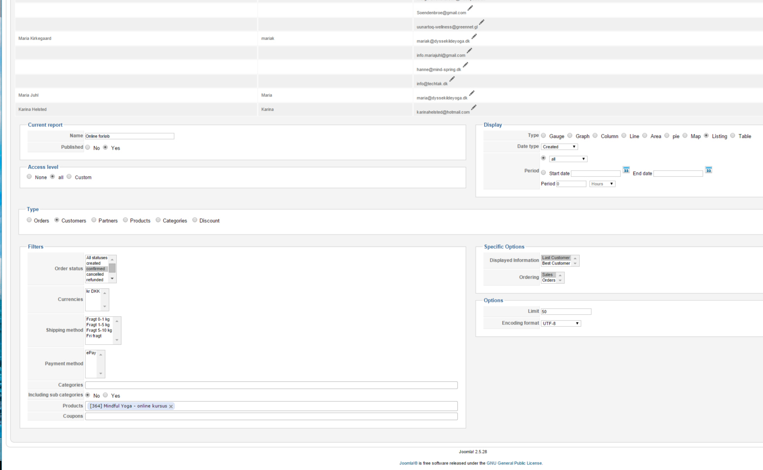

Can you show me how did you configured your Report through some screenshots ?
Note that a solution can be to :
- Set the "Type" option of the "Display" tab
- Set the "Type" tab/option to "Customers"
- Adapt the filters.
  • Posts: 7
11 years 3 months ago #201386
Hi Mohamed
I tried your advise, and now I can show a report with e-mail addresses. Great! But I can only show up to 50 on the list? How can I show more? Alternatively as a CSV file.

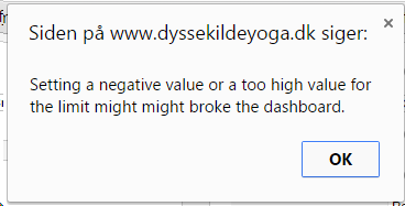

....Hmmm. But when I try to add eg. 500 I receive the following message:
So I can only put it as high as "Setting a negative value or a too high value for the limit might might broke the dashboard". And then it defaults to 7.
Last edit: 11 years 3 months ago by Butlerweb.
  • Posts: 26384
11 years 3 months ago #202216
Yes we added it for "security" purpose because it could require too much CPU/Memory for servers to execute such report.
If you want to perform an export, I will more recommend you to use a "mass action" instead of a report.
