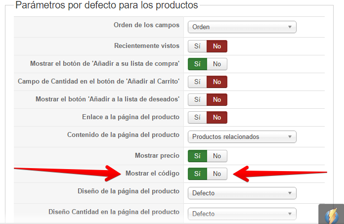

  • Posts: 86106
  • Thank you received: 14207
10 years 9 months ago #222710
Turn on the "display product code" setting of your HikaShop configuration and that should do it.

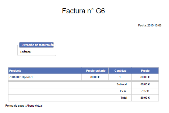

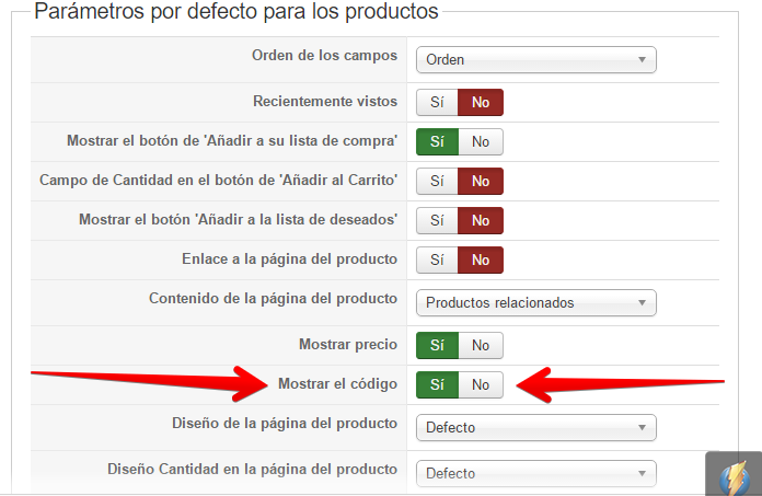

  • Posts: 75
10 years 9 months ago #222947
I attached the capture. This enabled see the code, and the bill does not come out. I am attaching the files.

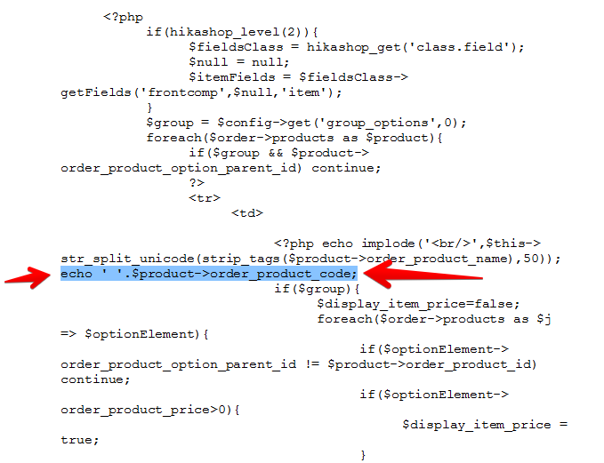

10 years 9 months ago #222969
Ah, you're using the PDF invoice plugin.
In that case, yes the product code is not added.
You need to add the line:
echo ' '.$product->order_product_code;
after the line:
<?php echo implode('<br/>',$this->str_split_unicode(strip_tags($product->order_product_name),50));
in the file plugins/hikashop/attachinvoice/attachinvoice/invoice.php
and that will add the product code.

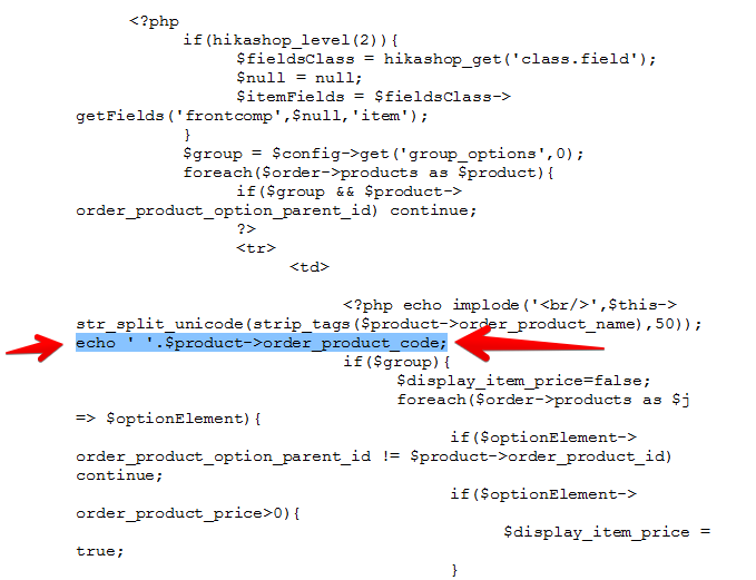

  • Posts: 75
10 years 9 months ago #223136
Thank you very much for responding so quickly.
I changed the line, and the bill not visualize the code of the product. I am attaching the file invoice.php (plugins/hikashop/attachinvoice/attachinvoice/invoice.php)
  • Posts: 86106
10 years 9 months ago #223440
The solution provided is definitely correct.
Can you do a screenshot of your change and one of an invoice after that change ?
Did you maybe already have an override for the invoice file ?

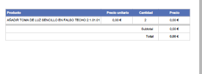

  • Posts: 75
10 years 8 months ago #223967
I performed the operation again and the result is the same. :(
