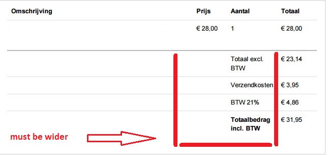

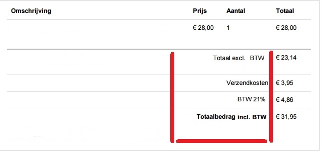

can you help me to edit my invoice in the correct way?
The lower column is displayed in the wrong width (see the attachment 001)
I would like to see it as attachment 002

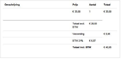

when i change the colspan i get this: see attachment 003
i add the current invoice script as attachment.

You also need to add the colspan="2" attribute to the other rows.
So this line:
<td style="border-top:2px solid #B8B8B8;" class="key">
needs to be:
<td style="border-top:2px solid #B8B8B8;" class="key" colspan="2">
for the subtotal.
And this line:
<td class="hikashop_order_tax_title key">
needs to be:
<td class="hikashop_order_tax_title key" colspan="2">
for the taxes.
