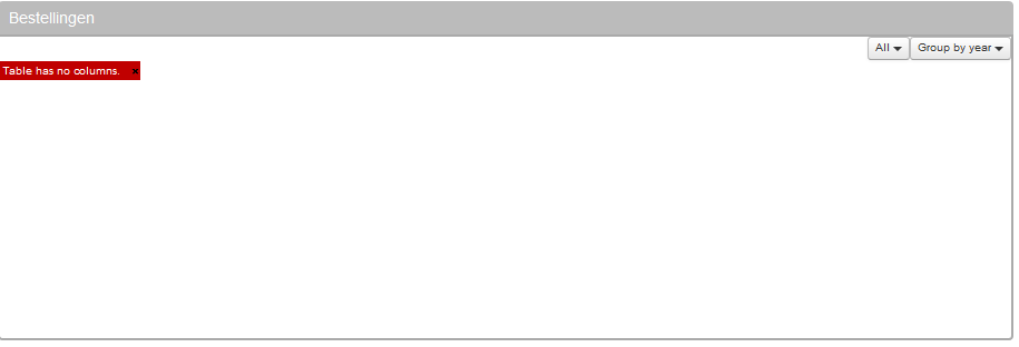

I have the same error at a website that is been updated from hikashop 2.6.4.
Newly installed sites with fresh Hikashop 3.0.0 do not have these messages.
When you select ALL at the Order settings in the Dashboard the message is "Table has no columns."
Perhaps this will give more info about the root cause....

9 years 6 months ago #263469
Got this error "Table has no columns." at the sites that were started at hika 2.6.x and that are upgraded to hika 3.x
There are several orders but they are not there at the dashboard.
The reports are all default. No change has been made ever.
What table needs to be there ?
Kind regards,
Cornel

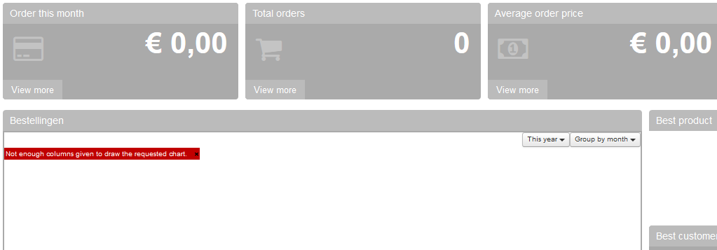

  • Posts: 54
9 years 6 months ago #263497
I was following this thread since I have the same issue (also update ftom 2.64. to 3.0.0). You can create any report you want in Orders/Reports. the all come up with a nice table, list or graph. Only in the Dashboard nothing changes. The message "not enough collumns" remains and the other stats still display zero.

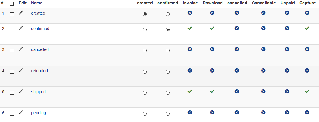

I changed the order statuses ( /administrator/index.php?option=com_hikashop&ctrl=orderstatus ) to create the invoice when a order is confirmed and shipped...... see current table:
No the stats are being displayed in the new dashboard and this topic can be closed.

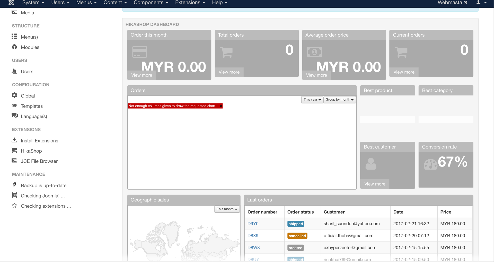

9 years 6 months ago #264330
Hai, i already install the Latest 3.0.1 but as you can see in the image attachment there is no data for total order, average order, best product, best customer, best category and geographical sale. For order, it still show Not enough columns given to draw the requested chart.
it only show the conversion rate and last order data. How to make it display the data?
Pleas guide step by step to solve this problem as im so damn noob. tq
  • Posts: 86106
  • Thank you received: 14207
9 years 6 months ago #264333
As we said earlier, you need to make sure that the "statistics" settings in the menu System>Order statuses correspond to what you want to display.
So if your orders are created and not confirmed, you want to activate "created" there. If your orders are confirmed, you want to activate "confirmed" there. Etc.
