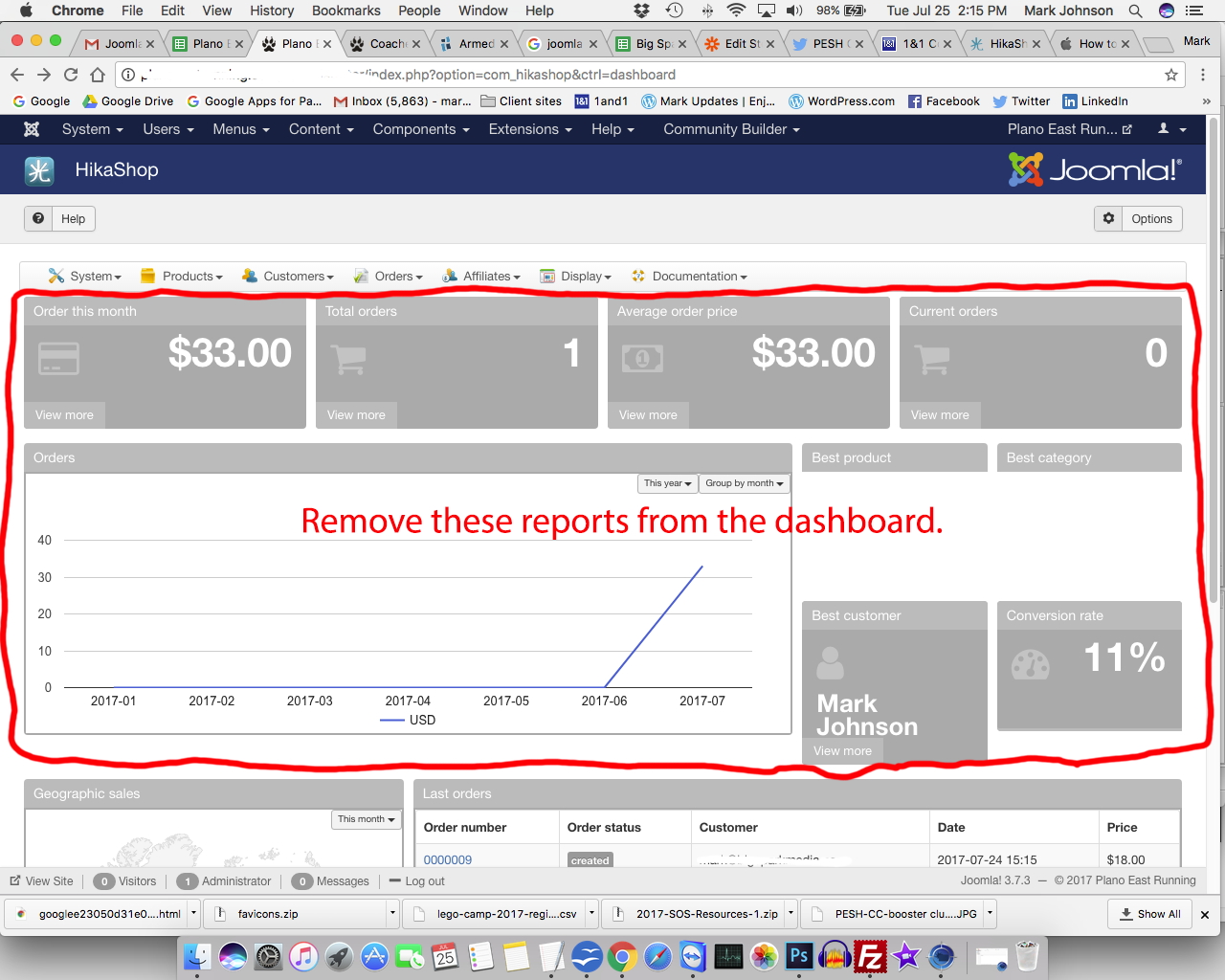

How do I remove reports from the Hikashop dashboard on the site administrative backend?
I want to remove many of the reports on the Hikashop dashboard.
I have searched the documentation, but cannot find an answer to my question.
See attached image (PNG image).
Thanks for the help.

There is no option for the moment to deactivate modules in the report.
But, if you activate the legacy dashboard, you will get the old report interface and you will be able to unpublish the old modules.
Otherwise, if you just want to hide some specific blocks, you can see to use some CSS rules using IDs.

Jerome - thanks for the reply - exactly what I needed!
I removed all the reports by...
1) Activating the legacy dashboard...
www.hikashop.com/support/documentation/5...html#advanced_legacy
2) Unpublishing all the reports that I did not want to appear on the dashboard.
A future product recommendation: create the ability for admins to create/add/delete reports from the new dashboard (the non-legacy dashboard) with the same ease as in the legacy dashboard.
