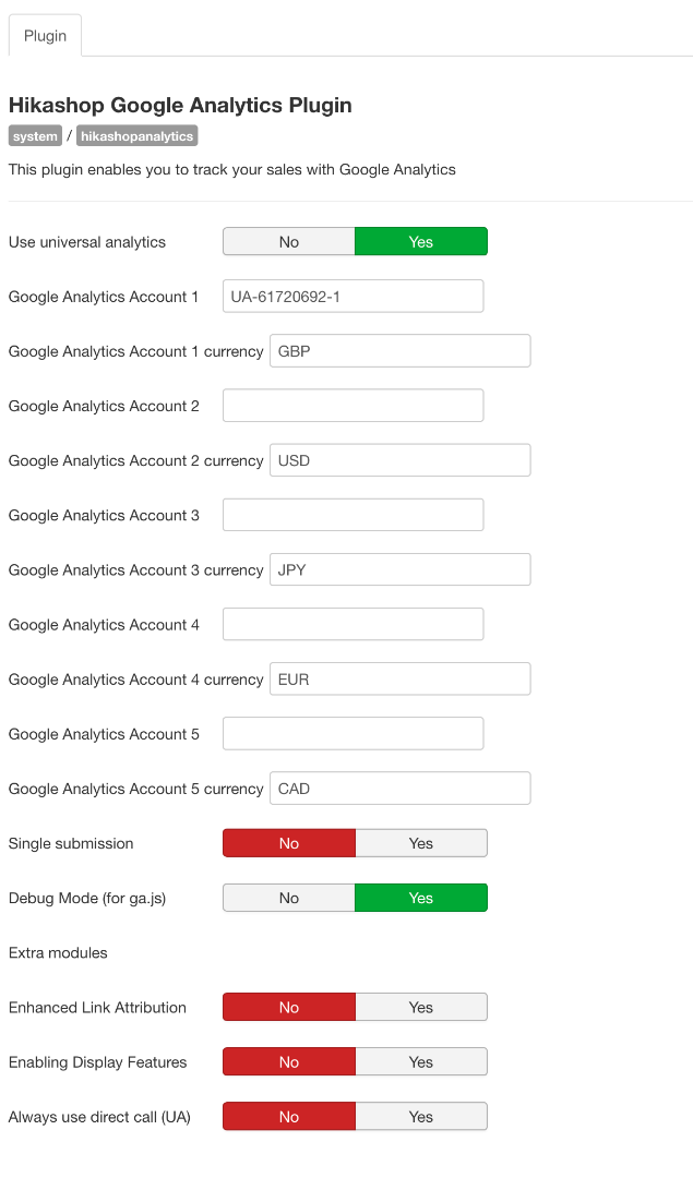

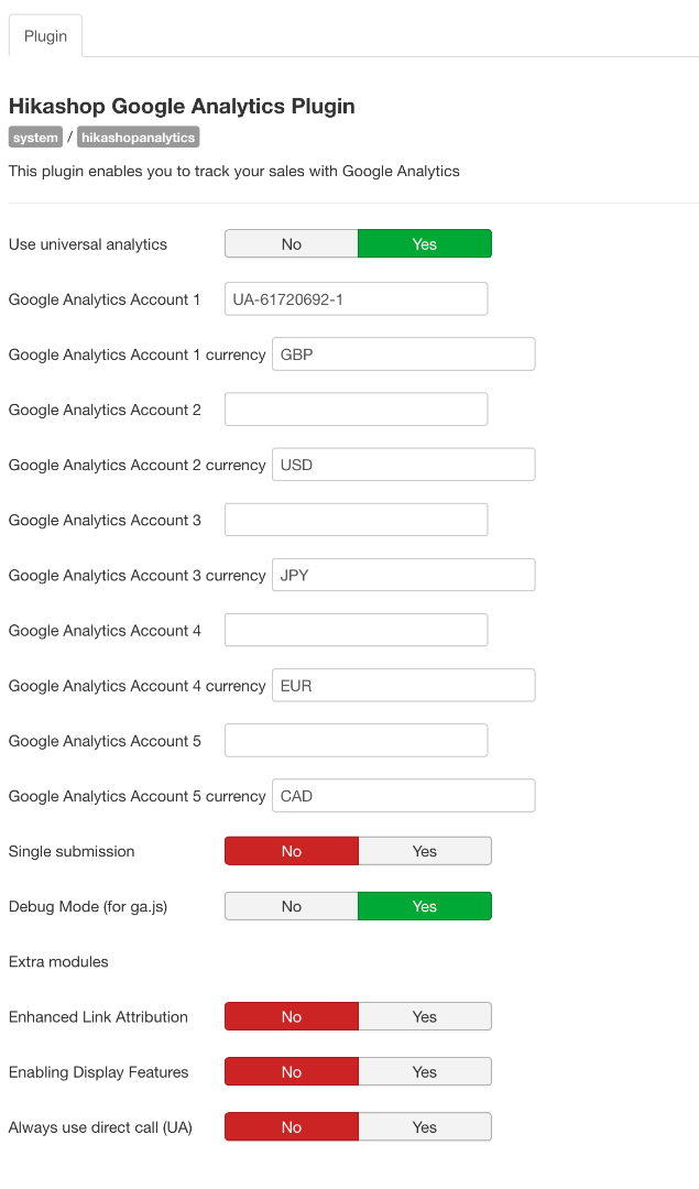

  • Posts: 100
8 years 9 months ago #282580
Sure, I've attached a screenshot. Could it be an issue with the settings?
Thanks again.
  • Posts: 86106
  • Thank you received: 14207
8 years 9 months ago #282585
Try activating the "Always use direct call" setting.
Sometimes, based on how your shop is configured, the data cannot be sent to GA with that option turned off.
