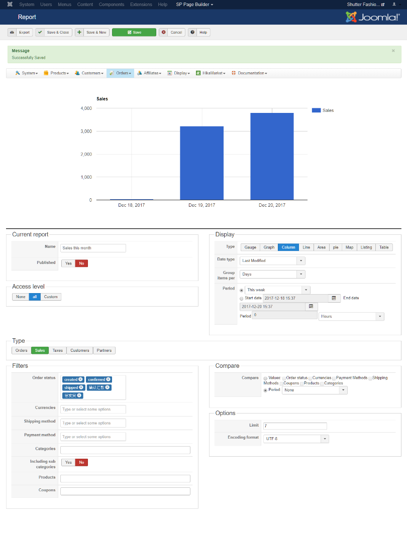

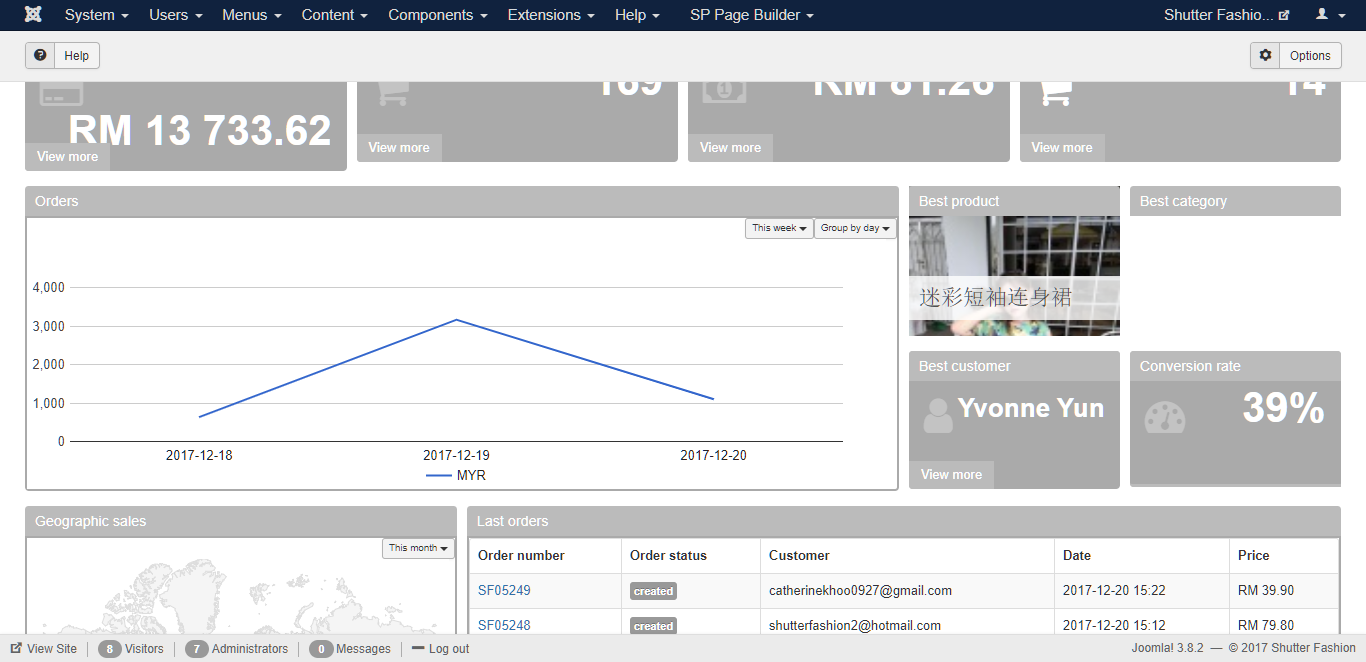

8 years 9 months ago - 8 years 9 months ago #284781 by ler@singmuiheng.com
Both legacy and non legacy dashboard have this problem
we upgrade it from 2.6.5
Let me provide a screen shot for better understanding
Joomla & Server timezone are using +8:00 Kuala Lumpur/Singapore
As you can see in screenshot, there is a big difference of amount between two report, we do not know which is correct when the transaction is big

8 years 9 months ago #284783 by nicolas
Well, you're not comparing the same data on both screenshots.
On the report, you have many order statuses selected but on the new dashboard, only the "statistics" statuses from the System>Order statuses menu are taken into account. Also, if the "created" order status is enabled as a "statistics" status, then it's the order creation date of orders that is used for the dashboard, and if not, it's the invoice creation date of orders that is used, while in your report, you're using the "last modified" date which is again another date.
The order creation date is the date the order was created in the shop.
The invoice creation date is the date the order was paid.
The last modified date is the date the last time something was changed in th order.
Normally, a customer will pay the order directly after it is created and you won't edit the order afterwards, so all these dates would be almost identical. But it's possible that the order was created two weeks ago, paid last week and that you modified it yesterday.
So because of these, it's totally possible to get results way off between the reports and the dashboard because you're not necessarily comparing the same things and it's highly likely that both are correct for what they are trying to display.

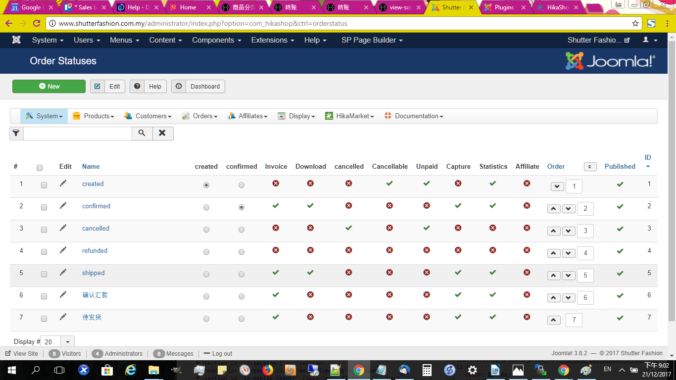

8 years 9 months ago #284866 by ler@singmuiheng.com
i still found problem, i had changed the statistic with created status , here is the screen shot for reference
More
8 years 9 months ago #284868 by nicolas
Well, first if you want the same data as on the reports, you might want to deactivate the "dashboard legacy" setting of the HikaShop configuration.
Otherwise, regarding the new dashboard, as I said in my previous message, if you enable the "created" status in the "statistic" column of the menu System>Order statuses, it will be the order creation date that will be used.

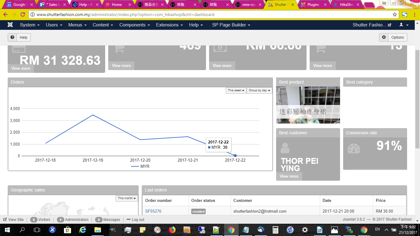

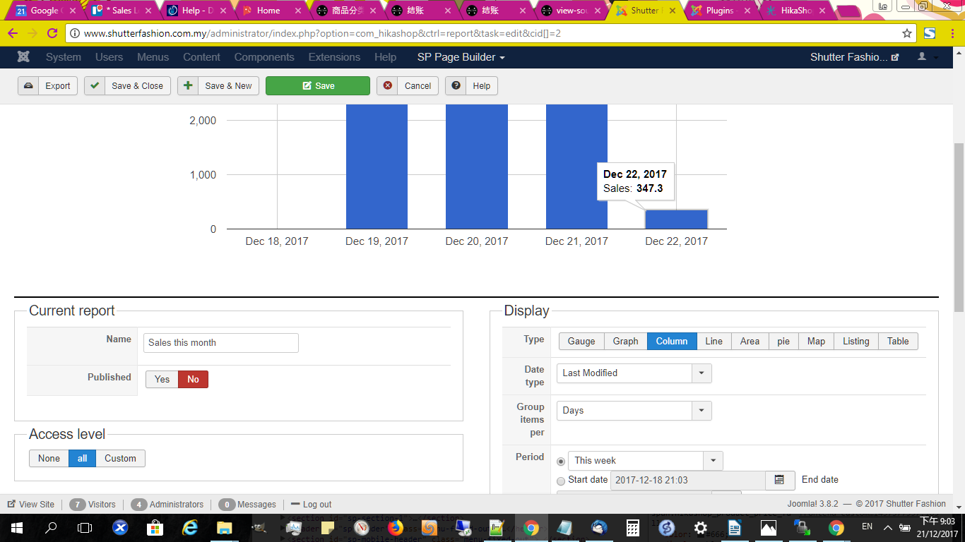

8 years 9 months ago - 8 years 9 months ago #284901 by ler@singmuiheng.com
Dear Nicolas
We had already checked the created status as per in the screen shot in the statistic (you can see it from the screen shot)
However, the data for the order list, report, dashboard are still different (you can see from the screen shot, dash board record the last on the next day date which is not even logic with the order or invoice date)

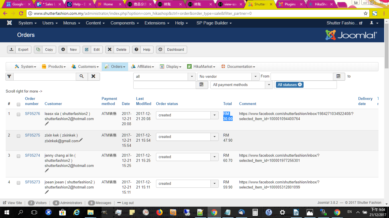

8 years 9 months ago #285082 by ler@singmuiheng.com
SELECT TIMEDIFF(NOW(), UTC_TIMESTAMP) -> result -> 08:00:00
var_dump result -> string(6) "+28800"
server timezone in Joomla - > Kuala Lumpur
For the order_created & invoice created in the screen shot order list
SF05273 - 1513840307 - 0
SF05274 - 1513841158 - 1514009010
SF05275 - 1513842841 - 1513911458
SF05276 - 1513858081 - 0
More
