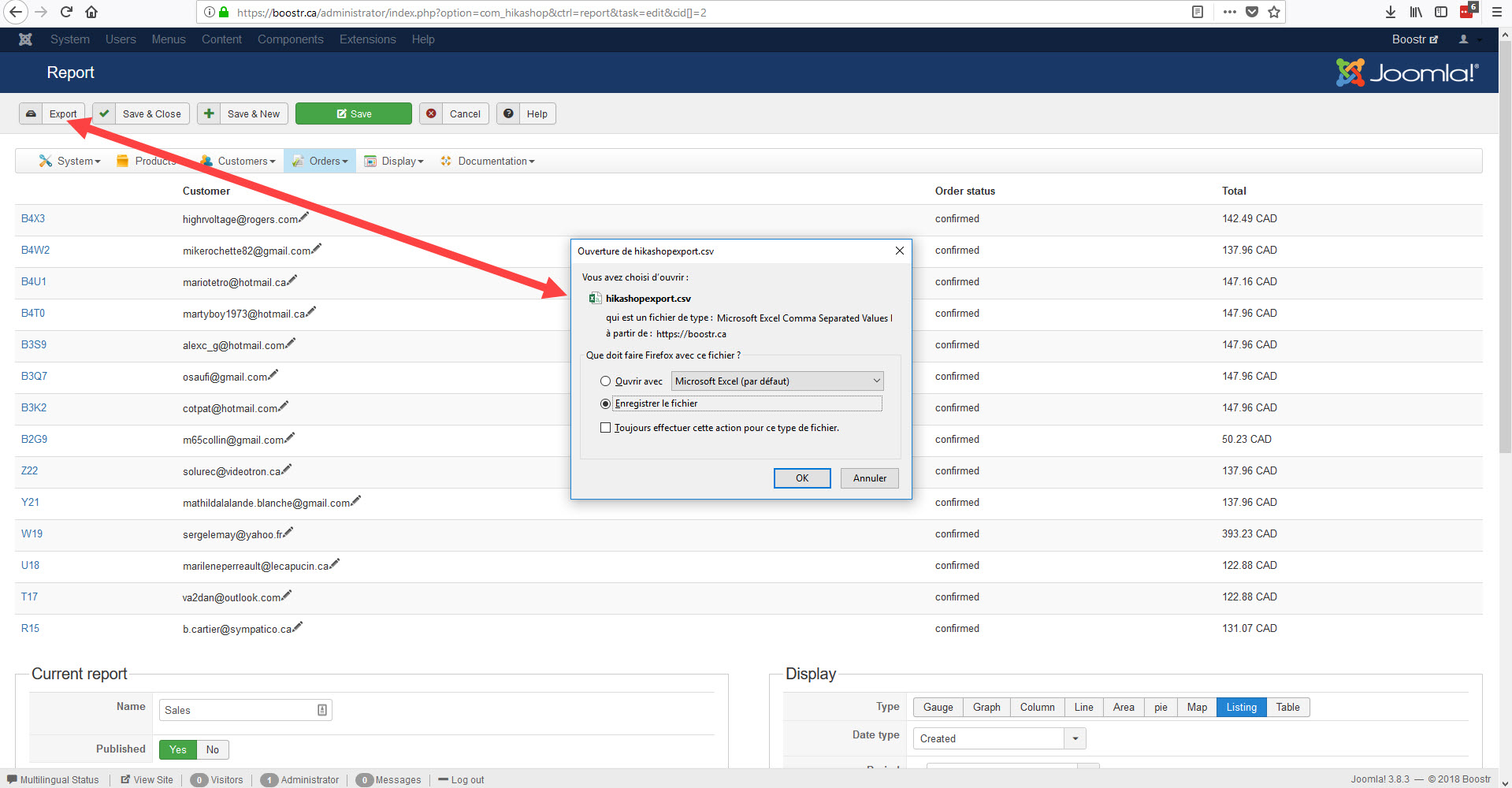

I am trying to import our exported CVS sales report content but the format breaks at the currency column
Can you see what's wrong ?

8 years 7 months ago #286514
This is how the default Export function (button) behaves - see attached screenshot

8 years 7 months ago #286528
Ah, I see what you mean. You're talking about the export of reports and this happens only for some reports, not all of them.
Fortunately, I was able to reproduce the problem thanks to your screenshot and I've added a patch.
You can download the install package again on our website and install it on yours to get the patch.
