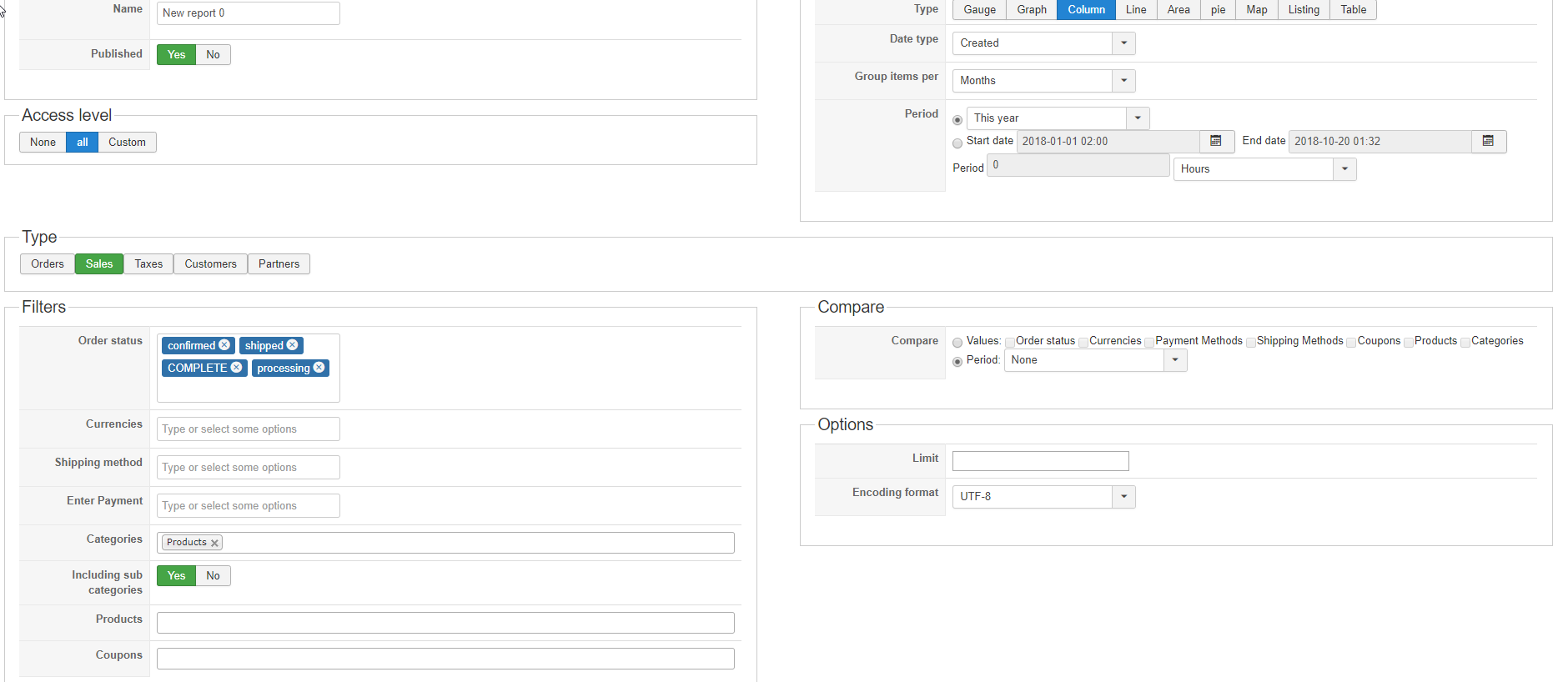

Situation:

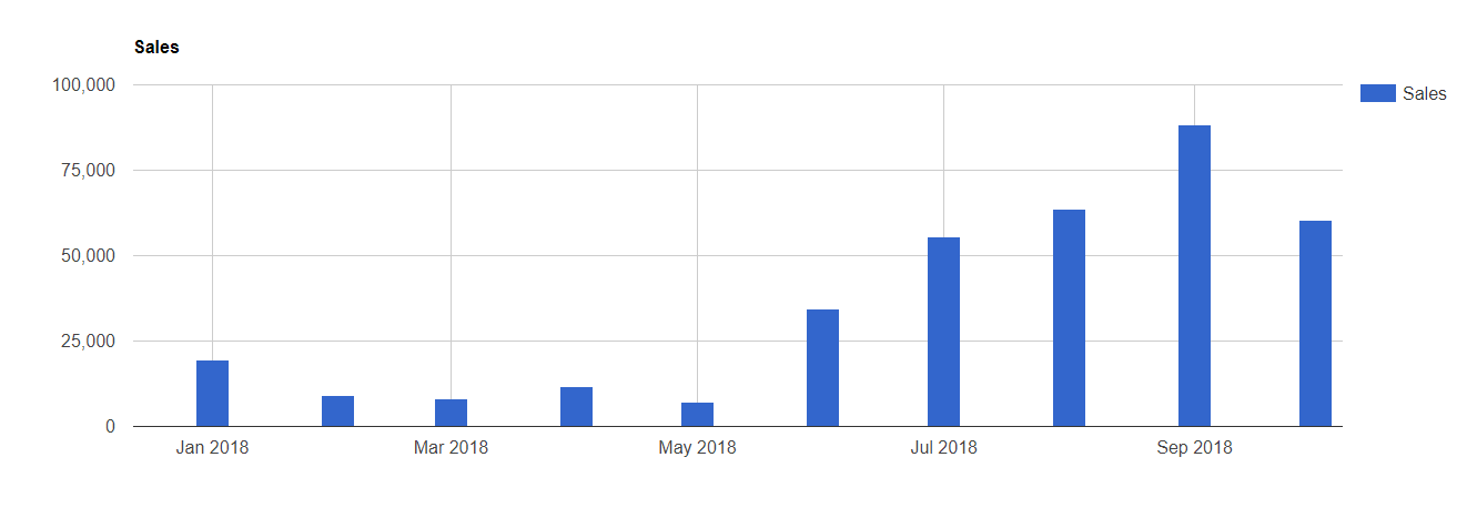

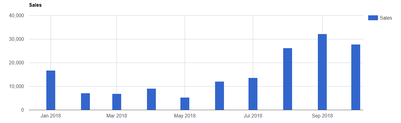

I am trying to show the yearly sales for two master categories. However, some products exist within multiple subcategories. For example, Product A might exist in Master A - > Subcategory A and Master A -> subcategory B. In the reports, i would think that it would filter through this and calculate the total for a given product no matter if it exist in multiple categories. However, this is what displays for the total yearly breakdown (no category filter) and is the correct total for each month:

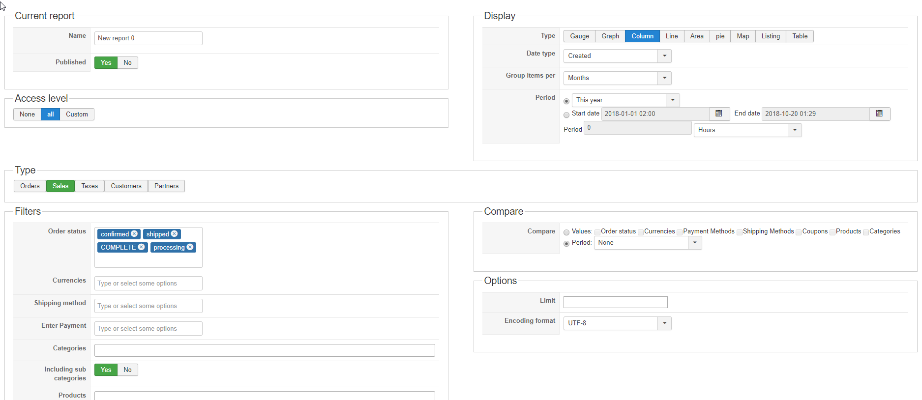

with the following settings (no category filter):
Now if i choose the first master category (products in this case):
with settings (only thing different is "Products" selected as the category):
Is this just a config error or is something broken? Odd that the category specific case shows MUCH HIGHER totals and is definitely incorrect.
I would like to just break down the monthly sales into "products" and "parts" which are both main categories. I should also note we may have one or two products that exist in both "products" and "parts" but that shouldn't skew the data too much.

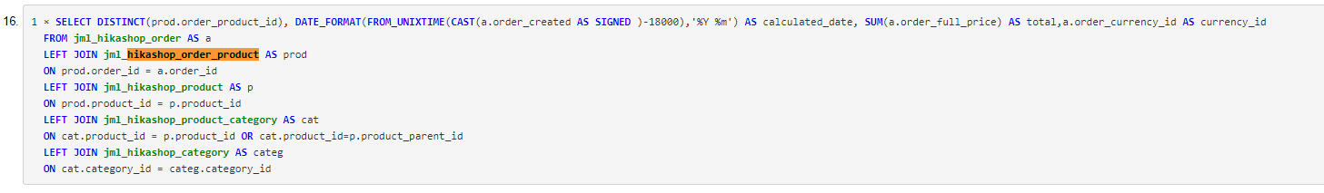

The fact that the products are in several categories is probably what's messing the amounts as the sales must be counted once for each category of the products in that case.
Could you turn on the "debug mode" setting of the Joomla configuration and look at the report again ?
Then, at the bottom of the page, could you search for the MySQL queries with the text hikashop_order_product in it and provide them ?

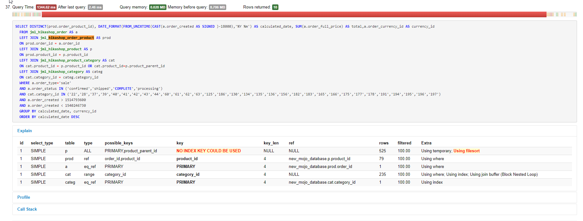

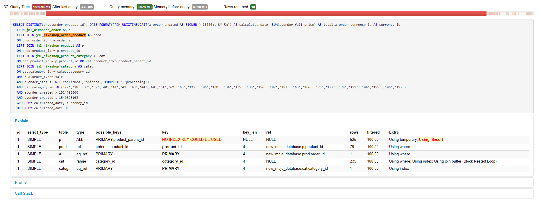

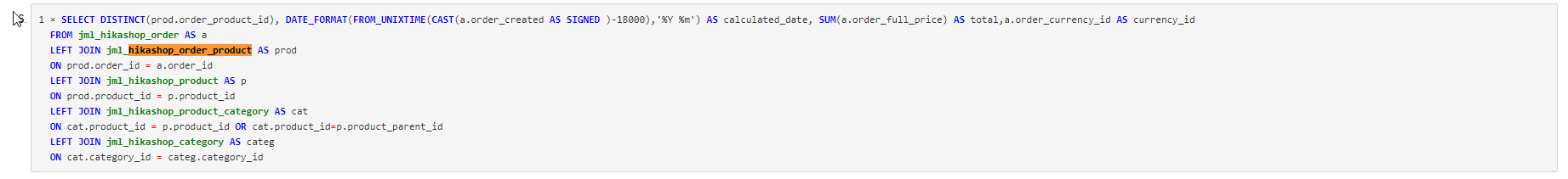

7 years 10 months ago #299441
Here are the query results:
Let me know if you need any further information.

7 years 10 months ago #299477
Thank you for that.
From what I can see, the issue is that the code:
if($widget->widget_params->content=='orders'){
					$selectAdd='prod.order_product_quantity';
				}else if($widget->widget_params->content=='sales'){
					$selectAdd='(prod.order_product_price+prod.order_product_tax)*prod.order_product_quantity';
should be added after the code:
if(!isset($leftjoin['order_product'])){ $leftjoin['order_product'] = ' LEFT JOIN '.hikashop_table('order_product').' AS prod ON prod.order_id = a.order_id '; }
				if(!isset($leftjoin['product_category'])){ $leftjoin['product_category'] = ' LEFT JOIN '.hikashop_table('product_category').' AS cat ON cat.product_id = prod.product_id '; }
				$leftjoin['category'] = ' LEFT JOIN '.hikashop_table('category').' AS c ON c.category_id = cat.category_id ';
in the file administrator/components/com_hikashop/classes/widget.php
That way, it will calculate the sales based on the amounts of the individual products in the order instead of the whole order amount.

Ok, then try to add the same code, but after the code:
$leftjoin['product'] = ' LEFT JOIN '.hikashop_table('product').' AS p ON prod.product_id = p.product_id ';
				$select .= 'DISTINCT(prod.order_product_id), ';
in that same file.
That should help better.

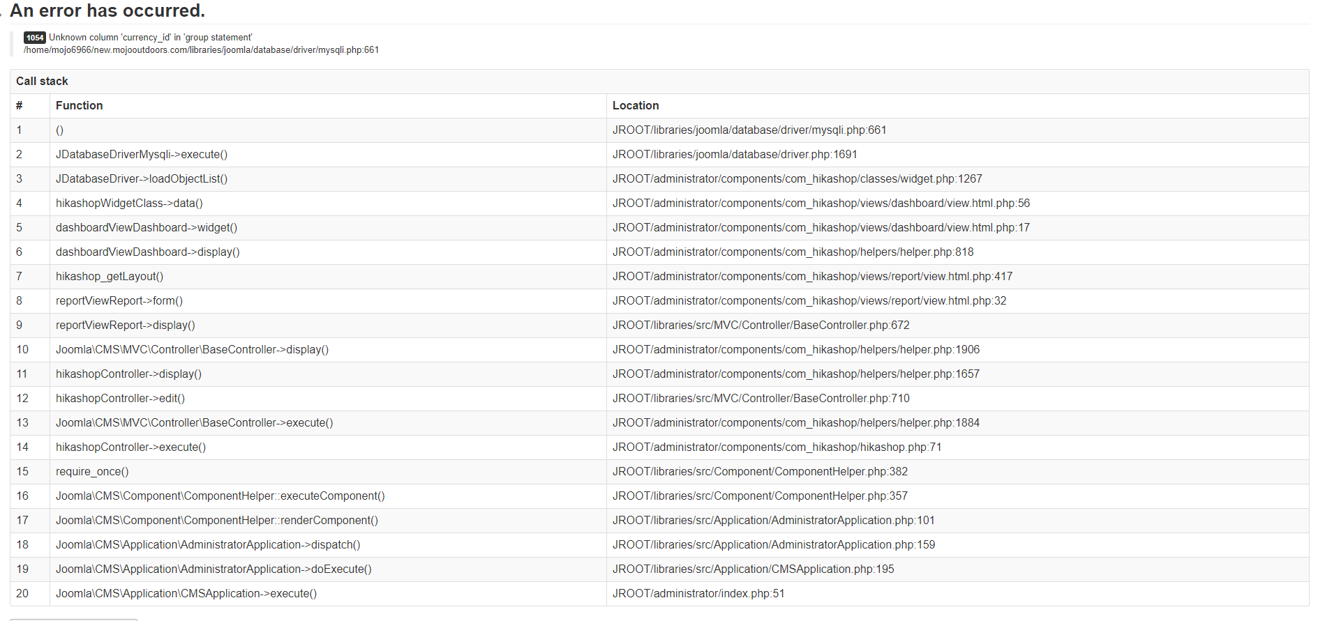

  • Posts: 303
  • Thank you received: 18
7 years 10 months ago #299664
Here's more info on the error:
For now I have removed the code. I added it to the requested location in administrator/components/com_hikashop/classes/widget.php which was around line 646.

  • Posts: 86106
  • Thank you received: 14207
7 years 10 months ago #299700
So you need to keep that change but also change the line:
$pie= 'SUM('.$selectAdd.') AS total';
to:
$pie= 'SUM('.$selectAdd.') AS total, a.order_currency_id AS currency_id';
in that same file. That will avoid that query error which happens because the way the calculations are done changed with the modification I proposed.
