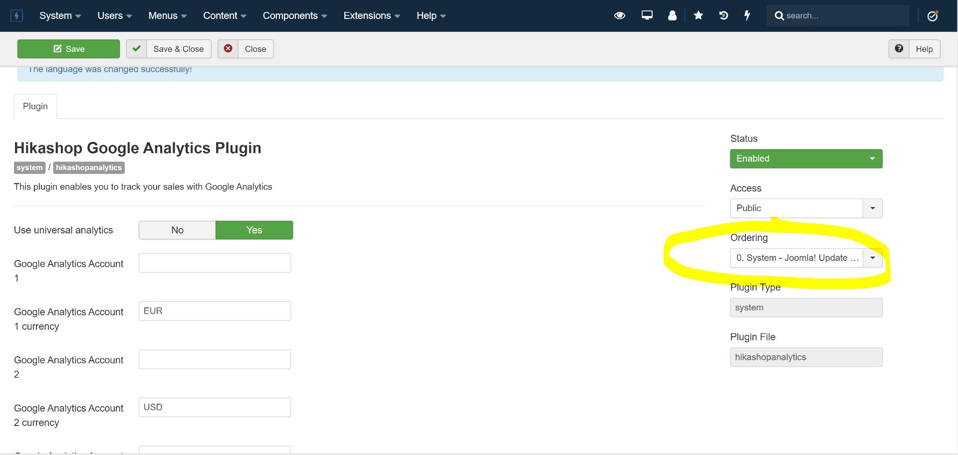

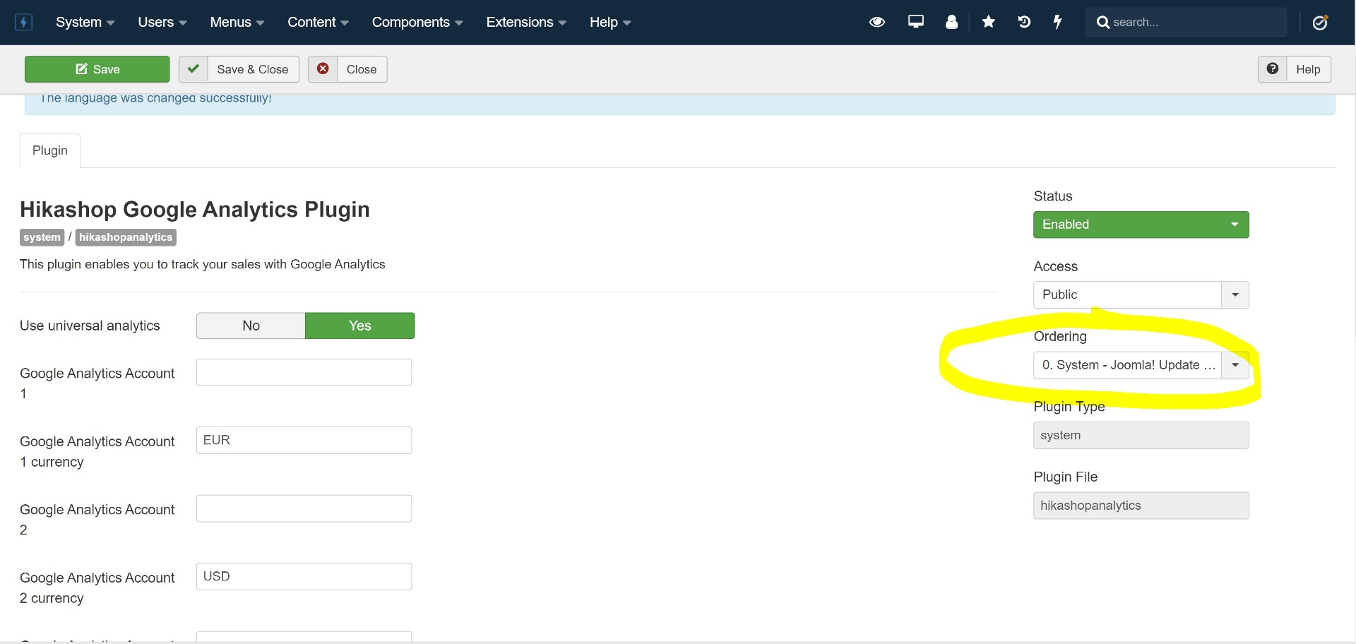

Hello I have installed the plugin for google analytics. I get the message no fragment found.
In the screenshot I have blancked the code but it is inserted. What I do notice is that when I select the google analytics in the ordering field it changes to 0. System - Joomla Update, I marked it yellow.
I understood that the plugin only registers orders, it that correct. I read a question why and what you want to know more. Well I am interested to see what pages are visited and how long. Is that possible. If not with this plugin, would the manually installing the tracking tag do the job.
thanks
jos
  • Posts: 86187
5 years 6 months ago #329871
The plugin is indeed only to send orders data to GA.
Seeing what page is viisted for how long is something oyu can do with normal Joomla GA plugins or with the script provided by GA:
www.joomlashine.com/blog/install-google-...GA%20tracking%20code .
So you'll likely want both that and the GA plugin we provide.
Now regarding the error "no fragment found", that's the first time I hear about it. Where did you get it ? Could you provide some screenshots ?
