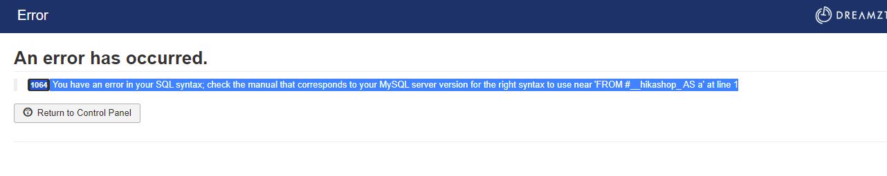

-- Joomla version -- : 3.9.21
-- PHP version -- : 7.2
-- Browser(s) name and version -- : google chrome
-- Error-message(debug-mod must be tuned on) -- : 1064 You have an error in your SQL syntax; check the manual that corresponds to your MySQL server version for the right syntax to use near 'FROM #__hikashop_ AS a' at line 1
Hi, can you help to check why error shows out in the report

That's hard to say like that. Even with the backend access I can't say.
It looks like a bug appearing in a specific situation based on how the report is configured.
Are you able to reproduce the issue with a new report ?
If so, could you do a screenshot of the settings just before you save and get the error ?
Also, it would be great if you could do that modification ( www.hikashop.com/support/forum/install-u...ror-1064.html#326783 ) so that the error message would include the MySQL query leading to the error. With the settings and the MySQL query that would help.

Thanks. I was able to investigate the issue.
The problem was the data of the report itself which wasn't initialized properly. So the fact that it wasn't displaying was only a byproduct.
I've added some code to add failsafes so that if the report has invalid data, it will still be able to load properly. The patch seems to work fine on your website.
We'll add that for the next version of HikaShop in September.
