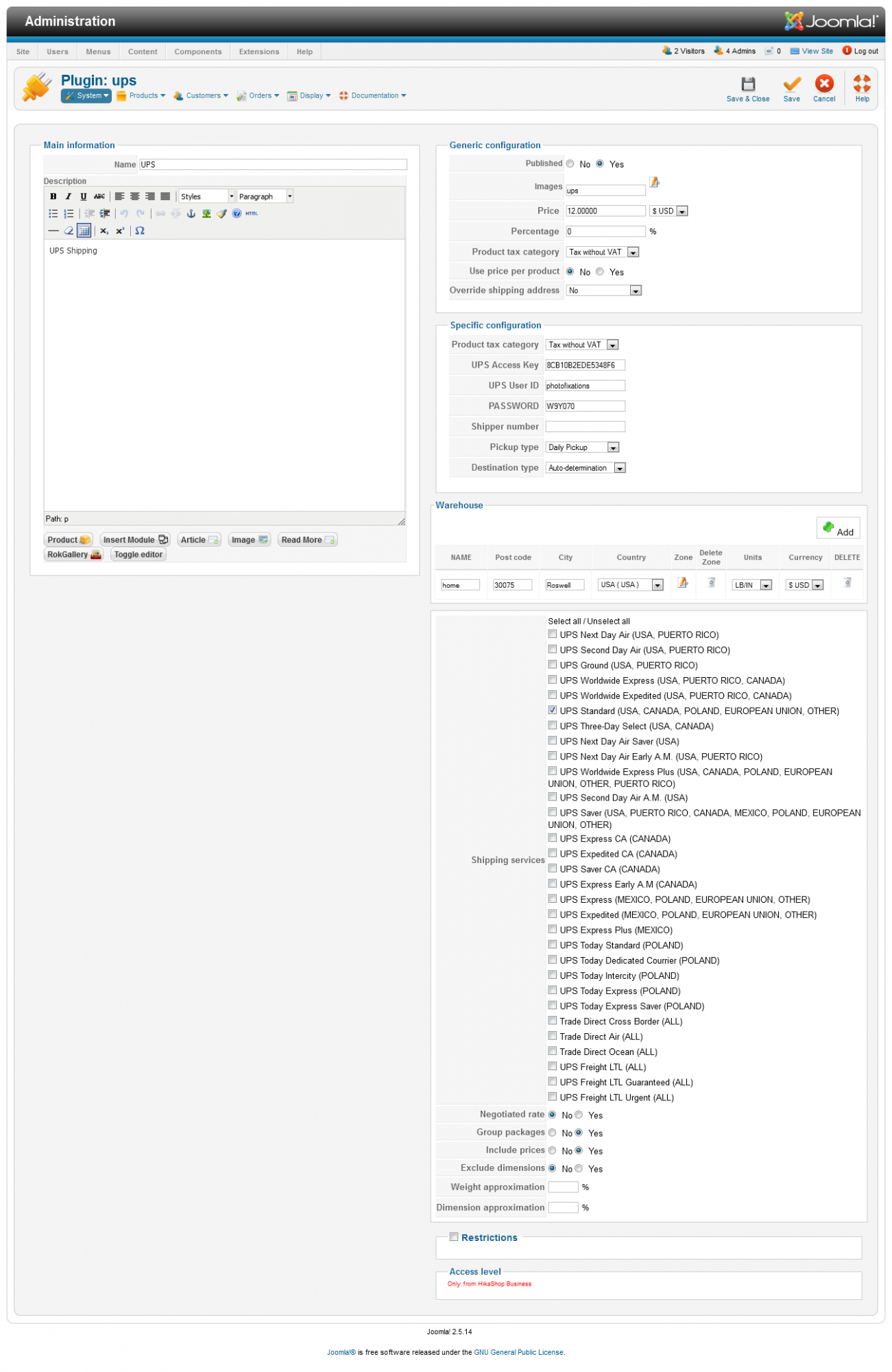

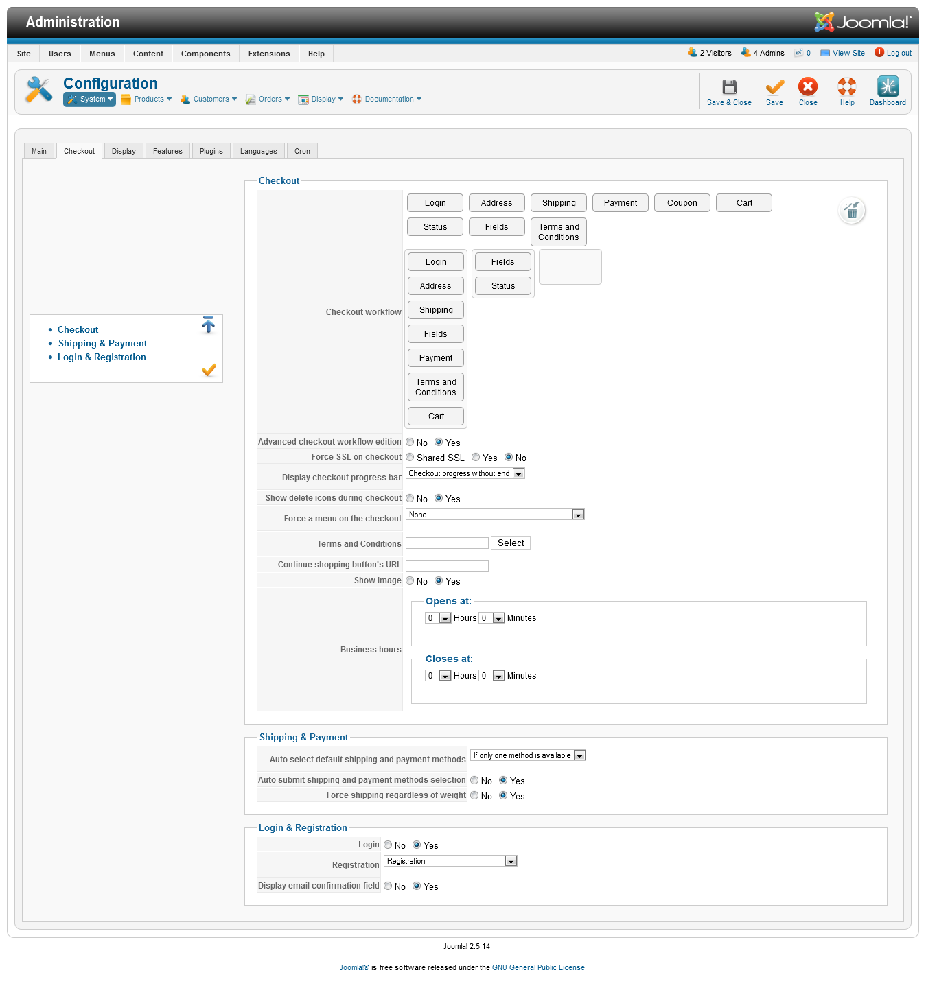

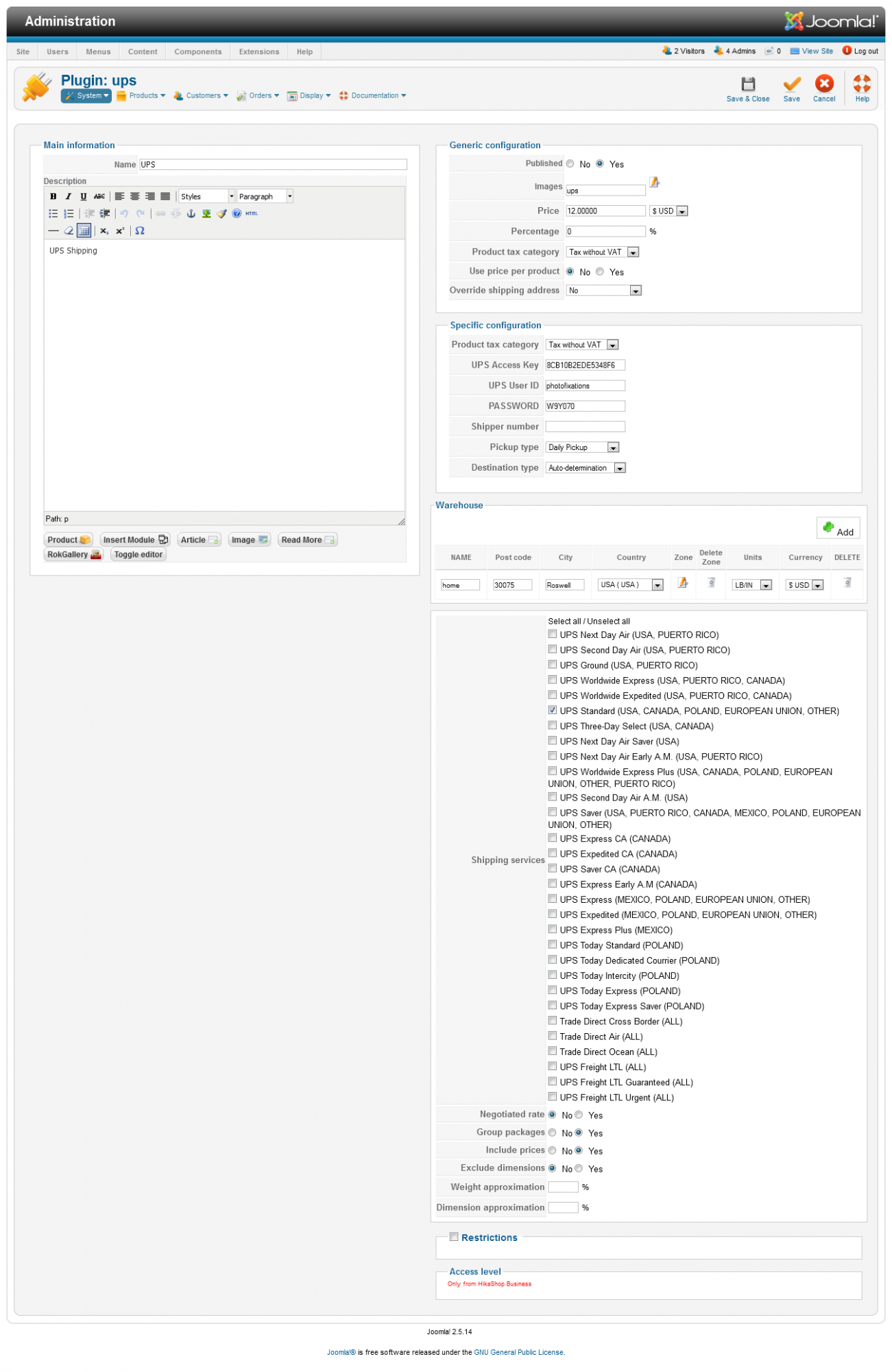

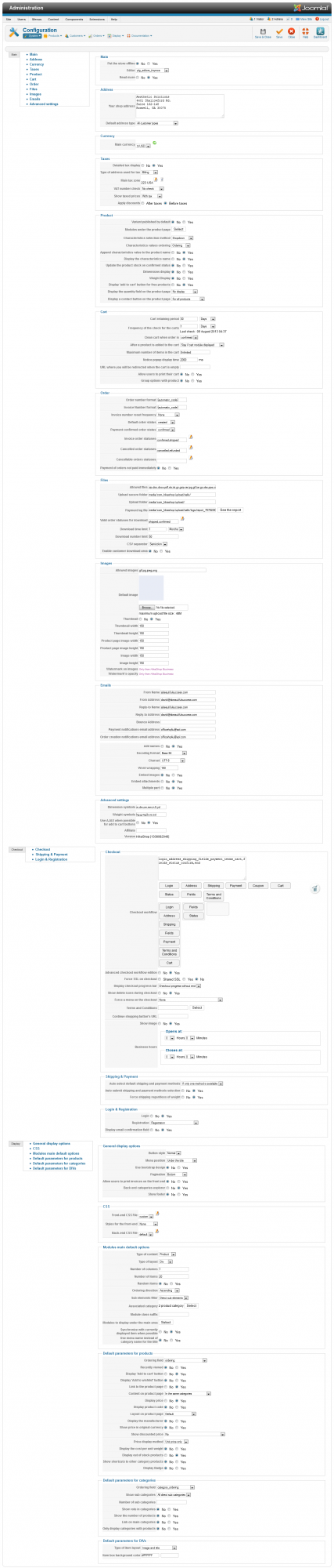

Ok, so can you show me of screenshots of how did you configured :
- Your UPS shipping method
- Your checkout workflow through "Hikashop->System->Configuration->Checkout"
- Your product weight and dimension that you are using when you're testing the UPS shipping method.

  • Posts: 18

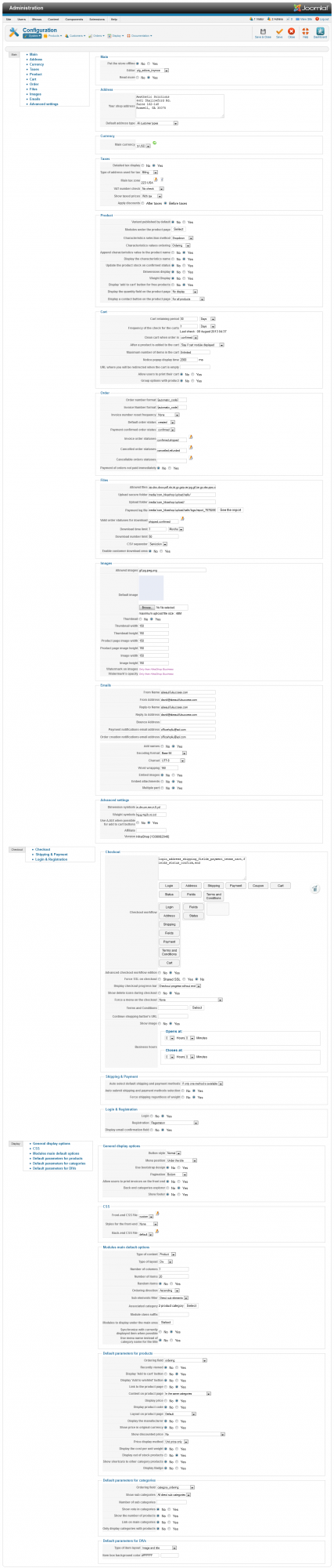

12 years 11 months ago #118008
please find the attached scrrenshots.
please find some fruitful solution

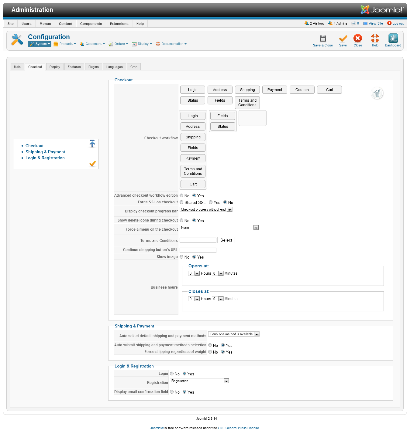

  • Posts: 18
12 years 11 months ago #118009
  • Posts: 18

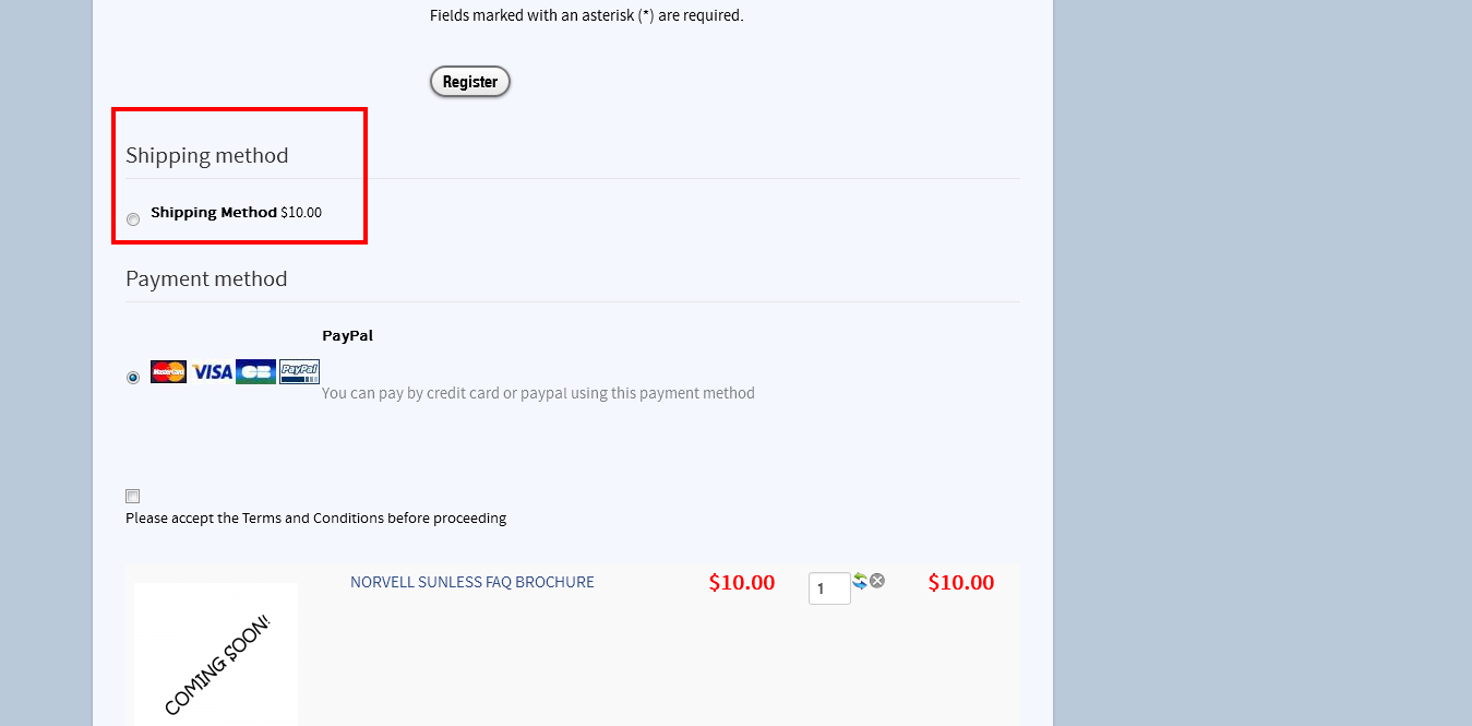

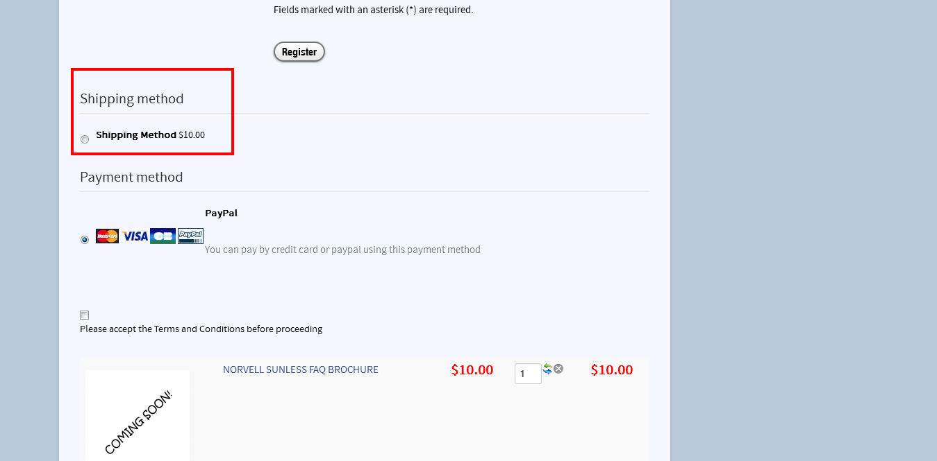

12 years 11 months ago #118010
Here onlu Shipping Method is shown but i need UPS shipping
  • Posts: 18
12 years 11 months ago #118019
Here is the screenshot which shows dimensions and weight symbols used.
what I need is UPS shipping option on website where now only shipping method is displayed.
12 years 11 months ago #118032
The problem is probably coming from the fact that you didn't set any Shipper number through your UPS configuration screen, also make sure that your products have a weight and dimensions.

12 years 11 months ago #118051
1. You'll find your shipper number through the UPS website: My UPS > Profile > Maintain Your UPS Account (cf. UPS documentation).
