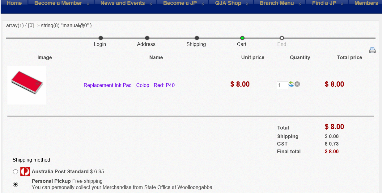

  • Posts: 22
12 years 11 months ago #120313
While this patch has solved the checkout problem I have noticed an erroneous message appearing during the checkout process: See attached screenshot.
  • Posts: 85995
  • Thank you received: 14167
12 years 11 months ago #120347
It's fixed.

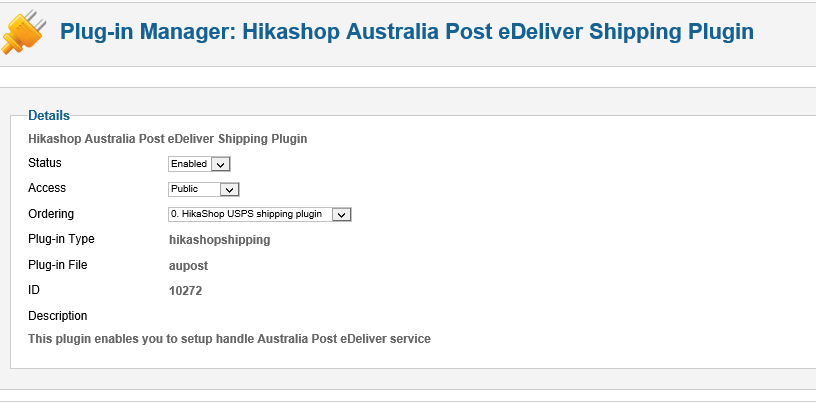

  • Posts: 22
12 years 10 months ago #124805
:S I have done some testing and I believe my problem relates to the latest Australia Post plugin issued with the 2.2.1 upgrade.
I reinstalled the Australia Post plugin released with version 2.2.0 dated 12/8/2013 and this works OK.
Prior to the 2.2.0 upgrade I used the "Additional Fee" field but noticed this was removed during the 2.2.0 upgrade. When I upgraded to 2.2.1 I noticed the "Additional Fee" field had returned but unfortunately as it appears this version of the plugin does not work on our system I am unable to use this feature.
I also noticed the plugin used to be called "Hikashop Australia Post Shipping Plugin" now it is called the "Hikashop Australia Post eDelivery Shipping plugin". what is the difference?
Our shop is now back online but using an older version of the plugin.
Can you help with identifying the fault as we would like to use the "Additional Fee' field.
Thanks,
Keith

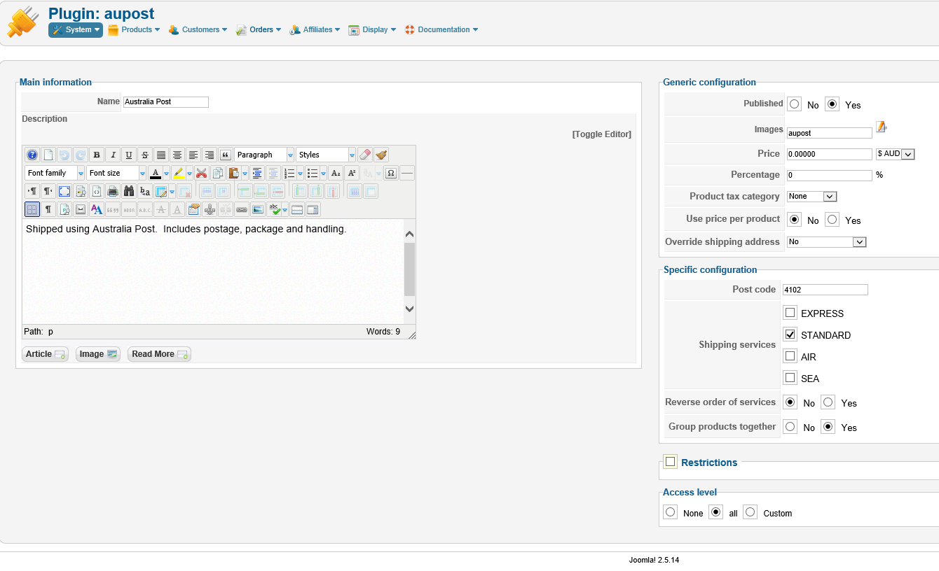

  • Posts: 22
12 years 10 months ago #125316
I have reinstalled 2.2.1 again - no change to the way the Aus Post plug in behaves. Attached are snapshots of the plug in and configuration screen where you can see there is no "Additional Charge" field.

  • Posts: 26380
12 years 10 months ago #125404
I am not the specialist of the plugin Australia Post, but in order to add some additional fees, you have to use the field "price" in the generic configuration of the shipping plugin.
The plugin base price will be this price and it will add the price return by the Australia Post API.
