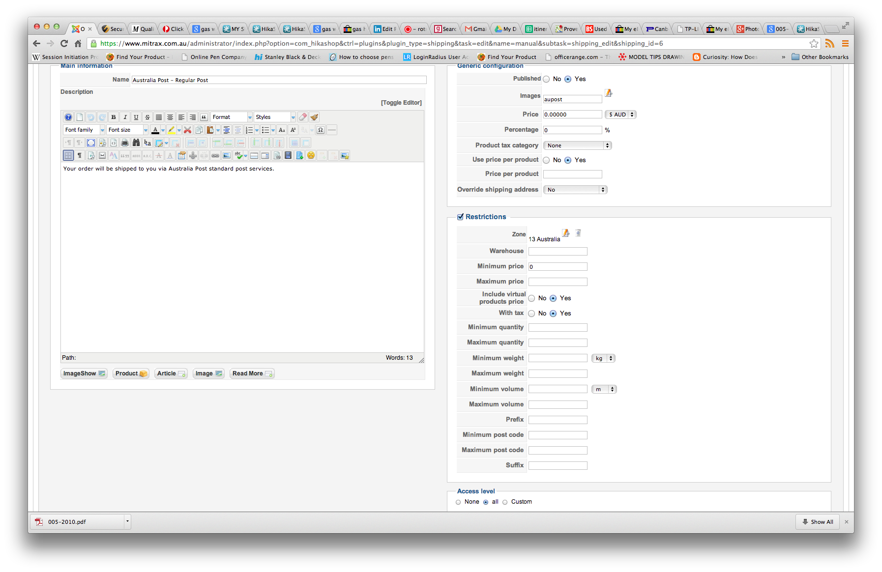

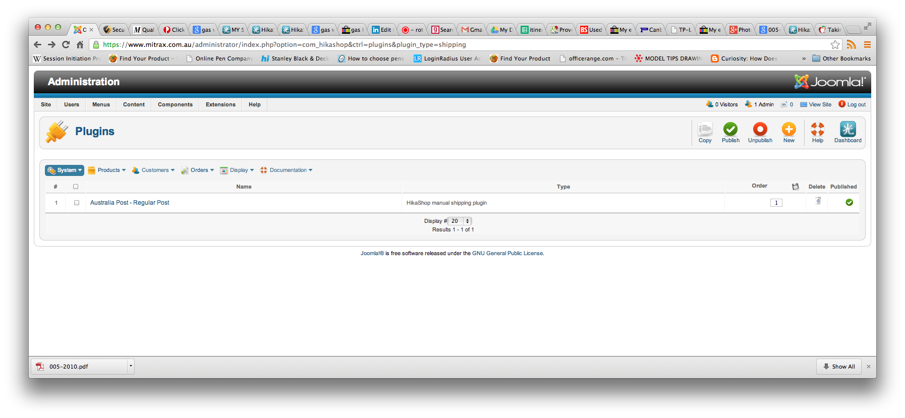

  • Posts: 76
  • Thank you received: 5
12 years 11 months ago #119300
I think the information you want is in the attachments on this post.

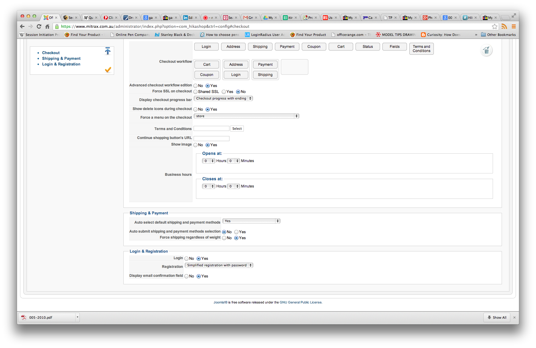

It's probably that you turned off the "auto select of the shipping and payment methods" option of the Checkout tab of the configuration. Please turn it back on and then you will have to refresh your user session (you can try with another browser for example) to see the change.
  • Posts: 76
12 years 11 months ago #119307
Thanks Nicolas,
Checkout configuration is attached. Auto select is set to yes.
Rob

12 years 11 months ago #119880
Indeed your configuration seems to be correct.
could you try to reinstall the last Hikashop version (by downloading it again on our site)?
If it doesn't solve the issue, we will probably need a FTP access to find the source of the issue.
