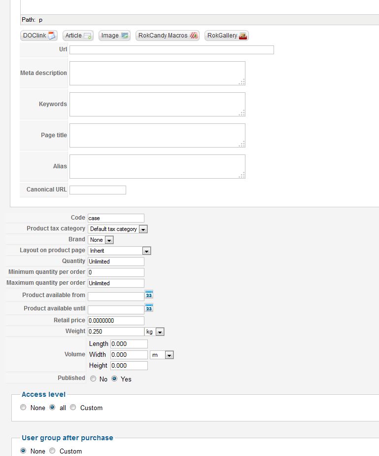

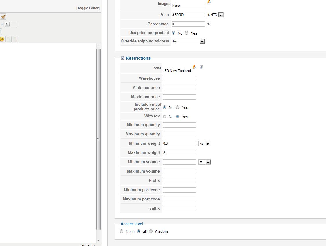

Firstly can you tell me how did you configured your product and your shipping methods through some screenshots ?
The following user(s) said Thank You: ivibes
  • Posts: 11

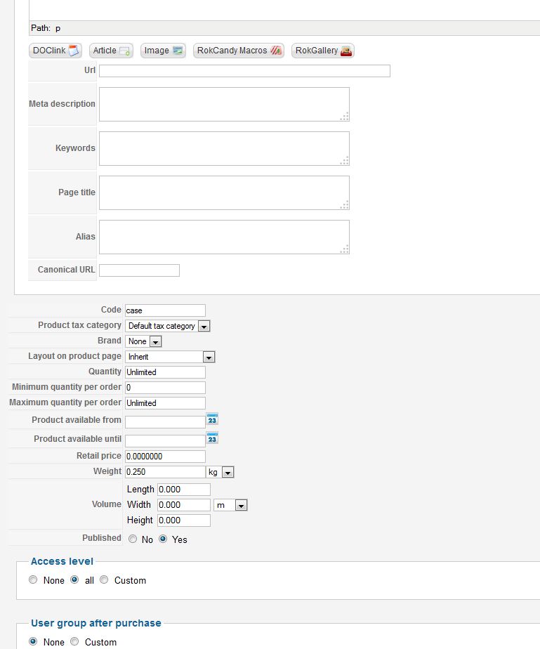

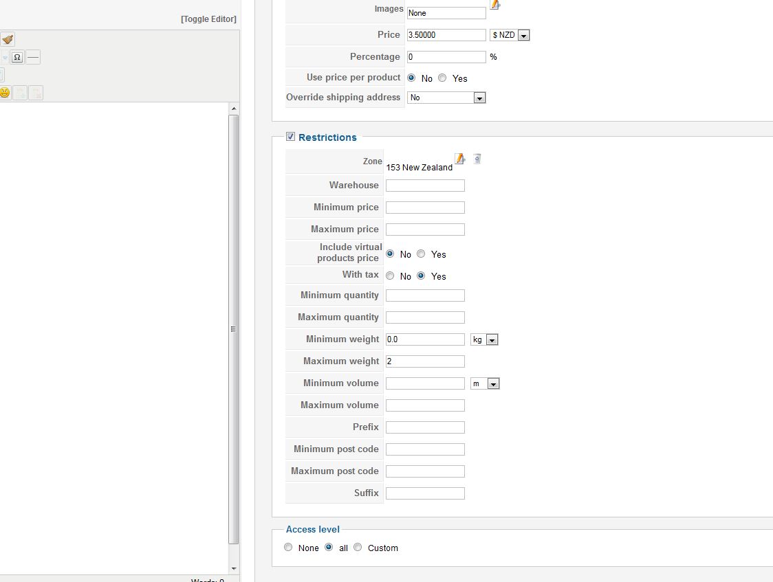

12 years 11 months ago #120773
Attached the screenshots, one of the cheapest shipping item config and one of the lightest product config.

I think that the problem is coming from the fact that you product don't have any volume, can you try it with a volume in you 0.25kg product ? Also are you sure that your shipping address was a New Zealand address ?

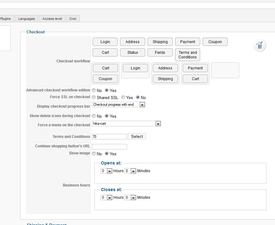

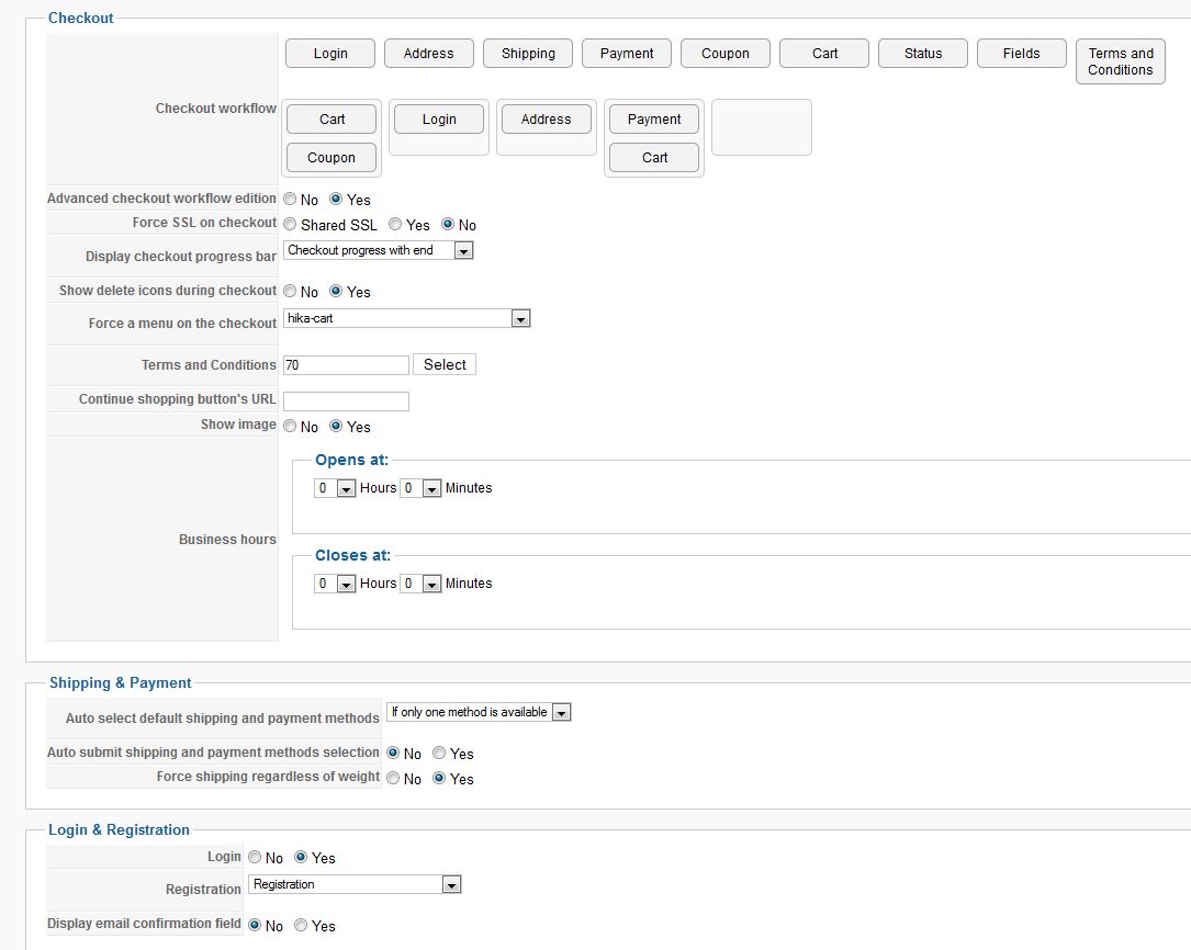

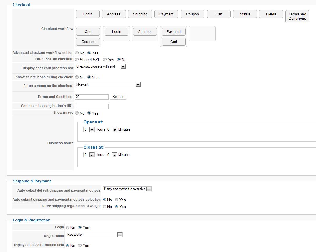

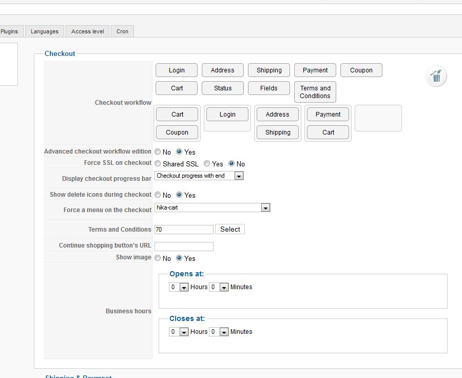

I don't have a full access to your Hikashop configuration, so can you show me how did you configured your "checkout workflow" option through "Hikashop->System->Configuration->Checkout" with some screenshots ?

12 years 11 months ago #121505
I set you as admin so not sure why you have limited access. If you need me to add your email to the login just pm it.
Here's the screen shot :
Last edit: 12 years 11 months ago by ivibes. Reason: wrong atttachment
12 years 11 months ago #121532
Ok, so the problem is probably coming from the fact that you didn't put any "shipping" action through your checkout workflow.

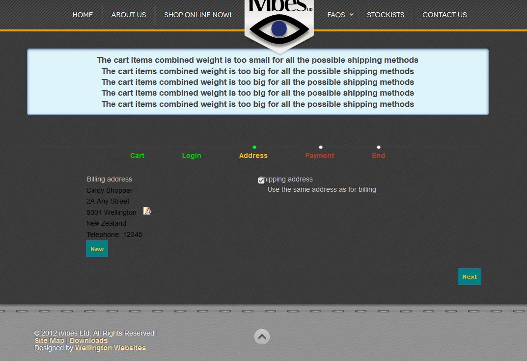

12 years 11 months ago #121656

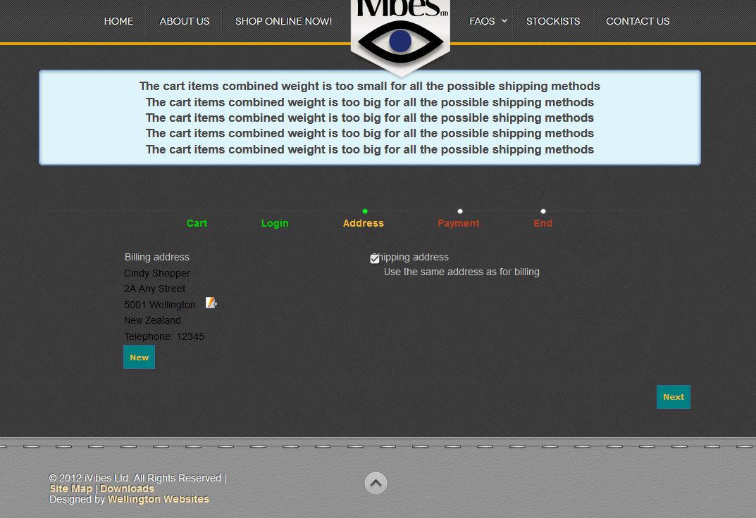

o.k so I added shipping to the shopping cart process (is it in the right place?)
Then I got this while trying to check out:

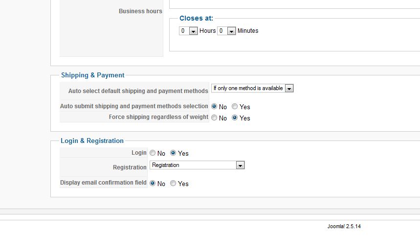

12 years 11 months ago #121661

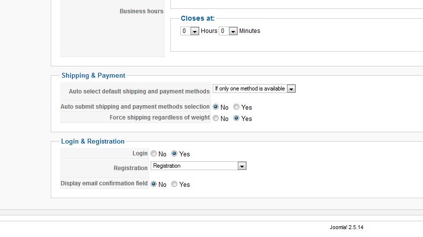

ok, so what I have done is I selected yes for "Auto submit shipping and payment selection" and it seems to be working.
I had to remove the shipping from the checkout process as it drew a blank screen in the process.
I will trial a few more and confirm the problems solved.
Thanks very much for your time!!
12 years 11 months ago #121685
I think that the problem is only coming from your shipping restrictions configuration, so you should just check the weight and dimensions of your orders, and the weight/dimensions restrictions of each shipping methods.
