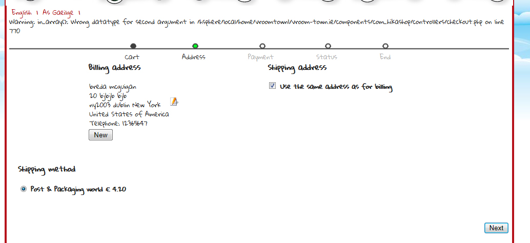

Can you explain what the Address box is for on the Workflow on the attachment? I put it in before shipping so I can ask for their address but nothings comes up on the screen.

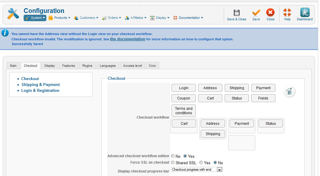

As you can see a notice message is displayed on your screenshot. The address step can't be used without the "login" one.
What you can do is add the login step, and in the checkout options set the login to "No", to havce guest checkout, there is option for that in the checkout options of the latest HikaShop version.

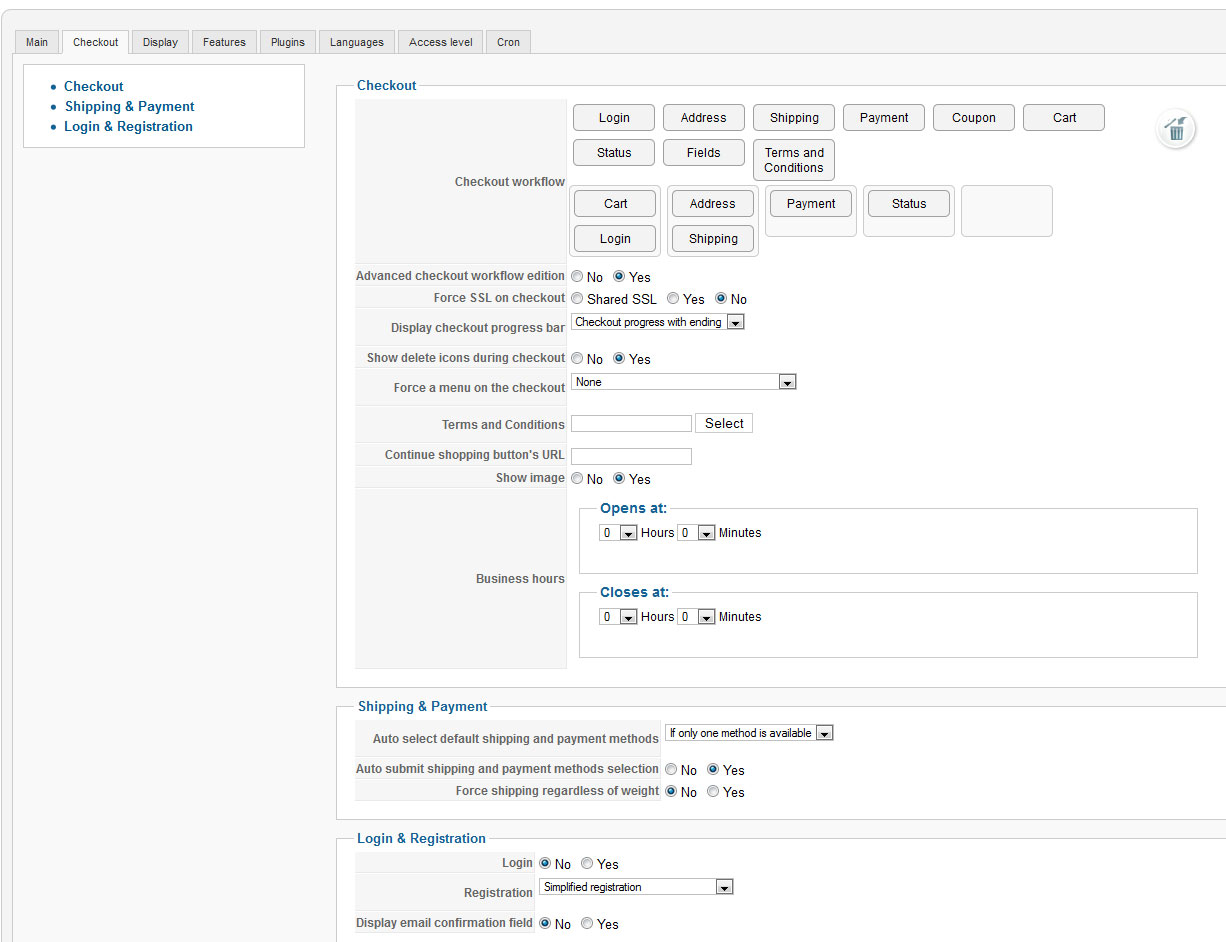

I have upgraded to HikaShop Business: 2.2.1.

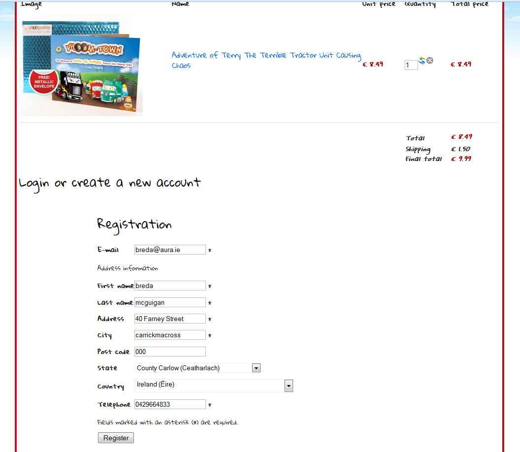

I set the log in as part of the checkout work flow and set the login to No, please see screen shot, but it's stil nto working for me, I can't get past the log in/address part. See 2nd screen, I fil in the address etc and click register and nothing happens. I cleared cached etc.

Xavier made a typo in his answer to you. It's not the login option that you need to set to no but the registration option on the same screen.
