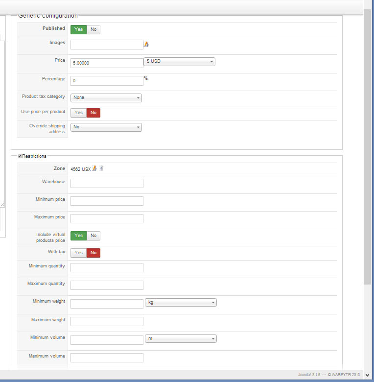

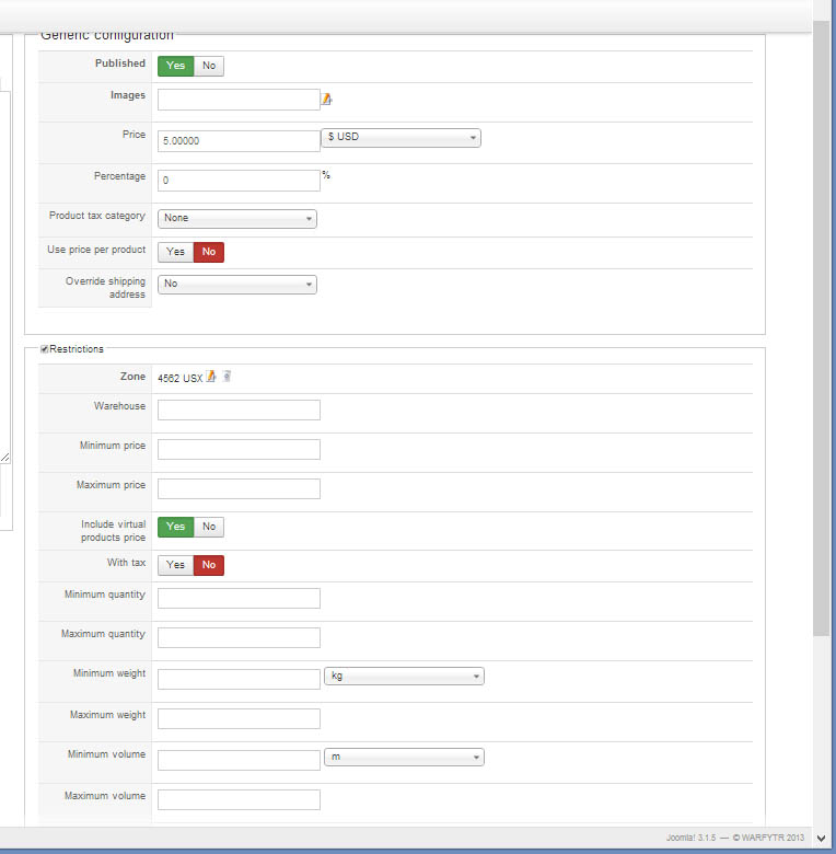

12 years 11 months ago #126964
Hello. I followed the FAQ. I can get the manual shipping to work, but as soon as I add a single zone restriction, it will not work anymore. screen shot should be below. I have tried it on the live site, and on a test site. I get the same problem. I am using Joomla 3 and a yootheme template with their widgetkit enabled. If it would help I can give you the test address and admin info via private message. I hate to ask for help but I can't find anything on this in the forum that has worked for me. The settings that are not in the pic are blank.

12 years 11 months ago #126971
The problem is probably coming from the zone that you are using for your manual shipping zone restriction can you show me some screenshots of how did you configured it ?

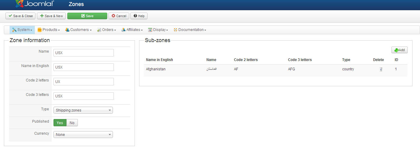

12 years 11 months ago #126983
Here is the zone config screen shot.:

12 years 11 months ago #127160
I've done some tests through your website :
1. Your manual shipping method wasn't showing because you didn't published it
2. Regarding the UPS shipping method, you should configure it before using it.

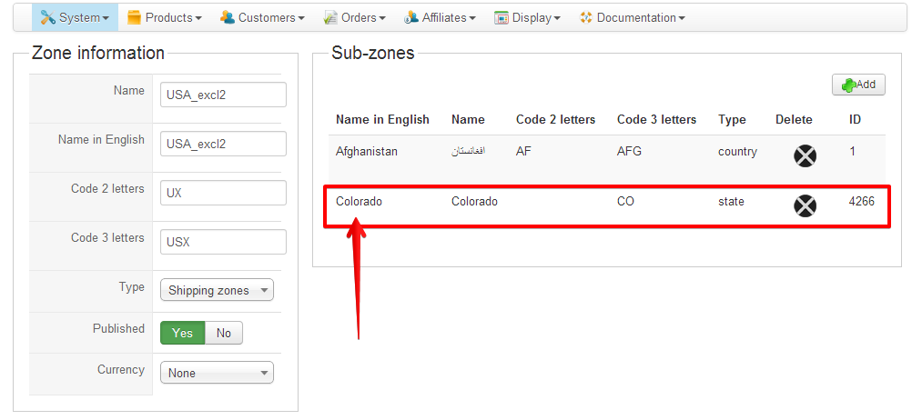

12 years 11 months ago #127333
If you want to allow shipping to USA or just Colorado you'll just have to add the state to your shipping zone, I added the state of Colorado and it worked fine now your shipping method only show when your customer have a shipping address from Afghanistan or from the state of Colorado.

  • Posts: 15
12 years 11 months ago #127335
Ah. I get it now. Thank you so much for your help. I had been trying to use the shipping zones as a place you could NOT ship to. Not as the places you could ONLY ship to.
