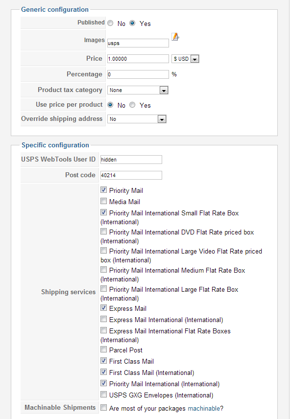

USPS error: -2147219498 Please enter a valid ZIP Code for the sender.
Failed to obtain shipping quotes.
No shipping method found
I get the following error message above. The "HikaShop USPS shipping plugin" is filled out correctly far as I know
I don't see anywhere to put a zip code
Were is hikashop looking for the zip?
12 years 11 months ago #128215
Can you show me screeshots of how did you configured your USPS shipping method ? Then I'll be able to reproduce the issue on my end, with the same zip code through the "Post code" option of the USPS shipping method.

12 years 8 months ago #138761
For "Post code" I had the USPS passcode instead of the zip code
