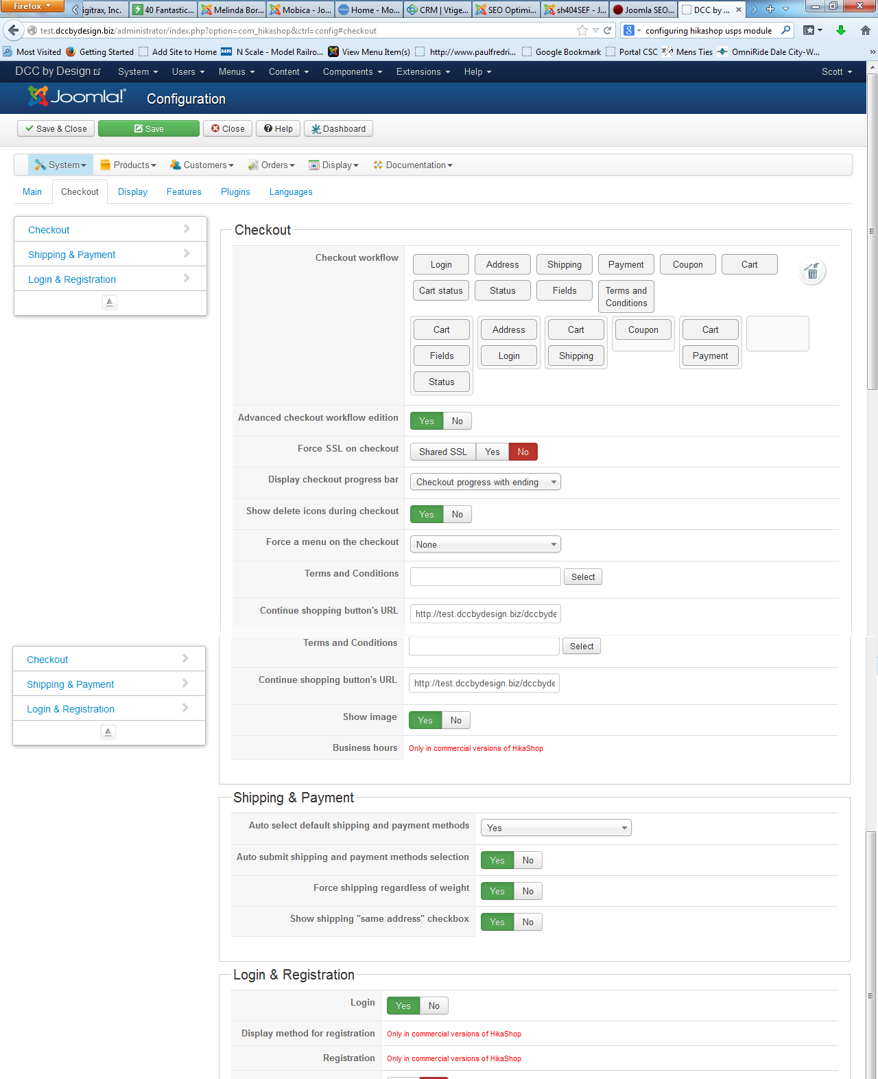

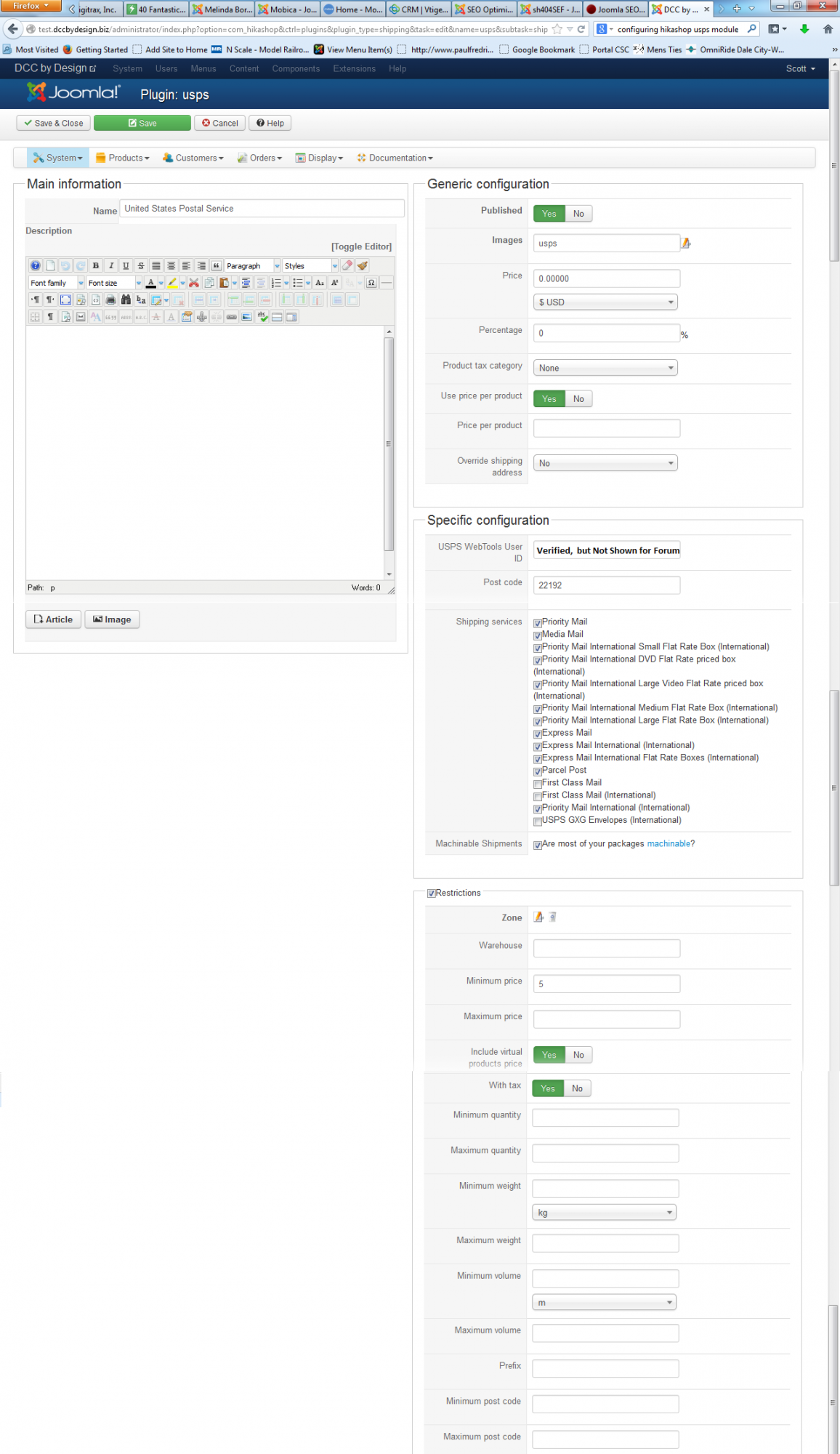

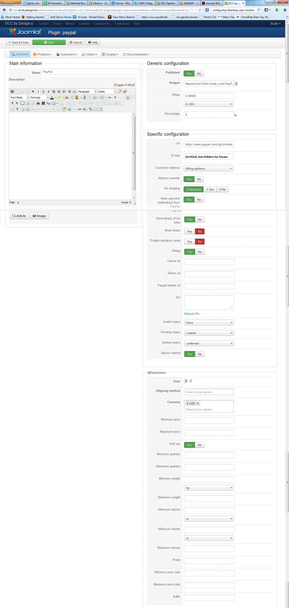

1. Did you followed the "shipping methods" section of the FAQ ? if not doing it will probably help you :).

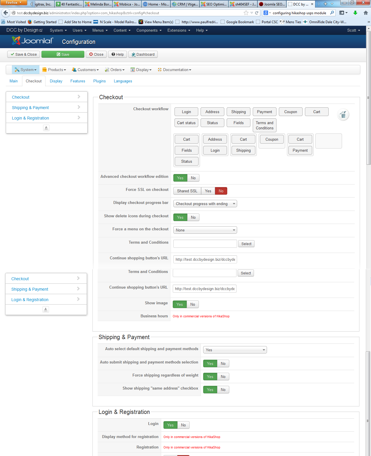

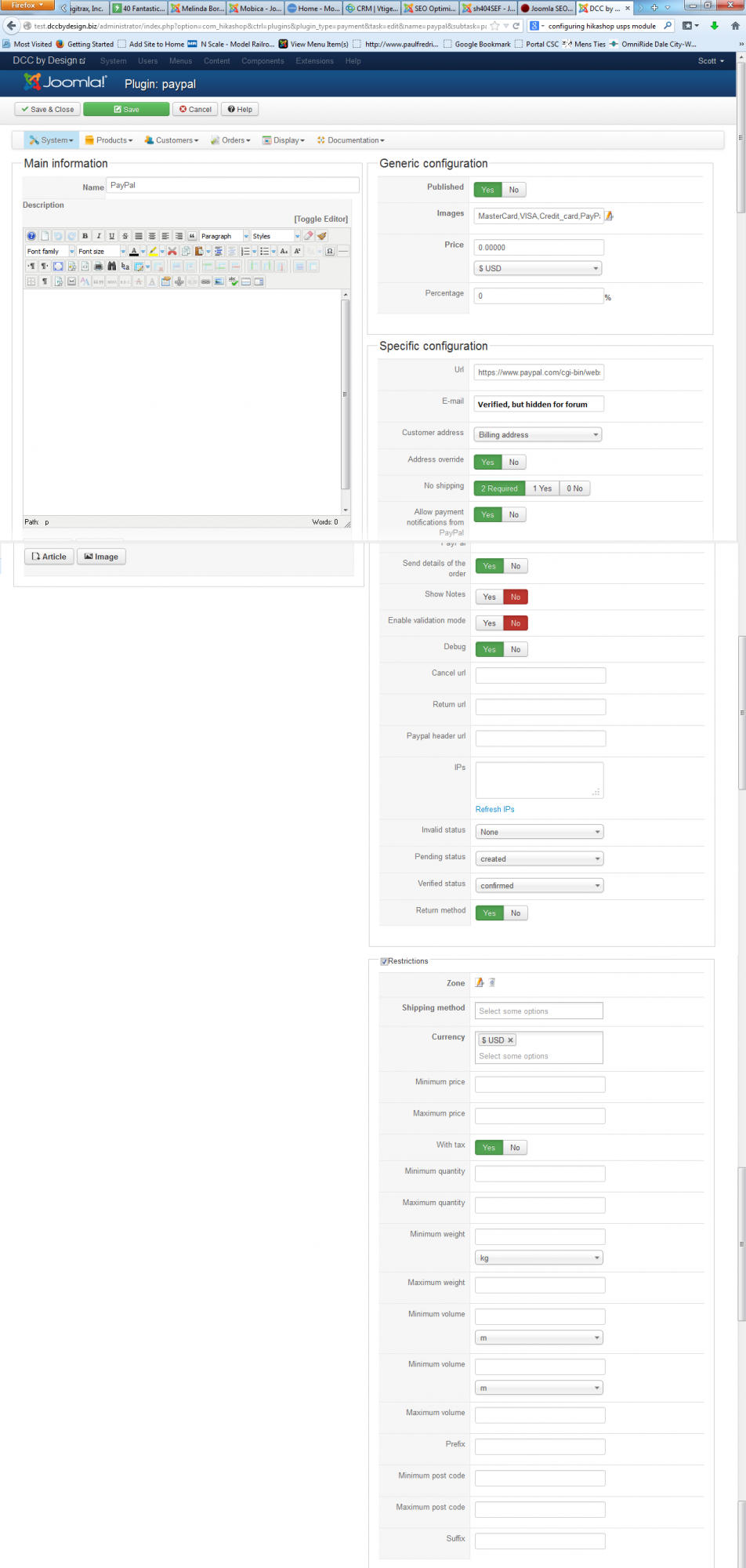

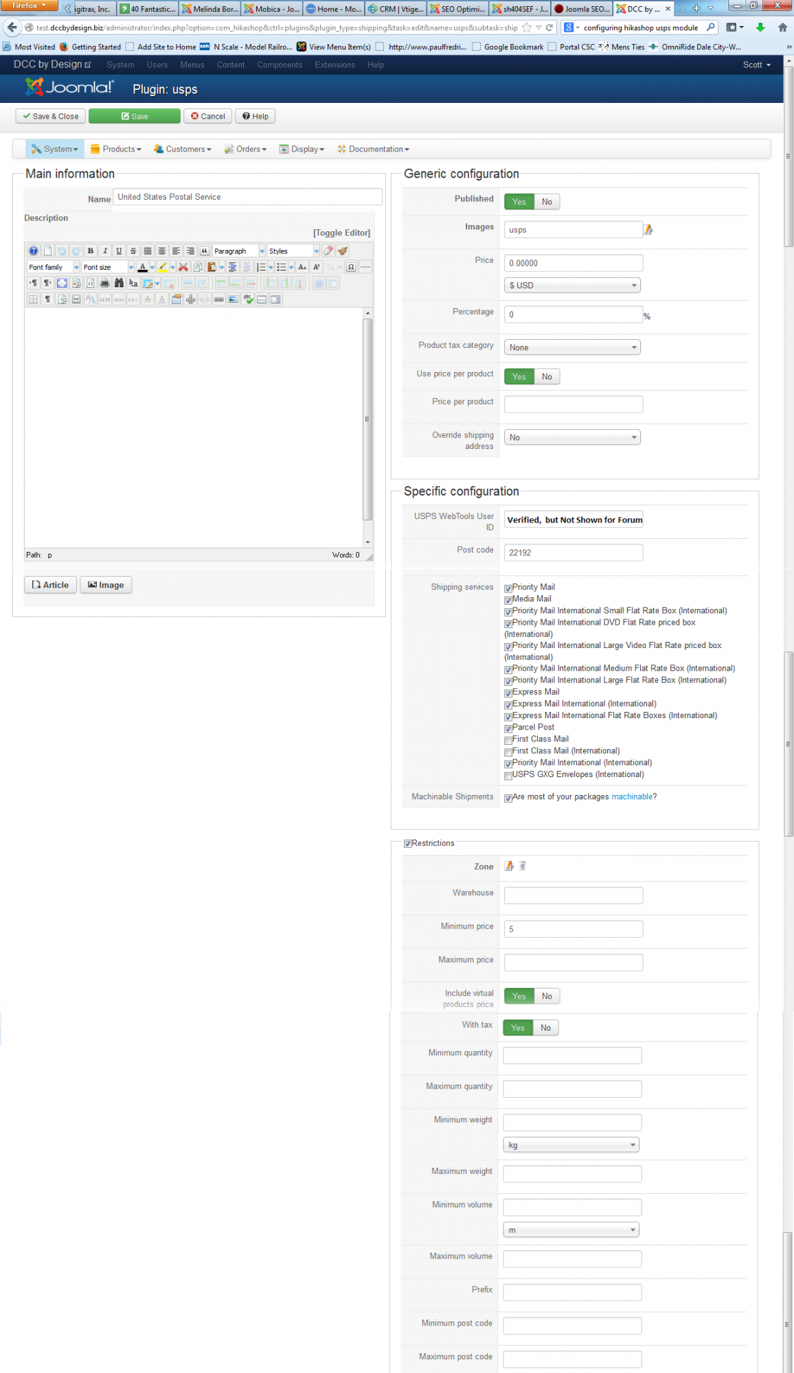

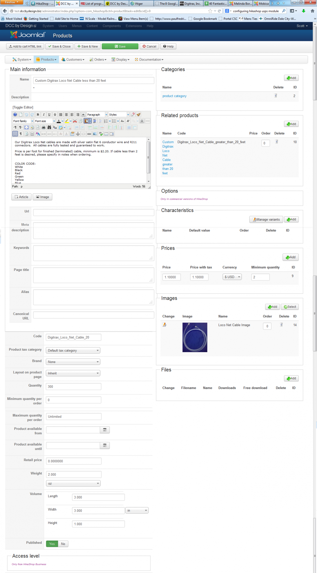

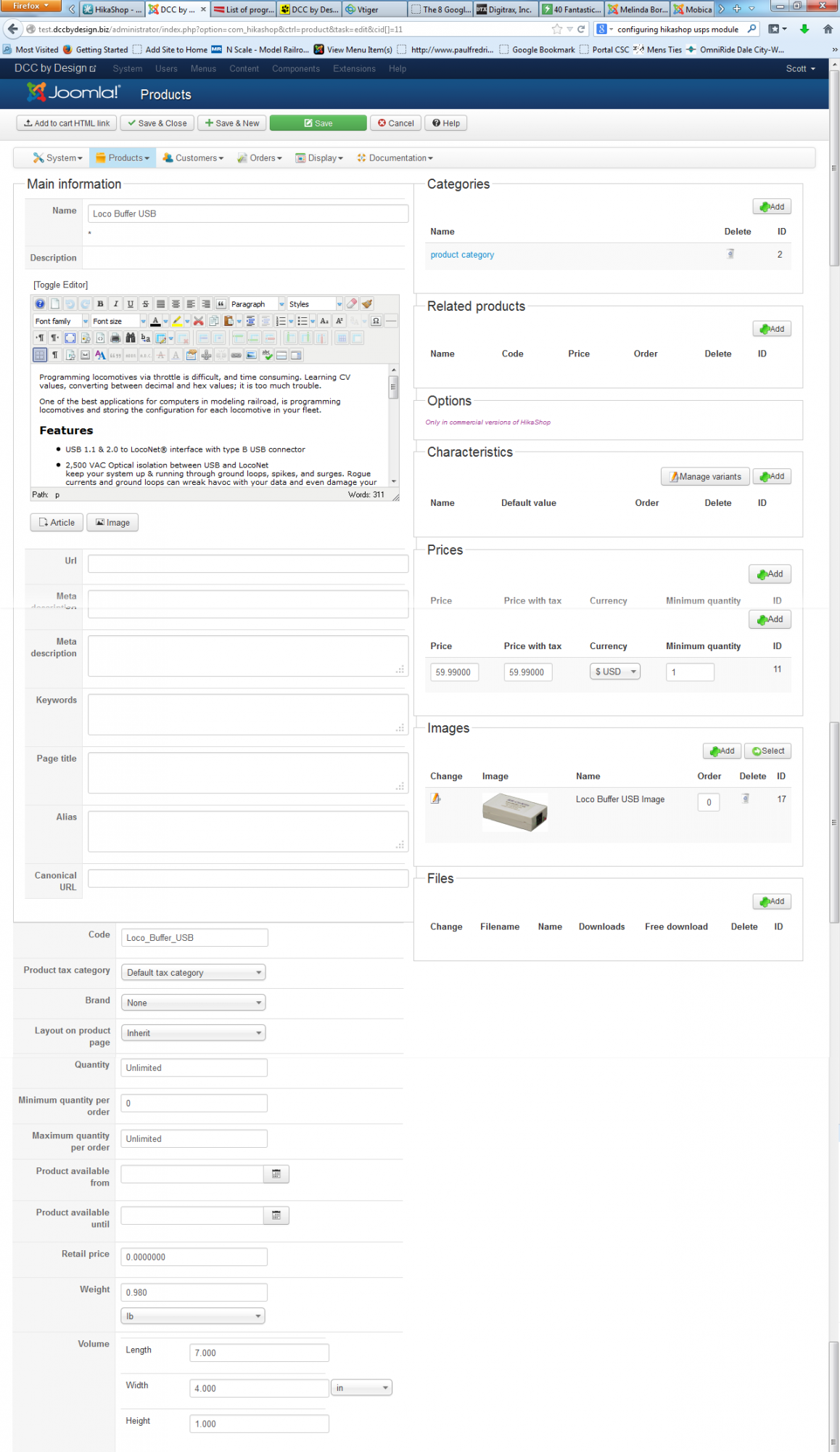

2. Can you show me how did you configured through some screenshots :
- Your USPS shipping method
- The products that you are using through your tests
- Your checkout workflow through "Hikashop->System->Configuration->Checkout"
- Your Paypal payment method
Thanks :).
Last edit: 12 years 11 months ago by Mohamed Thelji.
  • Posts: 4
12 years 11 months ago #129043
Yes I did try the Shipping FAQs, wish that had worked.

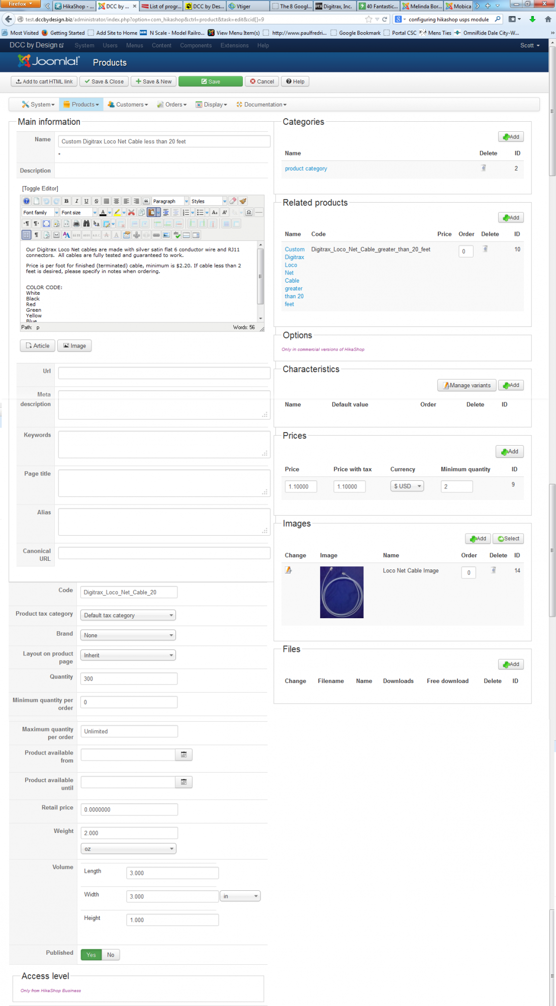

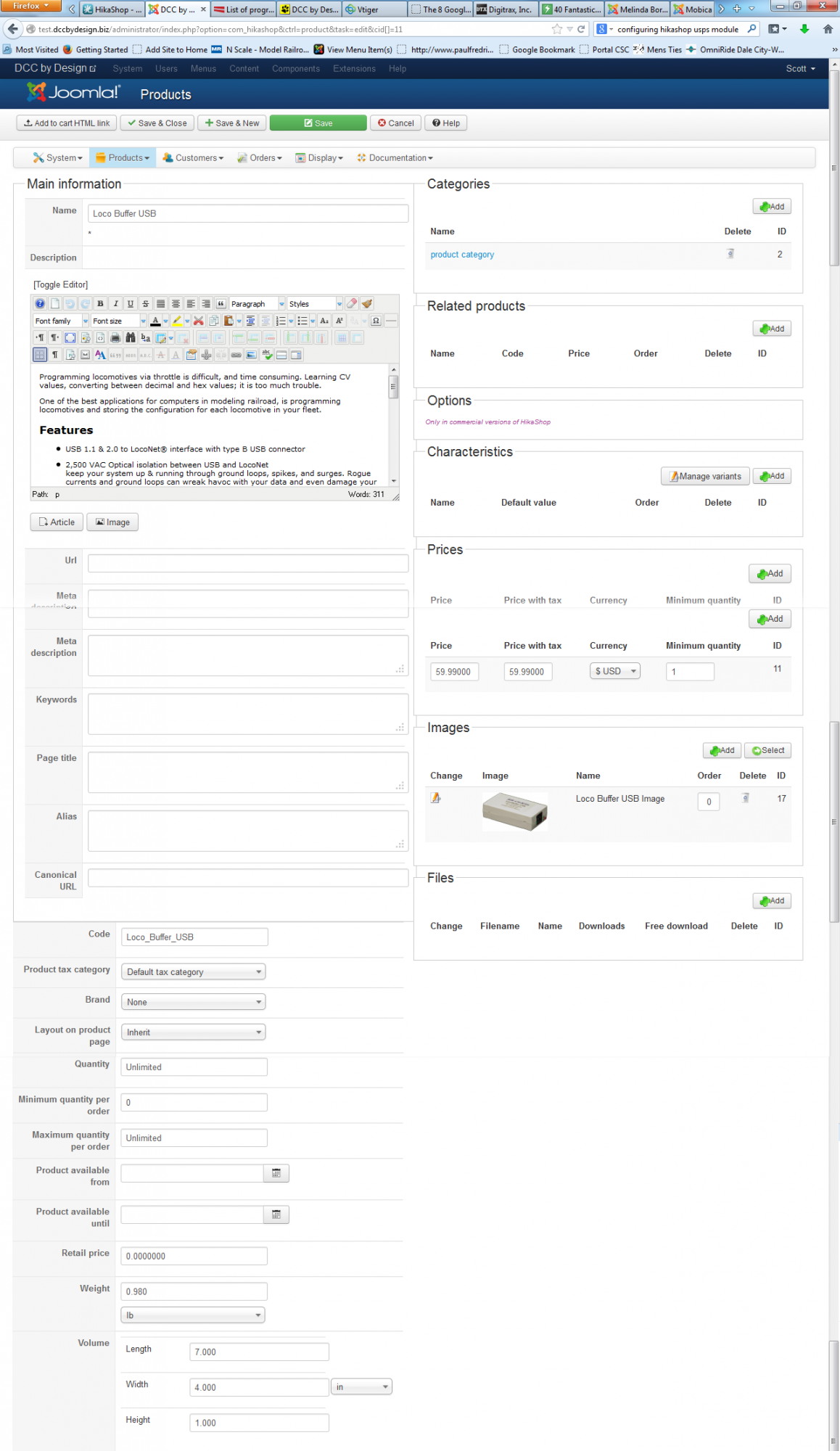

Attached are screen shots as request for the workflow, usps module config., paypal config., and two products that do not work properly. Site is test.dccbydesign.biz
Thanks for your help!
12 years 11 months ago #129080
I've done some tests with some products which have the same weight/dimensions as yourLoco Buffer USB product and it worked fine, can you tell me what was the delivery address that you used during your tests ? also can you try it without the minimum price value ? :).

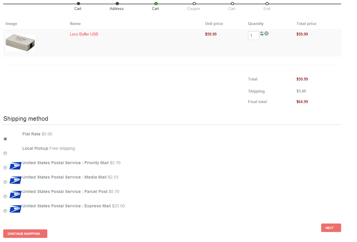

It's working fine on my end, can you give me a temporary back-end access through a private message for testing purpose so that I can found out from where the problem is coming from ?
12 years 10 months ago #129343
The problem was coming from your USPS WebTools User ID, I tested it with mine, and it was working fine. You should then directly ask USPS about your USPS WebTools User ID.
