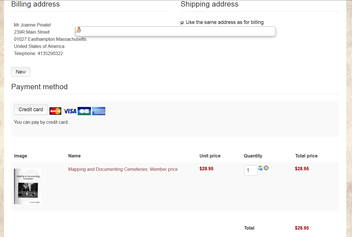

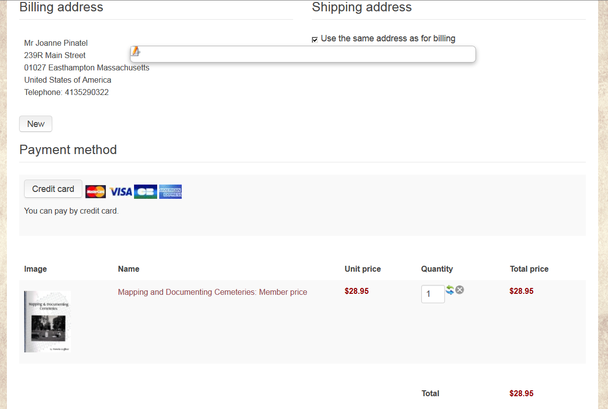

2. (See screen shot attached) The edit address icon floats above the Checkout page in a modal window -- I'm not sure why.

2. You have to change ".modal" to "div.modal" in the bootstrap.css file
