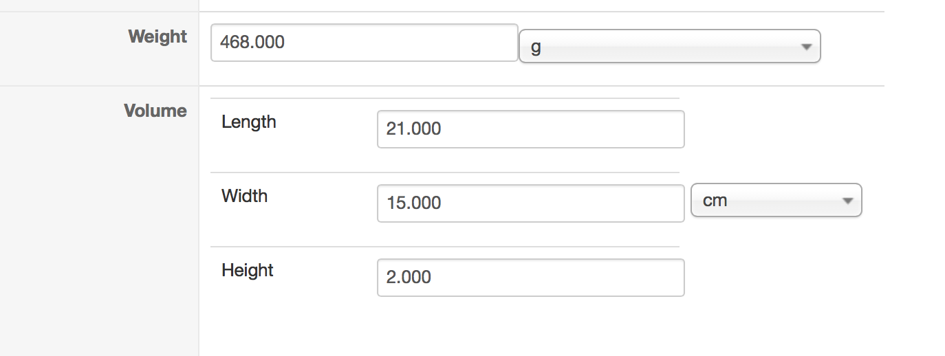

I have setup the weight and dimensions (see screenshot 1)

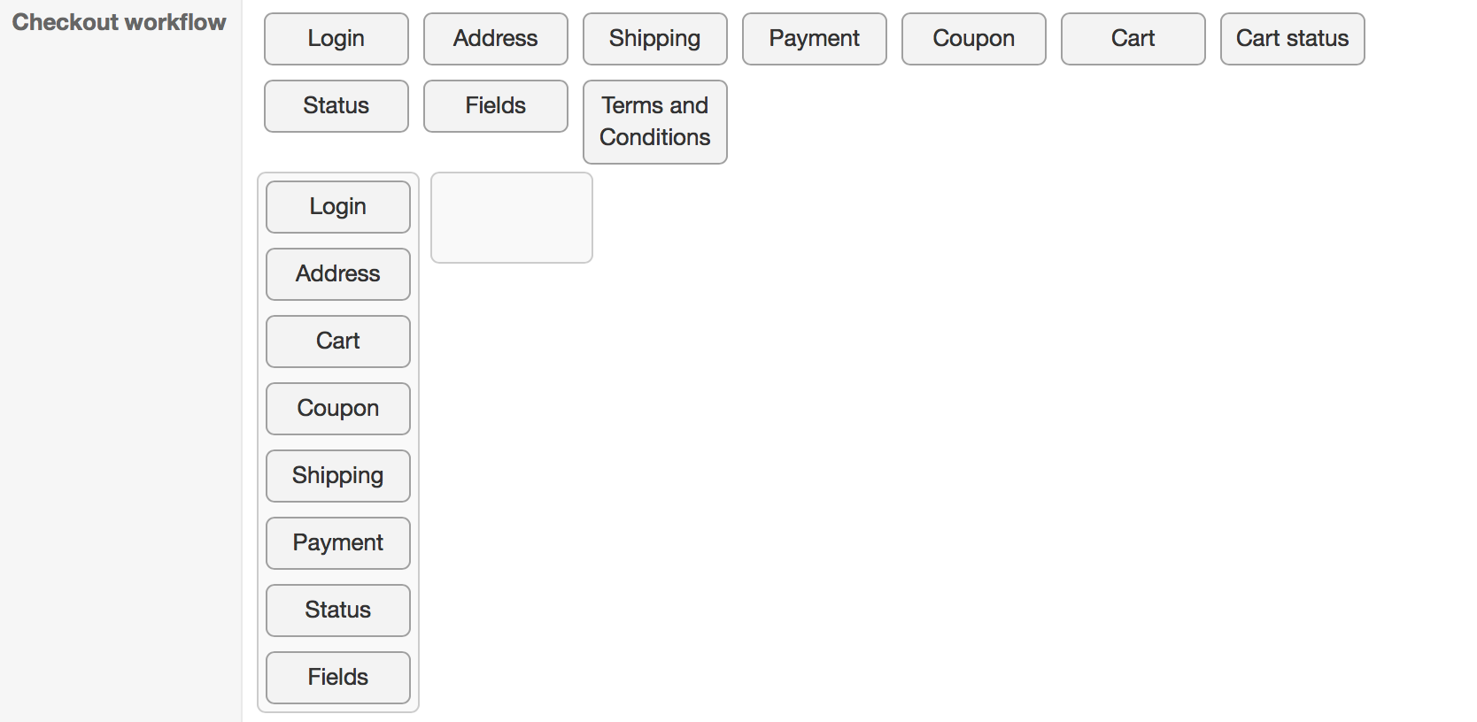

Attached a screenshot of the Checkout Workflow (2)

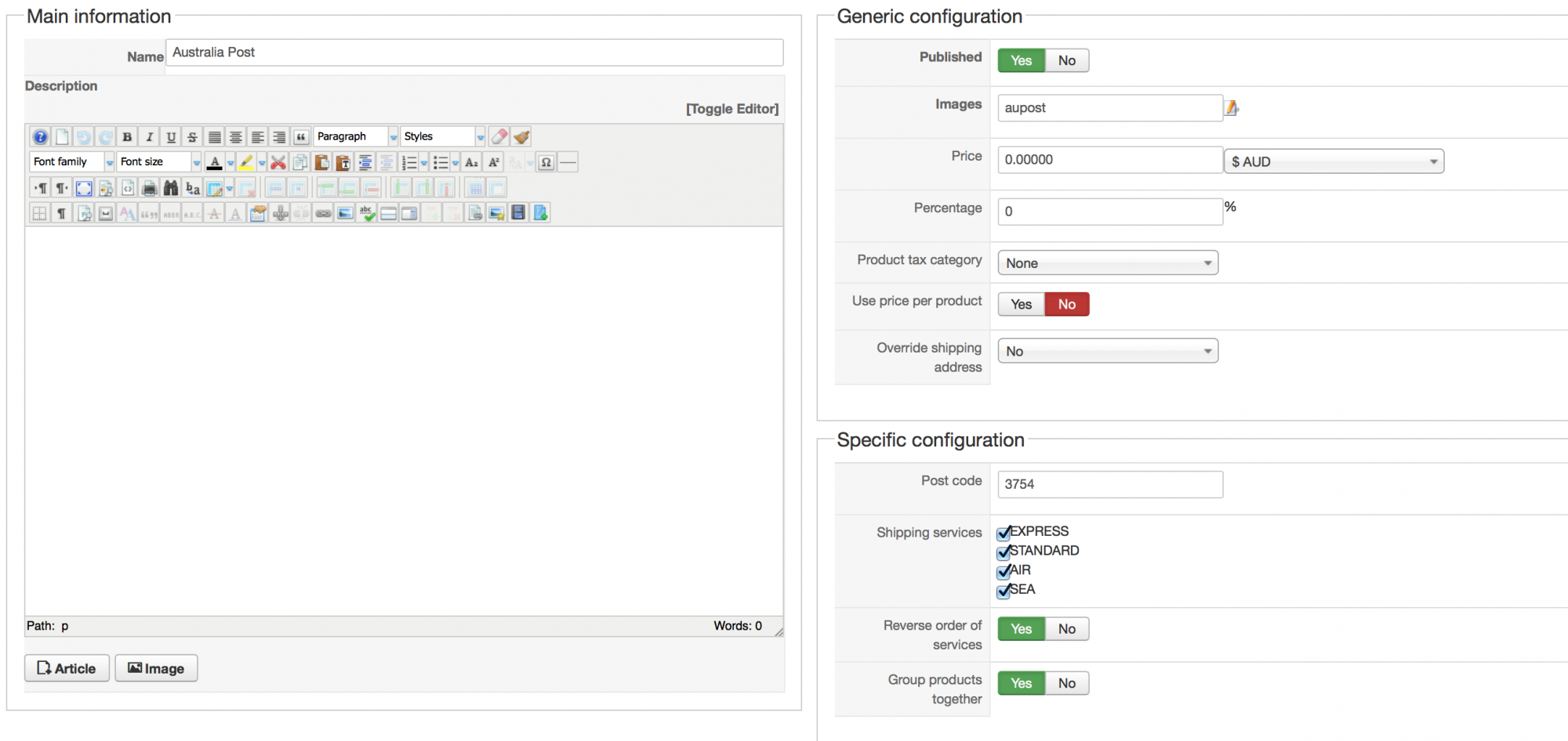

Attached a screenshot of the only plugin enabled for shipping - Australia Post (3)

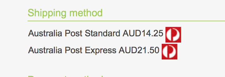

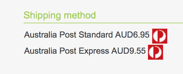

The different shipping methods that are listed can not be selected. Screenshot attached.

12 years 9 months ago #135743
I've done some tests, and it seems like the problem is coming from this CSS property of your "/media/com_hikashop/css/frontend_default.css[/i]" file :
.hika-radio input[type="radio"] {
display: none;
You'll just have to remove it.
