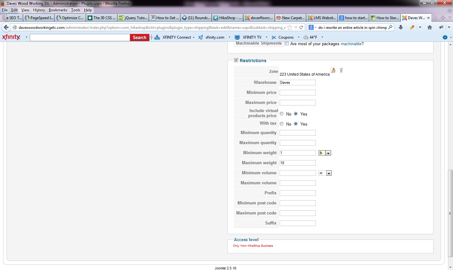

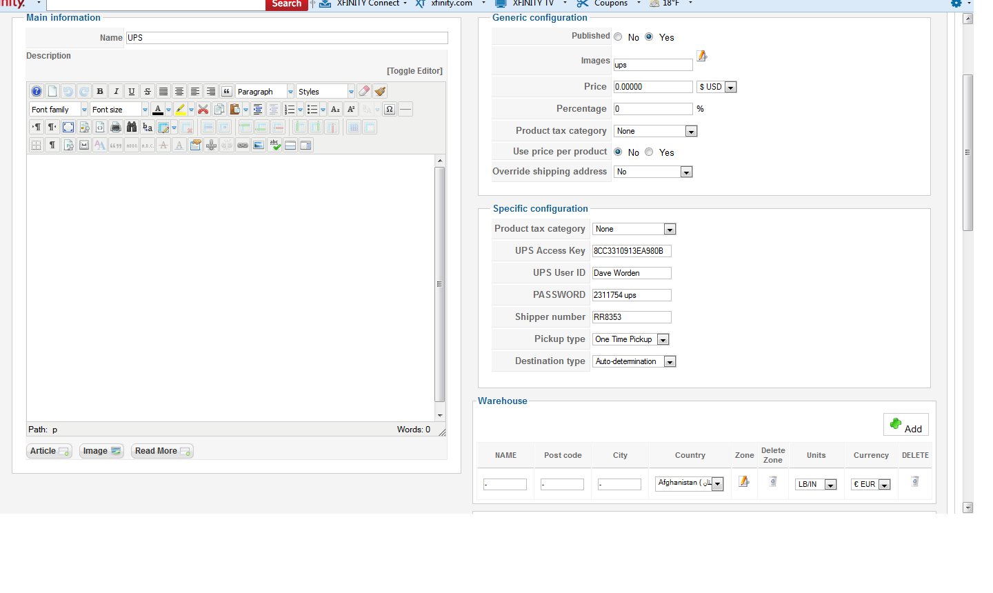

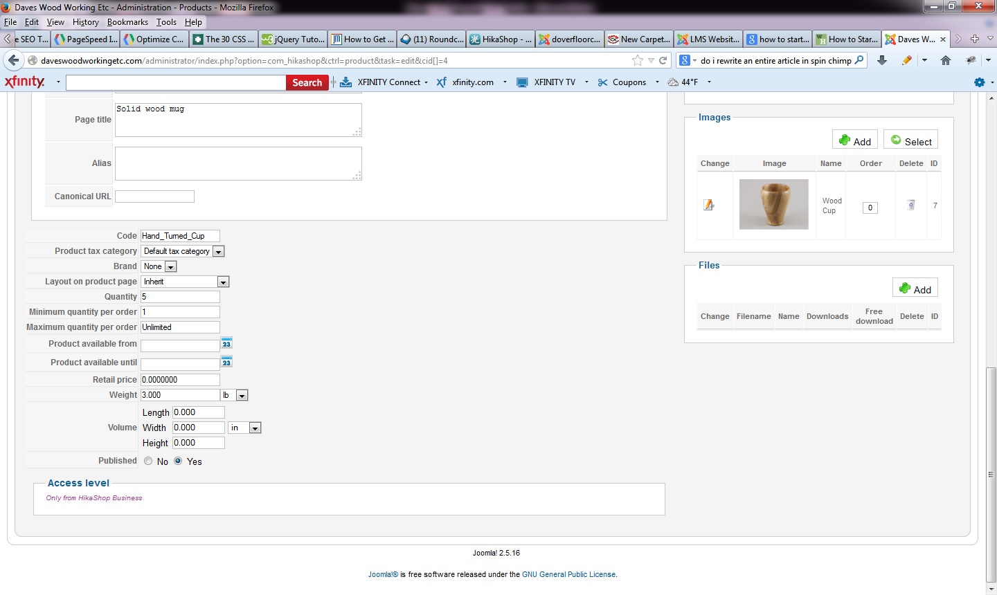

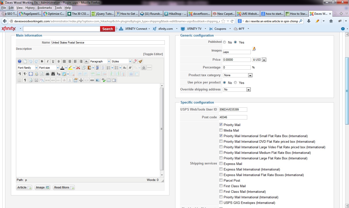

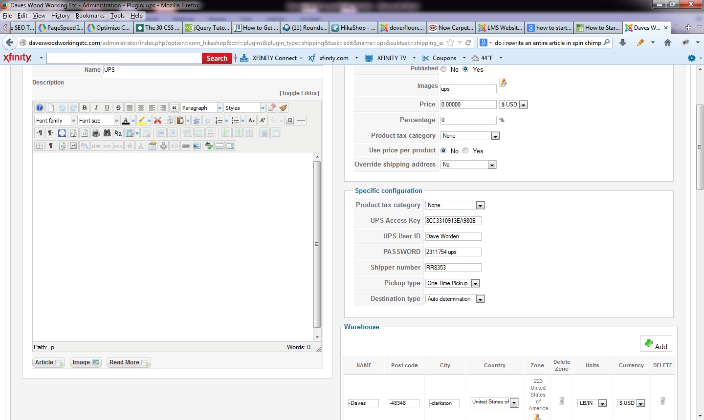

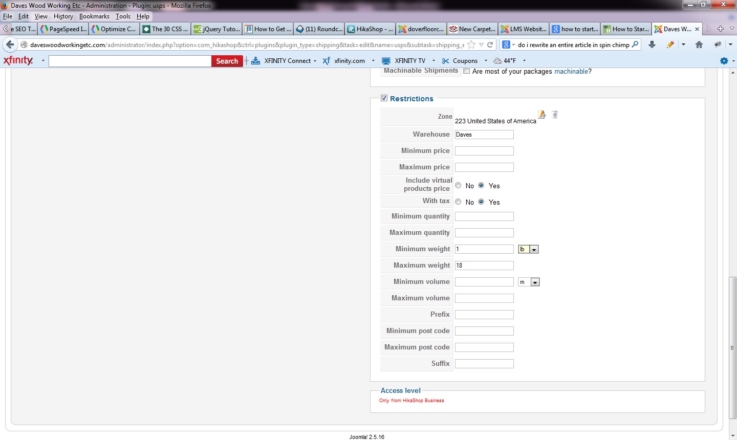

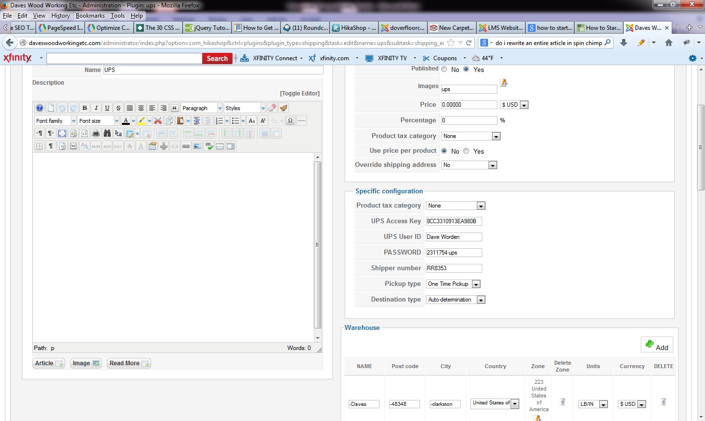

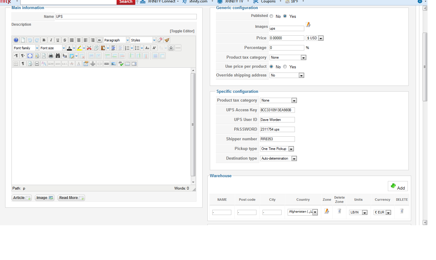

I've read the faq and read as many forum responses I could but couldn't find the answer to why when I test buy a product I get this error message: The cart items combined weight is too small for all the possible shipping methods. I've configured and enabled a UPS shipping method and an USPS shipping method. I gave them weight restrictions that fell within the parameters of the product I am trying to buy (minimum weight 1 lb, maximum weight 19 lbs) and no weight restrictions (the product I'm trying to buy weighs 3lbs). I get the error message everytime. Please help. Thanks.

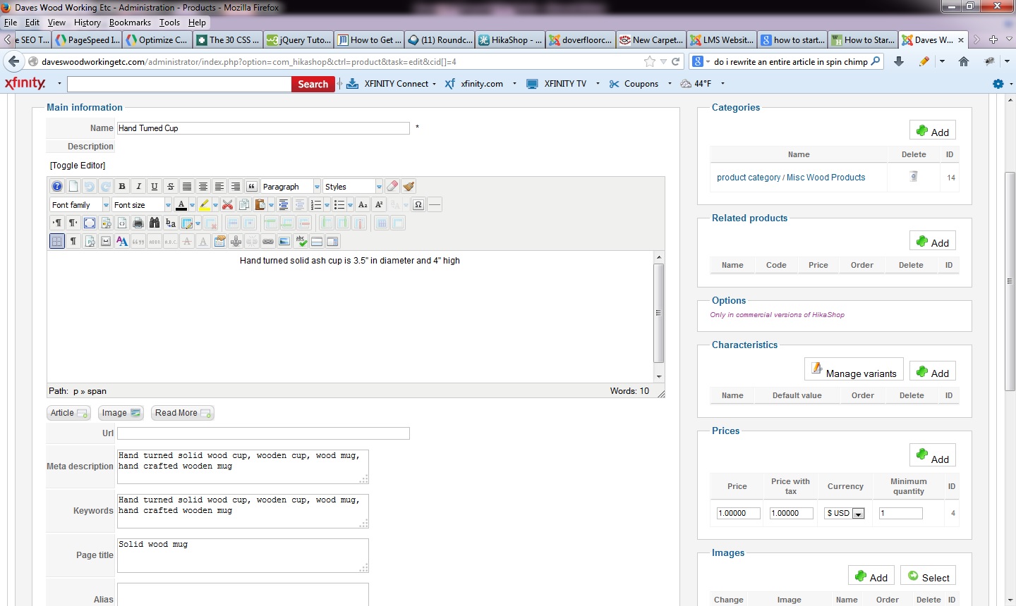

12 years 9 months ago #133464

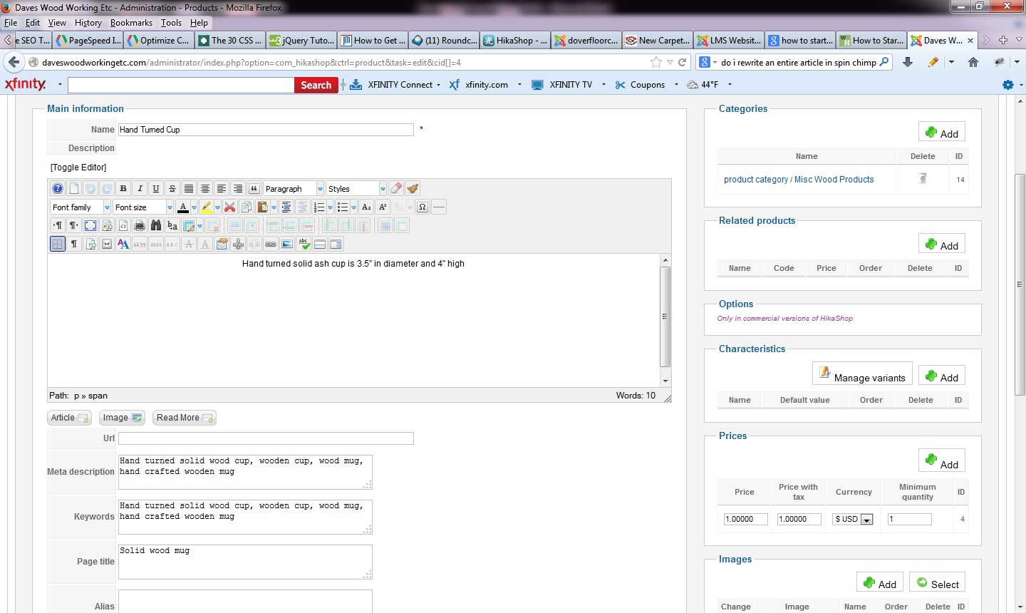

Can you show me how did you configured your :
- shipping methods configuration page
- product configuration page.
  • Posts: 74
  • Hikashop Essential

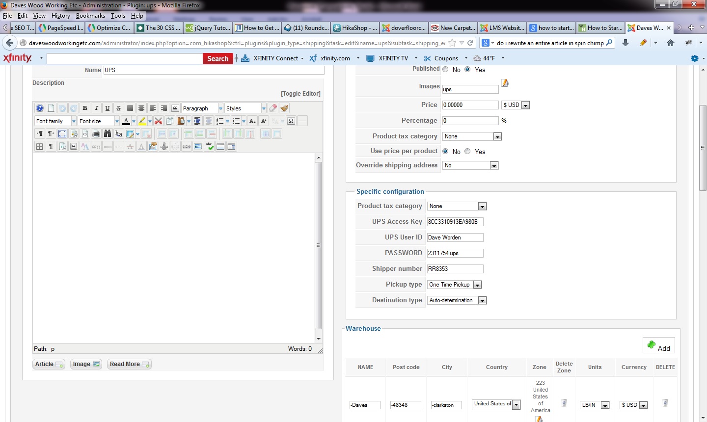

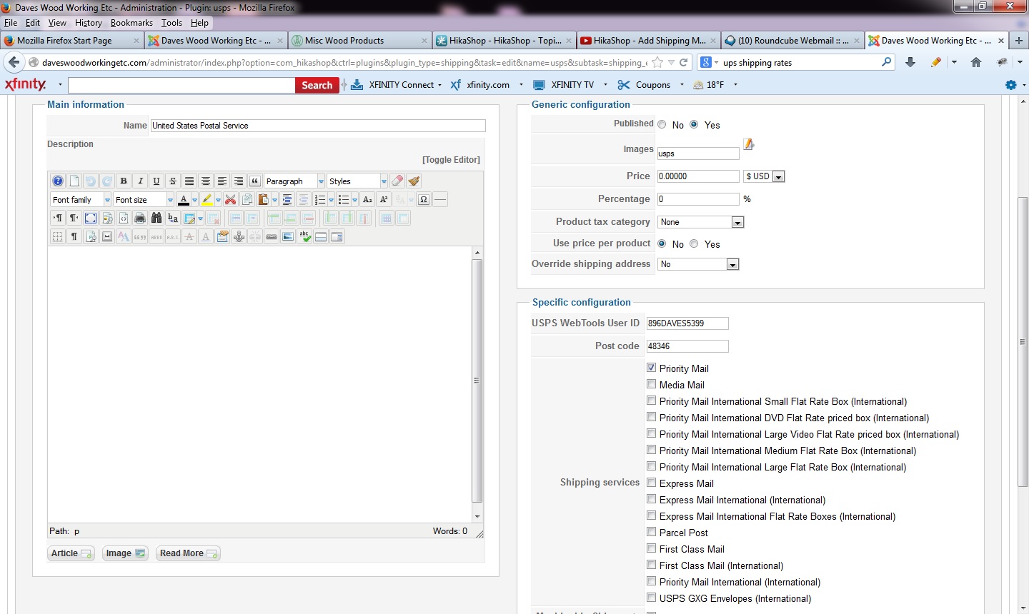

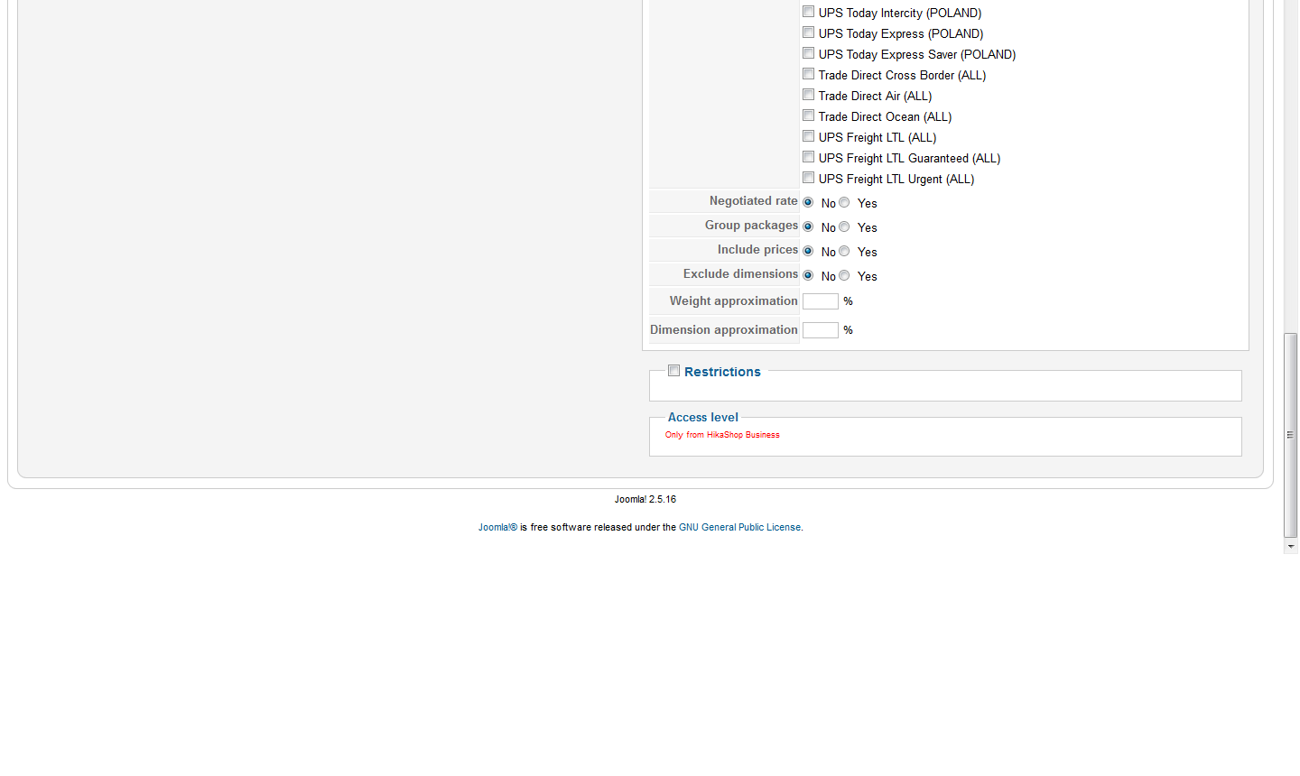

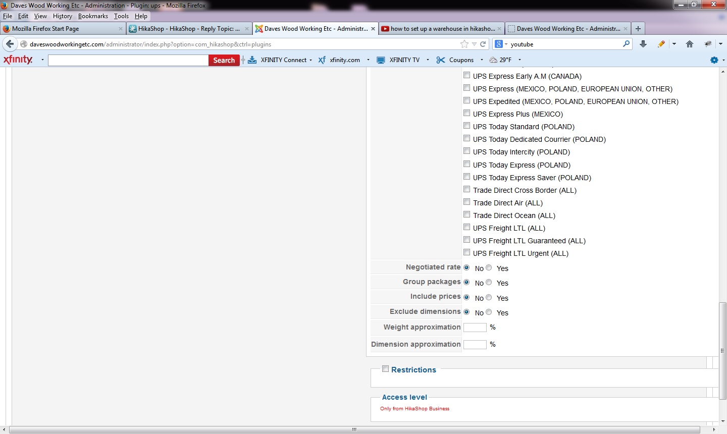

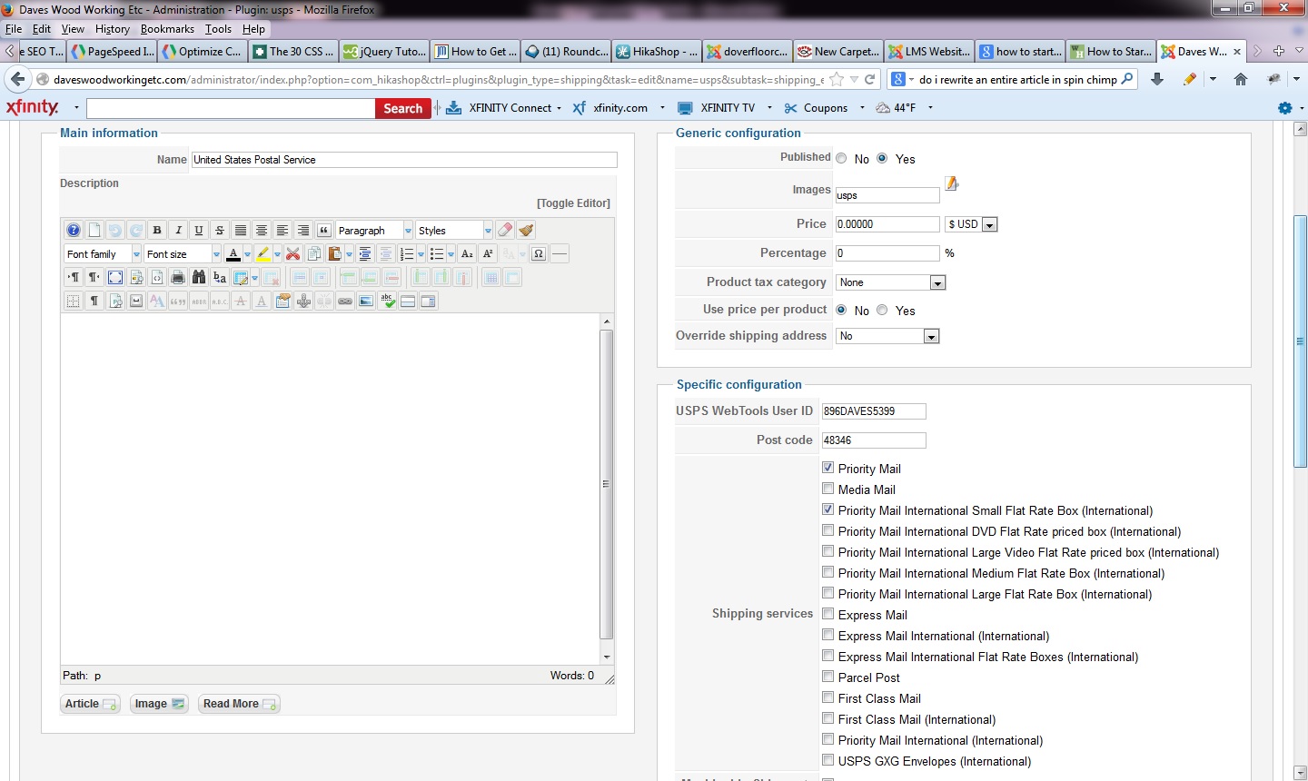

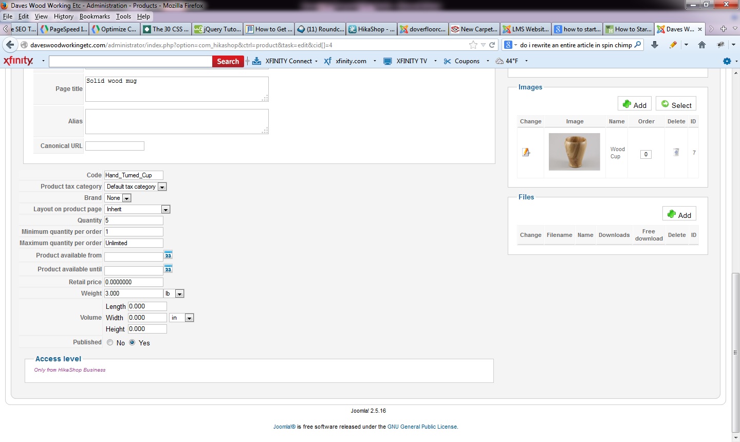

12 years 9 months ago #133573
Not sure how you would like me to do this so I've attached some files. Thanks for your help.

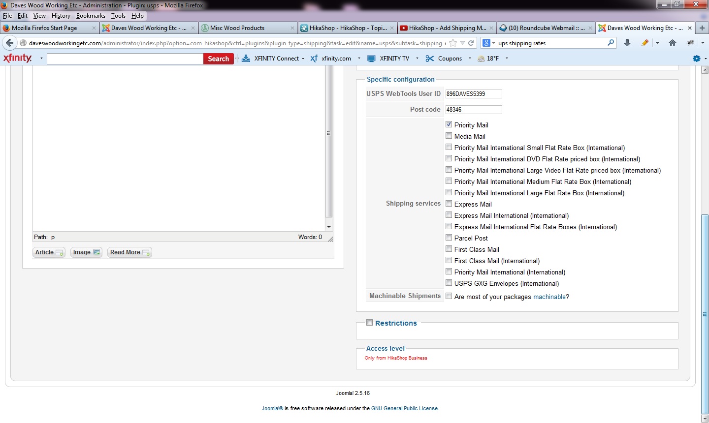

12 years 9 months ago #133746

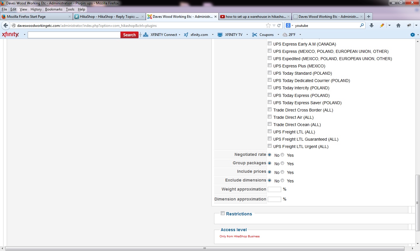

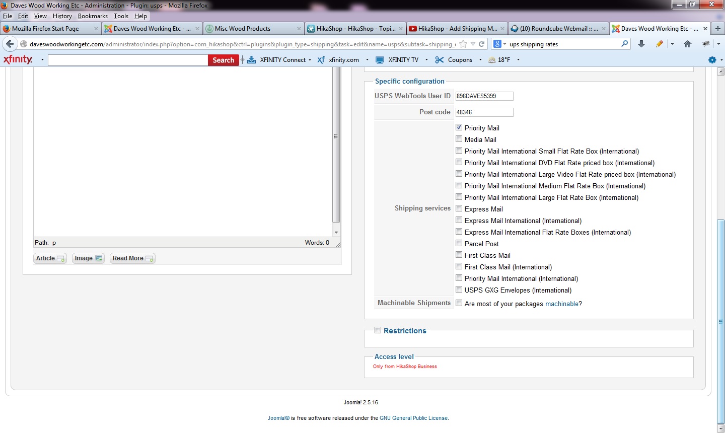

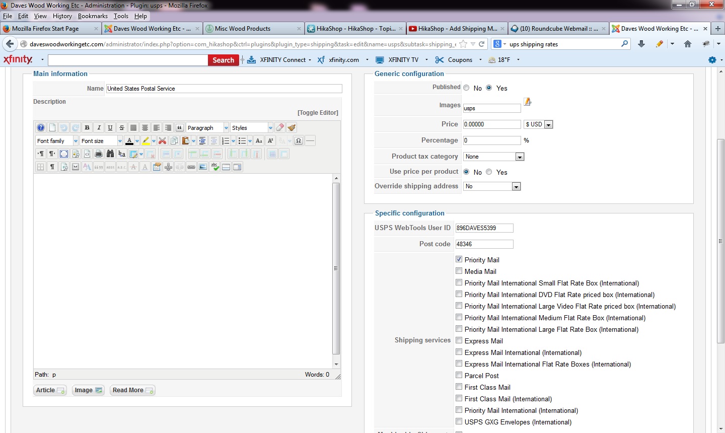

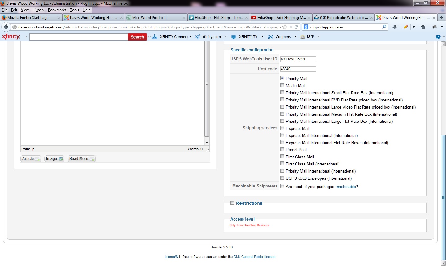

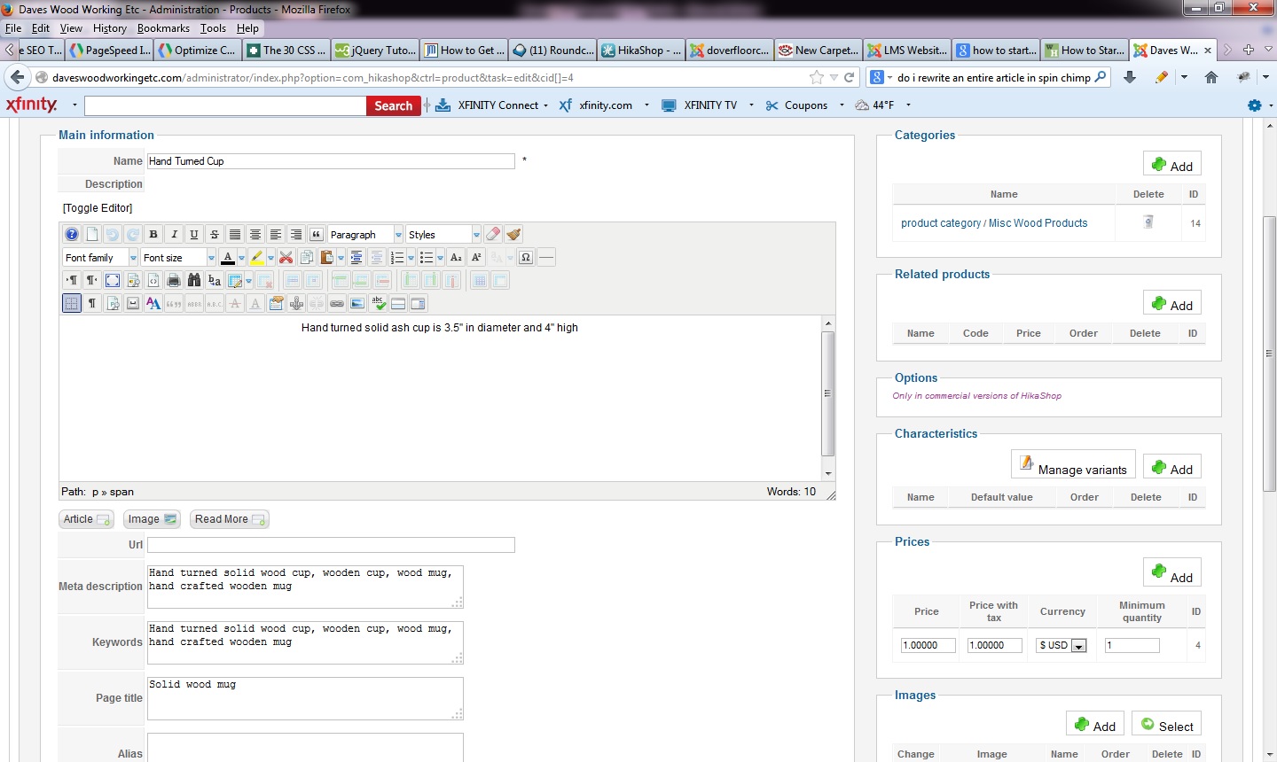

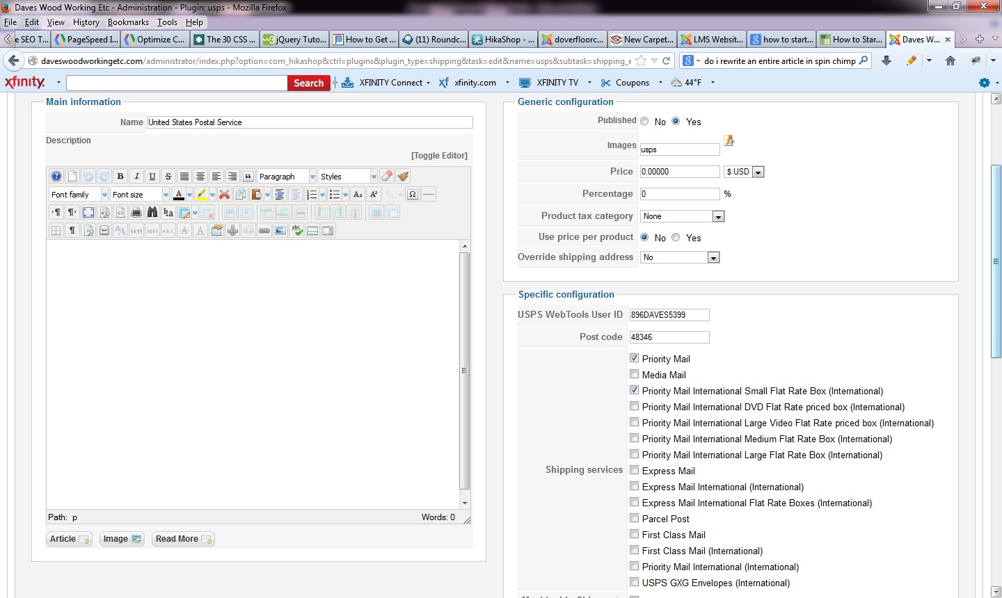

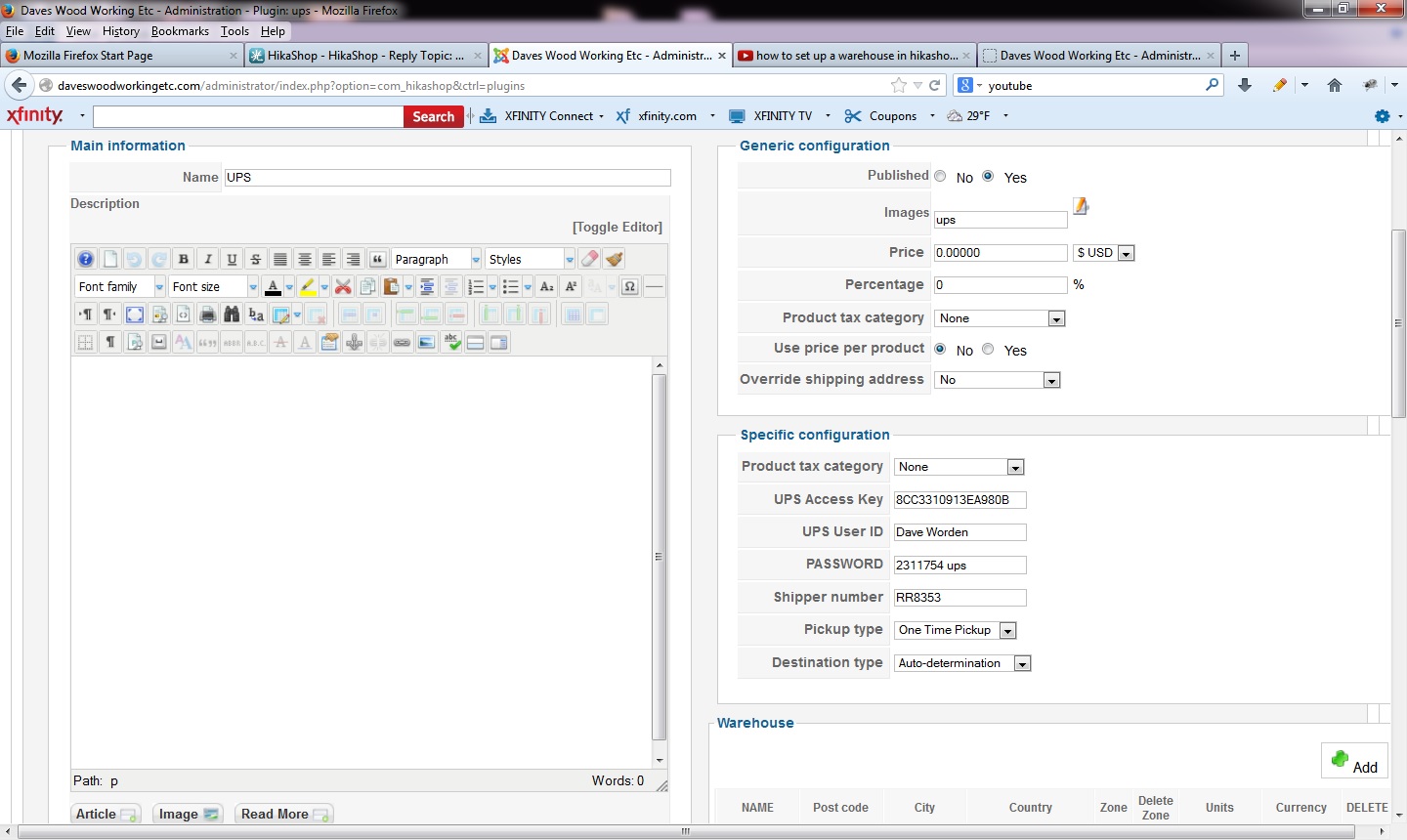

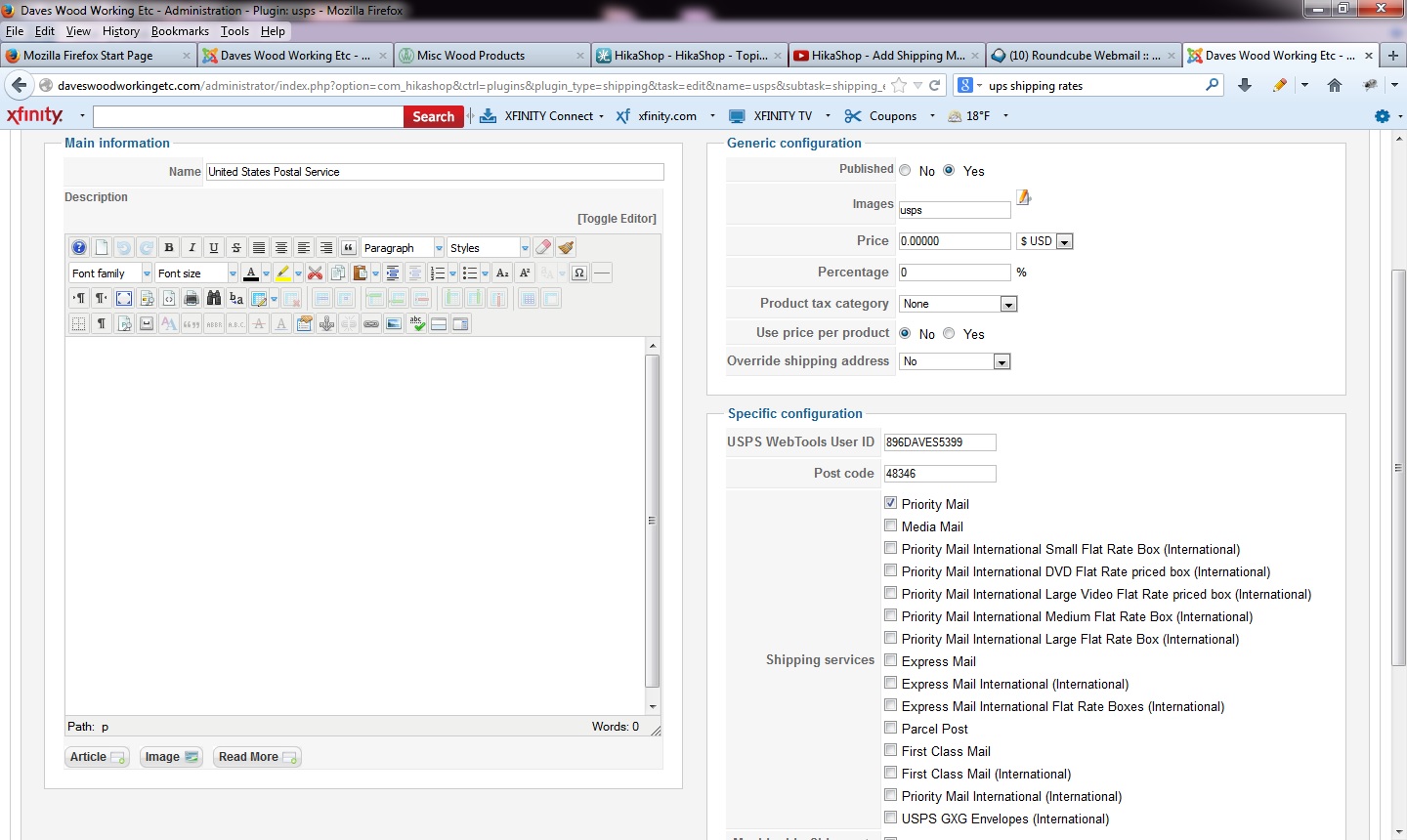

You have a lot of issues in your screenshots.
First, in the USPS plugin, you should leave the warehouse field empty.
Then, in the UPS plugin, you should remove the dash at the beginning of the name, city and post code fields.

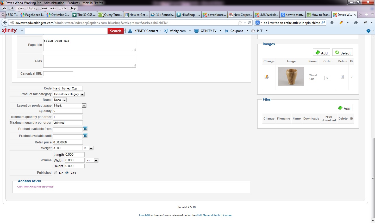

Finally, in your products, you should also configure dimensions.

Yes they query the USPS/UPS servers.

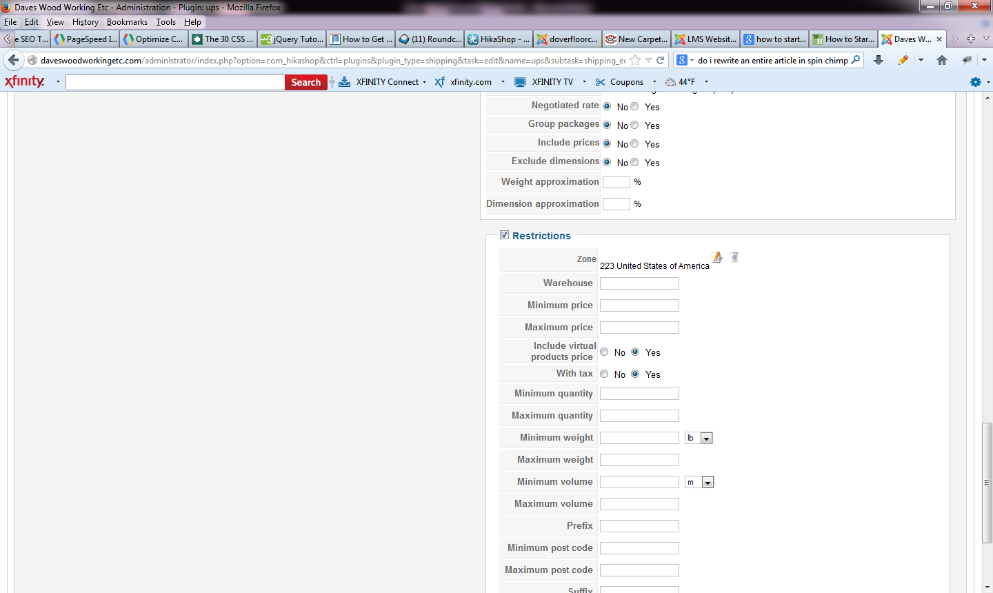

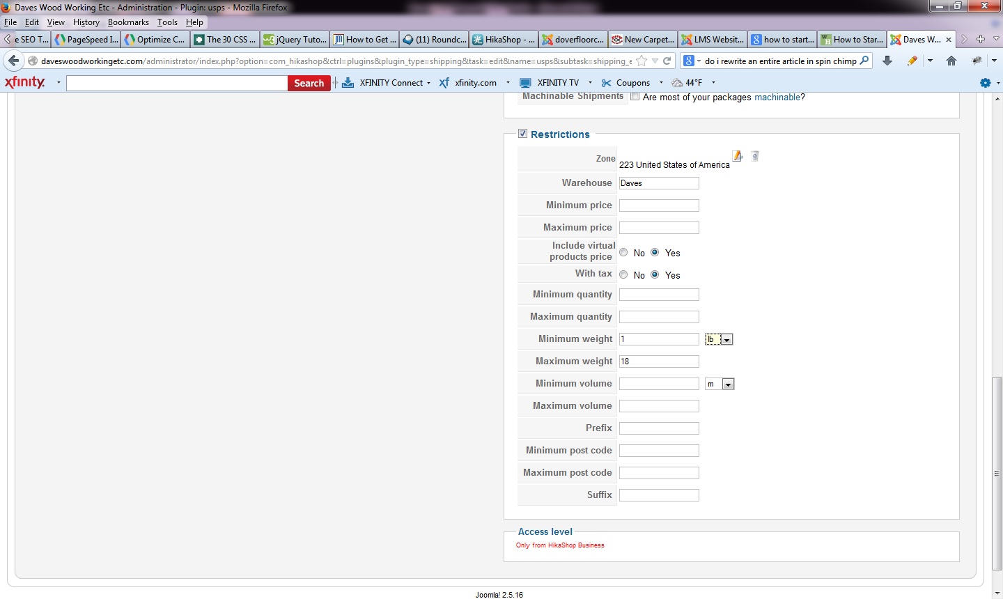

But if you set min and max weight in the restrictions area of these shipping methods, they first make sure that the total weight of the products in the cart are within that range. If you get that error, it means that it's not the case. So either make sure that the total weight of the products in your cart is within 1 and 18lbs or remove these weight restrictions and it should work.

Thanks Nicolas. I had no restrictions before and it didn't work. I put in restrictions and made my weight fall within those parameters and it still didn't work. I just took off the restrictions on a UPS and USPS shipping methods and I still get the error code. Now in my registration area on the front end the only state that shows is Rhone. Could that be the issue or no? When I use a manual shipping method they will always show with no error message but if I unpublish the manual shipping methods and leave the UPS and USPS shipping methods enabled I still get the error message.

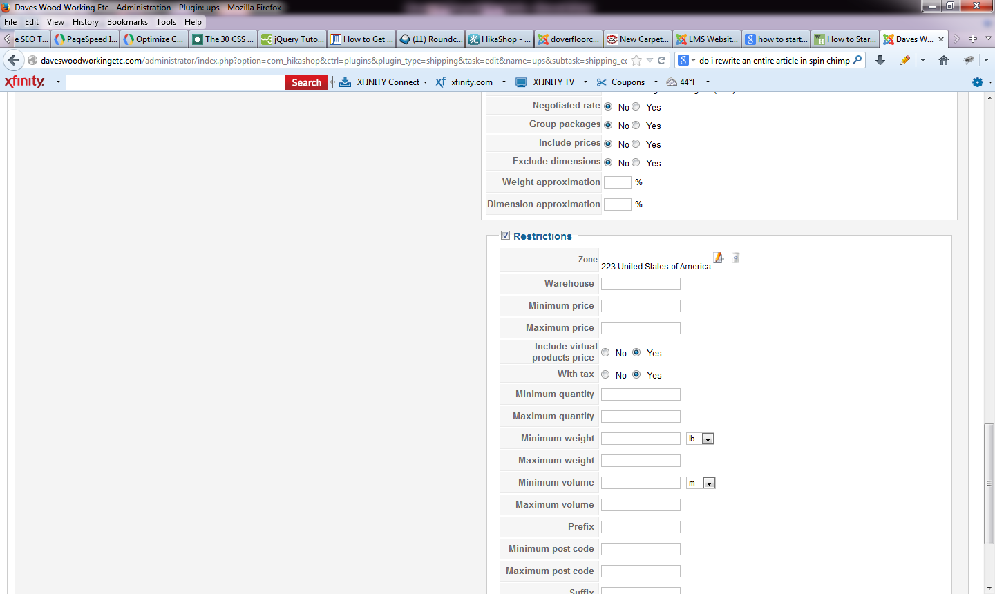

12 years 9 months ago #133921
If you look at the settings of your shipping methods, you can see that you configured a restriction on the zone so that the shipping method will only apply if the user is within the USA. If your address is in Rhone (France), which is not yet part of the USA, the shipping methods will be discarded of course.
Please remove these restrictions too or change your address to within the USA if you don't want to allow shipping internationally.

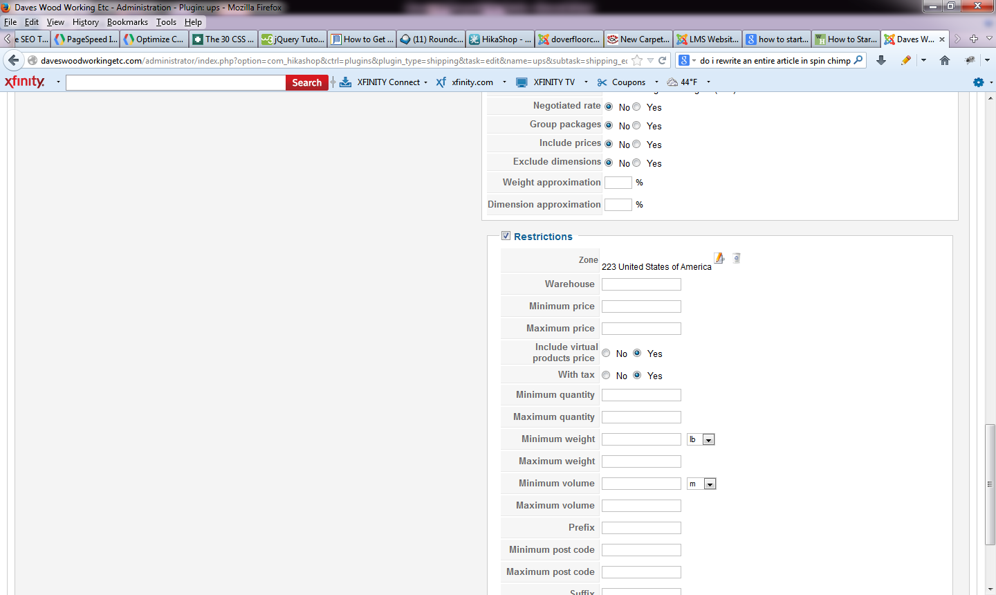

12 years 9 months ago #133937
Okay Nicolas. I've removed all restrictions on my UPS and USPS shipping methods and I still get the error message: The cart items combined weight is too small for all the possible shipping methods.

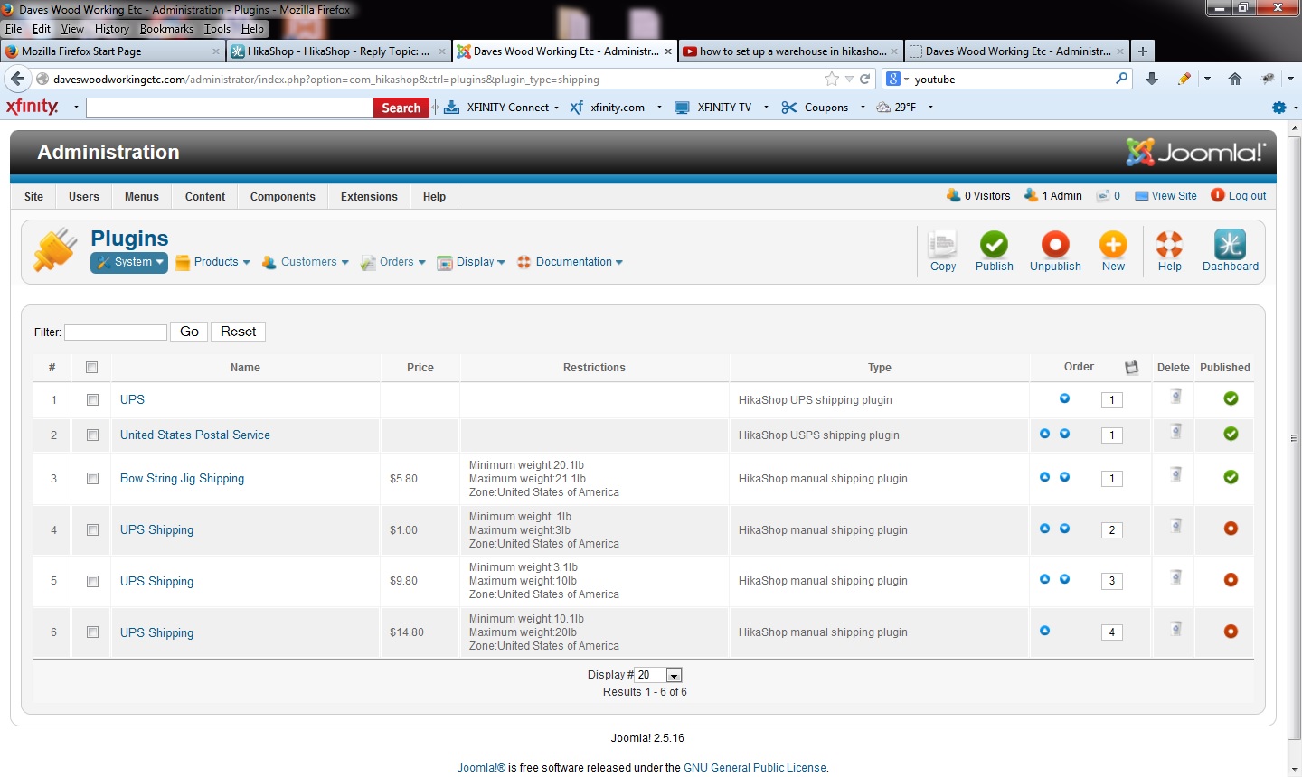

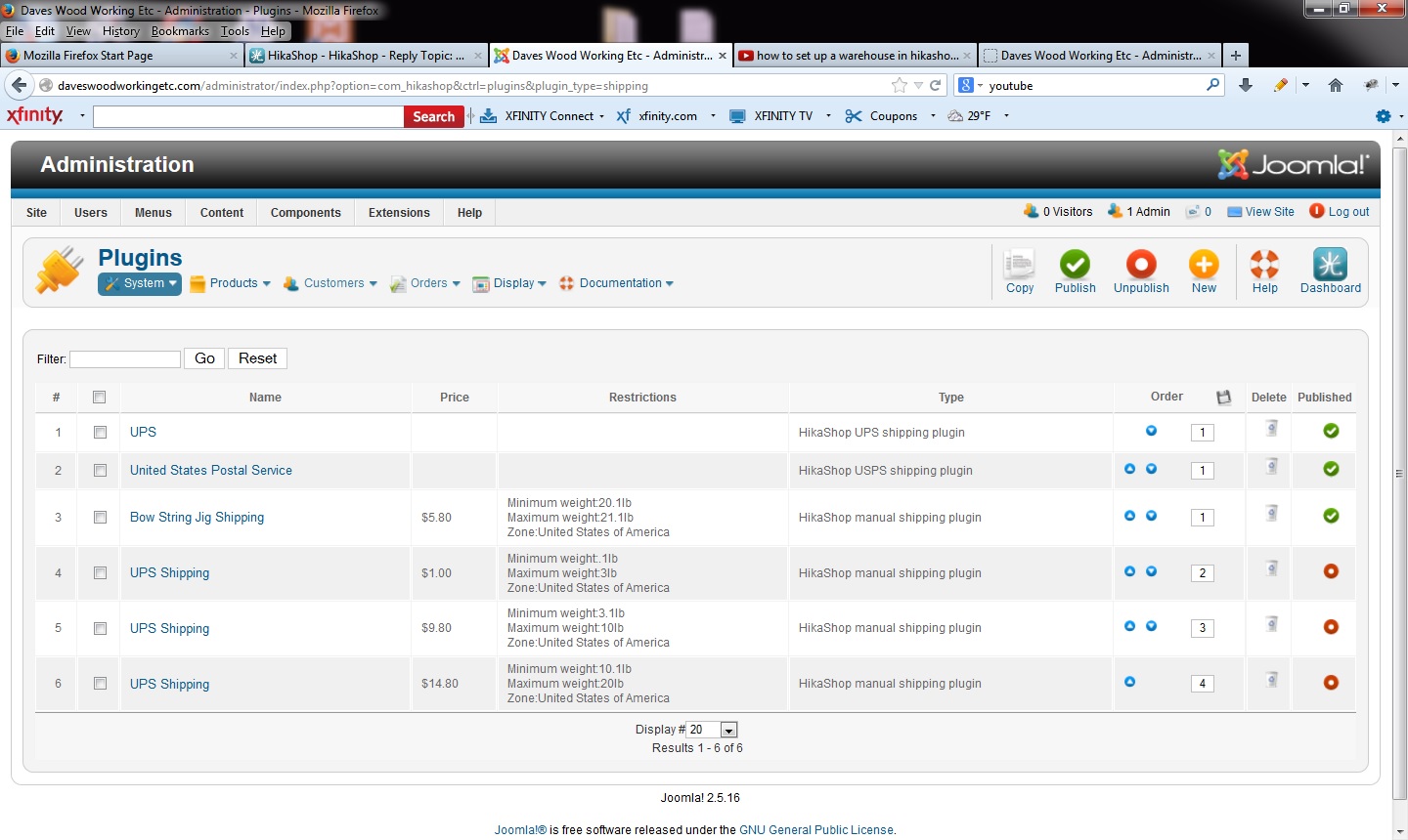

12 years 9 months ago #133942

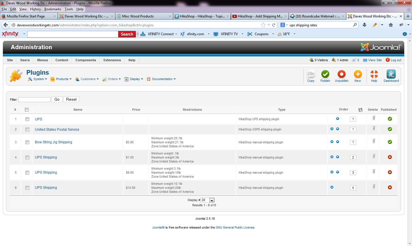

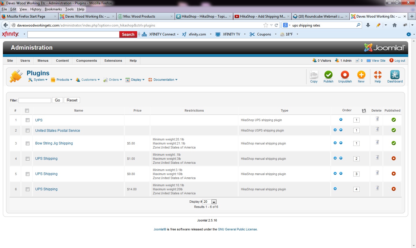

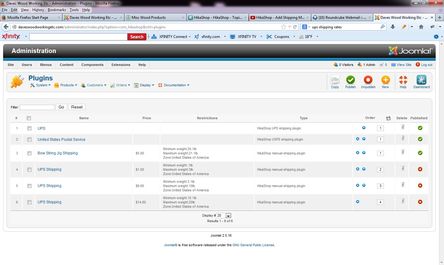

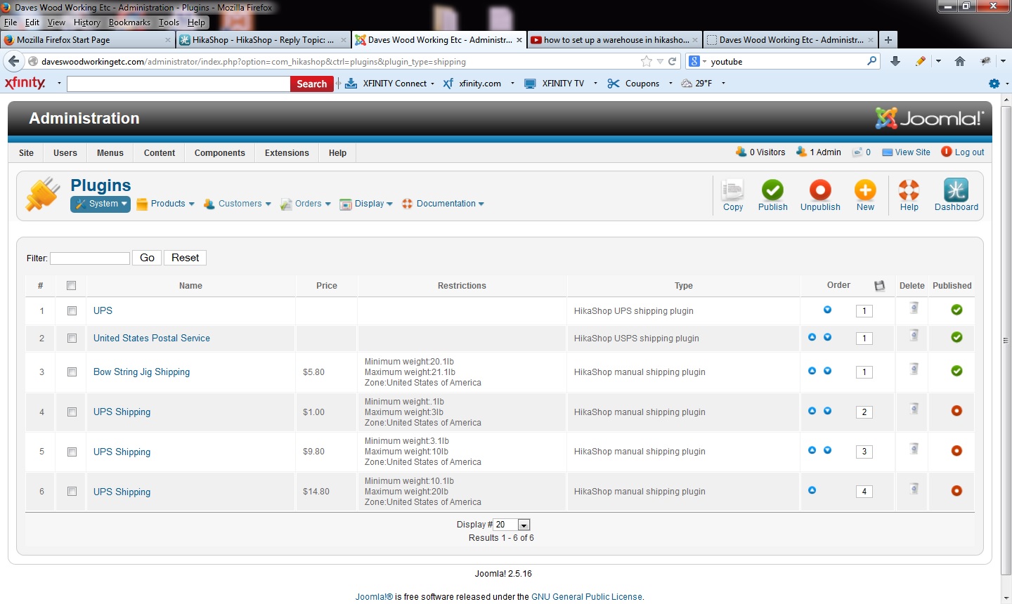

Please provide a screenshot of the shipping methods listing that you have in the backend with all your shipping methods listed.
  • Posts: 74

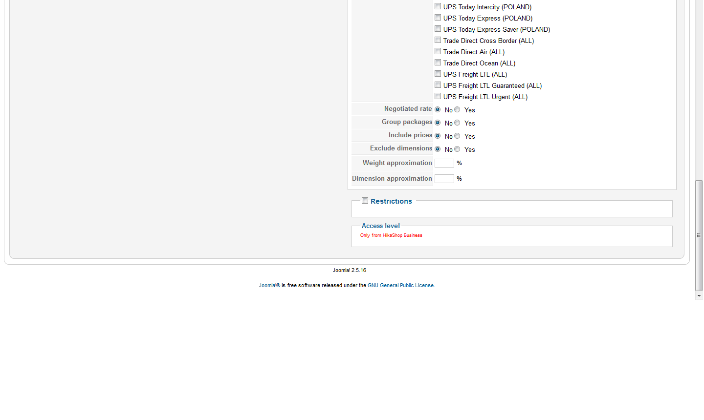

12 years 9 months ago #133951

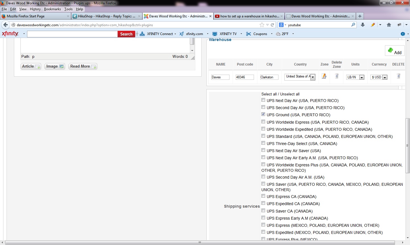

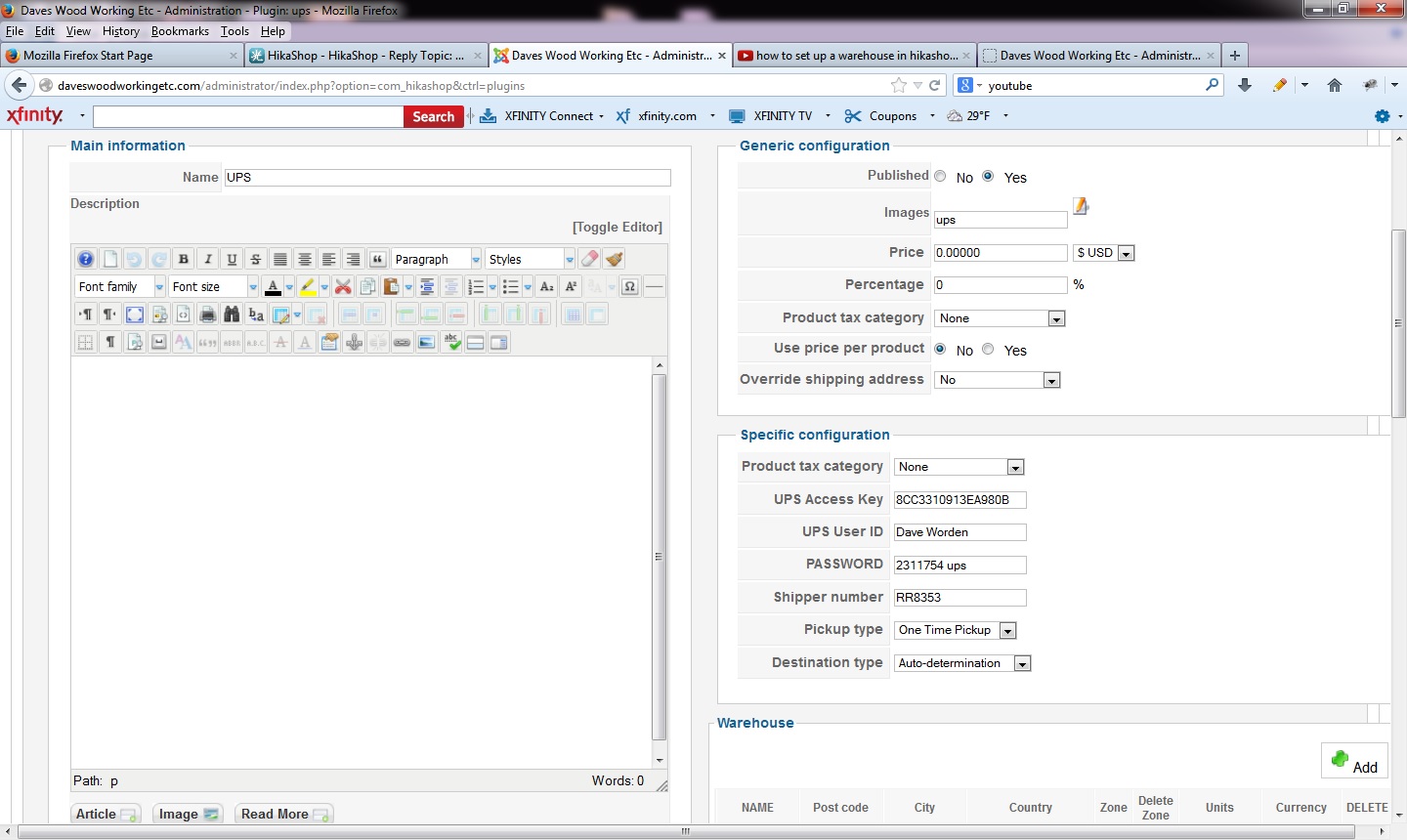

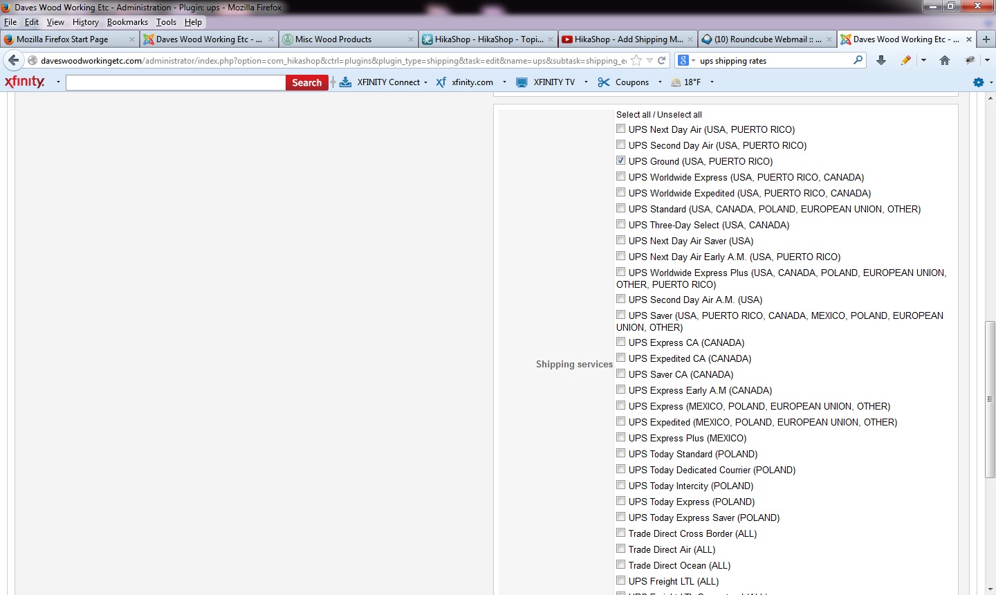

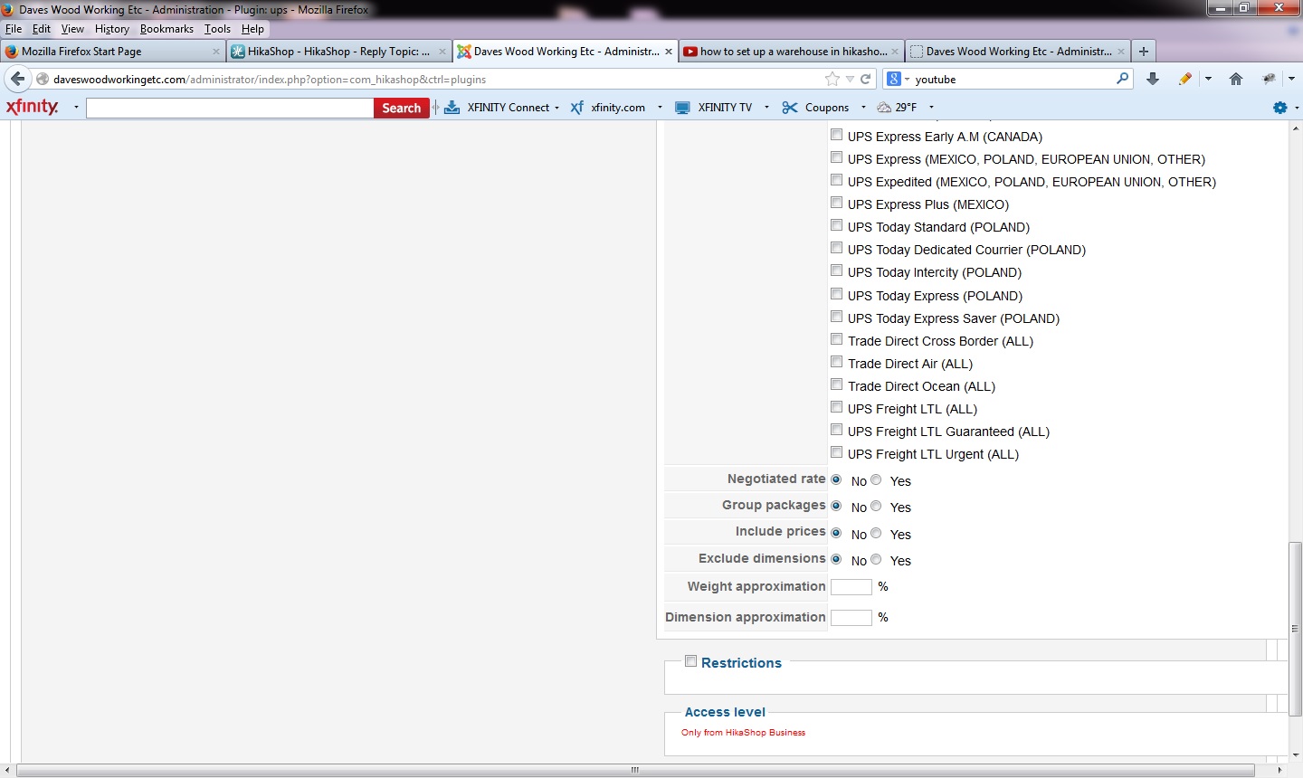

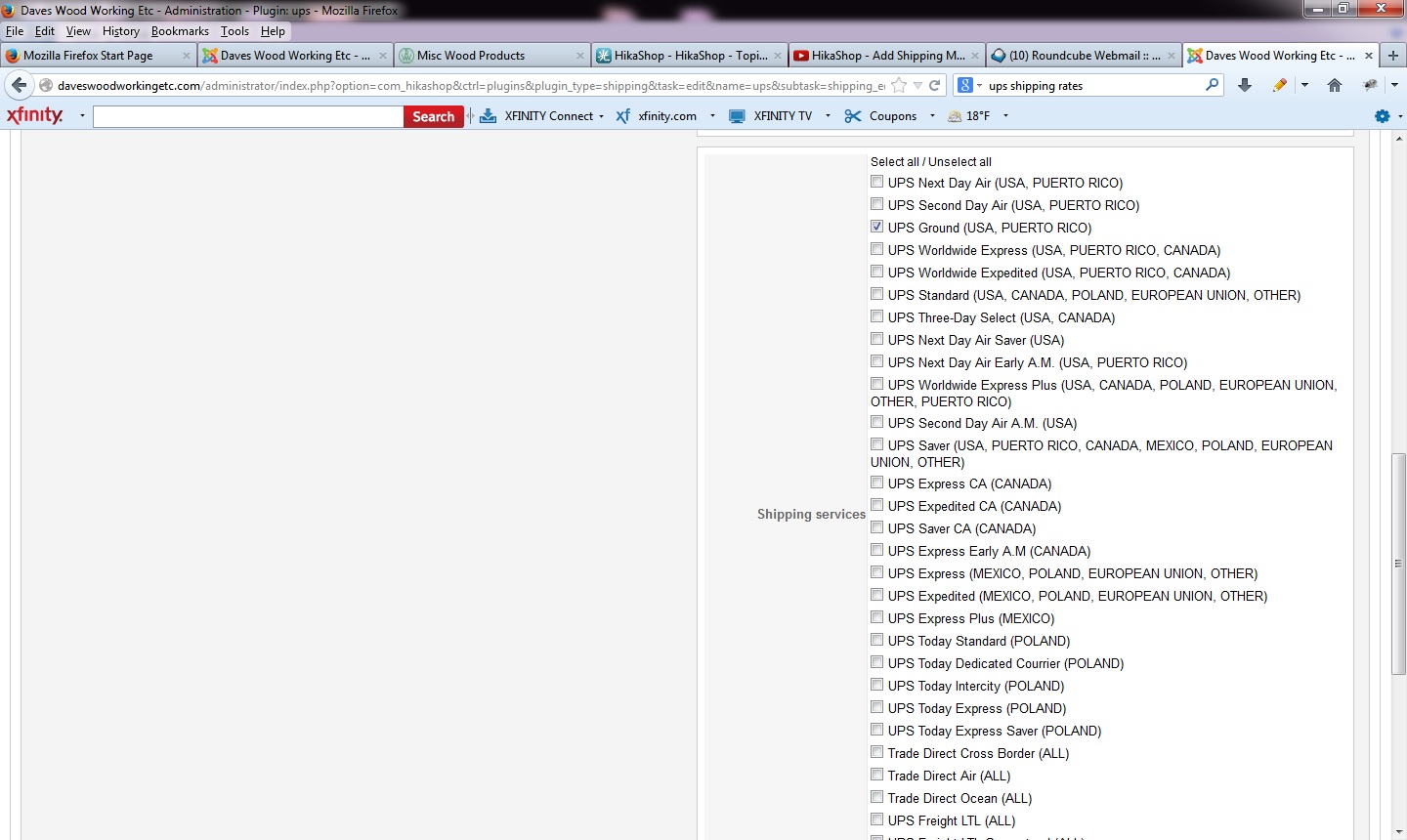

Thanks Nicolas. Here are the screenshots as they are configured right now. I have 3 manual shipping methods unpublished so that the system must use either the ups or usps shipping method. When I publish the manual shipping methods they will work. Thanks again.

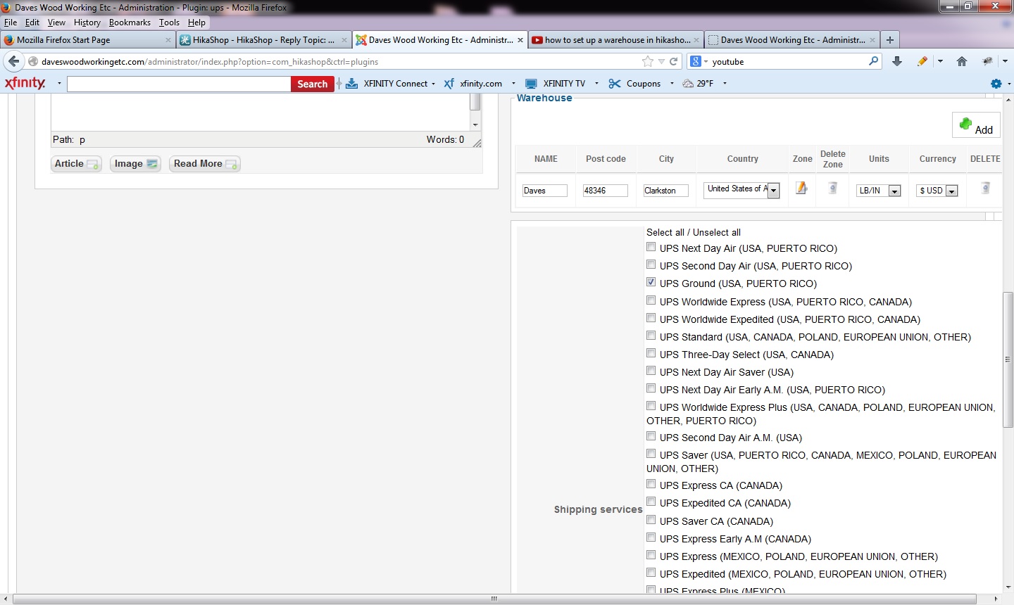

12 years 9 months ago #134000

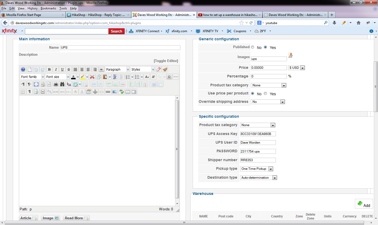

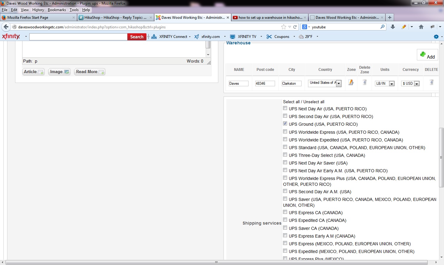

The problem is coming from the fact that you didn't set any warehouse for your UPS shipping method, Also you should check all USPS shipping services so that you can see what service will be available for your account and package that you want to send.
  • Posts: 74
12 years 9 months ago #134048
HI. I had a warehouse set up and it didn't work so I took it off. I've put a warehouse location in and it still doesn't work. Same error code. Is there a place to configure a warehouse other than just entering in the information on the UPS plug in?
