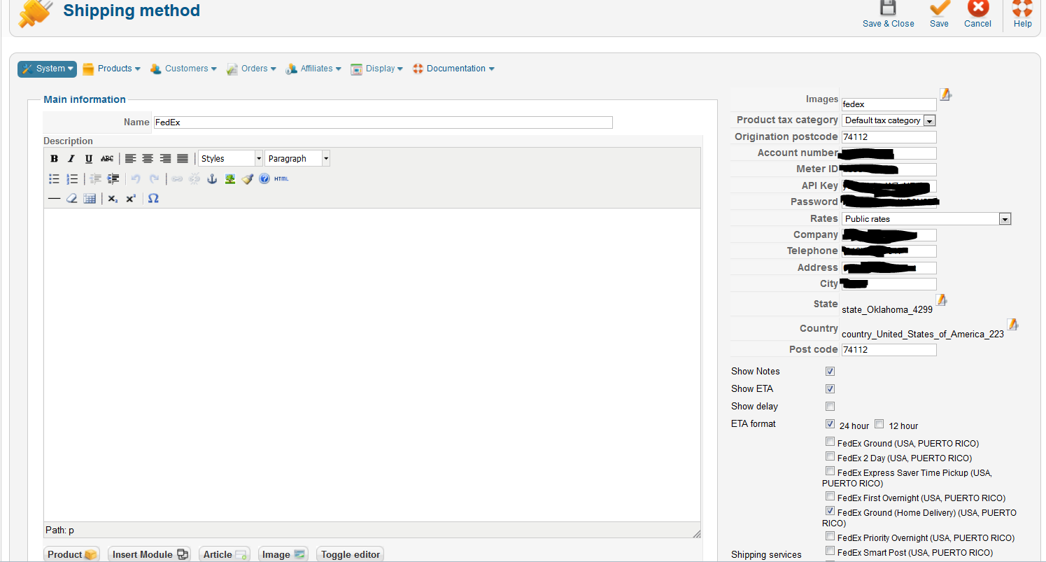

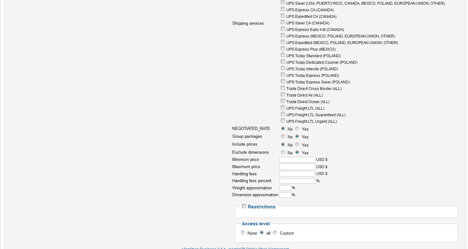

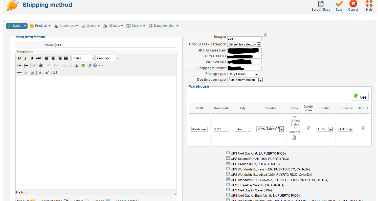

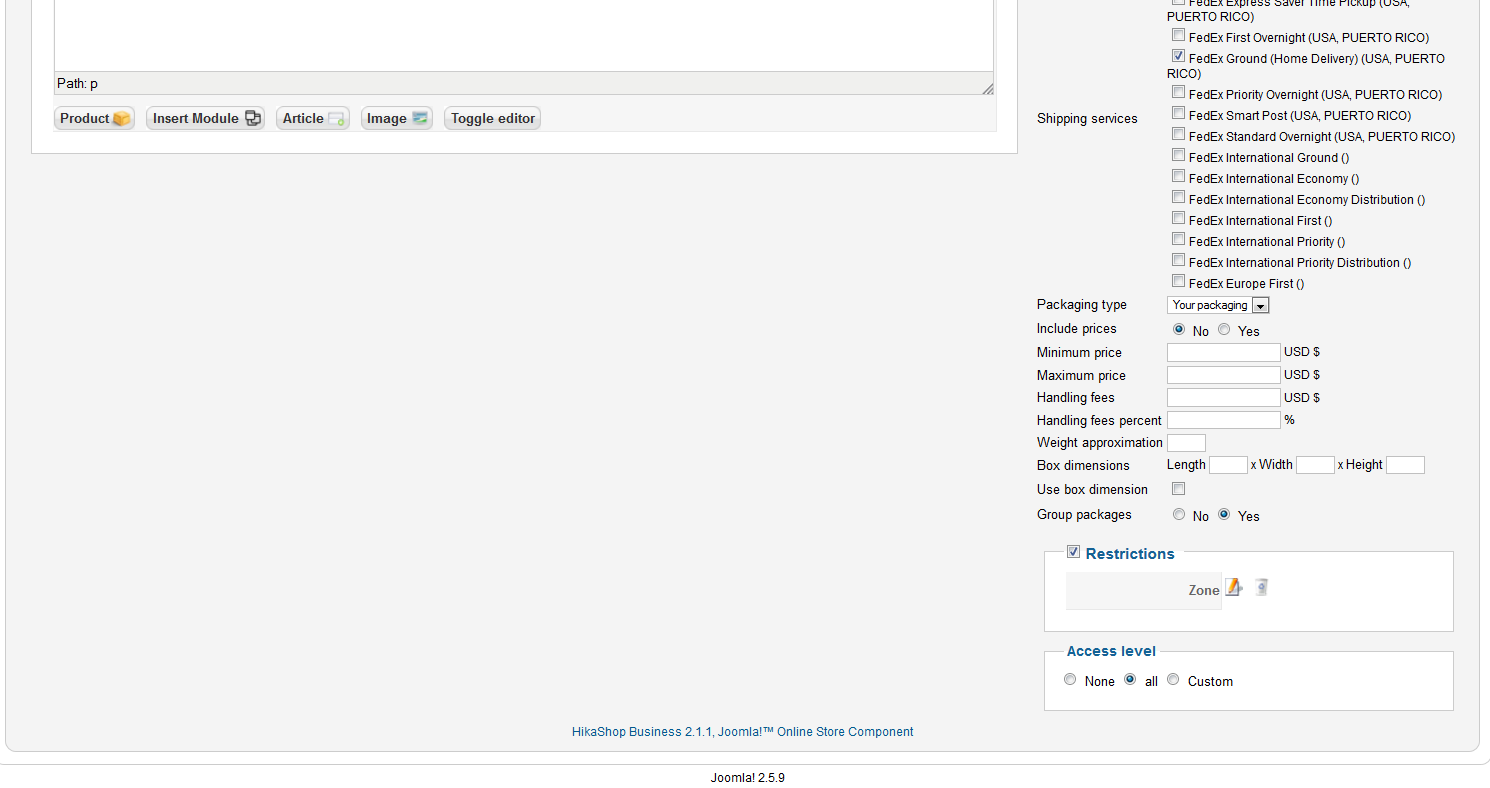

The only options that we've found in the UPS and Fed Ex plugins are the 'weight approximation' fields which add a percentage to the price. We tried using the manual shipping options to create a dummy UPS and Fed Ex gate, where if it fit certain weight requirements it would use that particular plugin, but it just adds another option rather than acting as a gate to choose shipping options.

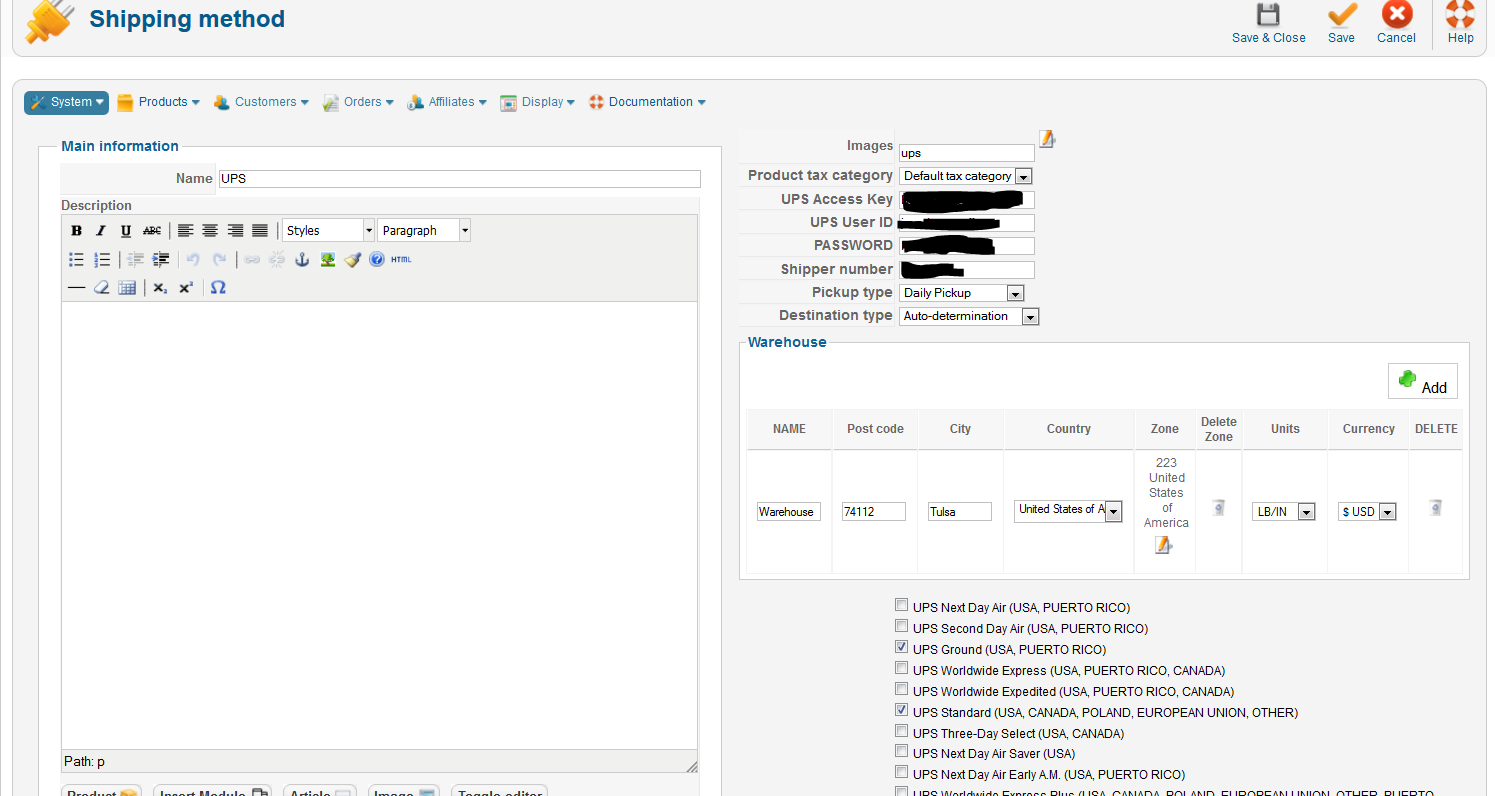

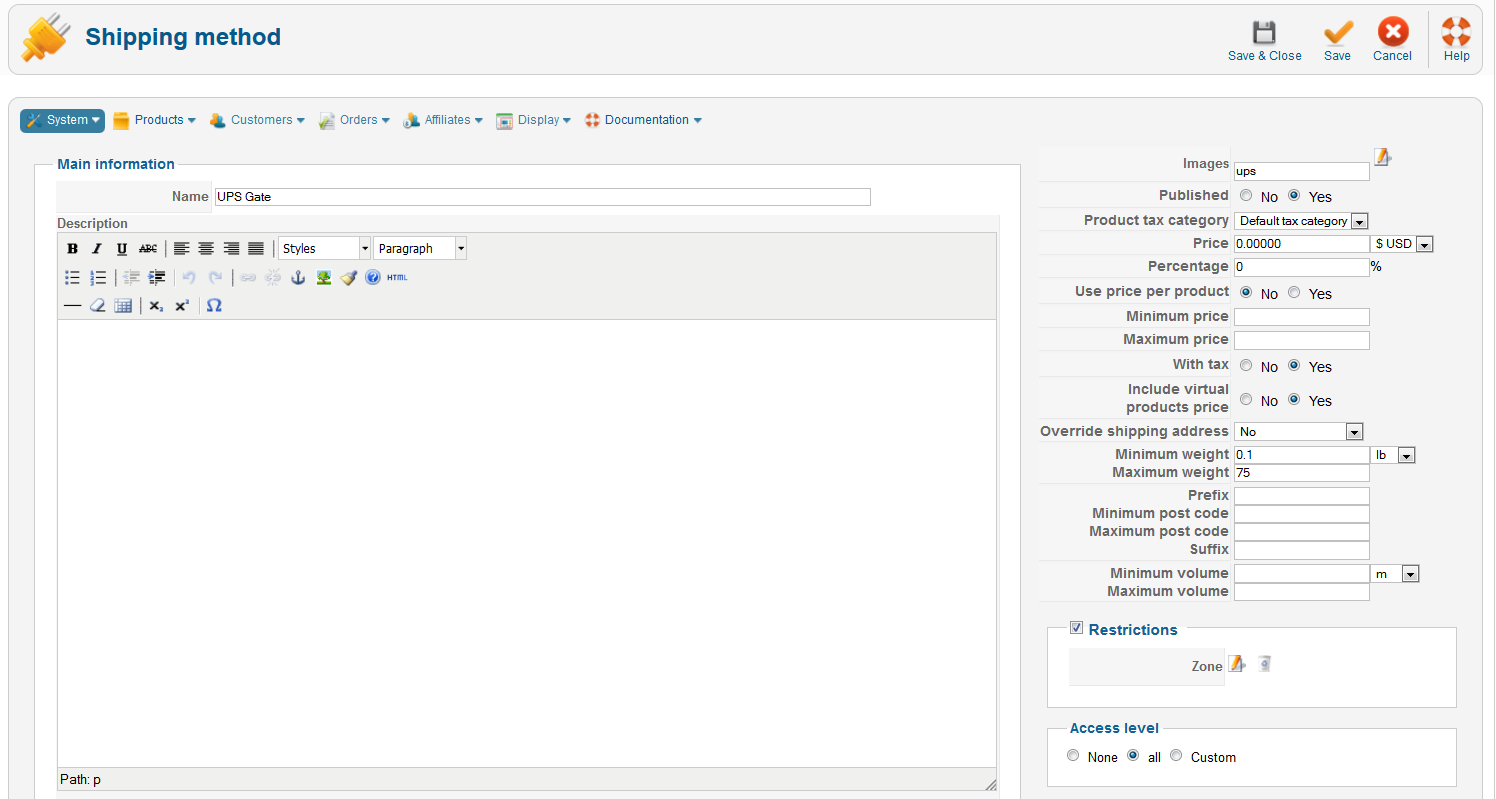

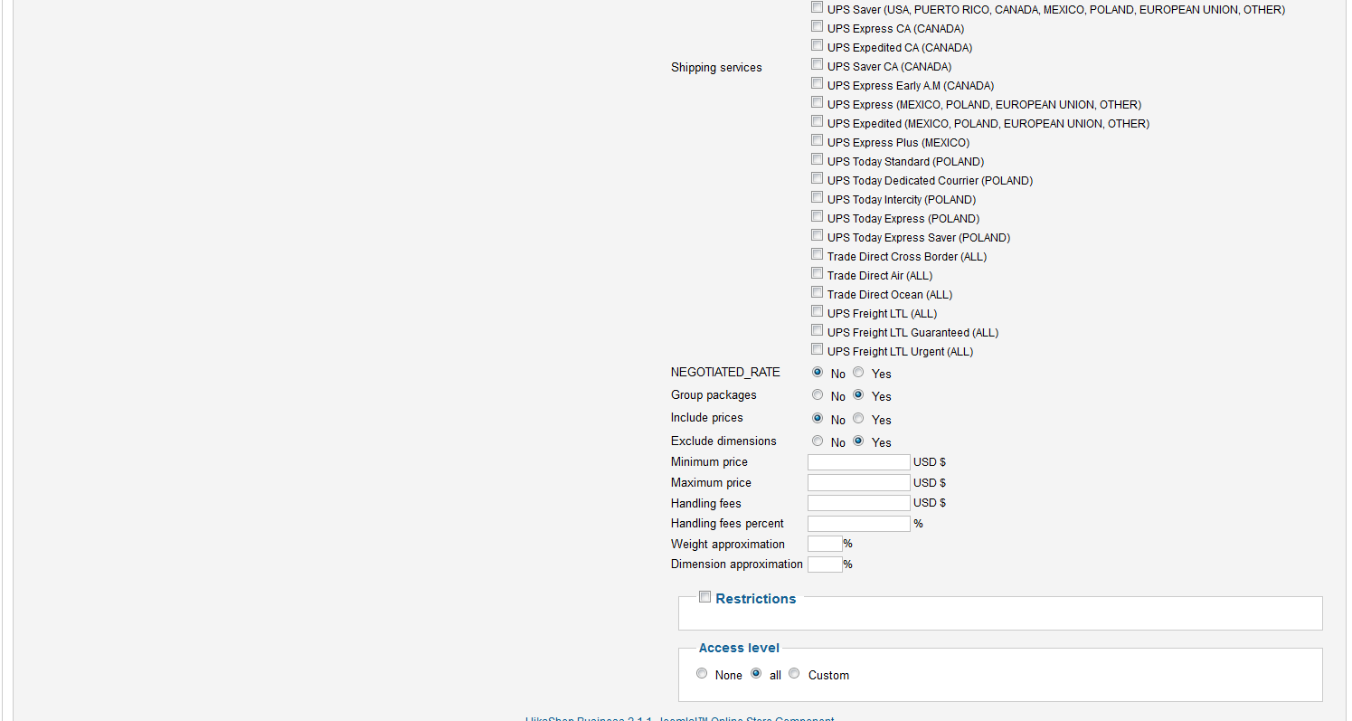

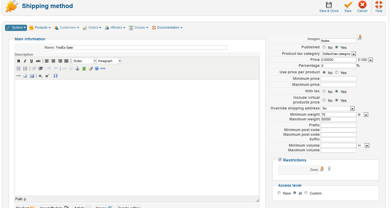

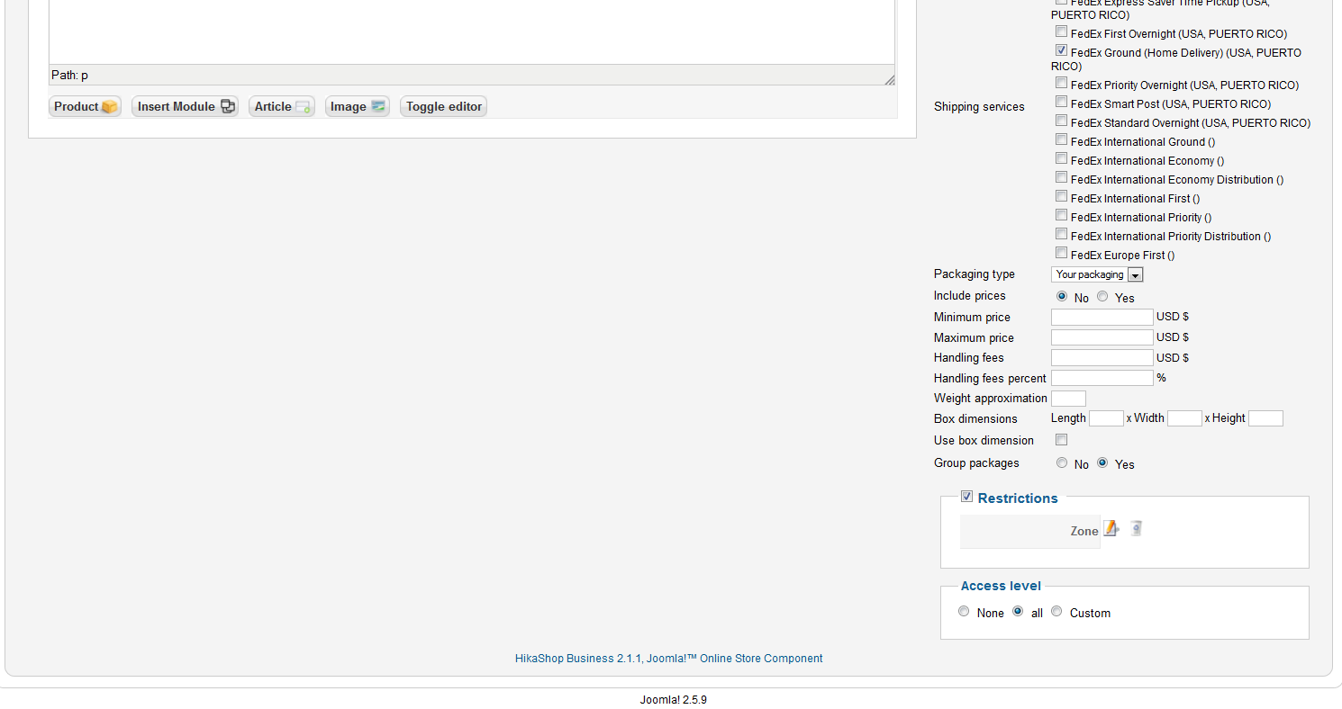

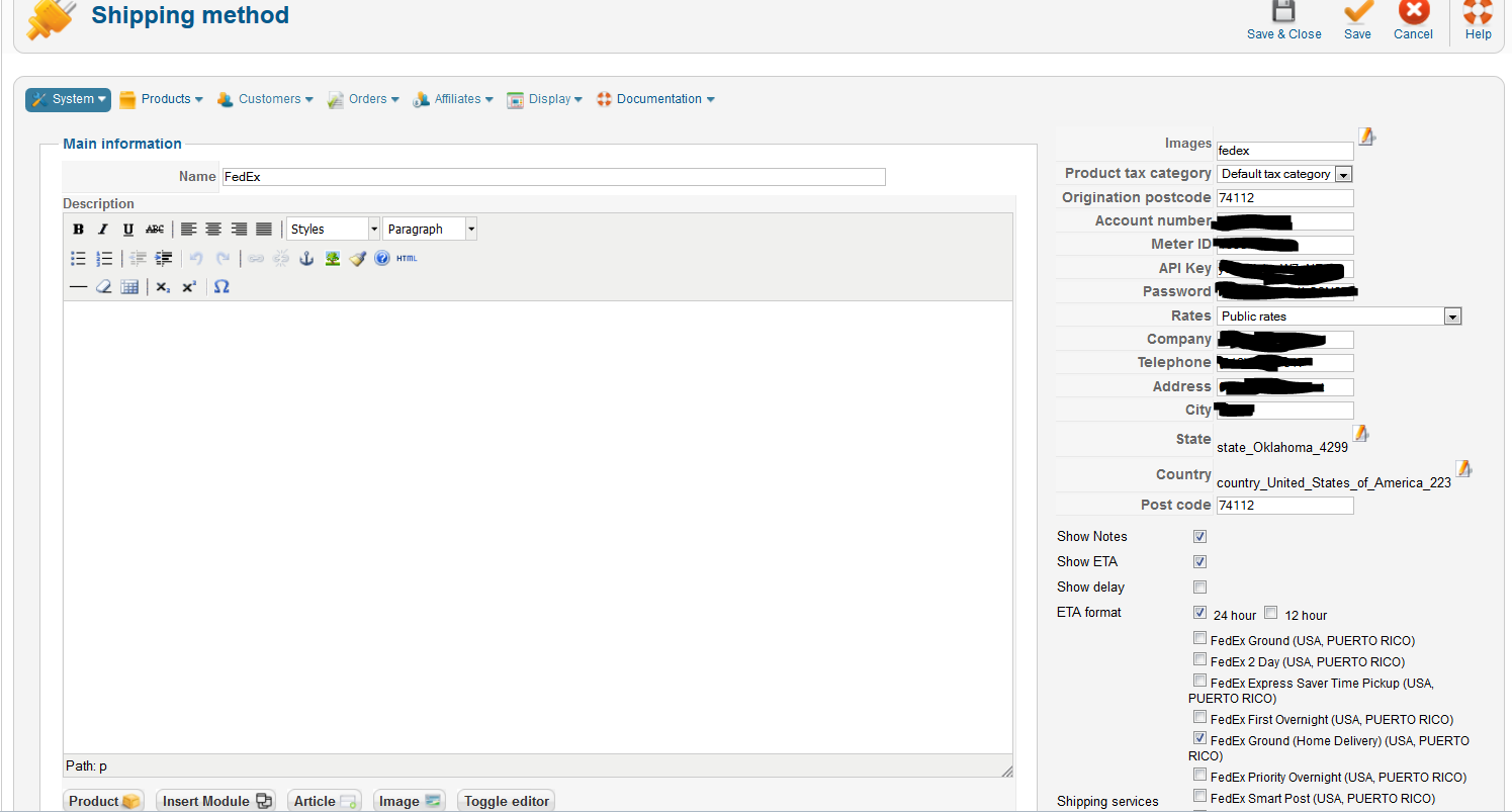

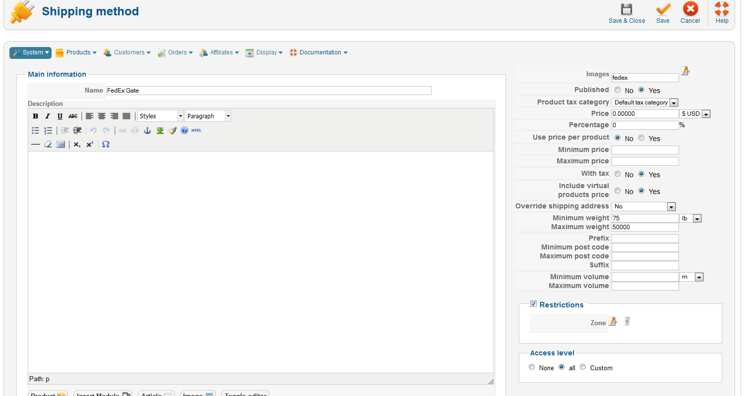

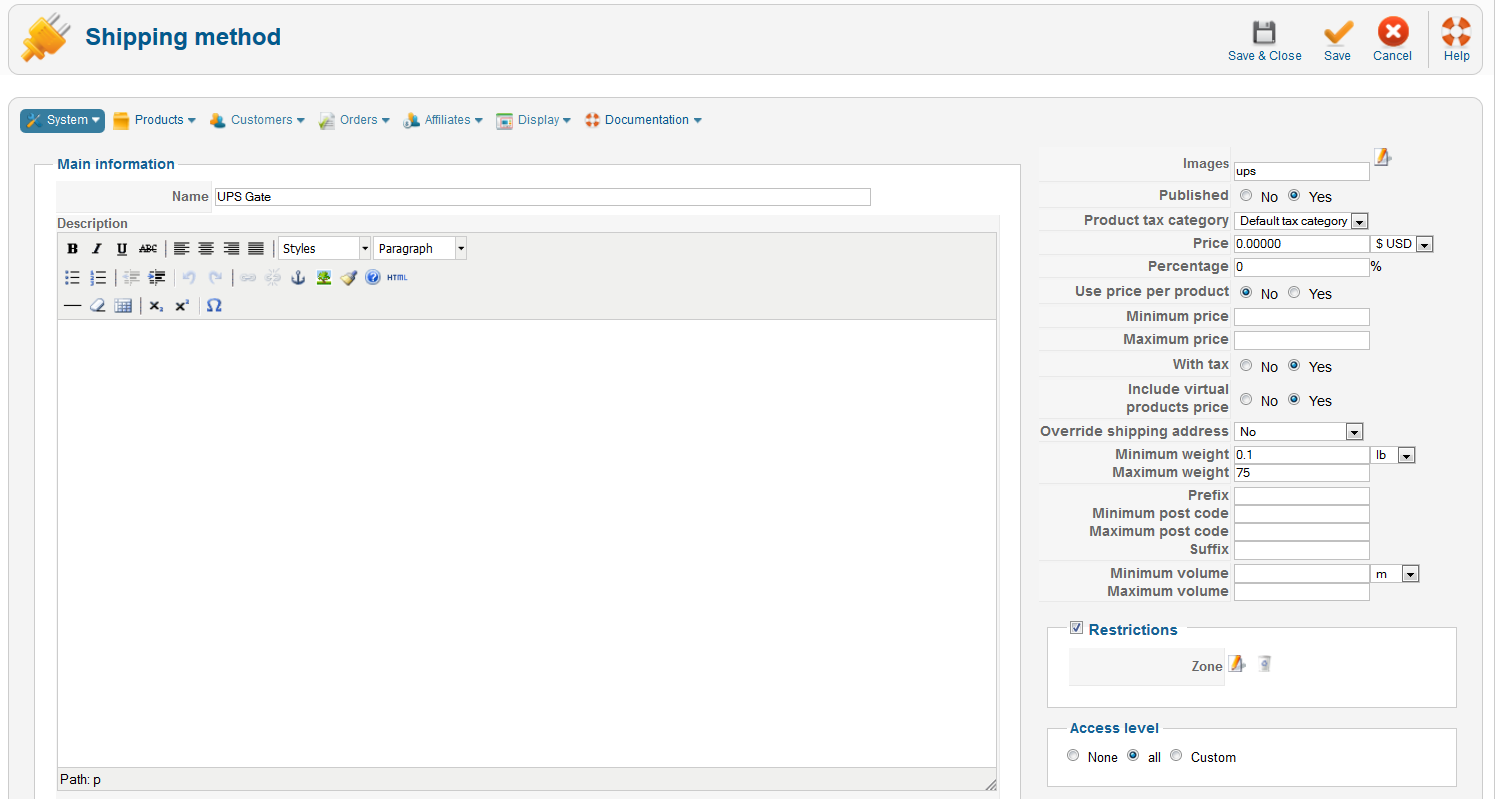

I might be misunderstanding, but we don't want the customer to have the option to select which shipping option they get, but to have it select for them based on the weight. I've looked in the restrictions for the manual shipping and only saw the ability to restrict by zones. I did see the minimum and maximum weight restrictions, and I have attached the images of how I set all these plugins up. Perhaps there's something here that I'm missing.
  • Posts: 86104
  • Thank you received: 14203
12 years 9 months ago #134374
If you have only two manual shipping method one with weight restrictions being 0 to 75 and another being 75 to 50000, the only time you would see both of them on the checkout would be for a weight of 75 exactly.
Otherwise, the system will filter out the one which doesn't match the total weight of the products in the cart.
