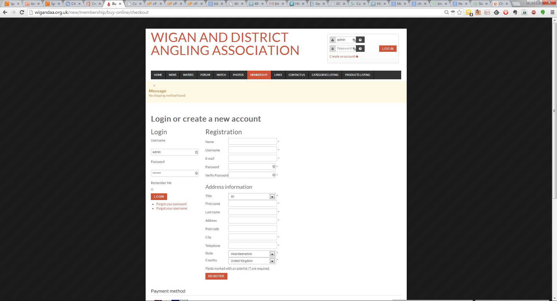

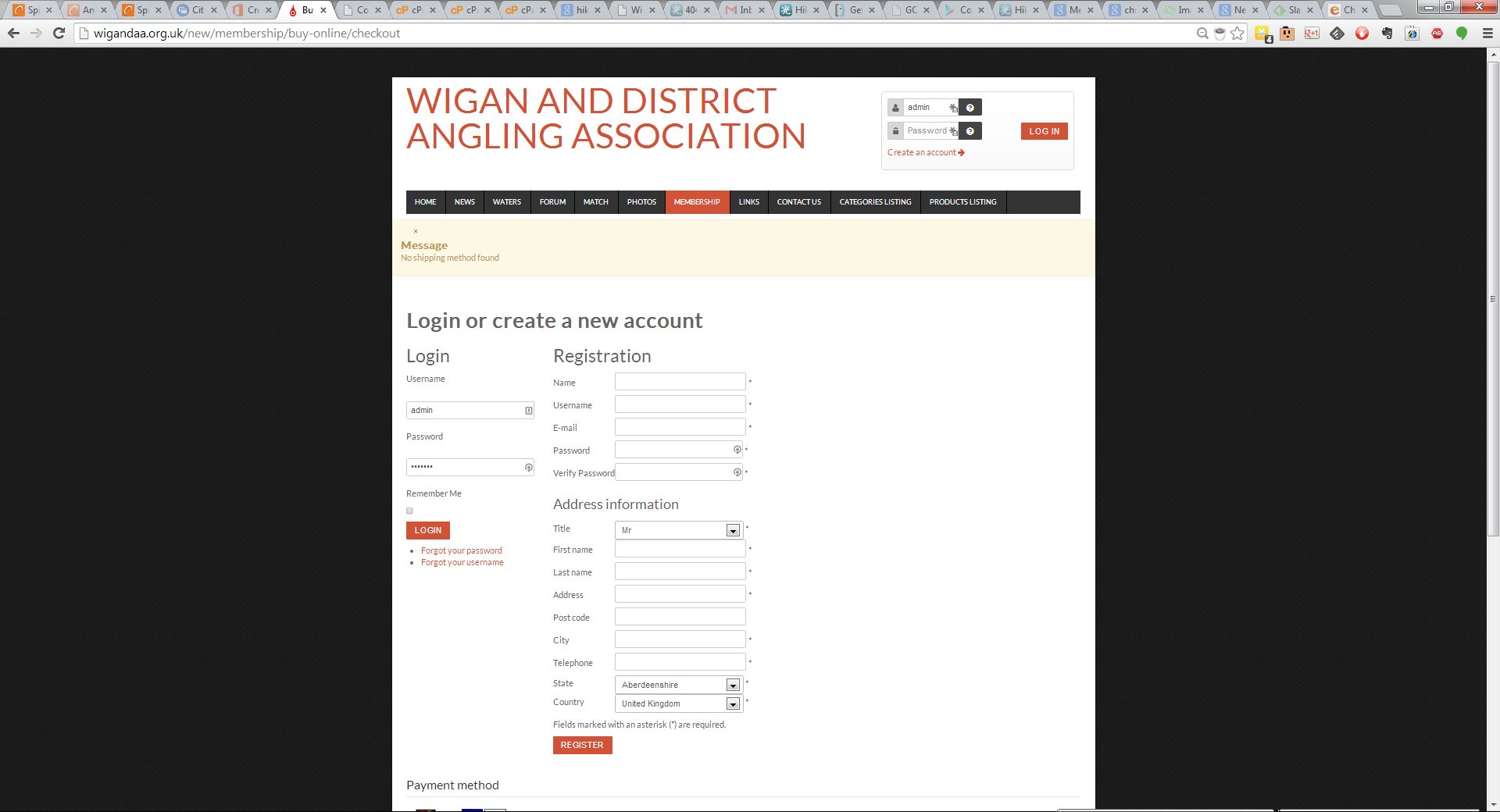

Hi Guys this occurs on the login/register page after I have clicked Add to Cart (Before it even knows my address). When I put my address I get the correct shipping options and checkout proceeds without a problem or further errors.

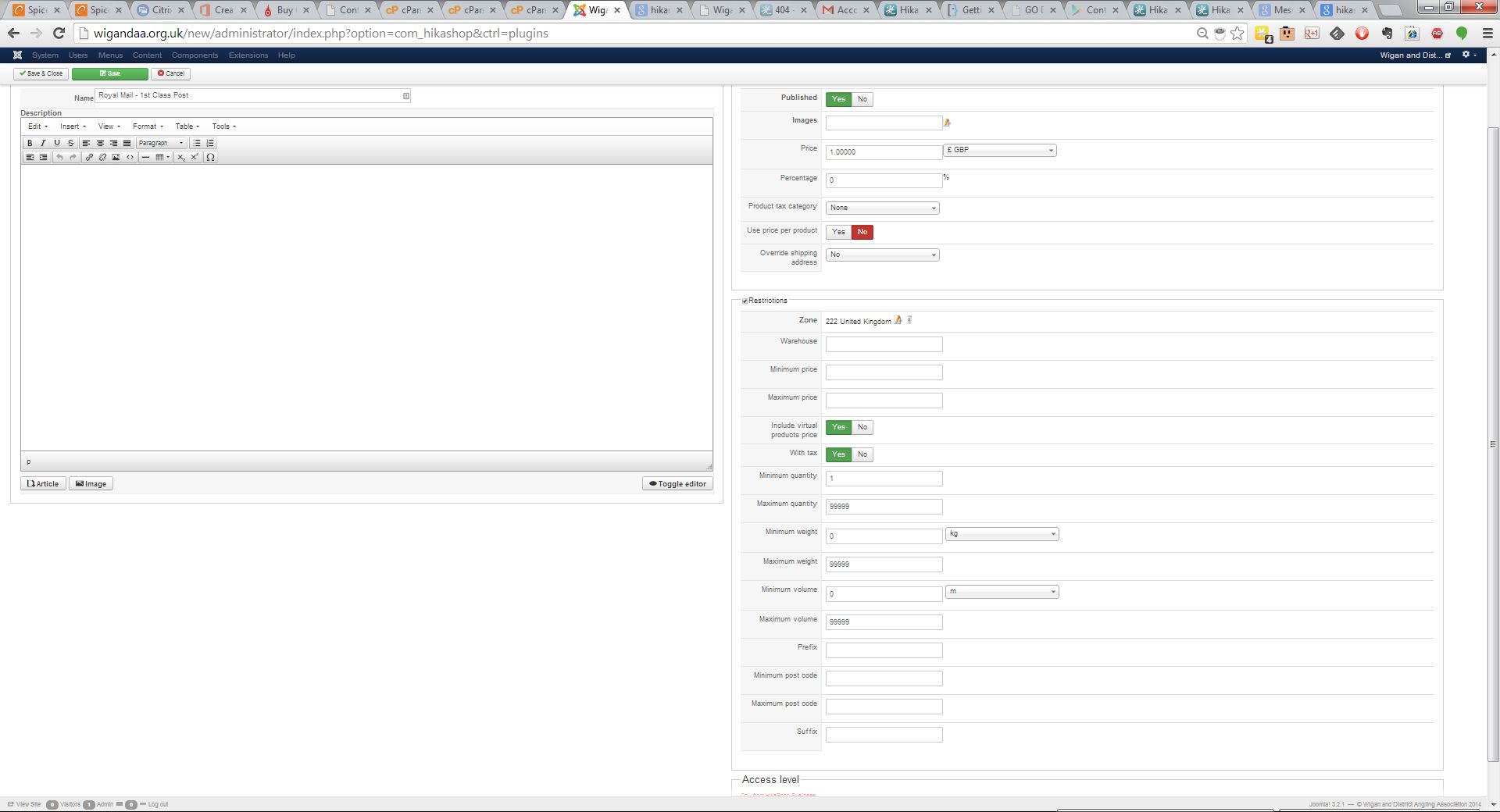

I have 1 Manual Shipping Module set up which is restricted by Zone.

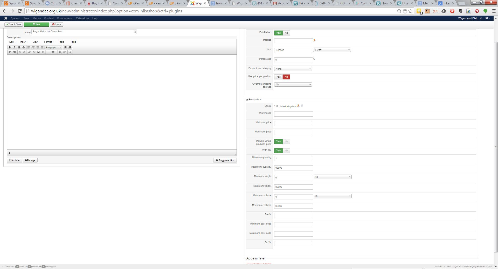

My Product
The Plug in is enabled and my checkout order is

To clarify this message only appears when I add a product to my cart and doesn't actually prevent checking out.

If I enter a UK shipping address it selects the correct shipping method and everything proceeds fine. If I enter a non UK Address it says No Shipping Method found. This is the behaviour I wanted. The issue I have is that it says No Shipping Method Found before I have even had chance to Enter my address.

Yes 1 Method Set Up with a Zone restriction

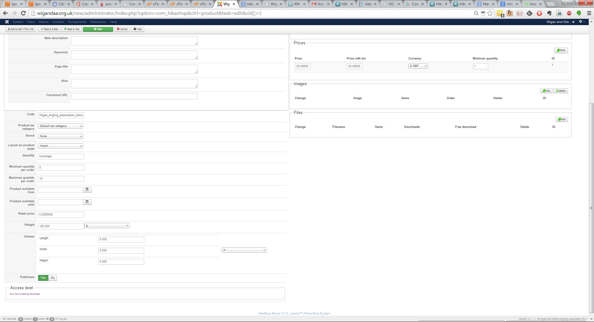

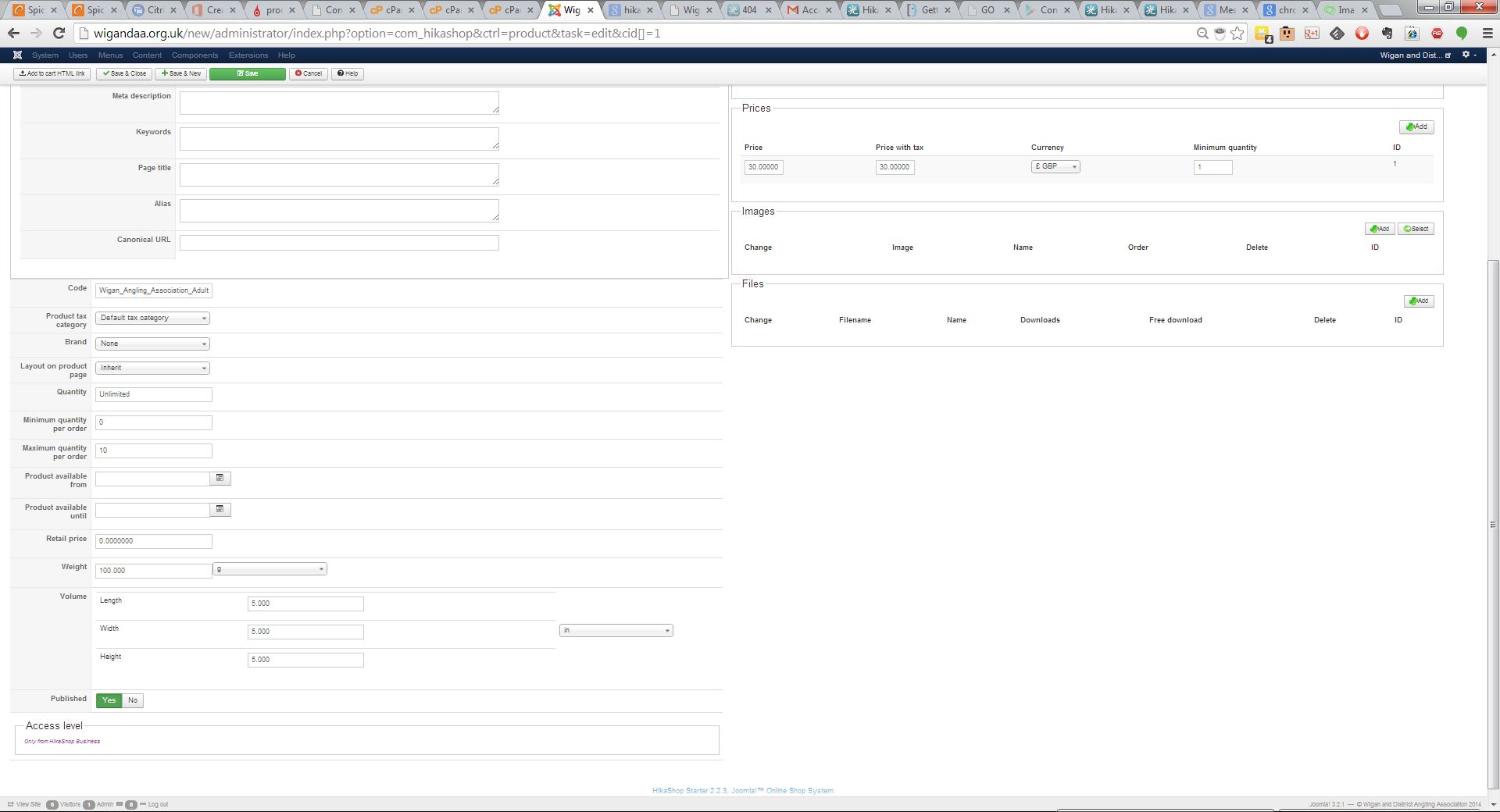

5) Check that your products have a weight, otherwise, the system won't display any shipping methods as it will consider the products as virtual goods.
They do indeed have weight of 1kg

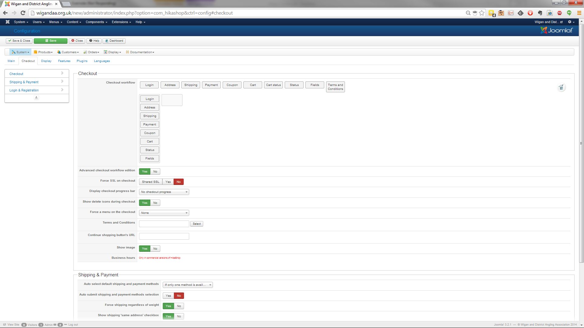

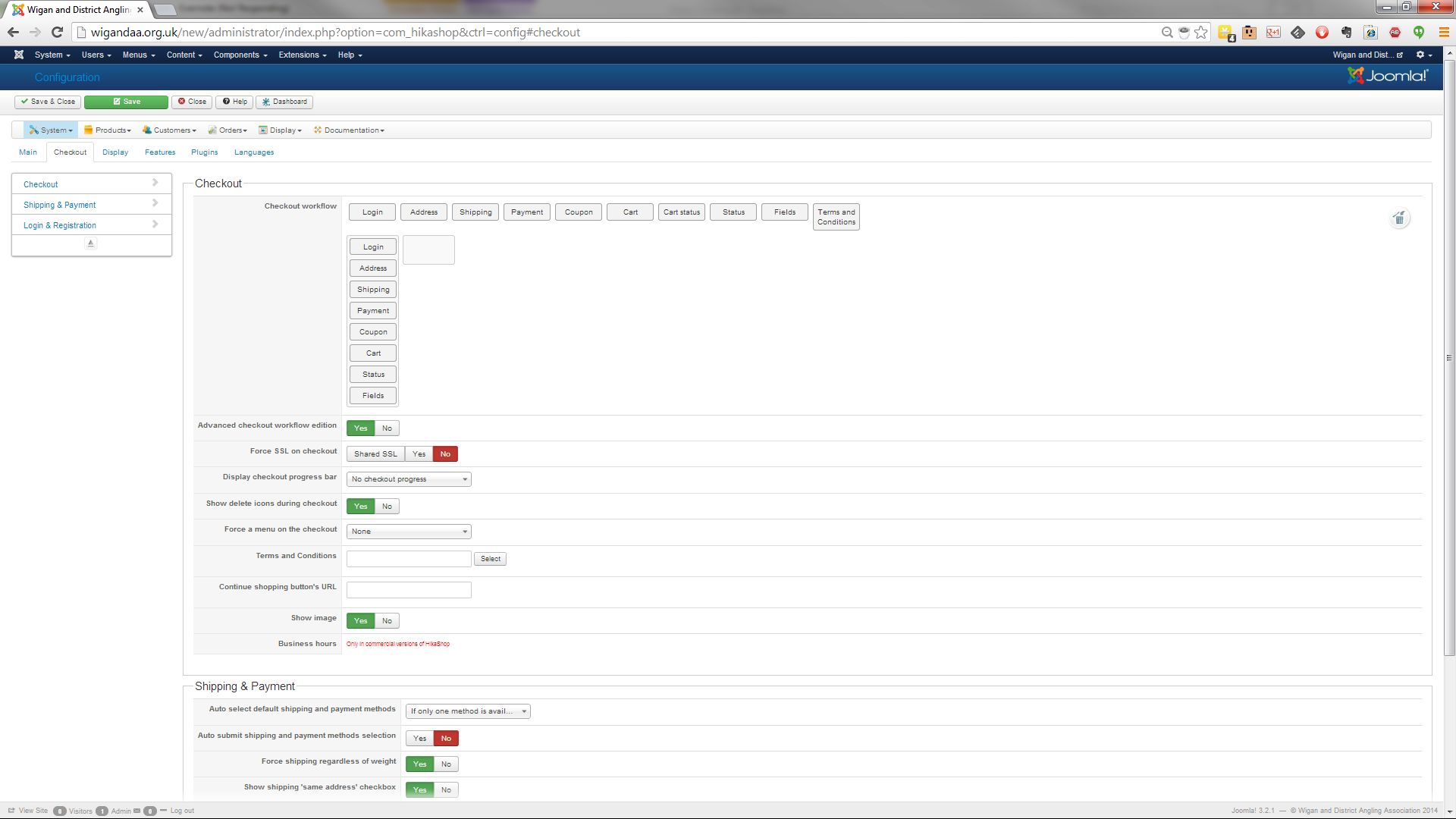

Ok, I think that the problem is coming from the way you configured your checkout workflow so can you show me some screenshots your checkout workflow through the page "HIkashop->System->Configuration->Checkout".
  • Posts: 3
12 years 8 months ago #140511
Thanks for the reply
please find attached a screenshot of my checkout settings.
12 years 8 months ago #140525
And if you configure your checkout workflow like this ?
STEP 1
Login
Address
STEP 2
Address
Shipping
Payment
Coupon
Cart
Status
Fields
