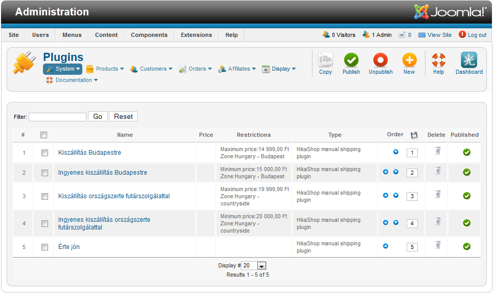

I have set two zones:
1. capital of the country
2. the rest (countryside)
and the third zone is the whole country
I have five manual shippping methods:
1. Customers come to the site of the company to pick the order up (zone: entire country, no min and max order value)
2. Delivery to the capital (zone 1) when the order value is under 15000 HUF (min value: 0 HUF, max value: 14999.99 HUF)
3. Free delivery to the capital (zone 1) when the order value is at least 15000 HUF (min value: 15000 HUF, max value: not set)
4. Delivery to the countryside (zone 2) when the order value is under 20000 HUF (min value: 0 HUF, max value: 19999.99 HUF)
5. Free delivery to the countryside (zone 2) when the order value is at least 20000 HUF (min value: 20000 HUF, max value: not set)

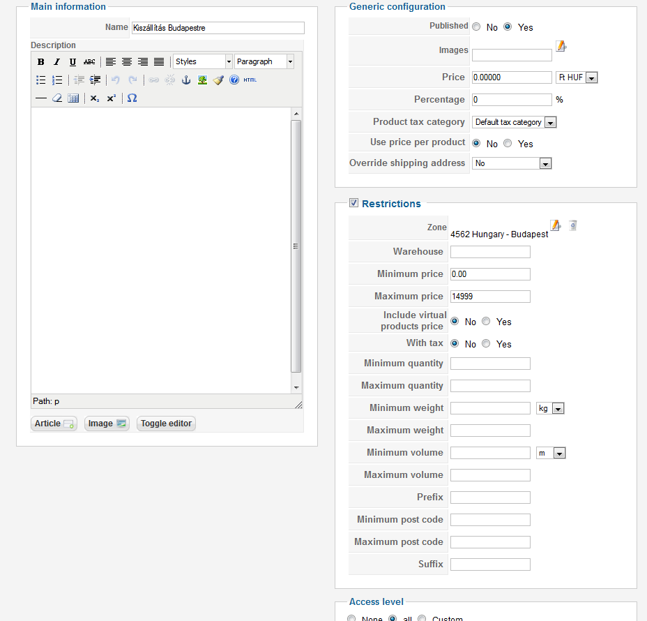

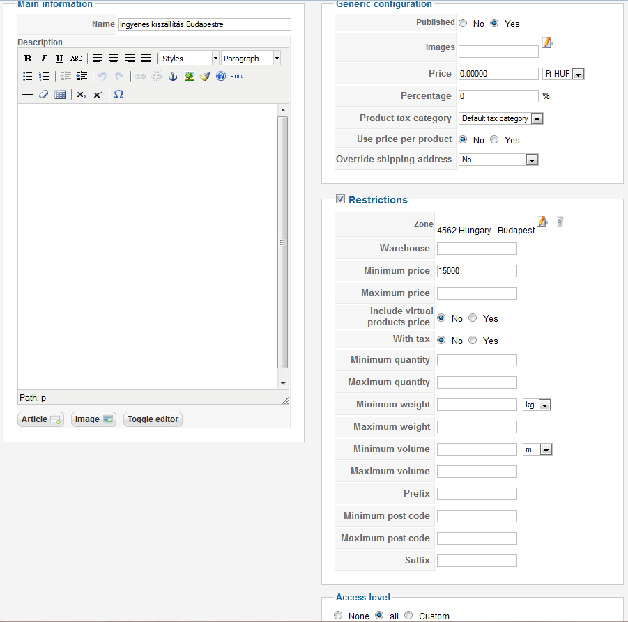

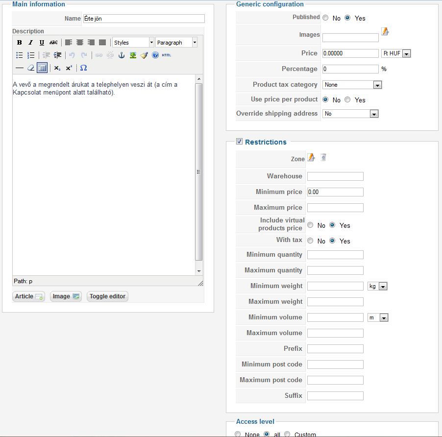

12 years 8 months ago #140378
Can you show me how did you configured your shipping methods through some screenshots ? Also, can you test it with a product with some dimensions and weight.
  • Posts: 29

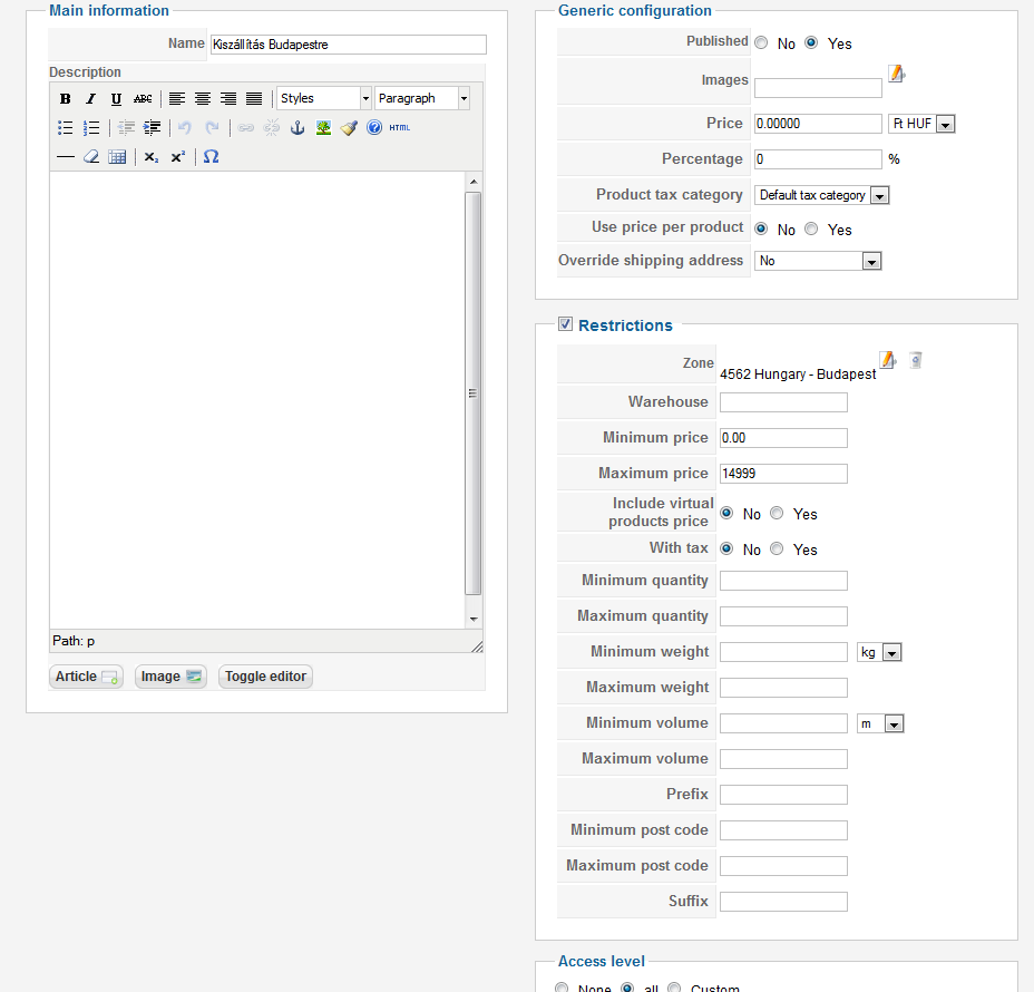

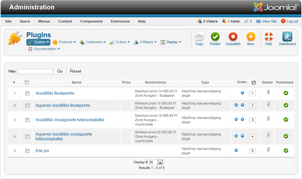

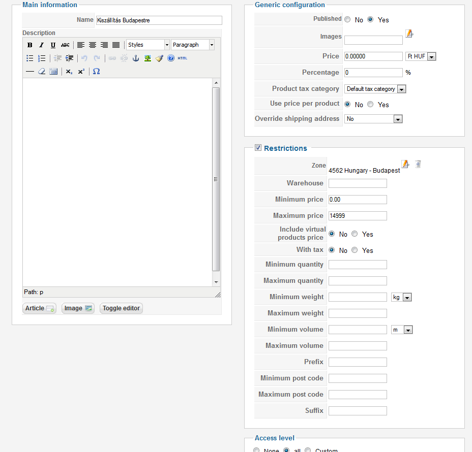

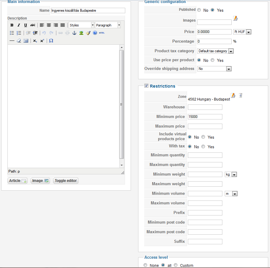

12 years 8 months ago #140398
Here are the screenshots, I can test it with weights and dimensions during the evening.

12 years 7 months ago #141319
The wrong shipping method was showing when your product weight and dimension was 0, because you haven't set the "Include virtual
products price" option of all your shipping methods to YES,
