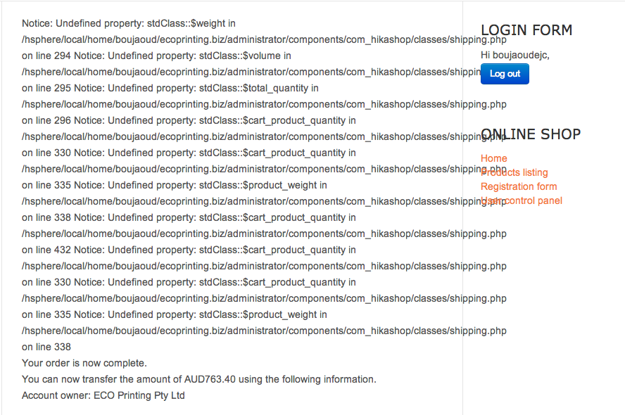

-- Error-message(debug-mod must be tuned on) -- : See attached screen capture for error

I keep getting the attached error at the top of the page.

These warnings appear because it's a fake order. We'll add additional checks in the next version of HikaShop to avoid them but they don't change the behavior.
You can just ignore them and turn off the "error reporting" option of the joomla configuration ( which you should anyway on a live website for security reasons ) in order to not display them.
