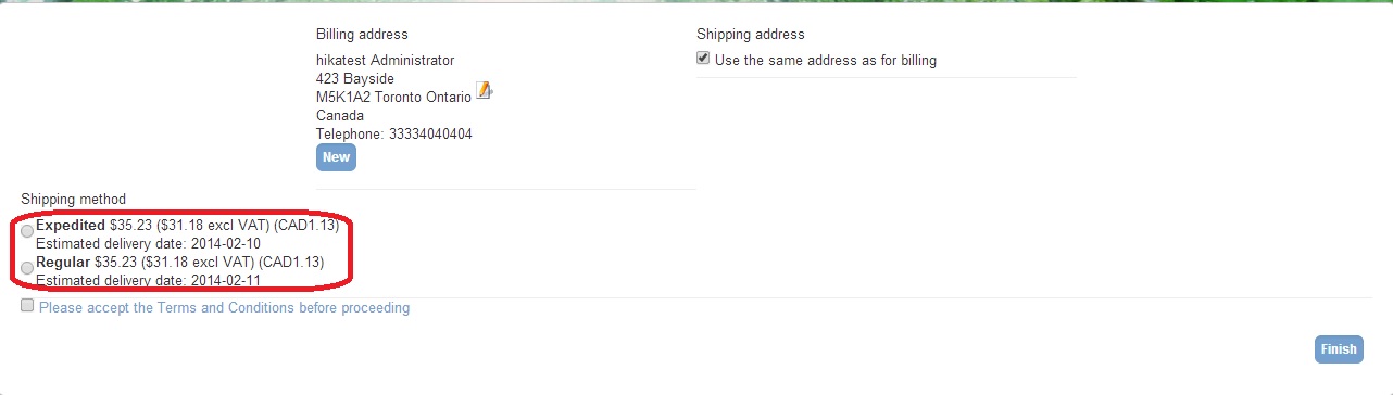

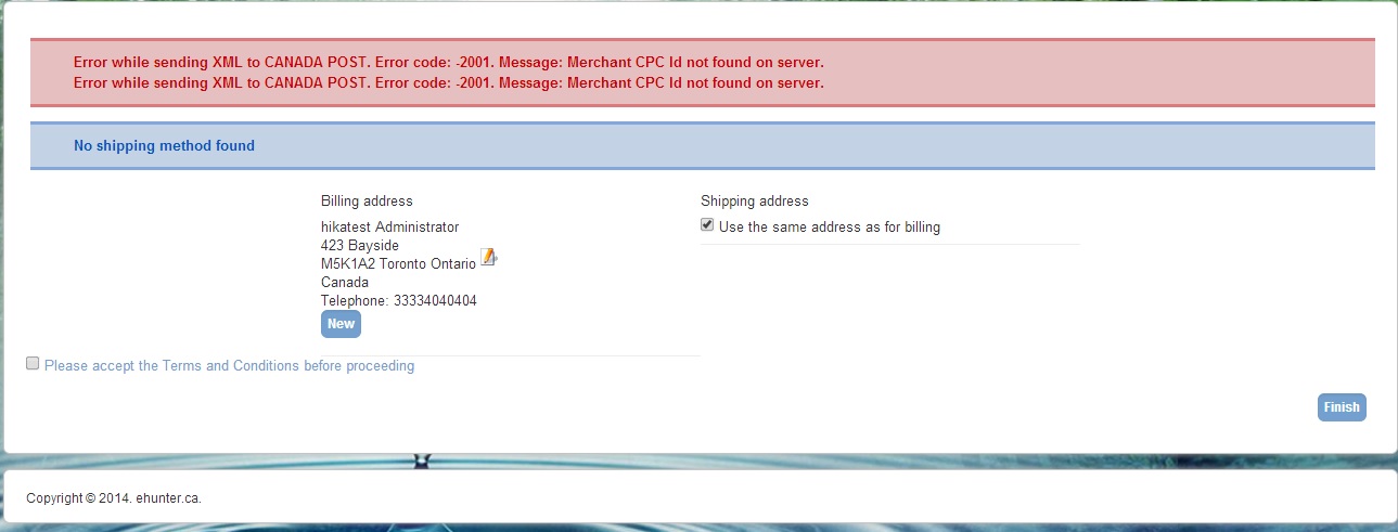

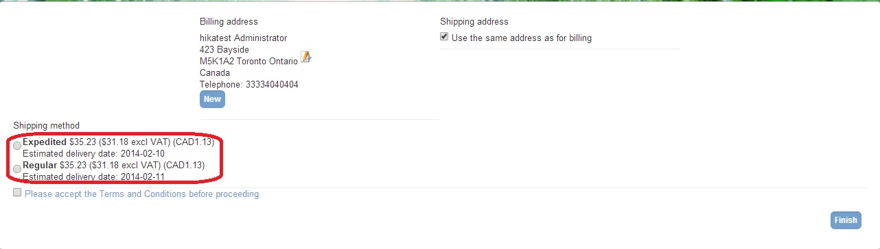

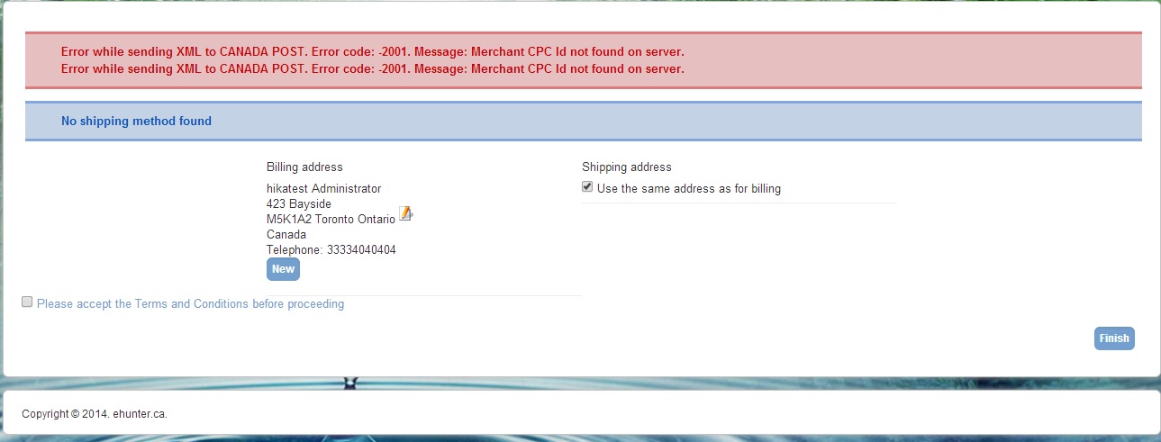

12 years 7 months ago #142703
I just tested it through your website, and I'm having this error : " -2001. Message: Merchant CPC Id not found on server"
And when I test it with my Canada Post test account it's working fine, you should then directly contact CanadaPost about your Merchant ID.
  • Posts: 19
12 years 7 months ago #142944
Hi Mohamed,
I assume you added a replacement head as a product from my website which caused this error. I contacted Canada Post, and they advised I needed to use by "Retailer ID" as the Merchant ID. This is NOT the Customer ID, and NOT the username : password from the key generated. This is a 3rd ID for other people's benefit. It is of the form CPC_COMPANY_NAME. I believe you need to call Canada Post to get this.
