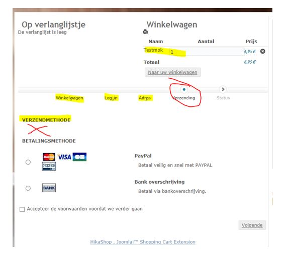

12 years 7 months ago #144167
Shipment methods don't show up at checkout
-- url of the page with the problem -- : www.de-koets.nl/joomla25x/index.php/ct-menu-item-15
-- Joomla version -- : 2.5.18
-- PHP version -- : 5.3.27
-- Browser(s) name and version -- : IE 11 / Firefox 27
-- Error-message(debug-mod must be tuned on) -- :

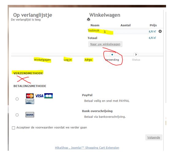

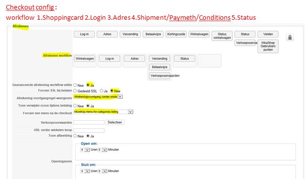

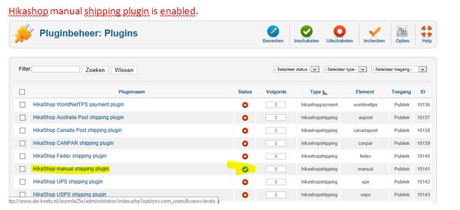

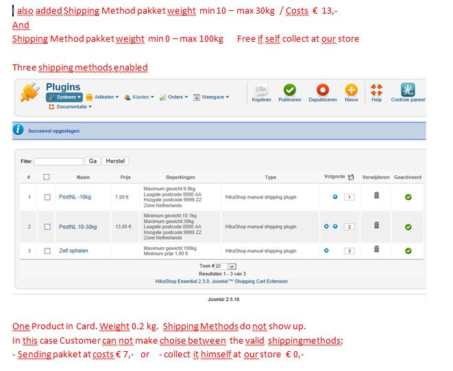

Before posting I read the manual, followed tips I found by Google, watched Vid tutoriuals and checked out this forum. Learnd something but can not solve the problem I have. That's valid shipment methods don't show up at checkout proces. You can not choos one.

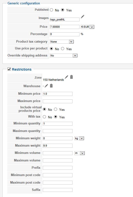

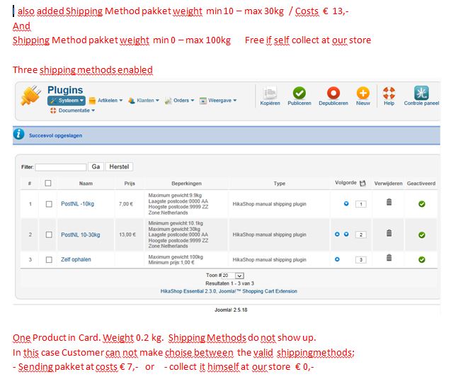

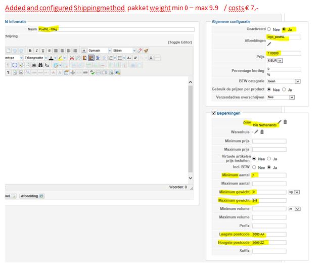

I used the manual shipping plugin to make 3 new shipping methods. All of them related to Weight. One for packages from 0 till 9.99 kg with costs € 7,- . One for packages from 10 till 30 kg with costs € 13,- . And one for packages from 0 till 100 kg with no costs if they pick it up at our store.
If a customer order a product (or more products) at total weight of 1kg, at the checkout he has to make a choise between two vallid shipping methods. namely Send package at costs €7,- of Pick up at store at no costs.
I tryed and puzzeld different configuration combinations but can't get it out. I hope you can help me out here.

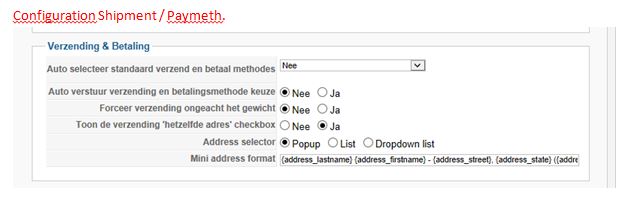

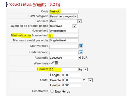

I added screenprints with the settings I have now. (but also don't show shipping methods)
Greethings

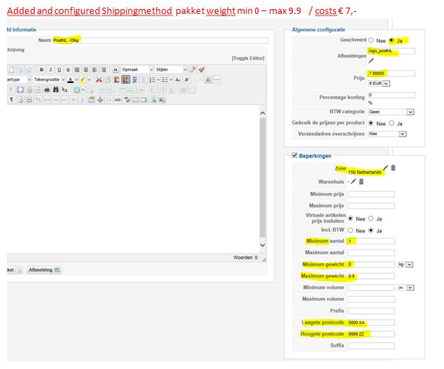

12 years 7 months ago #144220
Please remove the post code min and max restrictions and that should help.

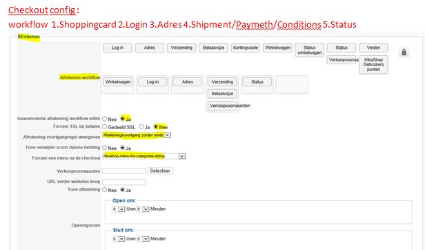

  • Posts: 7
12 years 7 months ago #144304
Well thank you Nicolas.
I removed the post code min and max restrictions at all 3 shipping methods but it didn't solve the problem. Configuration settings and shipping restrictions as how they are now, see attachements. Have an other idea?
12 years 7 months ago #144351

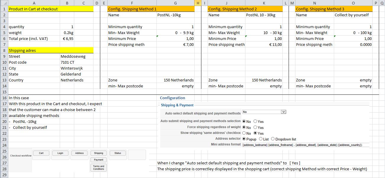

When you proceed to your checkout, can you tell me what is your order :
- total weight
- total price
- shipping address
So that I can tell you from where the problem is coming from ?
Thanks.
  • Posts: 7

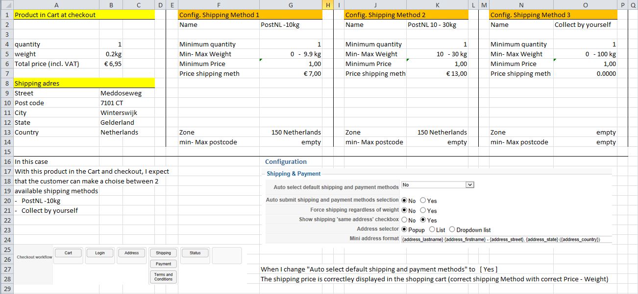

12 years 7 months ago #144447
I made an overview so you can see all in one. check attachment.

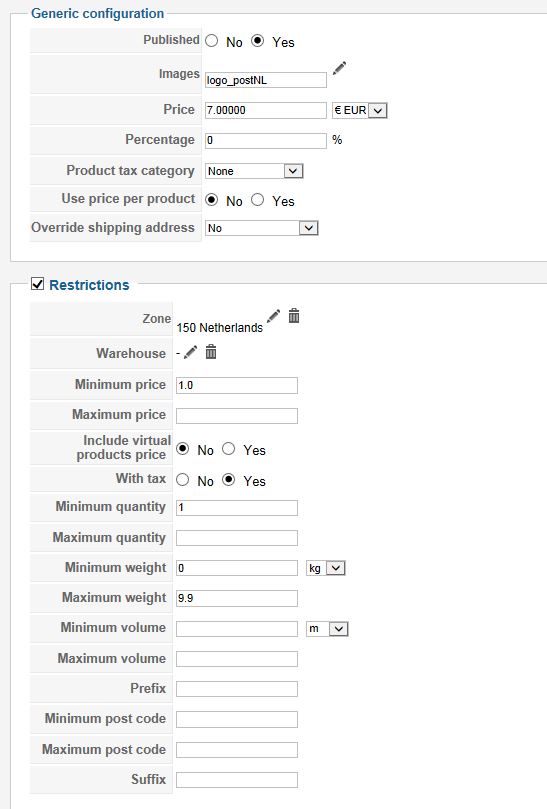

I also tryed to solve the problem by changing restrictions "Minimum Price" making empty of change 1,00 to 1.00
Did not solve it either.

12 years 7 months ago #144548
@iooi : Can you try it without any "Netherlands" zone restriction for your shipping methods ?

  • Posts: 7
12 years 7 months ago #144661
I removed "Netherlands" zone restriction for all shipping methods but either didn't solve the problem.
I'll sent you a private message with login for the back end.
Later I want to make more shipping methods because I also want to ship to Germany, Belgium and Luxemburg. Therefore I had the restriction "Netherlands" on the shipping methods I made so far.

12 years 7 months ago #144839
I made a fix directly in your view "checkout | shipping" (for both websites)
We will create a new HikaShop package including this fix.
Last edit: 12 years 7 months ago by Jerome.

  • Posts: 7
12 years 7 months ago #145036
Well thank you very much for your support. Didn't react yesterday because it was my birthday and had a party. Thanks for this birthday present! :cheer: Checked it and HS works fine now. Tested first order. :) :)
Updated this reply later this evening.
Oeps..... had to customize my joomla template, installed the customized version and the problem is back. :(
When I make yesterday's joomla template default again, everything is fine.
When can we expect the pakcage with the fix? Or can you show me how to fix this myself?
Last edit: 12 years 7 months ago by iooi.
  • Posts: 26387
  • Thank you received: 4078
12 years 7 months ago #145085
The new package is available. You can re-download HikaShop it will contain the fix.
Please check that you do not have an override for the view "checkout | shipping" in your template. If so, please remove it.
