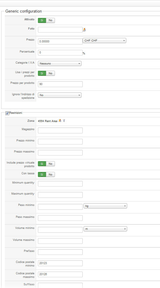

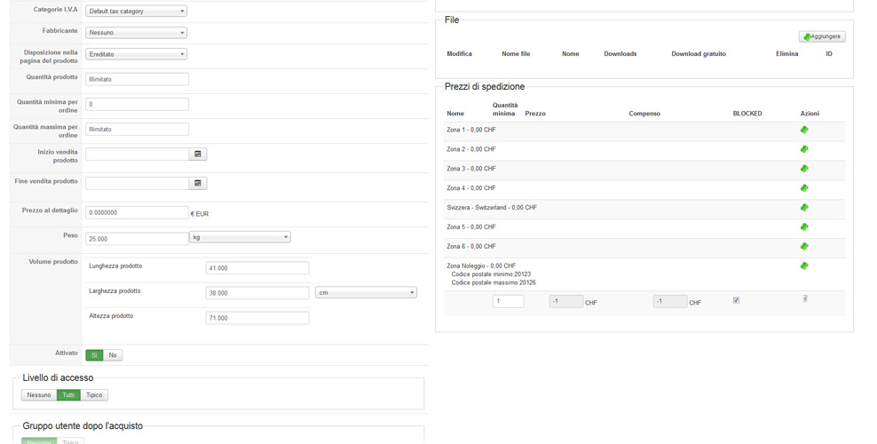

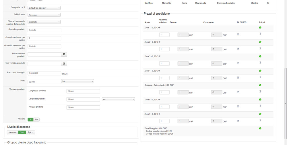

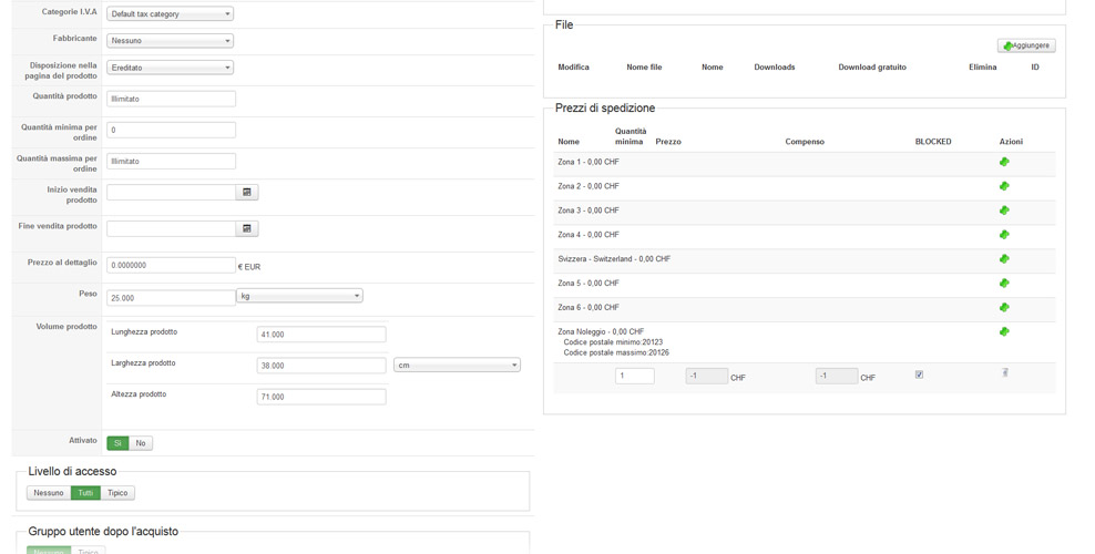

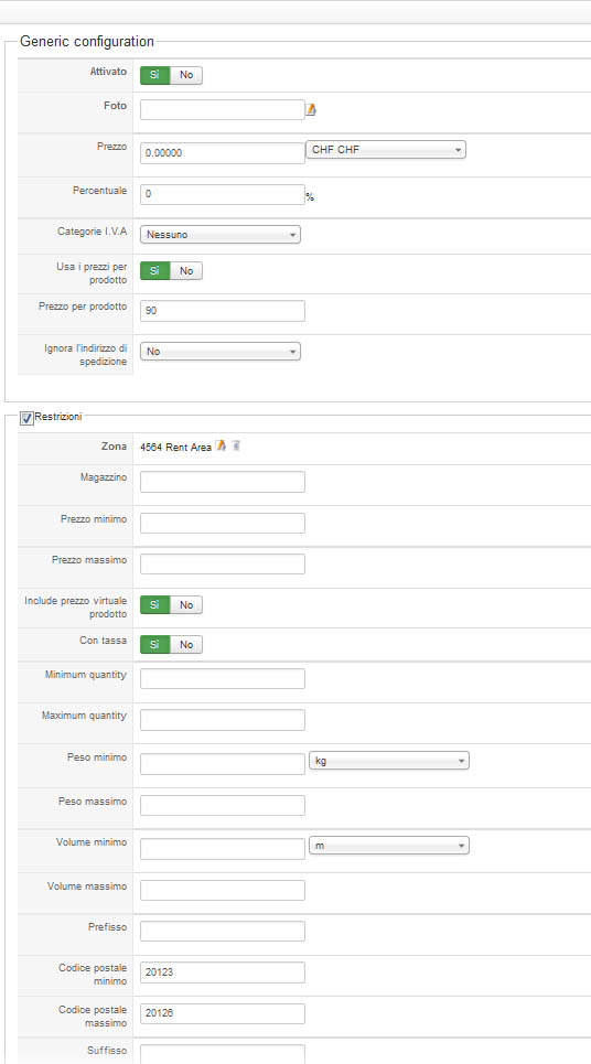

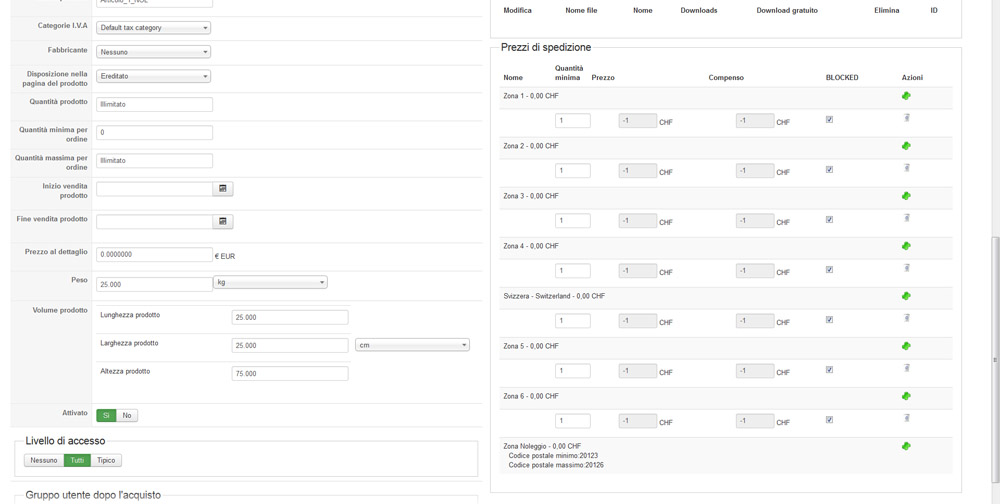

I have all the shipping zones set with "Use price per product" and these are the screenshots of the shipping and product configuration.
Is there anything else i should check?
12 years 5 months ago #146703
The solution will be to :
- Go to the product configuration page of the restricted products
- Check the "BLOCKED" checkbox for every shipping methods that you don't want to use for your restricted products
