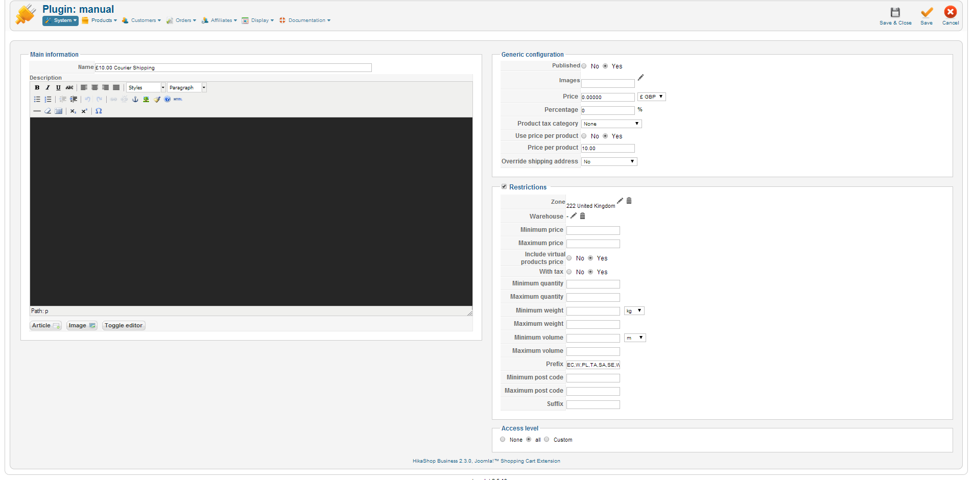

We wish to create some more complex shipping rules as follows:
1) Free Shipping
2) £10 per item charge to a selection of post codes such as EC,SE,SW,N,NW,TR etc
3) No shipping to post codes JE & GE which are jersey and gurensey as these are offshore.

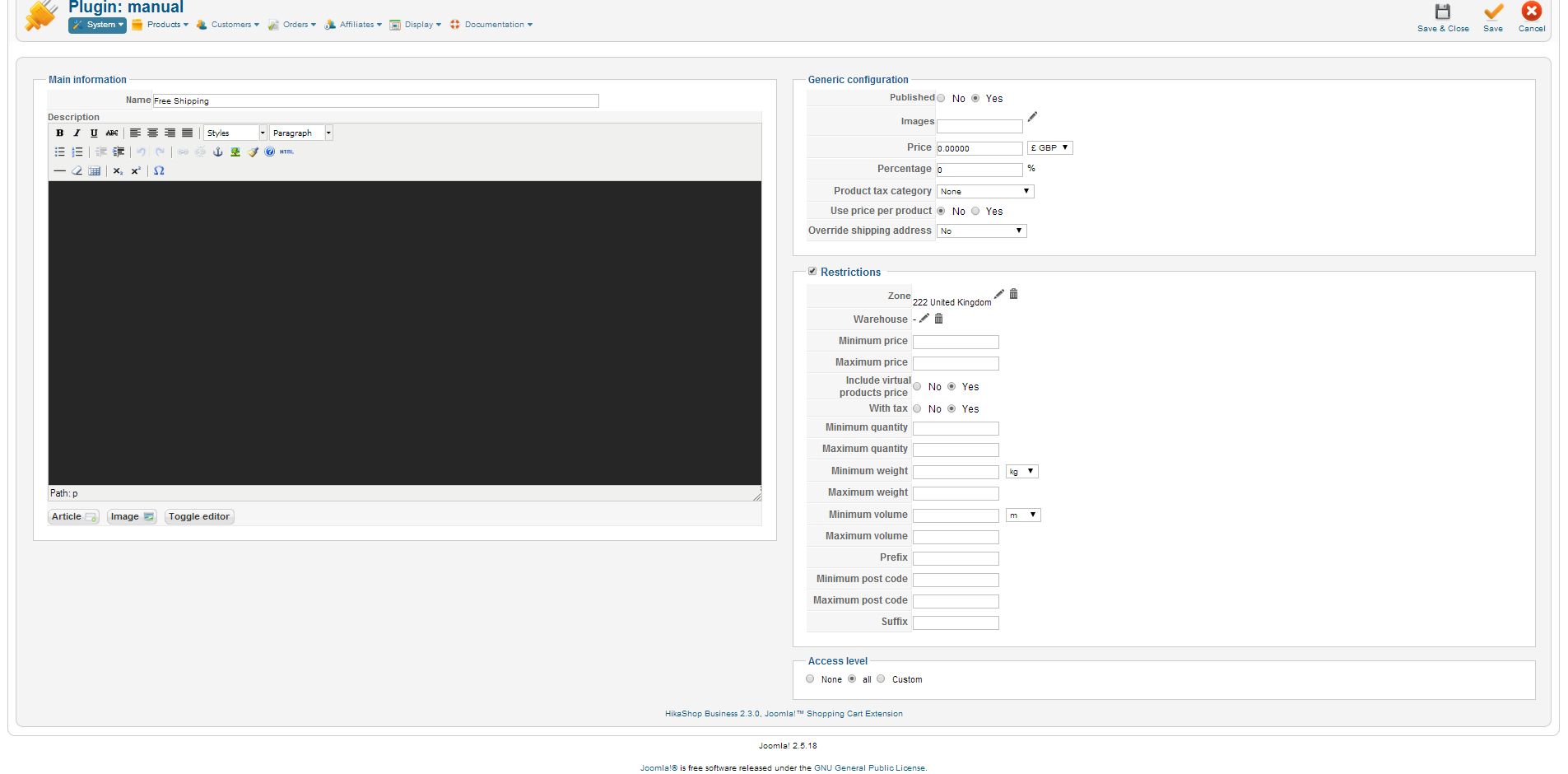

We have set up a free shipping condition (screen1)

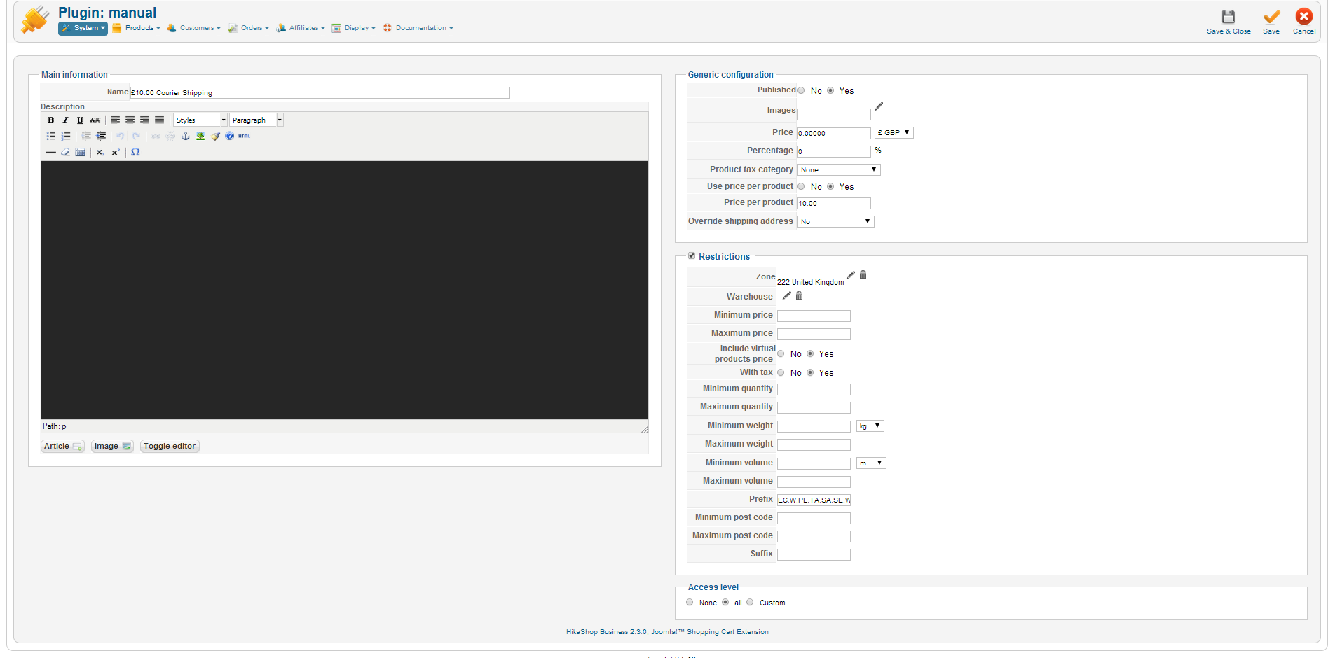

We have setup the £10 per item charge with another shipping method, with the prefix restrictions of EC,SE,SW,N,NW,TR (screen2)
When we test an order the free shipping shows for all UK addresses. Sure we are just getting something the wrong way round.
Also how can we completely restrict shipping to JE & GE postcodes?

  • Posts: 12
12 years 6 months ago #146354
HI Jerome,
Thanks for getting back to me.
So that I understand, we would need to have two shipping conditions:
1) 10.00 per item shipping condition that had the restrictions of the post codes we want to apply it to. eg. EC, SW, NW
2) Free shipping - With every UK Post Code in the restrictions except the ones above that have £10 and JE & GE as we dont ship there?
Hope that makes sense,
