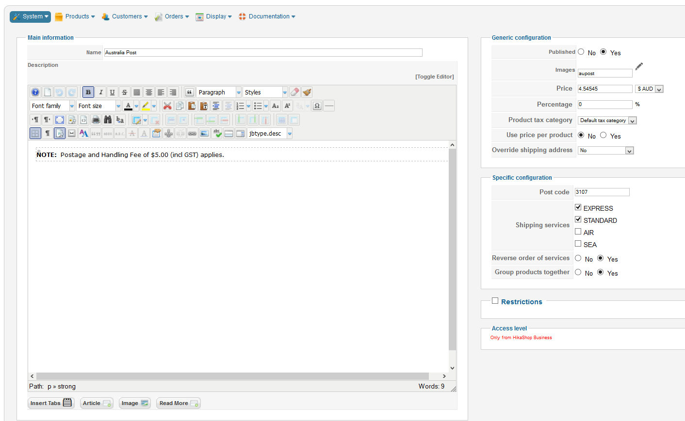

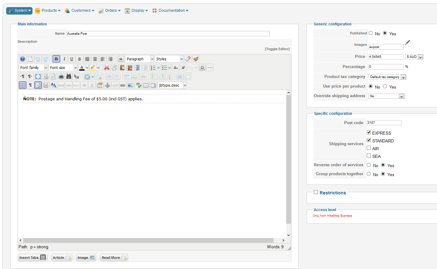

I have another problem. In the Australia Post module, I have an additional $5.00 charge for postage and handling. I have some text in the WYSIWYG and this text used to show on the front end - now it doesn't show. How to get this back?
Last edit: 12 years 4 months ago by Huski.
  • Posts: 86212
  • Thank you received: 14220
12 years 4 months ago #154476
Hiding a field on the frontend is actually really easy with CSS.
For the country field, you can just add that CSS:
.hikashop_registration_address_country_line{display:none;}
Regarding the description of the shipping methods, I had it displayed on your website 2 days ago when I looked at it. So I don't know what you did since then but I guess reverting what you did would help. Are you sure that you didn't remove the text from the shipping method option ? Did you modify the file 'shipping' of the view "checkout" via the menu Display>Views in some way ?
  • Posts: 301
12 years 4 months ago #154488
I haven't touched the australia post plug-in at all. The text from the WYSIWYG is still there but not showing on the front-end. Haven't touched the views either.

12 years 4 months ago #154837
Regarding your australia post description issue, you should probably remove the customization that you have made through the "shipping" file of the "checkout" view of your front-end template and test it again.

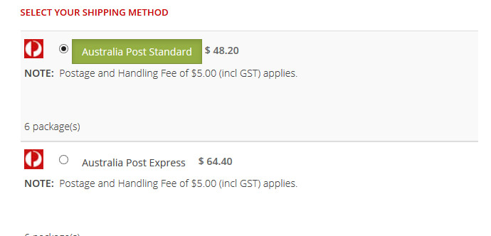

Ok - with Joomla 3 - I am getting the Shipping Note showing now after reuploading Hika.
All Good.

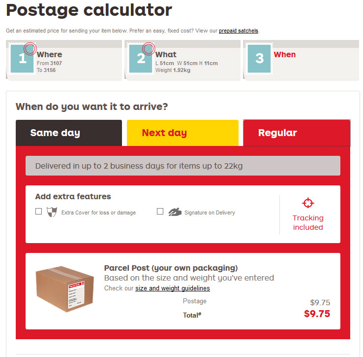

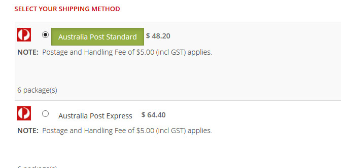

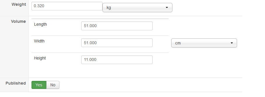

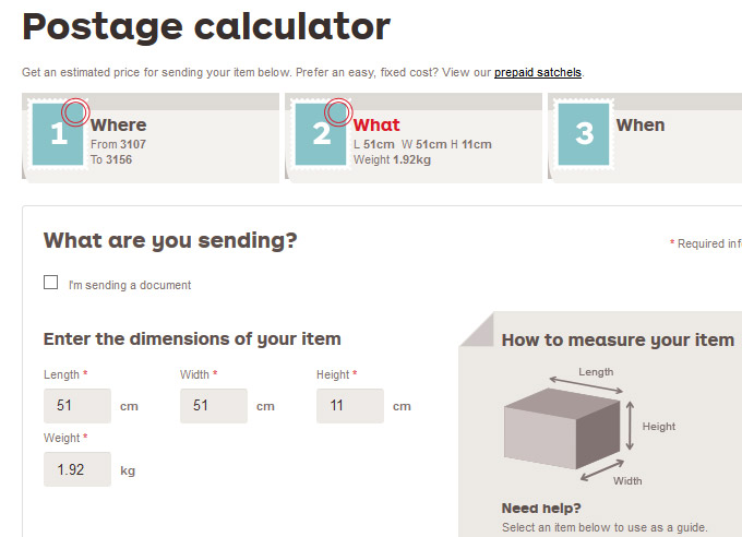

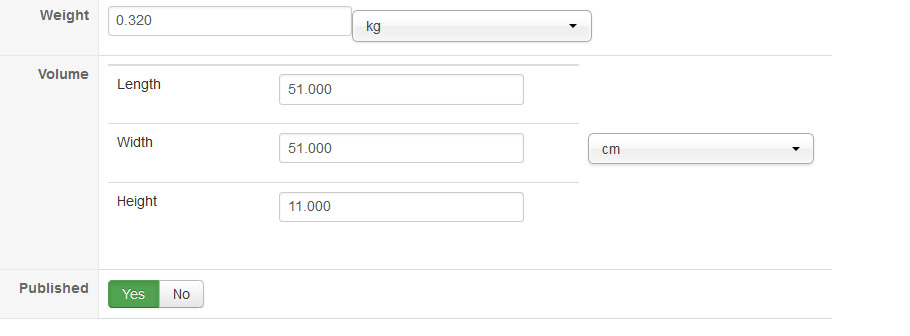

I have just done a test booking using the Australia Post package and my products.
Product weight: 0.32kg
Length: 51cm
Width: 51cm
Height: 11cm

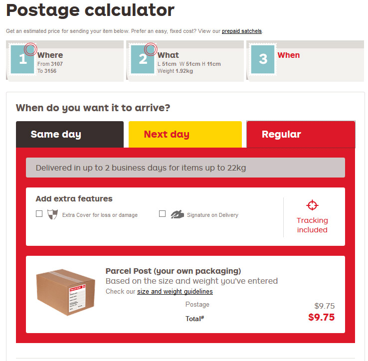

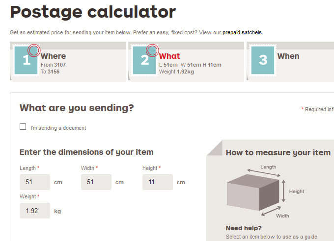

I ordered 6 of the products.
The total shipping in Hikashop has come to $43.20 plus $5.00 handling charge.
I went to the Australia post website and checked on there putting in the same dimensions and weights and the total was $9.75. If Hika made the right calculation I would also add $5.00 on top of that for a total of $14.75.
So thats a huge difference between what Hika Australia Post calculator is doing compared to Australia Post website.
This is in the Joomla 3 version of my site as well as on the Joomla 2.5.
What is going wrong? See the images attached.
