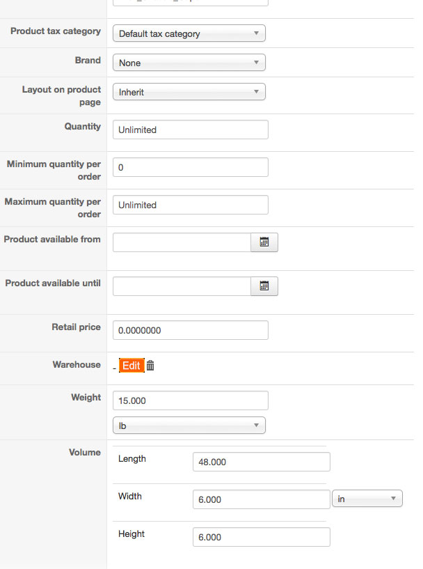

I'm having a really tough time trying to get the UPS shipping plugin to display the correct price/rate.
Product Info:
- Weight : 15 lbs
- Dimensions: 48 x 6 x 6 inches
Ship From:
- Beloit, 53511 USA
Ship To:
- Janesville, 53547 USA.

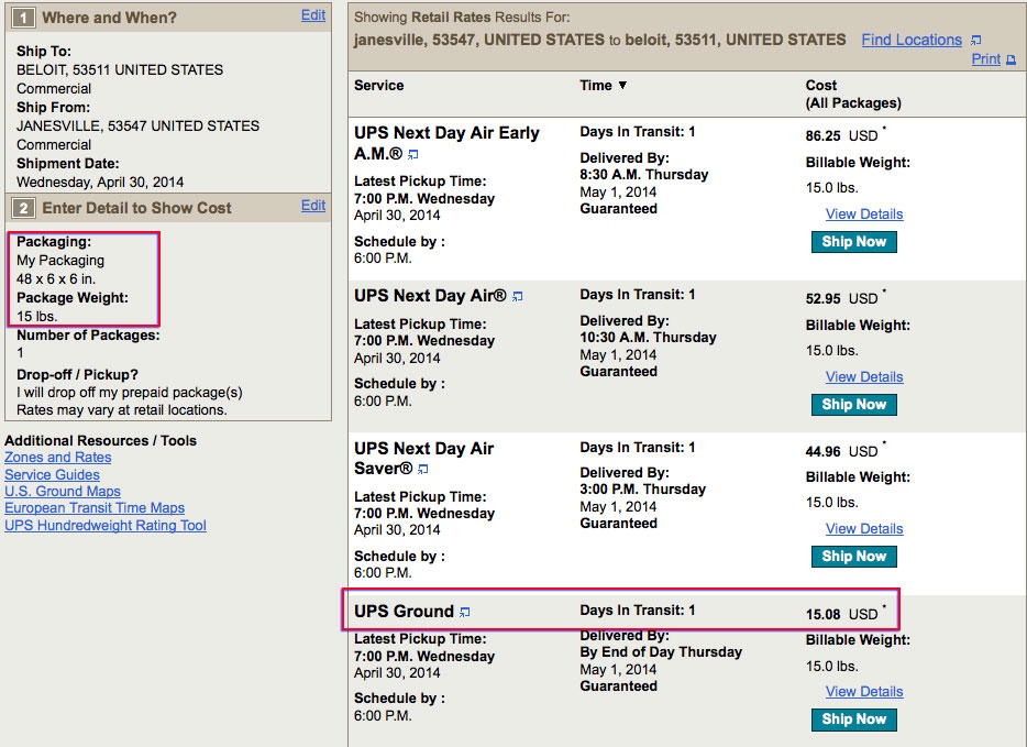

The UPS Calculator says:
UPS Ground - $15.08

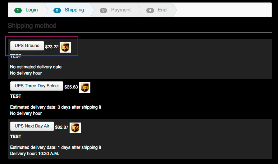

Hikashop says:
UPS Ground - $23.22

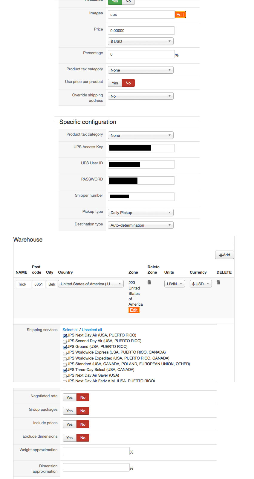

I've done my best to troubleshoot the issue using the points from the post below, but no luck.
- www.hikashop.com/forum/2-general-talk-ab...-ups-rate-sheet.html
I've also attached a few pics of the Prodcut settings and the UPS Shipping Plugin settings.

There are several options of the UPS plugin which can change the rates calculated by UPS besides the warehouse information:
The pickup type, the destination type, the negotiated rates, the include prices, the exclude dimensions and the group packages option can all generate a different price.
From your screenshot of the UPS calculator, it seems that you selected a different pickup type than what you have configured in the plugin. And you configured a "commercial desitination" in the UPS calculator but not in the UPS plugin.
