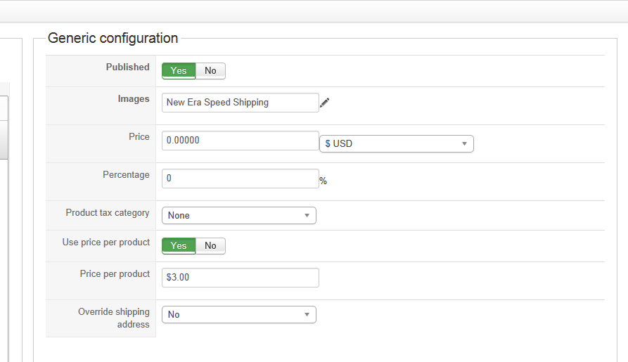

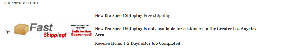

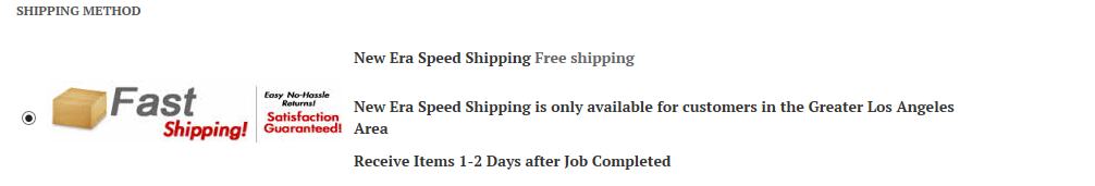

ok this is really simple but for some reason cant get it to work. I already installed manual shipping methos but I want it to add $3.00 per product in cart. I already inserted $3.00 per product in shipping method but for some reason it still says free shipping
12 years 4 months ago #154823
1. Did you set a weight and dimensions through your product configuration page ?
2. are you sure that it's the shipping method that you showed me that is displaying ?

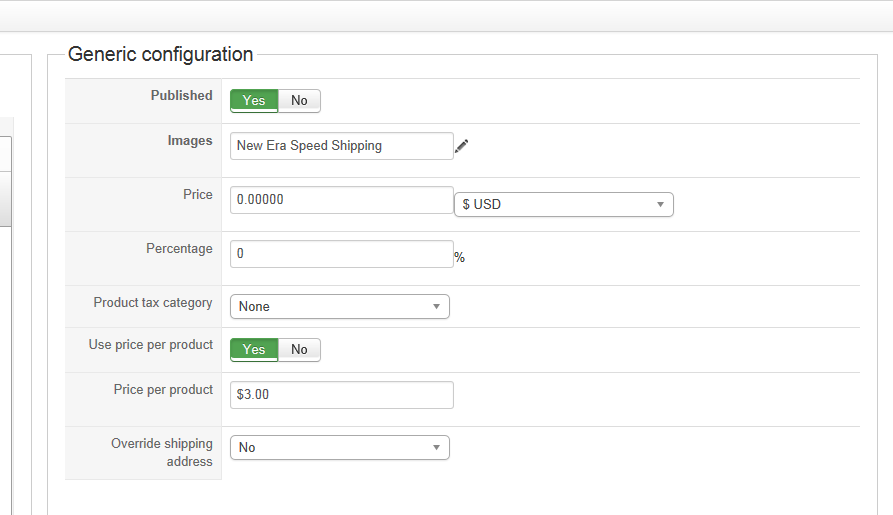

1. In the "price per product" field, please enter only 3. The dollar in the field is messing up the with the system. It should then work automatically.

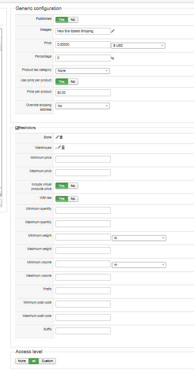

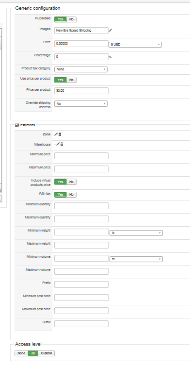

12 years 4 months ago #156592
Are you sure that you don't have any restrictions on the weight in your shipping method parameters ?
Thanks to give us a screenshot of its configuration.
As temporary fix, you can use the mass actions and set a weight on all your products where the current weight is equal to 0.

12 years 4 months ago #156632
Here is how I have the shipping setup:
The weight restrictions is not set on any of the shipping records:
