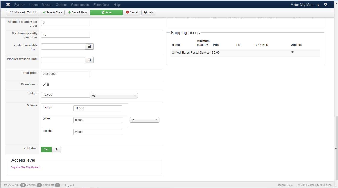

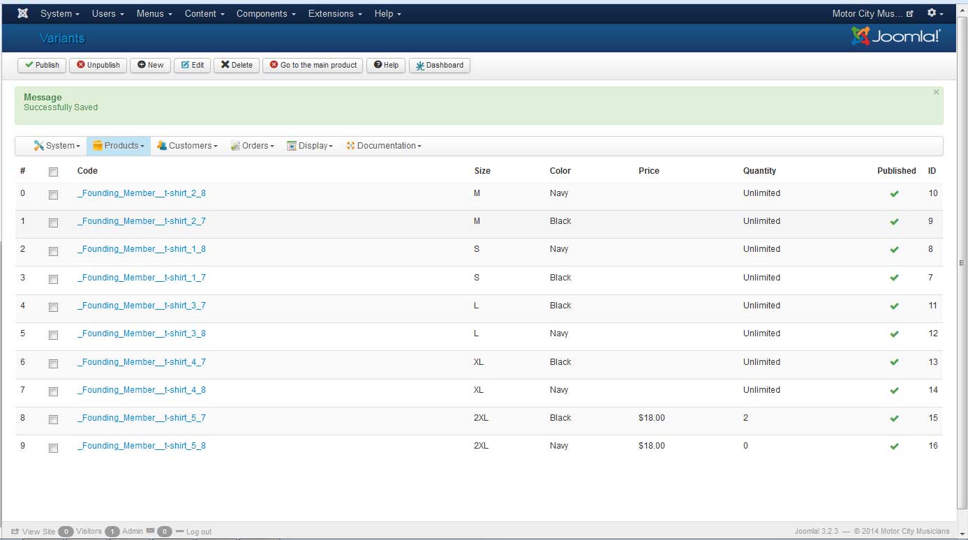

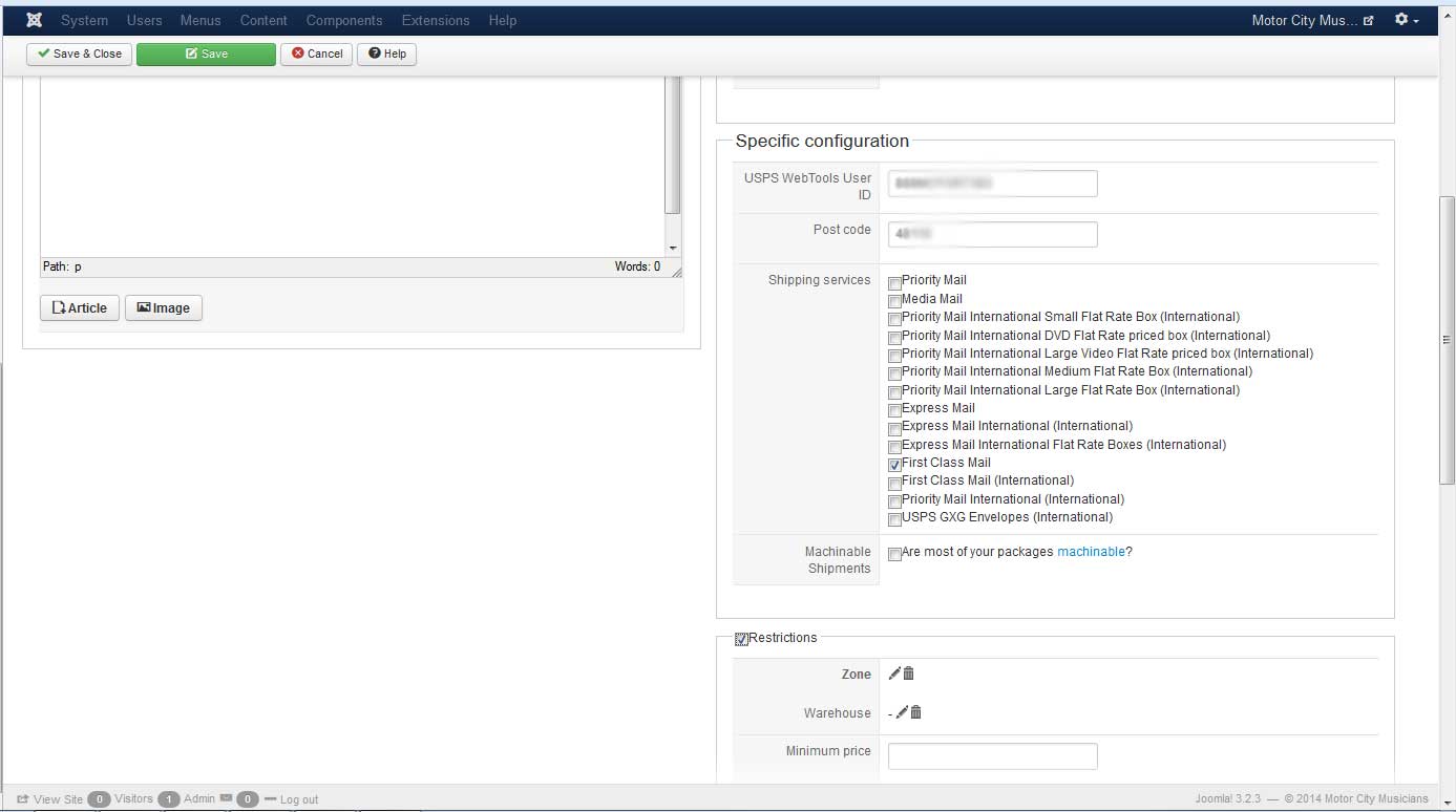

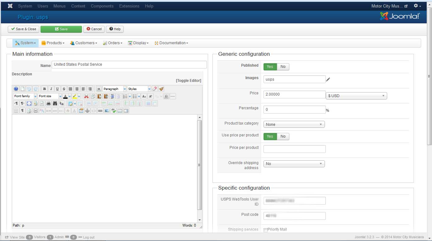

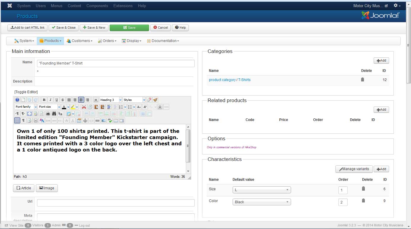

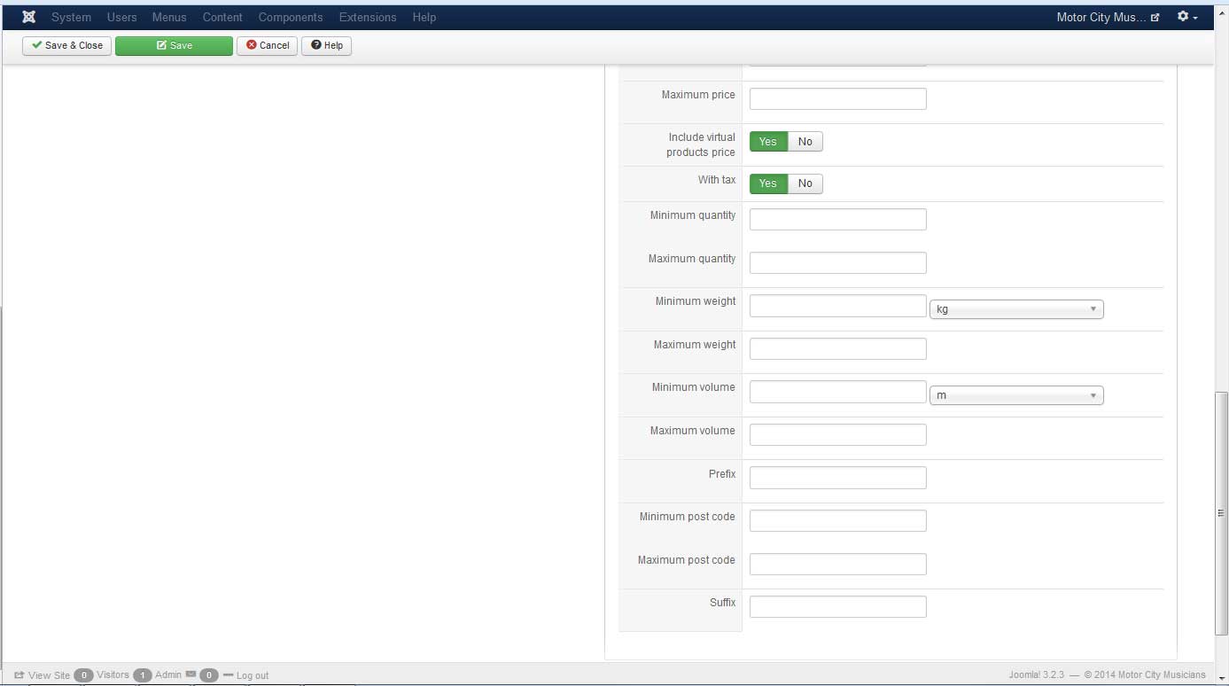

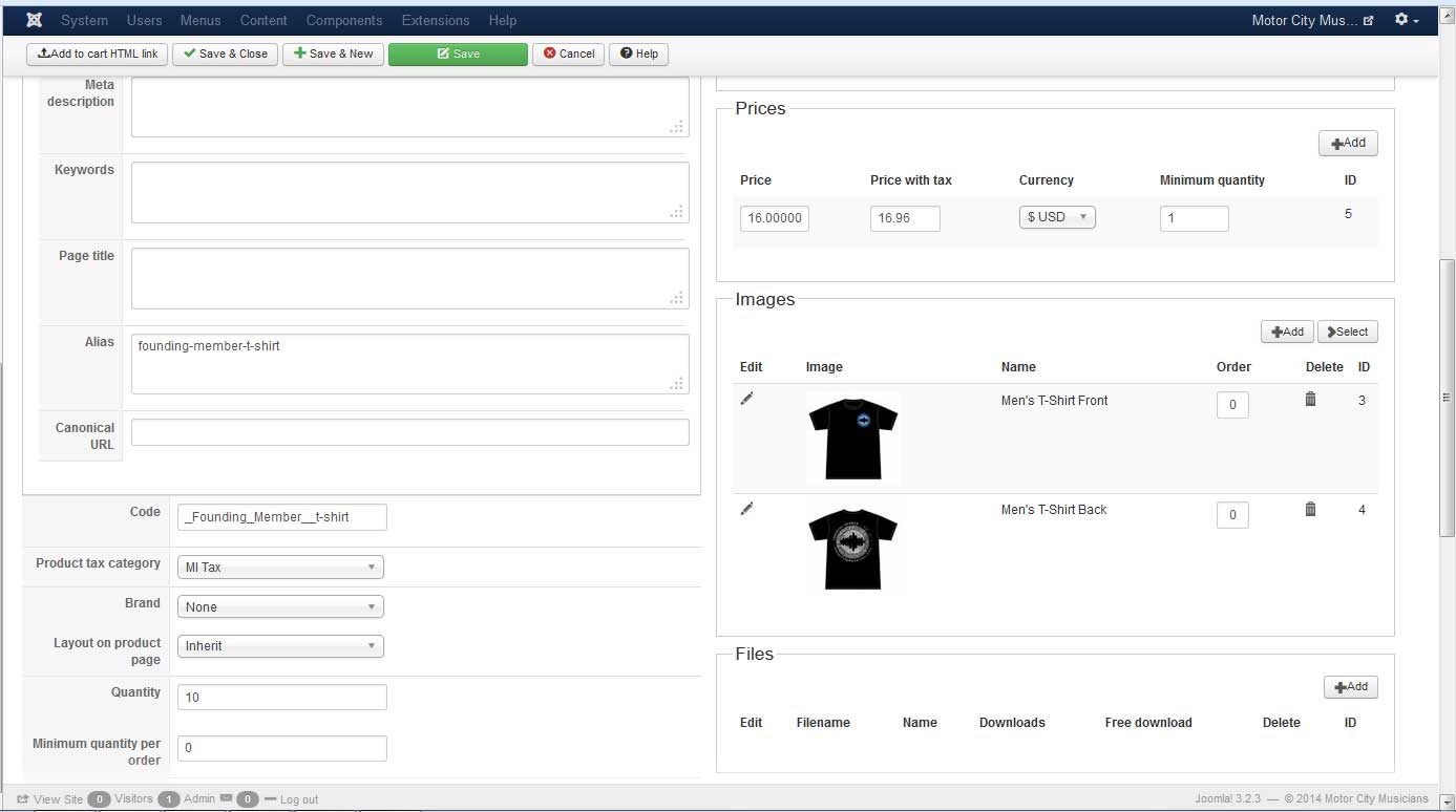

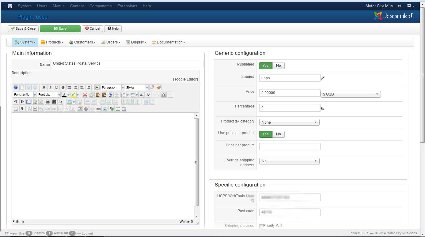

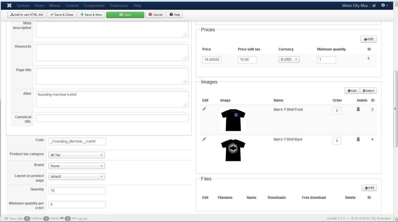

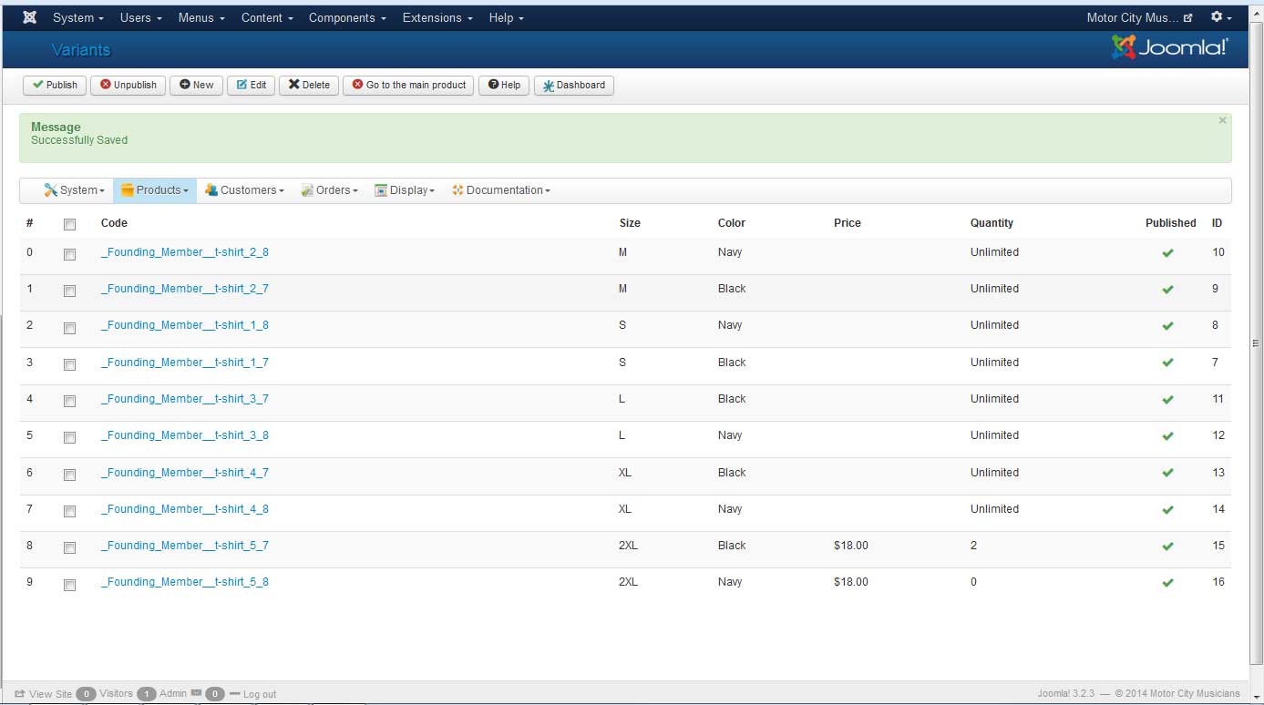

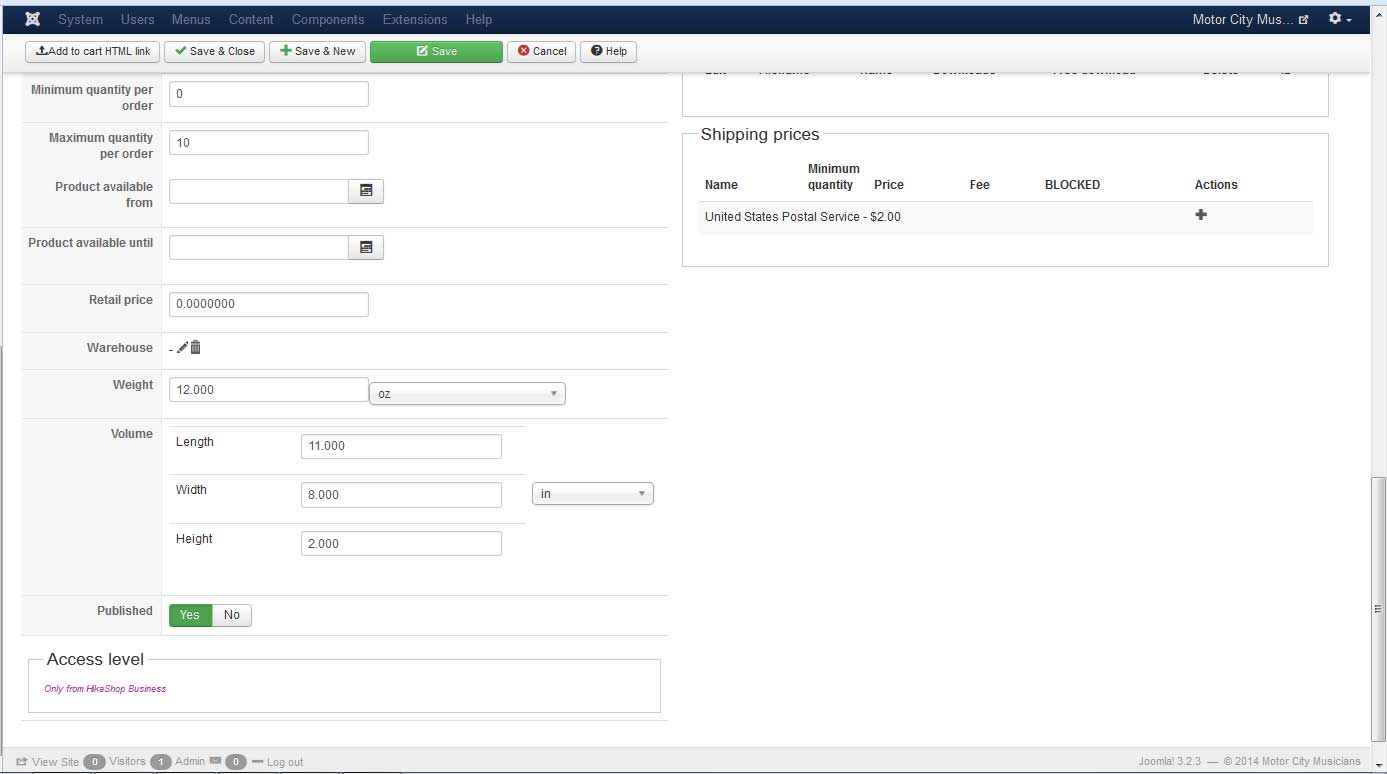

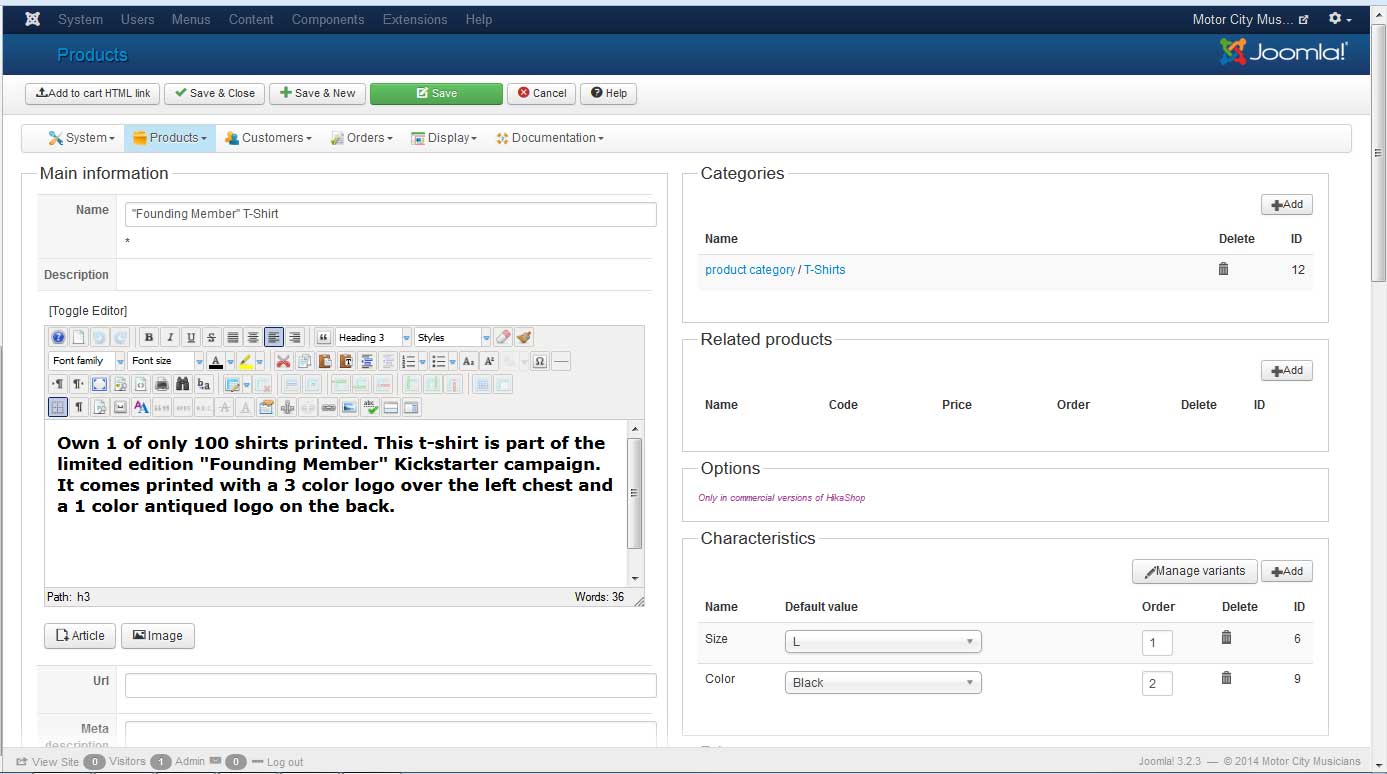

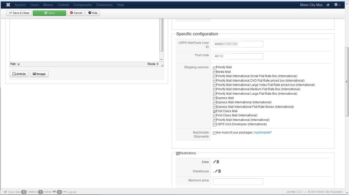

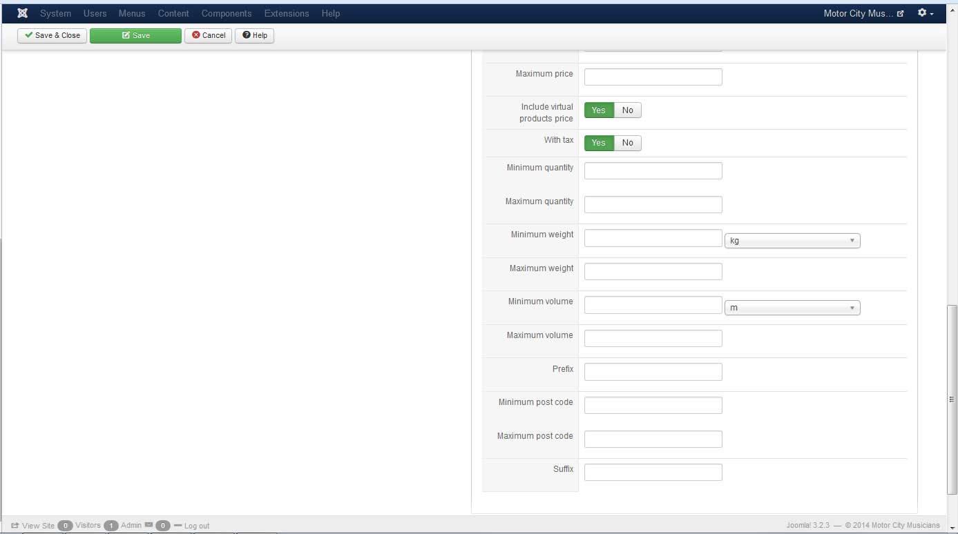

Can you show me how did you configured through some screenshots :
- Your USPS shipping method
- The product that you are using on your checkout workflow.
  • Posts: 5
12 years 4 months ago #155765
Here are screenshots of the requested pages. Let me know if more are needed.

The first issue that I have come across is that the shipping value disappears from the checkout screen if I increase the quantity and refresh. "No shipping method found" also gets displayed at the top of the screen.
I think that your issue is coming from the fact that when you're increasing the quantity of the product in your cart, the "First class Mail" USPS service isn't available anymore because the weight or dimension limit was exceeded.

That seems to make sense since it comes back once reduced back to 1 but how do I set a limit or remove any limits that are causing this?
I want people to be able to order more than 1 as a quantity.

12 years 4 months ago #156136
It looks like turning off the "Price Per Product" option has resolved the issue.

12 years 3 months ago #157767
First Class shipping has a weight limit of 13 oz.
Last edit: 12 years 3 months ago by Drakenator.
12 years 3 months ago #158044
Yes, like it's said on the USPS developer documentation.
