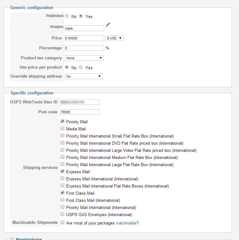

Upgraded to 2.3.1 now and the error is gone, but I'm not getting any shipping pricing now. I just have the USPS plugin module enabled right now with no restrictions. Attached is the settings I do have on.

Sorry for the late reply, your issue is coming from the fact that you unpublished the "address_country" custom field for your front-end through "Hikashop->Display->Custom fields".
The solution will probably be to use this last version of the USPS shipping plugin :
Note that with that version, if you disabled the country field, the country will be automatically set to US.

12 years 4 months ago #156419
That worked! Thanks so much. Didn't even dawn on me that removing that country option would be the problem. Thanks for having a USPS version that bypasses that.
