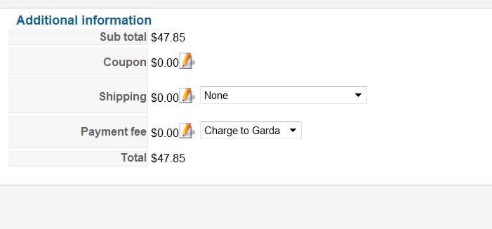

how to set the default shipping value to internal
  • Posts: 25
12 years 3 months ago #160466
-- HikaShop version -- : 2.0
-- Joomla version -- : 2.5.8
-- PHP version -- : 5.3
-- Browser(s) name and version -- : N/A
-- Error-message(debug-mod must be tuned on) -- : N/A
I know we are still using an old version of Hikashop but it was highly customized at the time for our customer's need. So we can't upgrade for now.
Our client ask if it is possible to set the default shipping value to "internal" instead of "none". As it is, the "Internal" value is the second one in the drop list.
Thanks in advance for your support!
Jenny
  • Posts: 26386
  • Thank you received: 4078
12 years 3 months ago #160523
I don't think it will be possible like that.
The problem is not really to set the default shipping, it is to change the default shipping when an order is completely empty.
Because you are talking about the "shipping method" set in an order when you create it thought the backend, not from the front-end.
It is not possible to have a "none" shipping method in the front-end if you have some shipping methods available.
So, except by using a custom plugin to change the order created in the backend (onBeforeOrderCreated), I don't see any simple solution.
It will require some PHP skills.
www.hikashop.com/support/support/documen...r-documentation.html

  • Posts: 25
12 years 2 months ago #160642
Hi Jerome,
Thanks for your help. Is it possible to turn off all the other shipping option and just have none and internal as values?
I turned off all the shipping plugins expect the manual shipping.
Thanks!
Jenny
  • Posts: 86179
  • Thank you received: 14214
12 years 2 months ago #160652
You need to delete the shipping methods via the menu System>Shipping methods, not just disable them.
