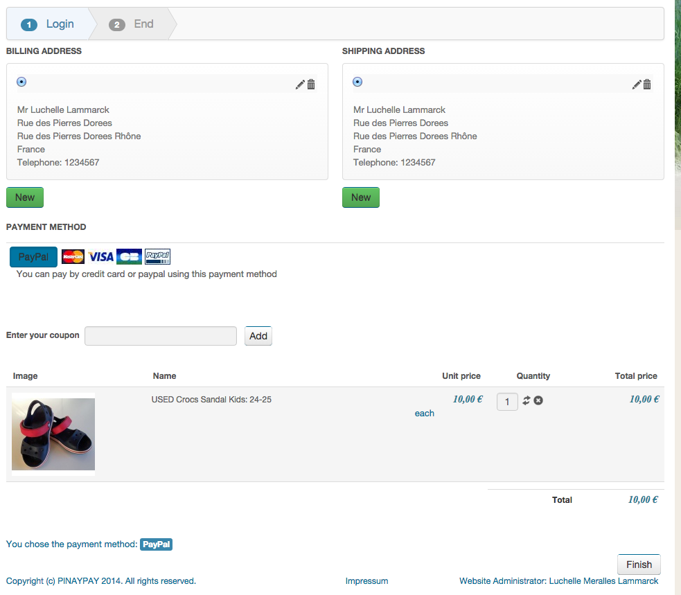

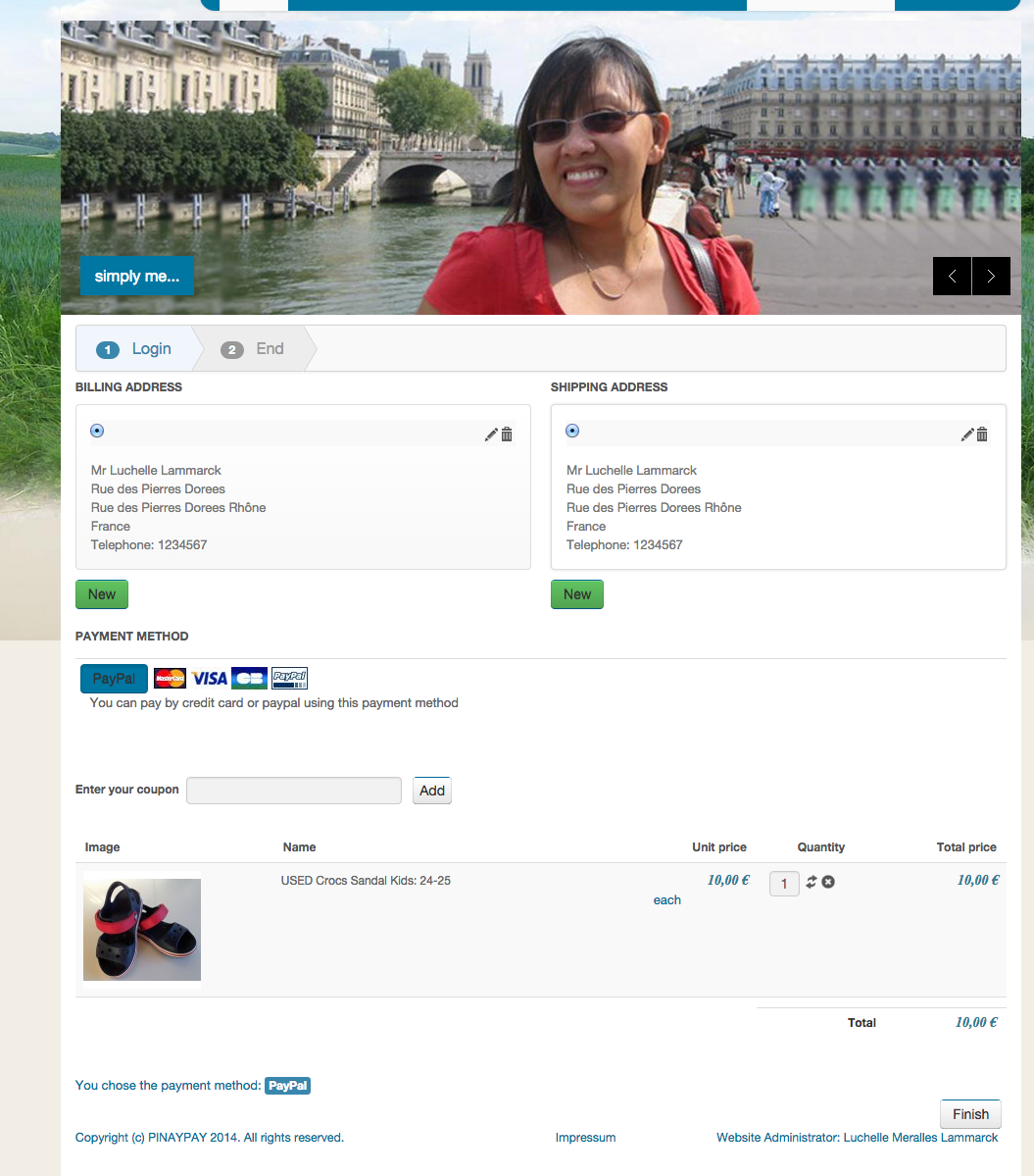

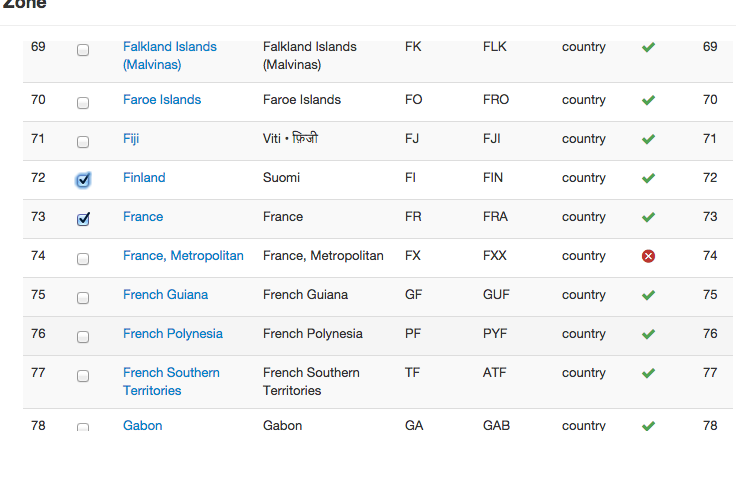

11 years 10 months ago #172101
I tried to do check the countries under zone restrictions but it doesn't seems to work? It only show the last country being checked? Can this normally happen?
I tried to make an order and shipped to a country which I included in the zone ex. france but it doesn't work. The shipping method is not showing.

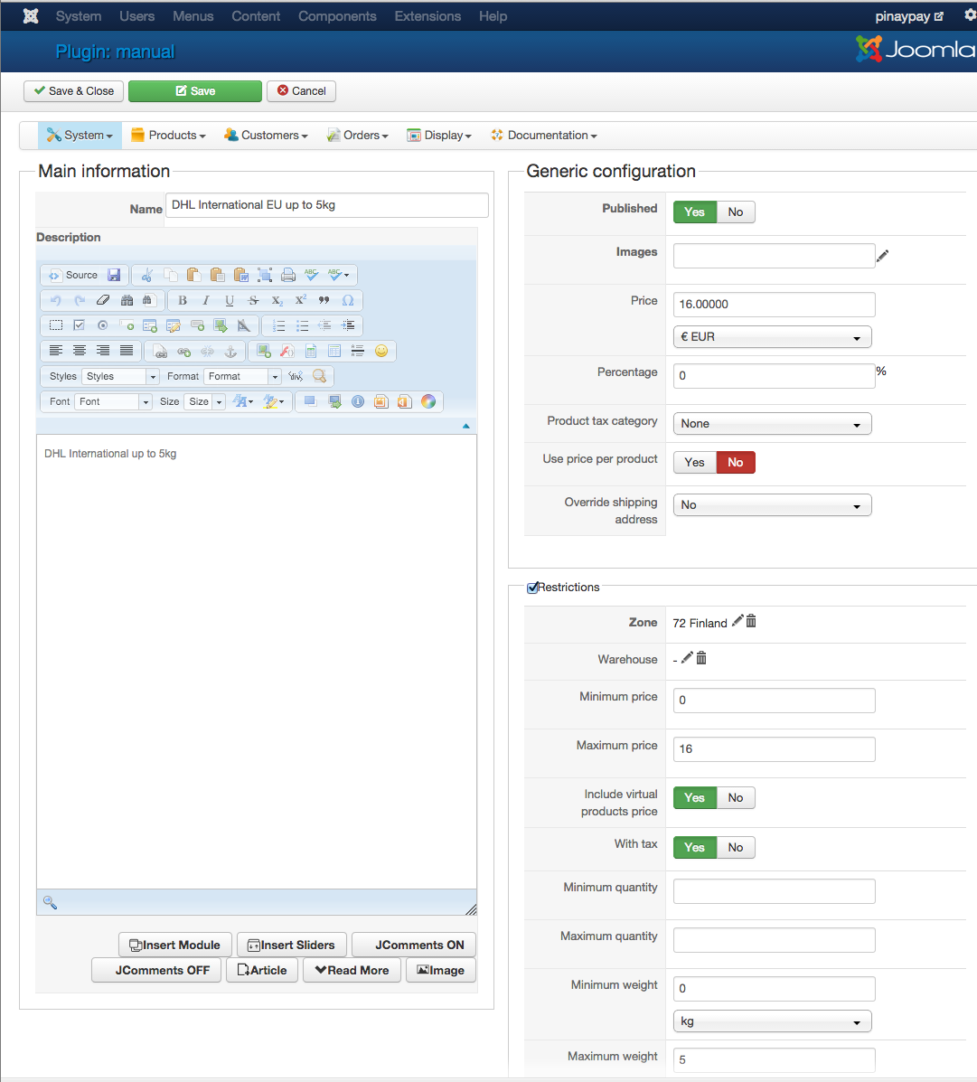

11 years 10 months ago #172103
Sure,
Can you show me how did you configured your shipping method through some screenshots and also tell me if you have correctly added the France country zone which have the ID number 73 through the "Zone" option of your shipping method configuration page.

11 years 10 months ago #172204
Hi here I attached the files. I wonder why it only shows the last or first one being clicked and when I tried to choose one of the selected country, the shipping method doesn't show.
  • Posts: 9
11 years 10 months ago #172223
Hi I think I found the problem.
I just logged-in in your demo domain/website and see that there is a Europe Zone created. I think I will just have to do it the same way to gather all countries I want to include in a zone.
