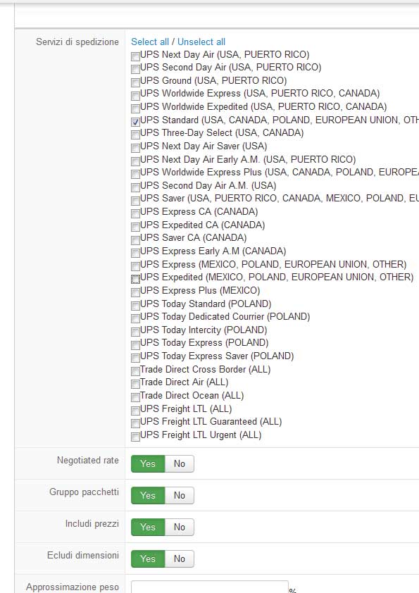

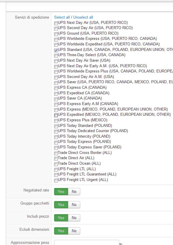

11 years 11 months ago #175815
yes i did! you can check by screenshot. I think the problem is for Italy localization.
waiting for your kindly feedback
11 years 11 months ago #175843
Ok,
And do you see a difference if you set the "Negotiated rate" option to NO ? Because the UPS plugin ask for the Negotiated rates and it's just displaying the rates that are sent through the UPS response.

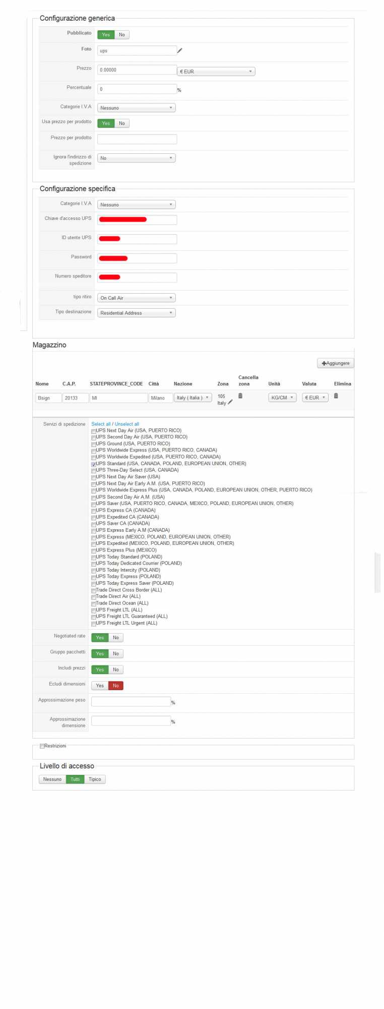

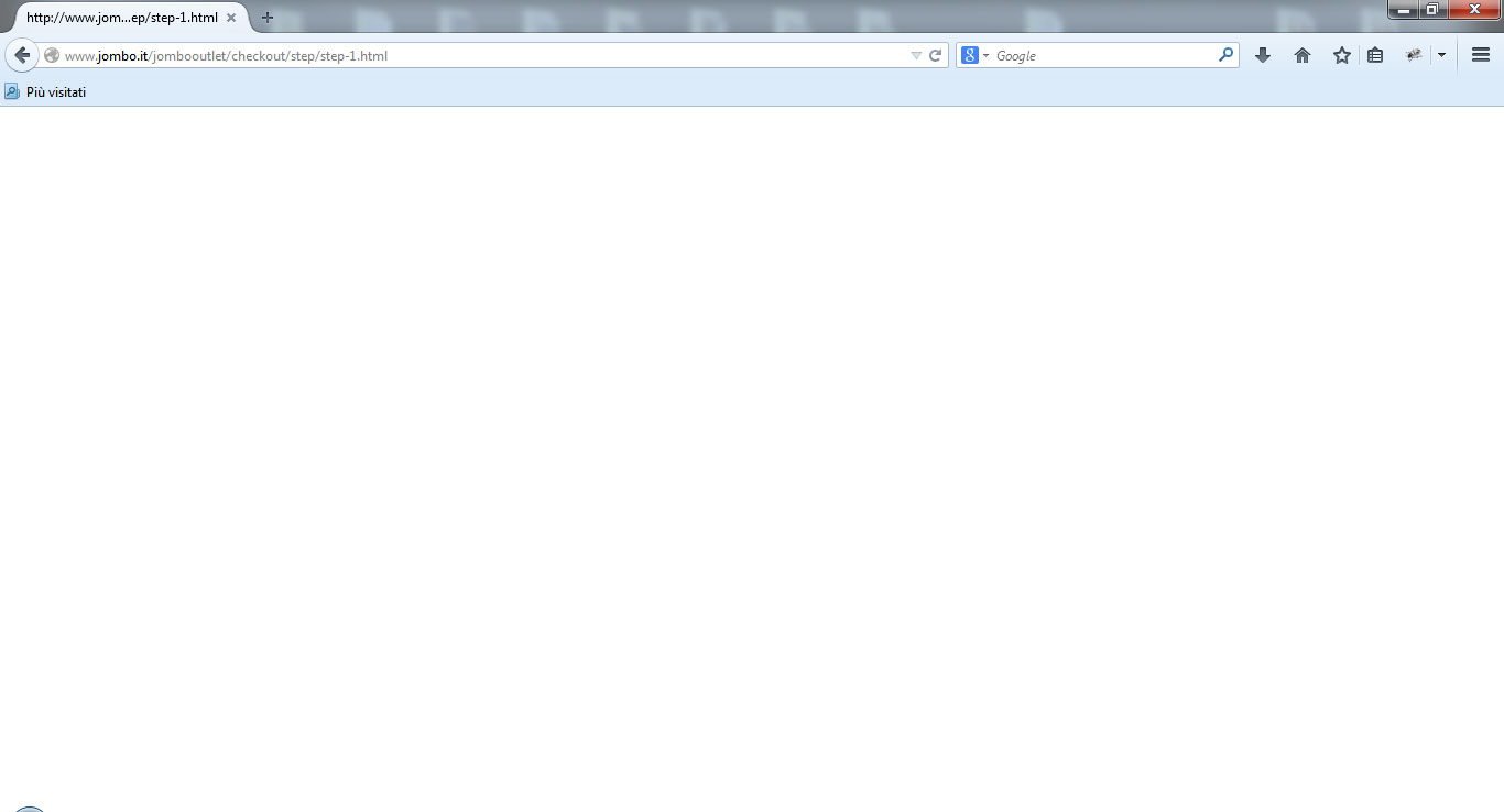

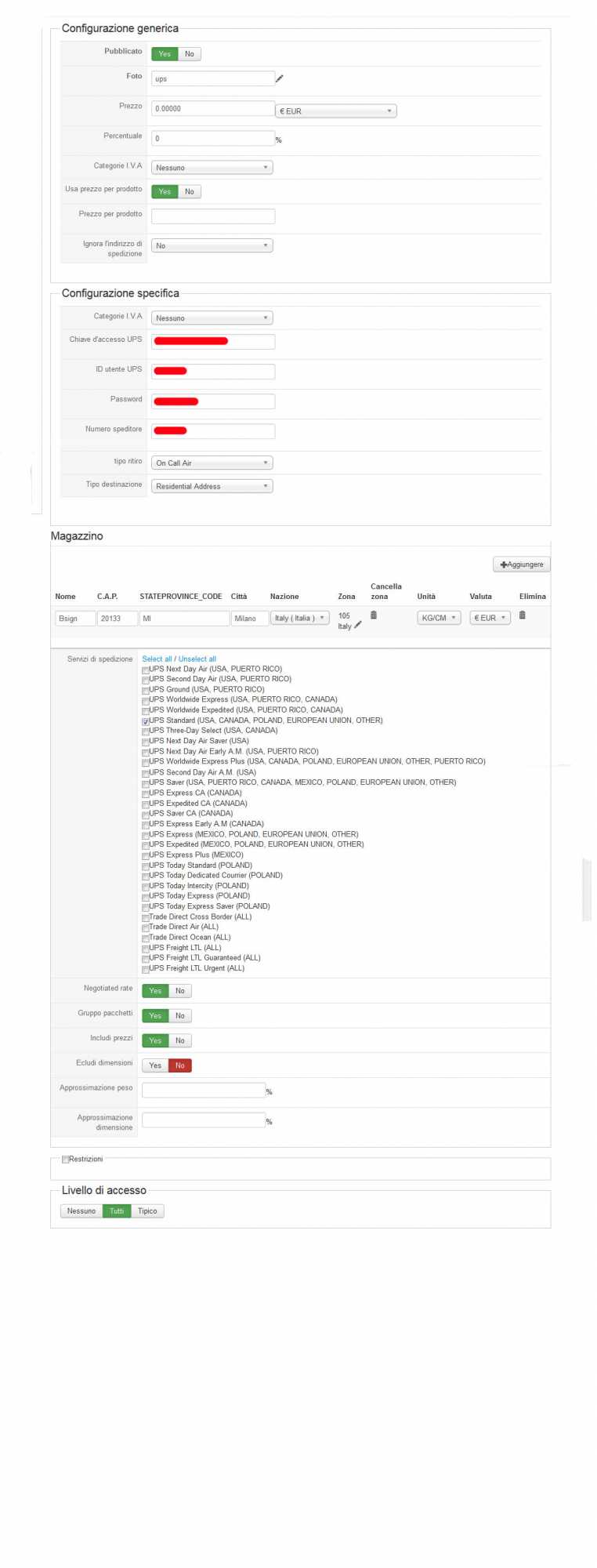

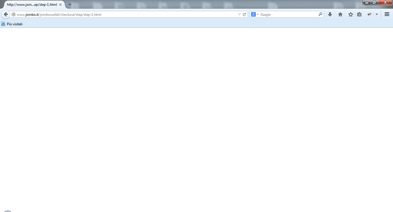

  • Posts: 21
11 years 10 months ago #179936
Dear Mohamed,
I have filled stateprovince_code as your info.
to b sure i have attached the configuration printscreen.
If i able the UPS plugin checkout is blank page, if i disable checkout work properly.
Your account is stil lworkig in my ecommerce, can you be so kind to investigation plugin problem?
Waiting for you rfeedback
thx
Andrea
