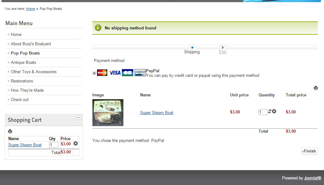

-- Error-message(debug-mod must be tuned on) -- : No shipping method found

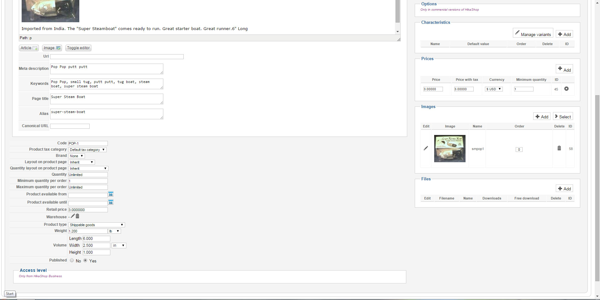

Updated to 2.3.3 (was not working on previous version either).
Product has a weight and all demensions
No restrictions on product

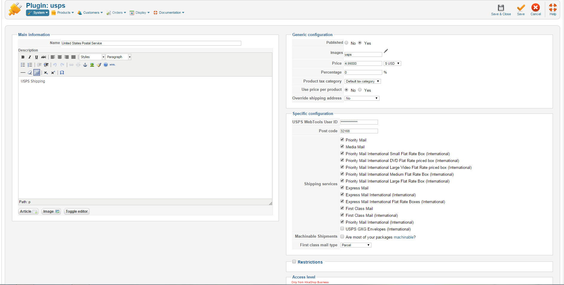

Only using USPS plugin, and I have input the USPS API user ID in Hikashop setup
Works if I set it to virtual goods

Can you show me through some screenshots how did you configured your USPS shipping method and the product that you have added to your cart so that I can directly test it ?
Thanks ?
  • Posts: 6
11 years 11 months ago #176423
Attached screen shots as requested. If you need other information please let me know and I will get it.
