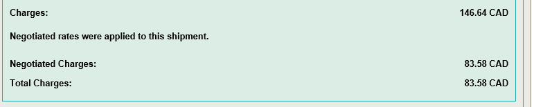

10 years 11 months ago #210999
I tried negotiated rate but I am getting regular price.It does not make any change if I change negotiated setting to "Yes" or "No".I am able to see negotiated rate on UPS.com but not in hikashop.Could you please tell me if there is any setting I need to do on UPS?

  • Posts: 64
10 years 11 months ago #211074
I checked xml and I am getting negotiated rates with regular rates.So it seems code is handling only regular rates.After changes I am able to get negotiated rate.Below is the code changes in if condition if(!empty($is_negotiated_rate)) {,it would be great if you can confirm if this is fine.
