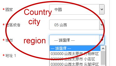

  • Posts: 27
10 years 2 months ago #244528
Thank you for your reply.
The picture I attached was a screen capture from another website I found online. And I think maybe you can help me set up like that. In the "region" option, I would like to check the zone and the zip code, as what you said to turn it to be a dropdown instead of a text field. Also, when I try to choose some of the cities in Taiwan, it turns out that I cannot find the correct regions.
Hence I was wondering if you can deal with the aforementioned problems. Thank you.
Last edit: 10 years 2 months ago by hlv008.
  • Posts: 86187
10 years 2 months ago #244557
I'm sorry but I don't understand what you mean.
What do you mean by " I cannot find the correct regions" ?
Where do you " try to choose some of the cities in Taiwan" ?
When you say "I would like to check the zone and the zip code", where do you want to do that and what kind of check do you want to do ?
What do you mean by "In the "region" option" ? There is no such field by default. Are you talking about the "state" field ?

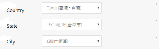

  • Posts: 27
10 years 2 months ago #244726
The picture I attached is the setting we could see now.
However, after I click the state I want, I can not see the change.
(All the states do not share the same cities.)
I was wondering if you could tell me how to deal with the issue, thanks.
  • Posts: 86187
10 years 2 months ago #244727
So your question is "How to configure cities as sub zones for states and have them refresh when the state changes ?".
There is no such system in HikaShop.
HikaShop only handles dynamic refresh between state zones and country zones.
So if you want to have cities dynamically refresh, you would have to configure them as state zones, then configure states as country zones, rename the address_country field as state and the address_state field as city, and deactivate the address_city field.
That supposes that you would only ship to one country.
If you need to ship to several countries, I would recommend to leave the fields and zones as they are by default, and leave the address_city field as a text input field so that the customers can write themselves the name of their city.
Time to create page: 0.185 seconds
