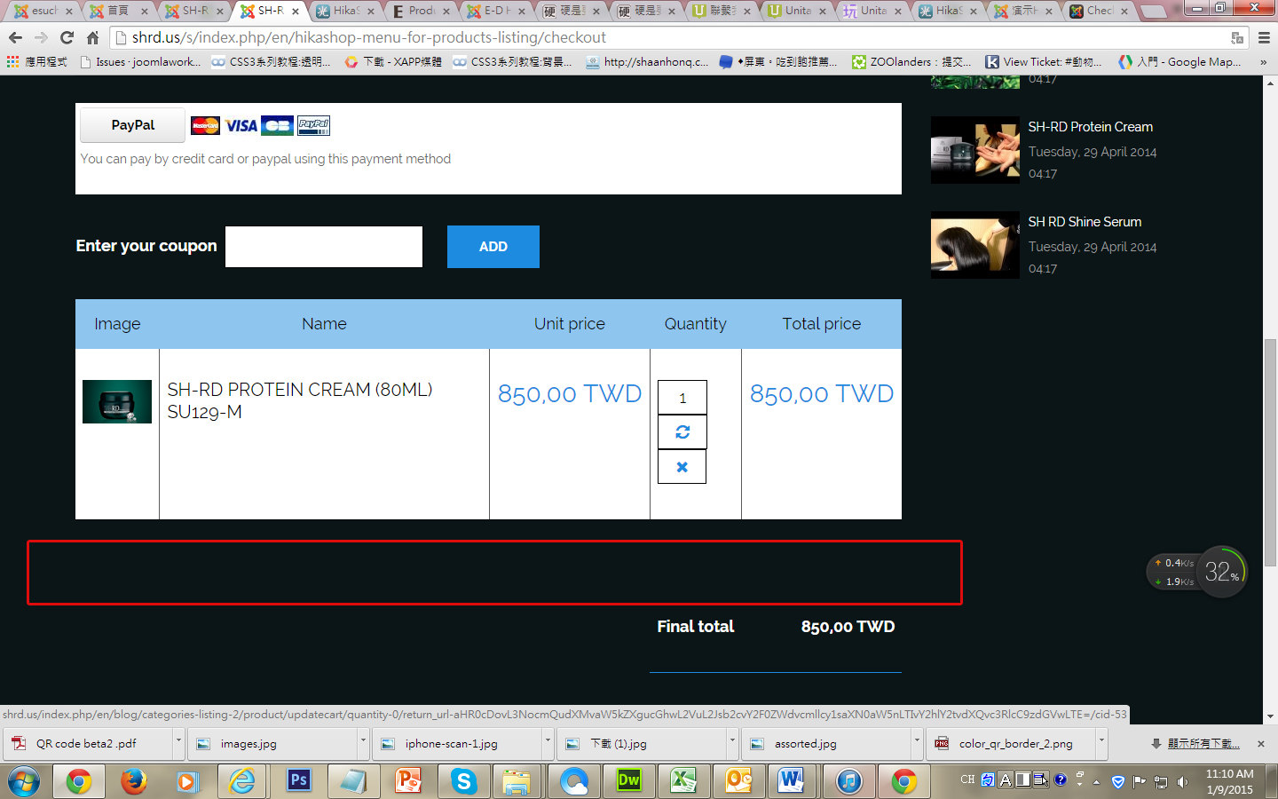

FREIGHT DOES NOT SHOW UP?
  • Posts: 11

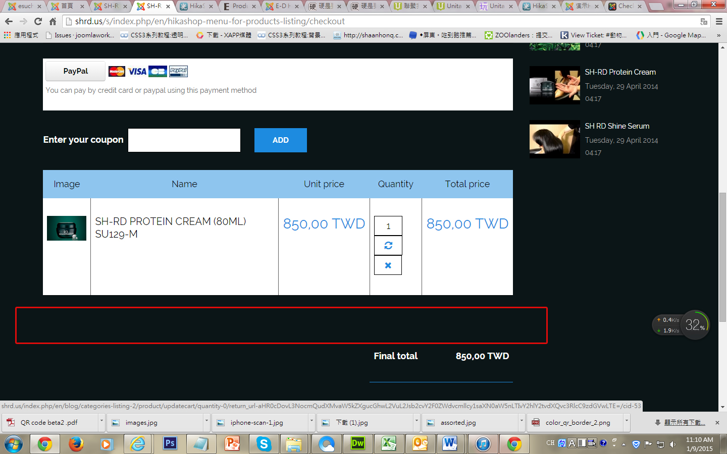

11 years 8 months ago #185815

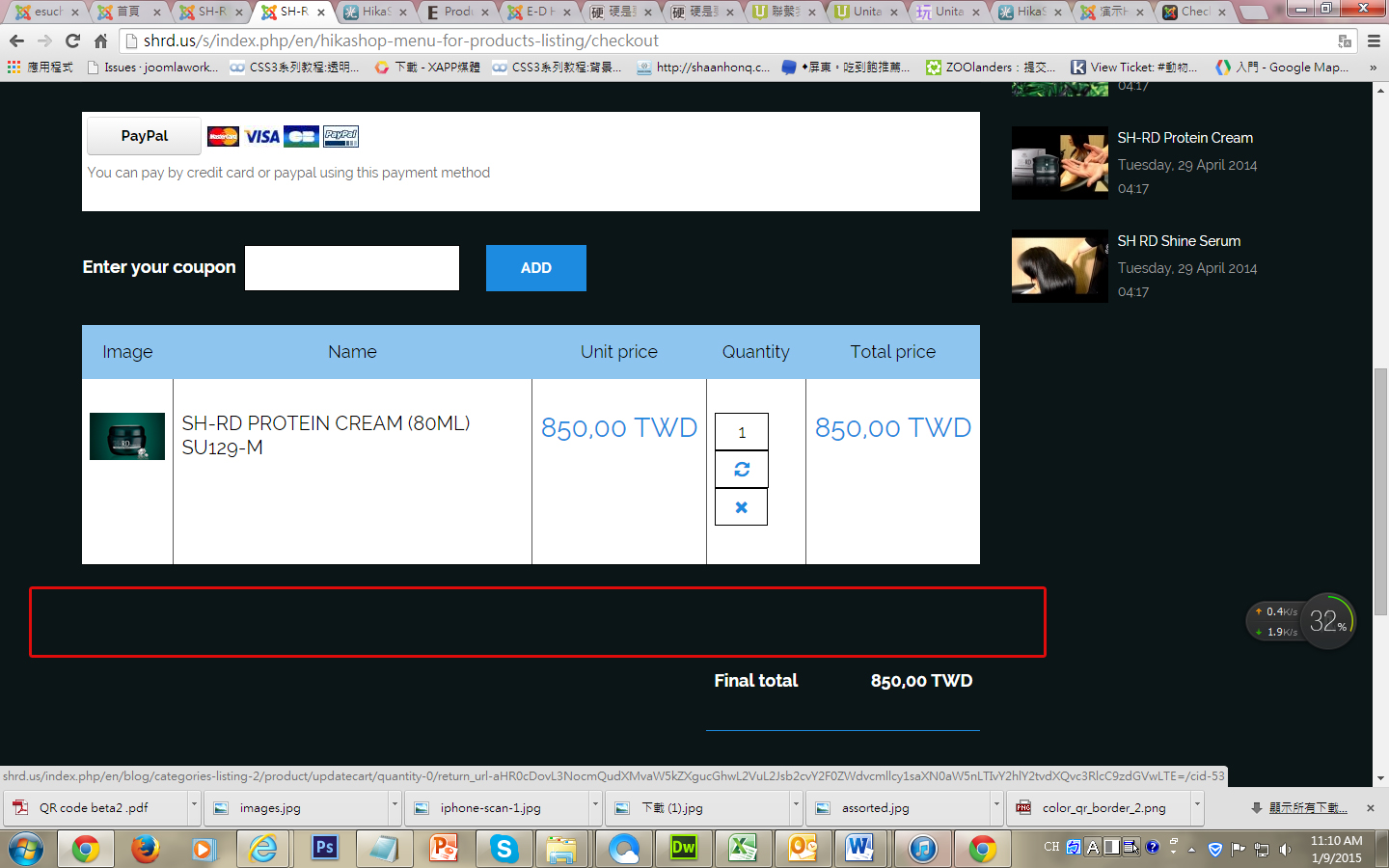

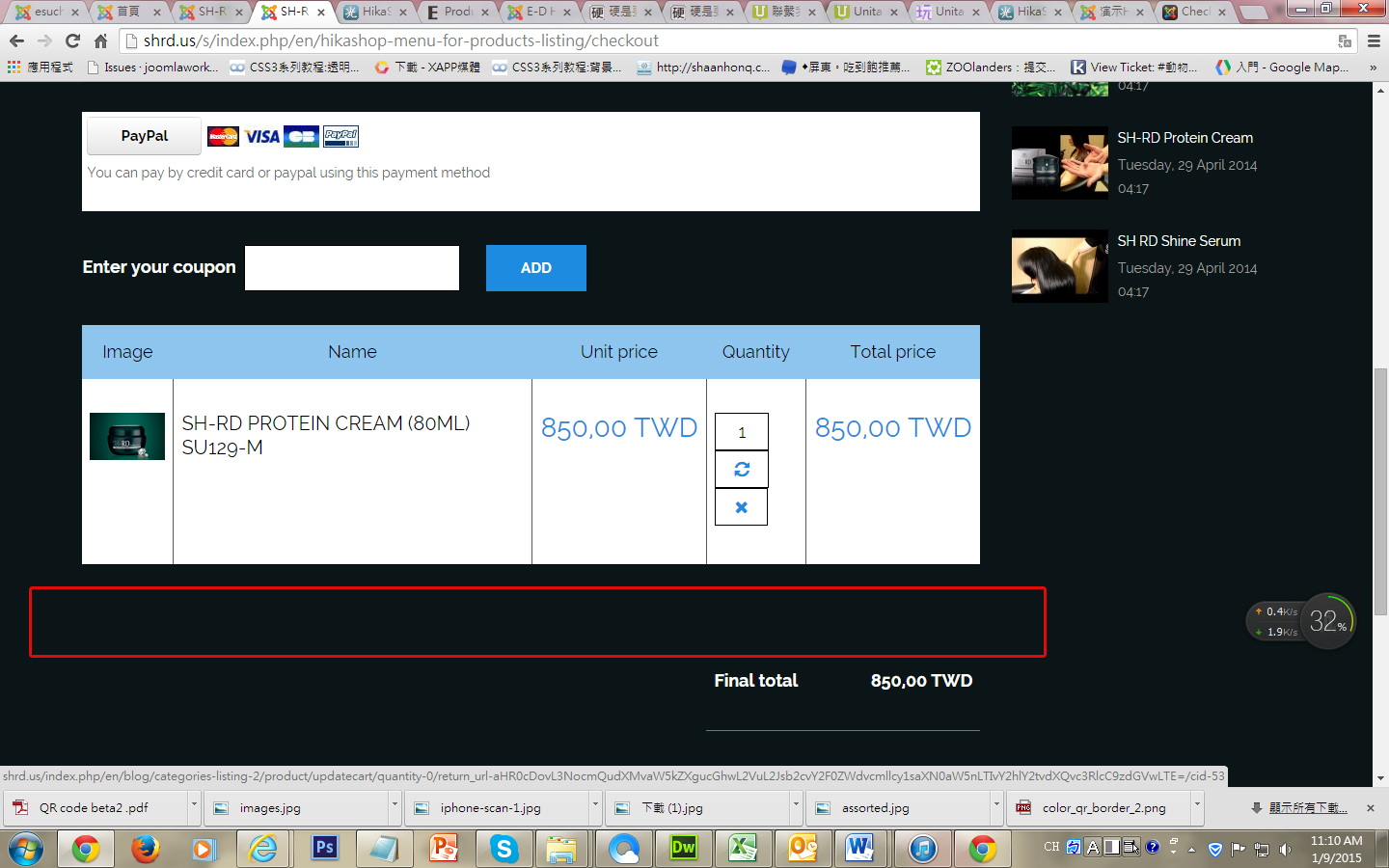

-- Joomla version -- : 3.3.6
-- PHP version -- : 5.4.34
-- Error-message(debug-mod must be tuned on) -- : FREIGHT DOES NOT SHOW UP?
Freight does not show up?
my shop
www.shrd.us/index.php/en/blog/categories-listing-2/checkout
HikaShop → System → Shipping methods
shrd.us/s/index.php/en/hikashop-menu-for...cts-listing/checkout

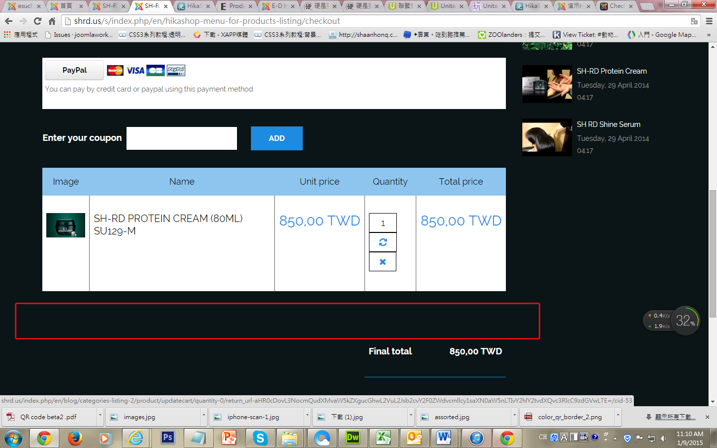

Do not show up?
I tried setting
www.hikashop.com/
Still can not show shipping
I need to Display freight ...

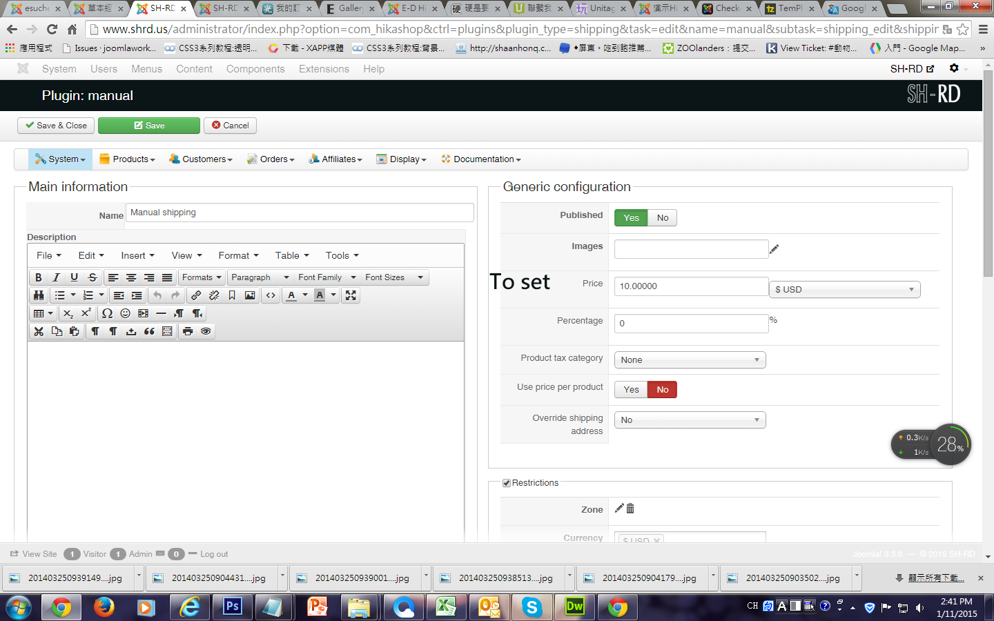

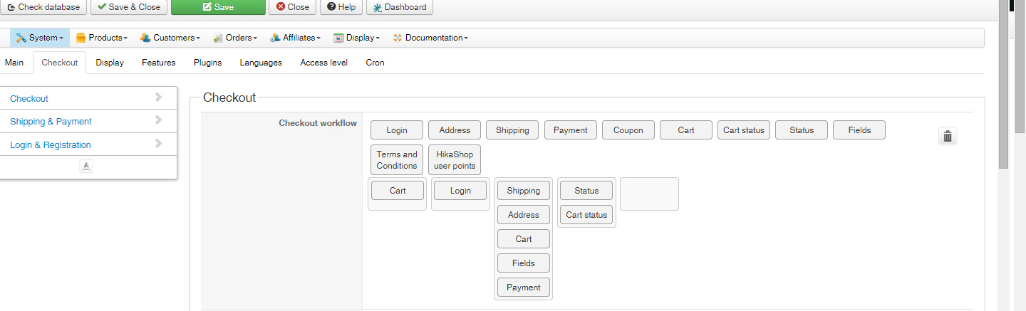

11 years 8 months ago #185825

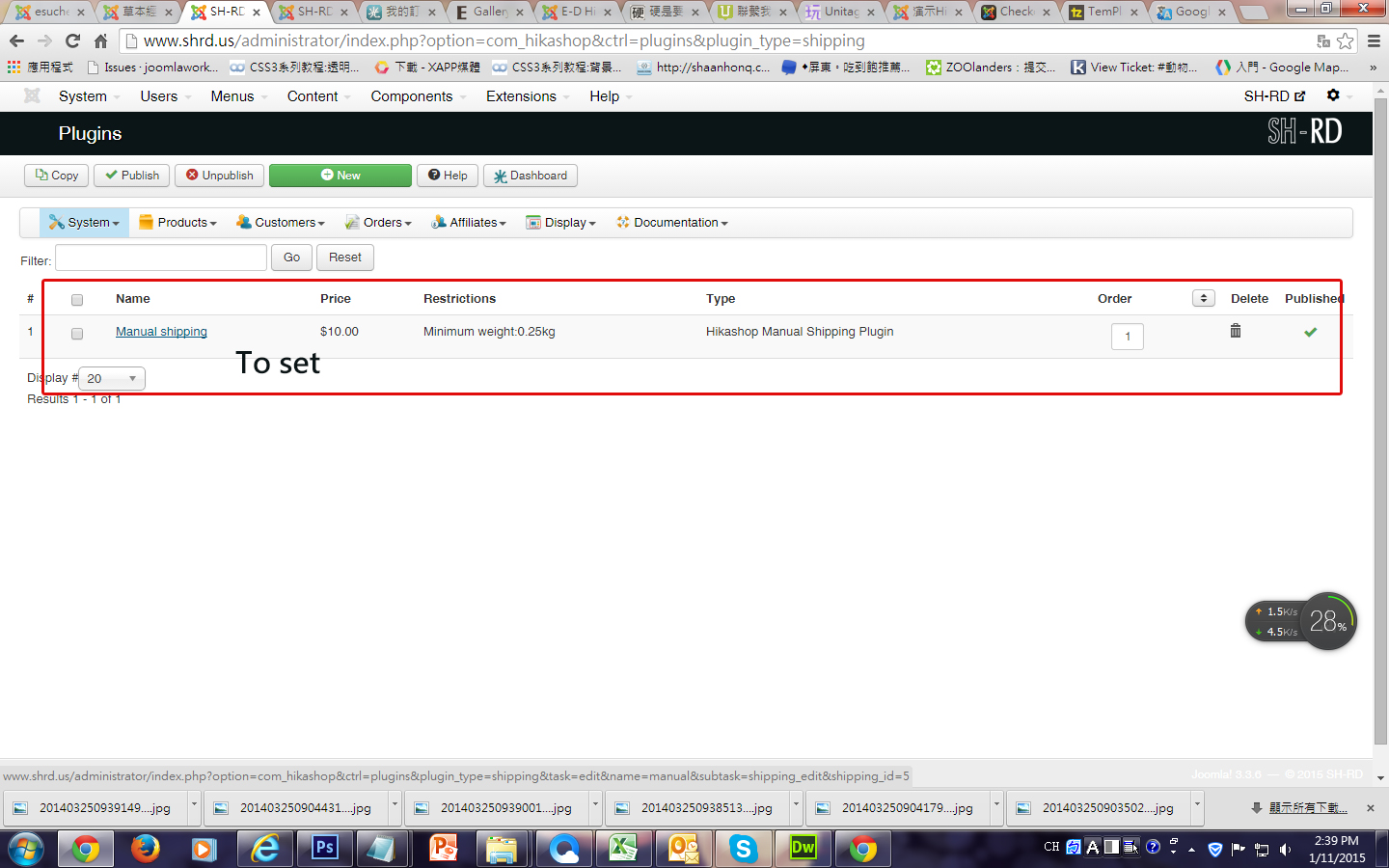

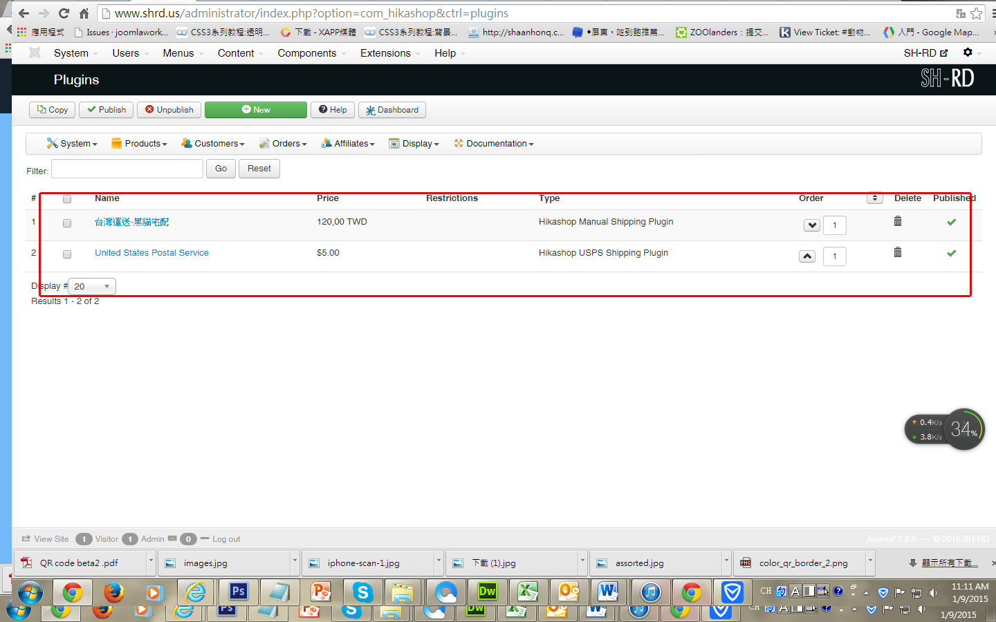

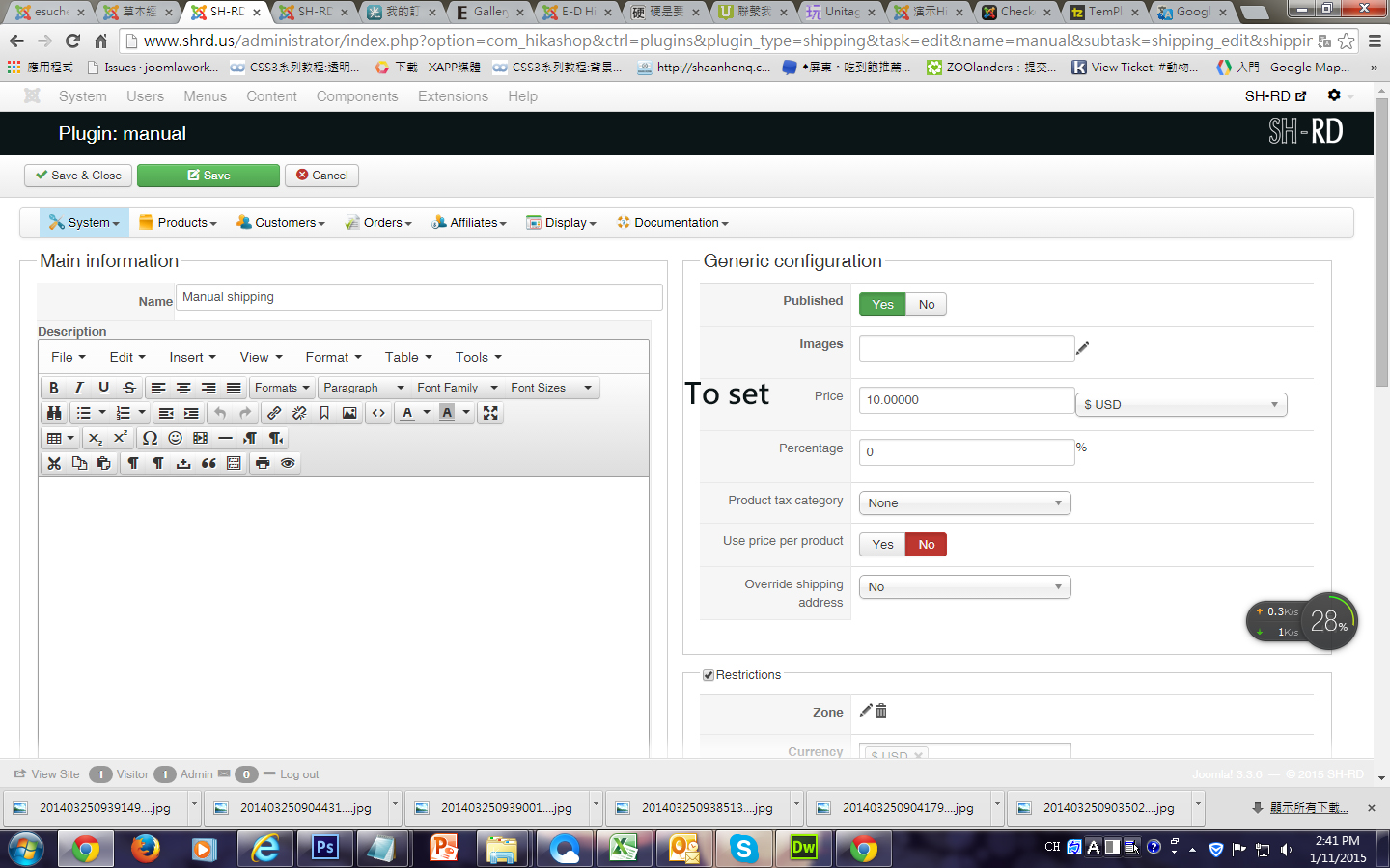

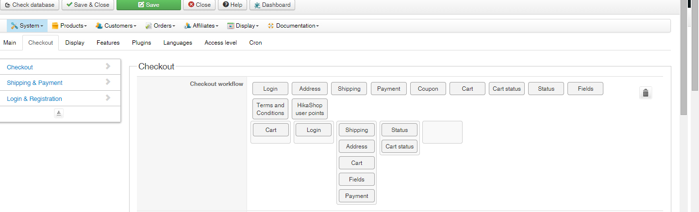

Probably it's caused by your configuration.

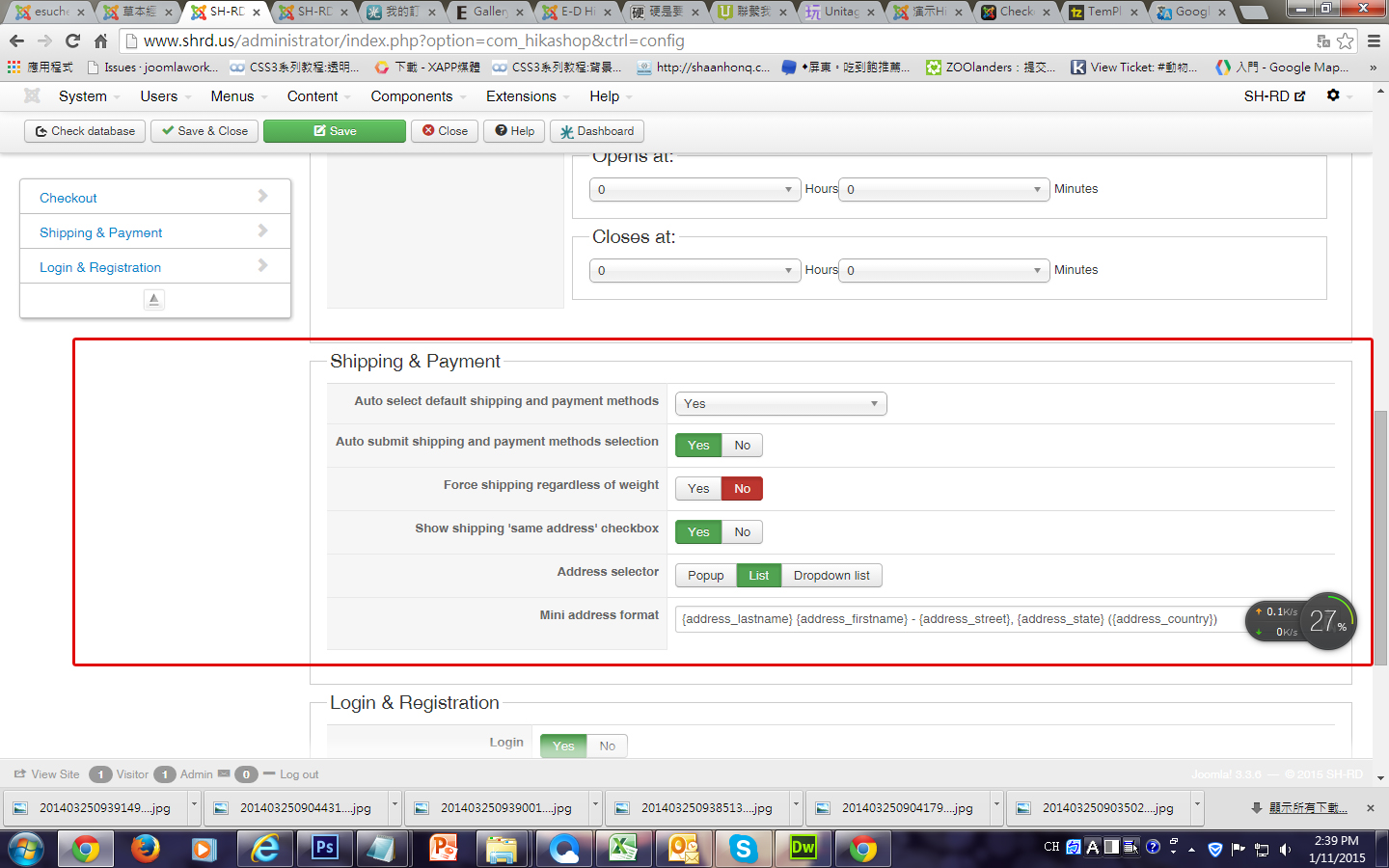

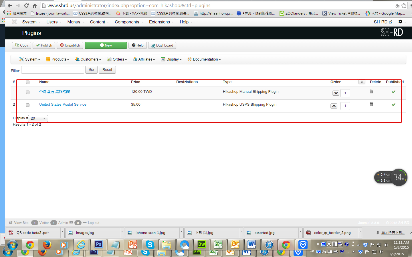

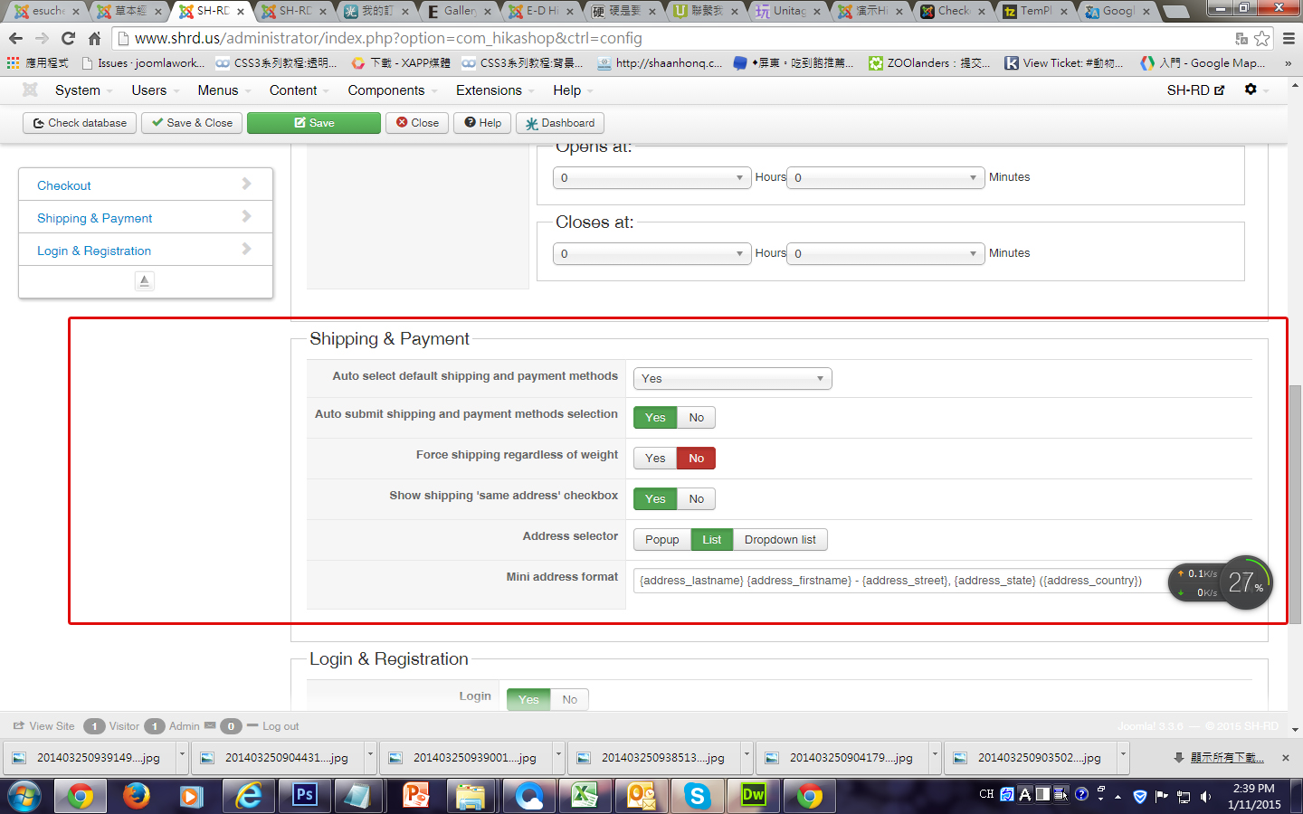

It would be good if you could post screenshots of each of the two shipping methods, and the configuration of Checkout and Shipping & Payment in the backend under -> System -> Configuration -> Checkout.

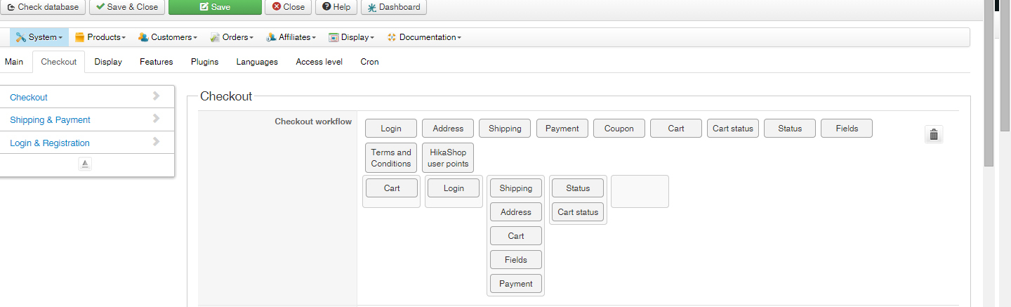

  • Posts: 11
11 years 8 months ago #186075
Setting Display
But
Still can not show freight (shipping)
I have tried many ways
Or does not show up

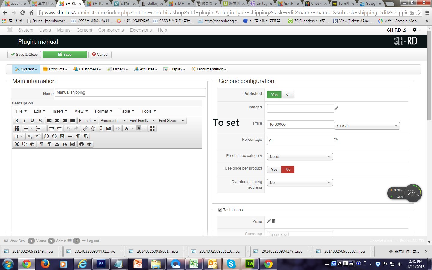

  • Posts: 2143
  • Thank you received: 747

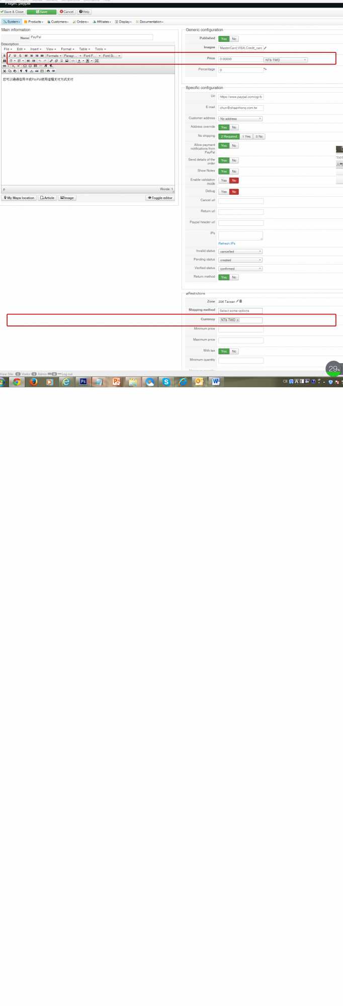

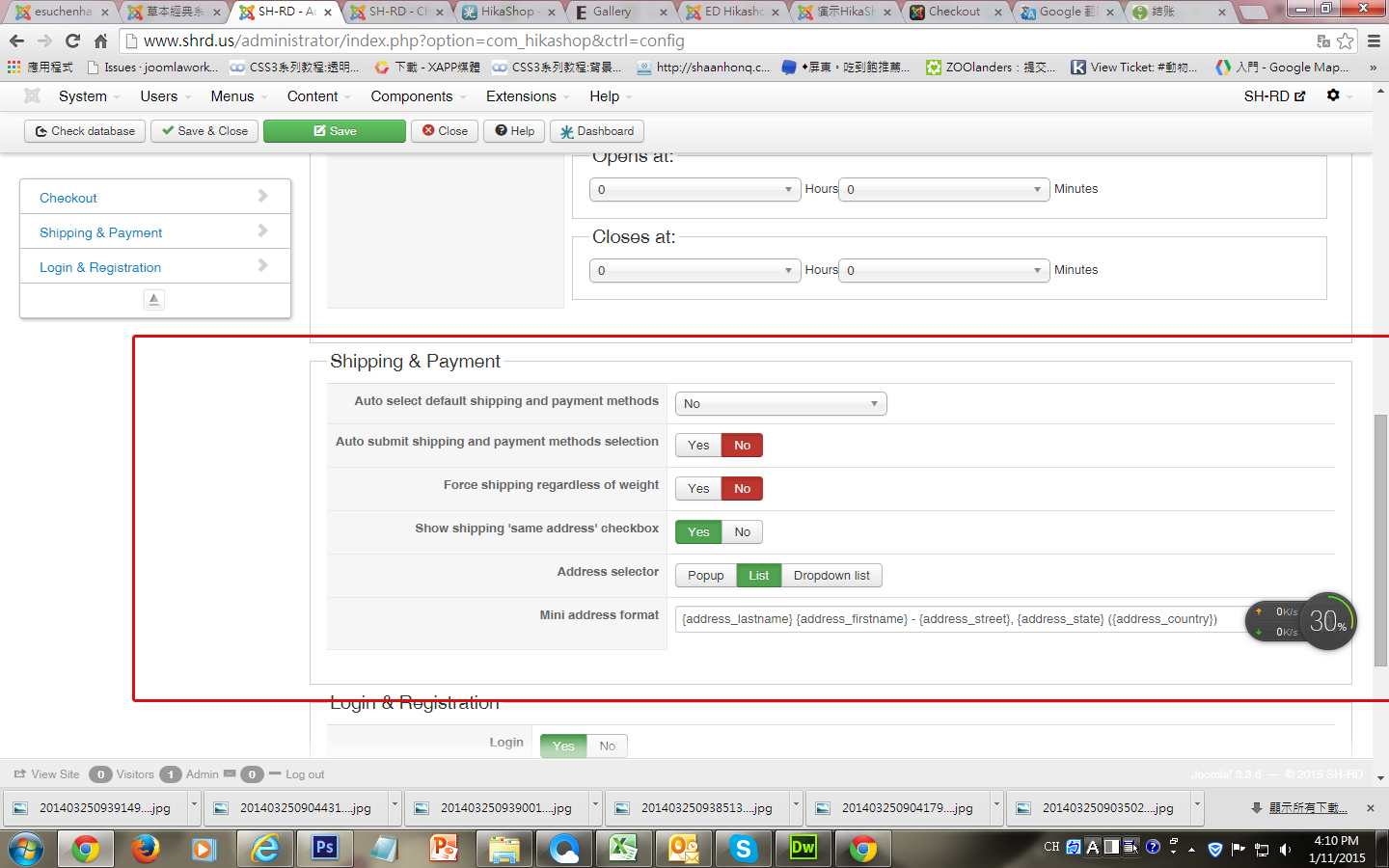

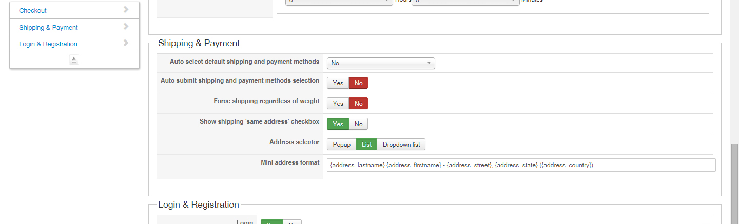

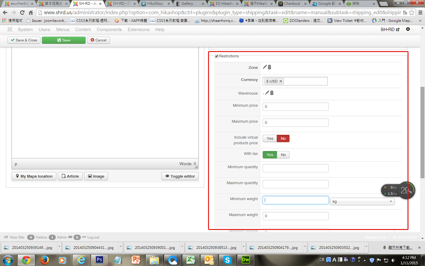

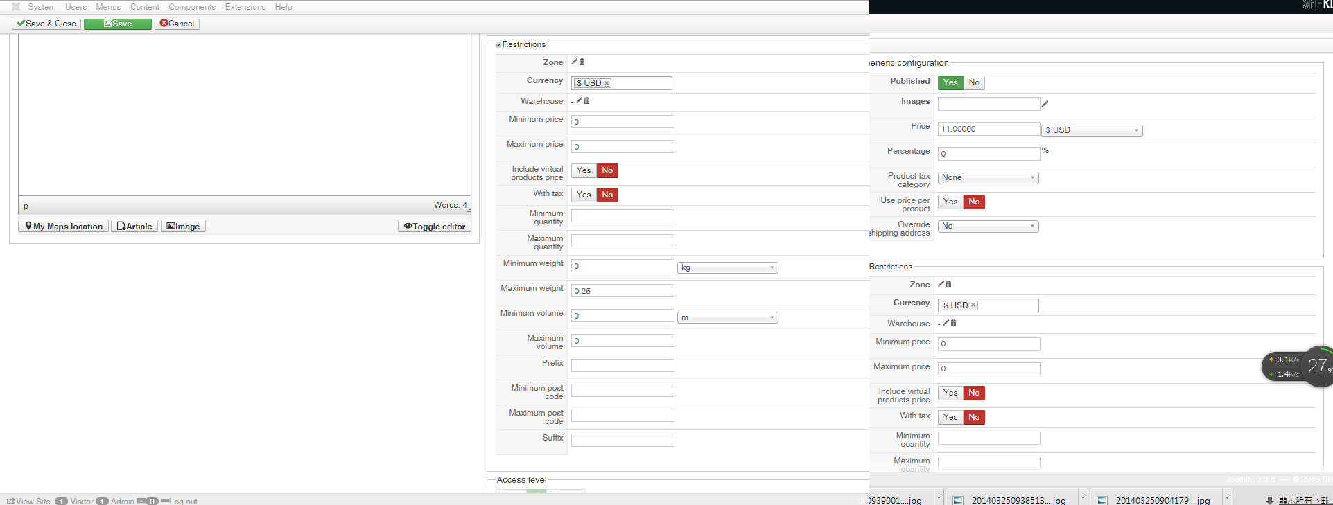

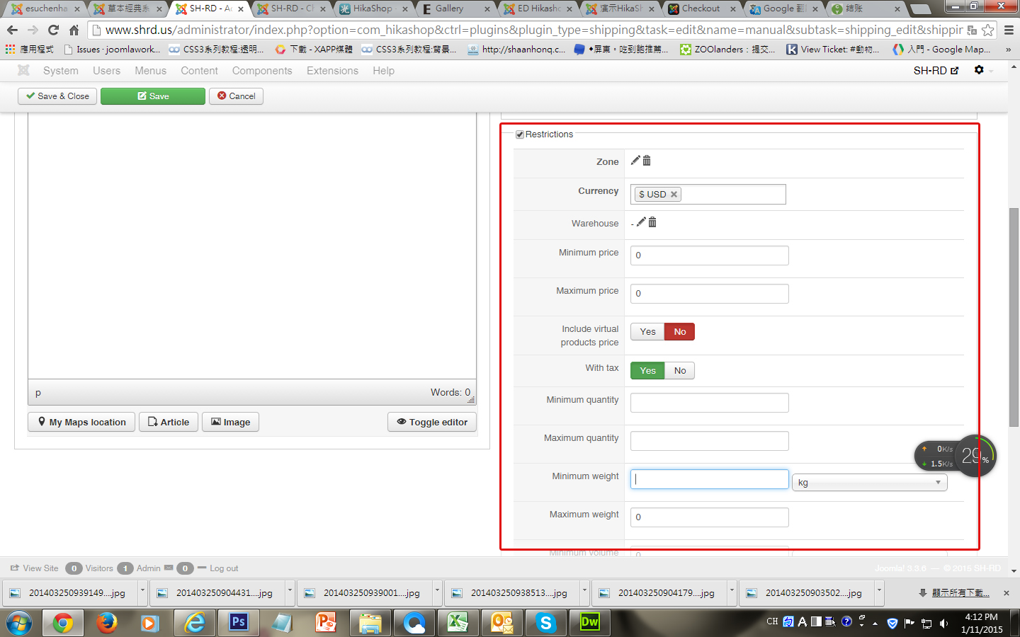

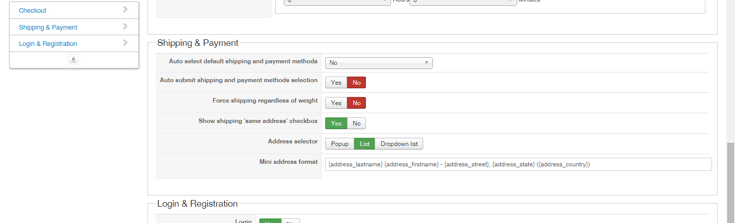

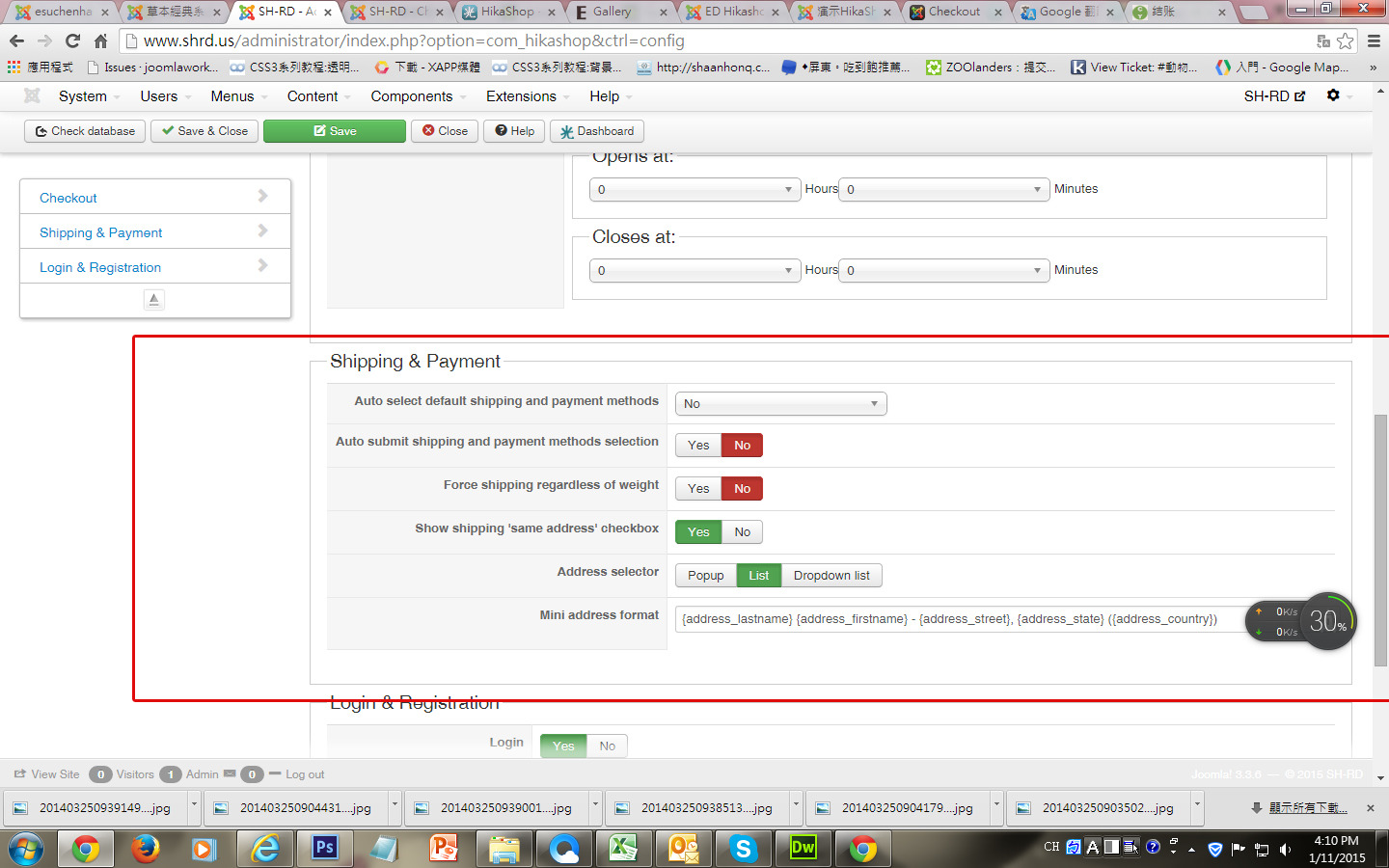

11 years 8 months ago #186084

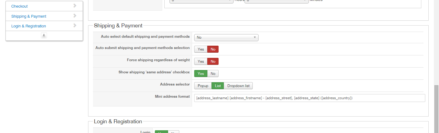

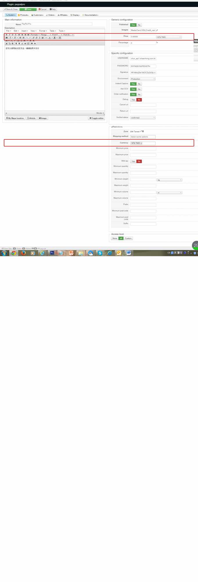

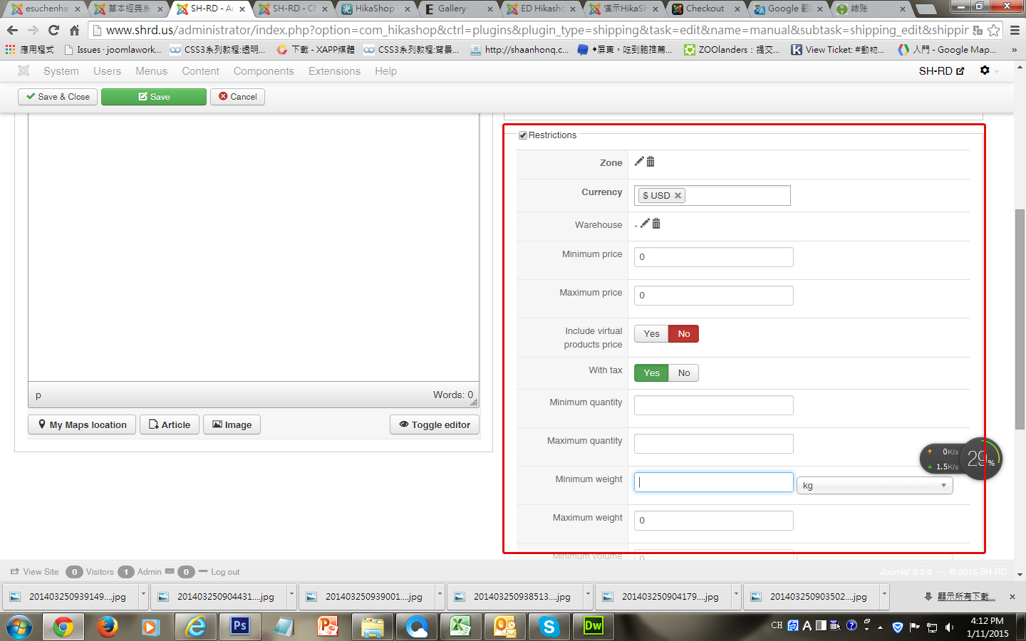

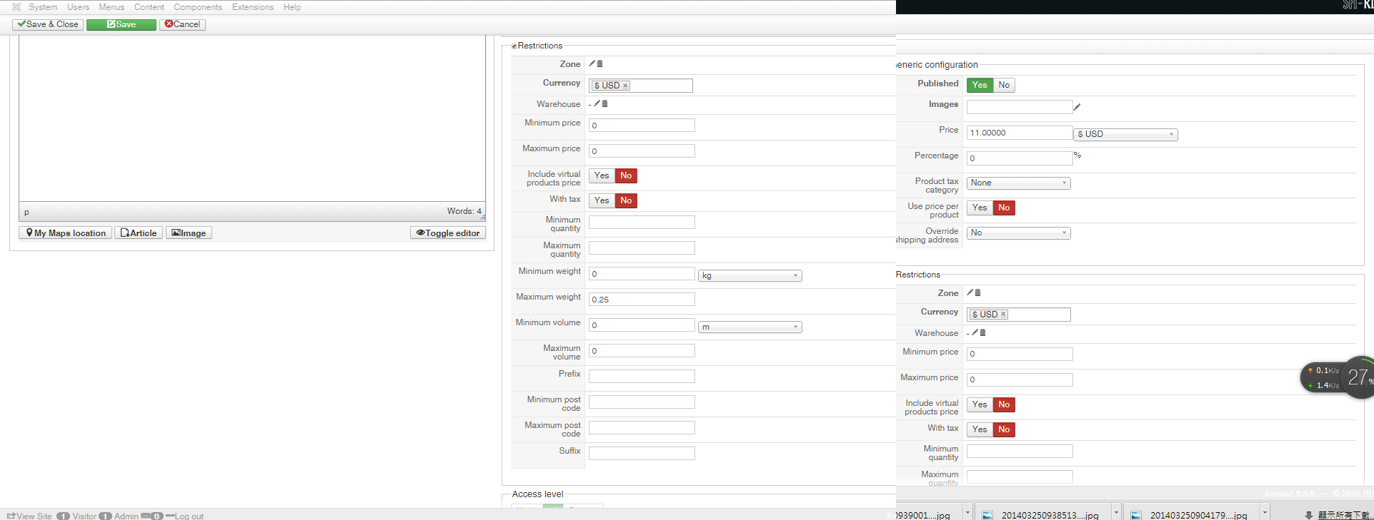

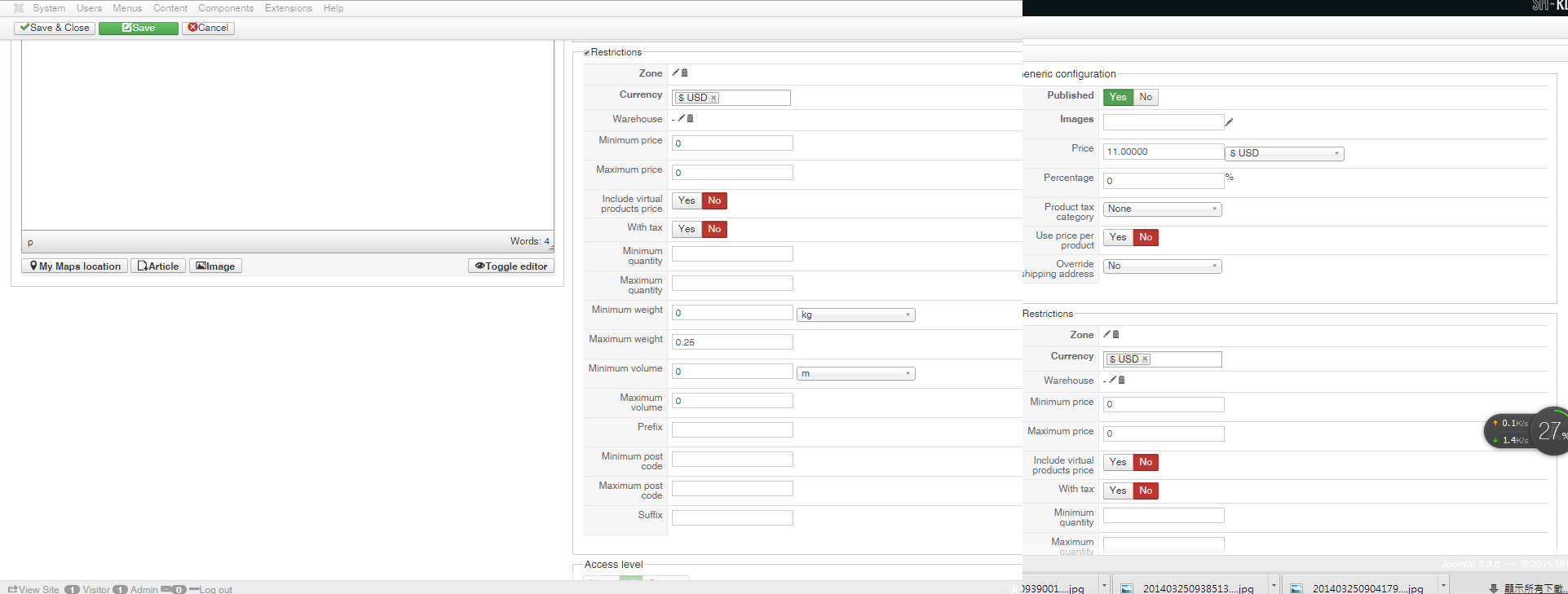

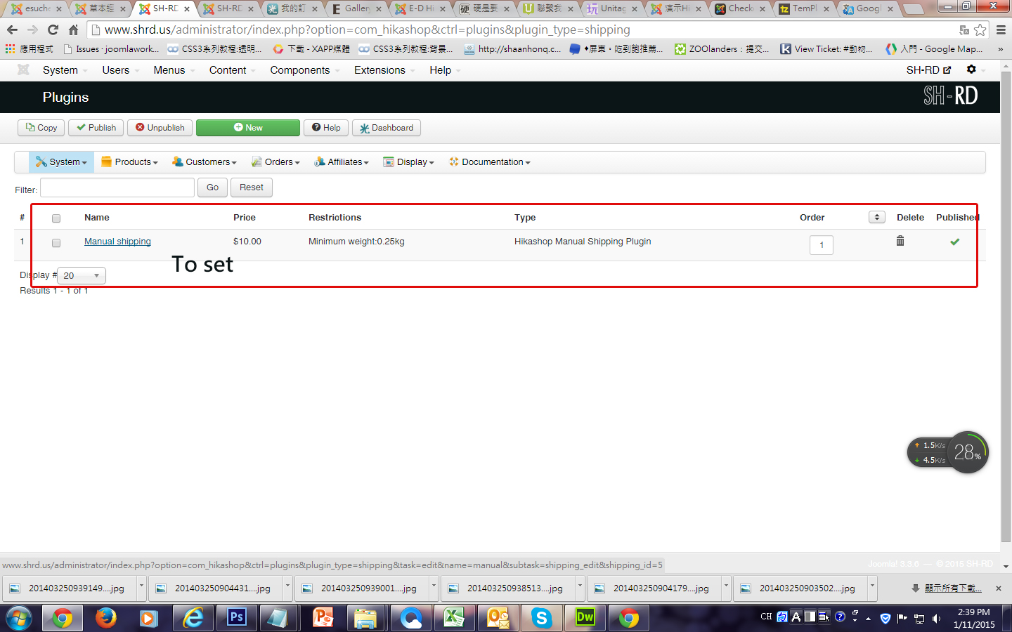

Thanks. However, you didn't show the "Restrictions" part: 115.jpg ends too soon, so please scroll down and show that section, too.

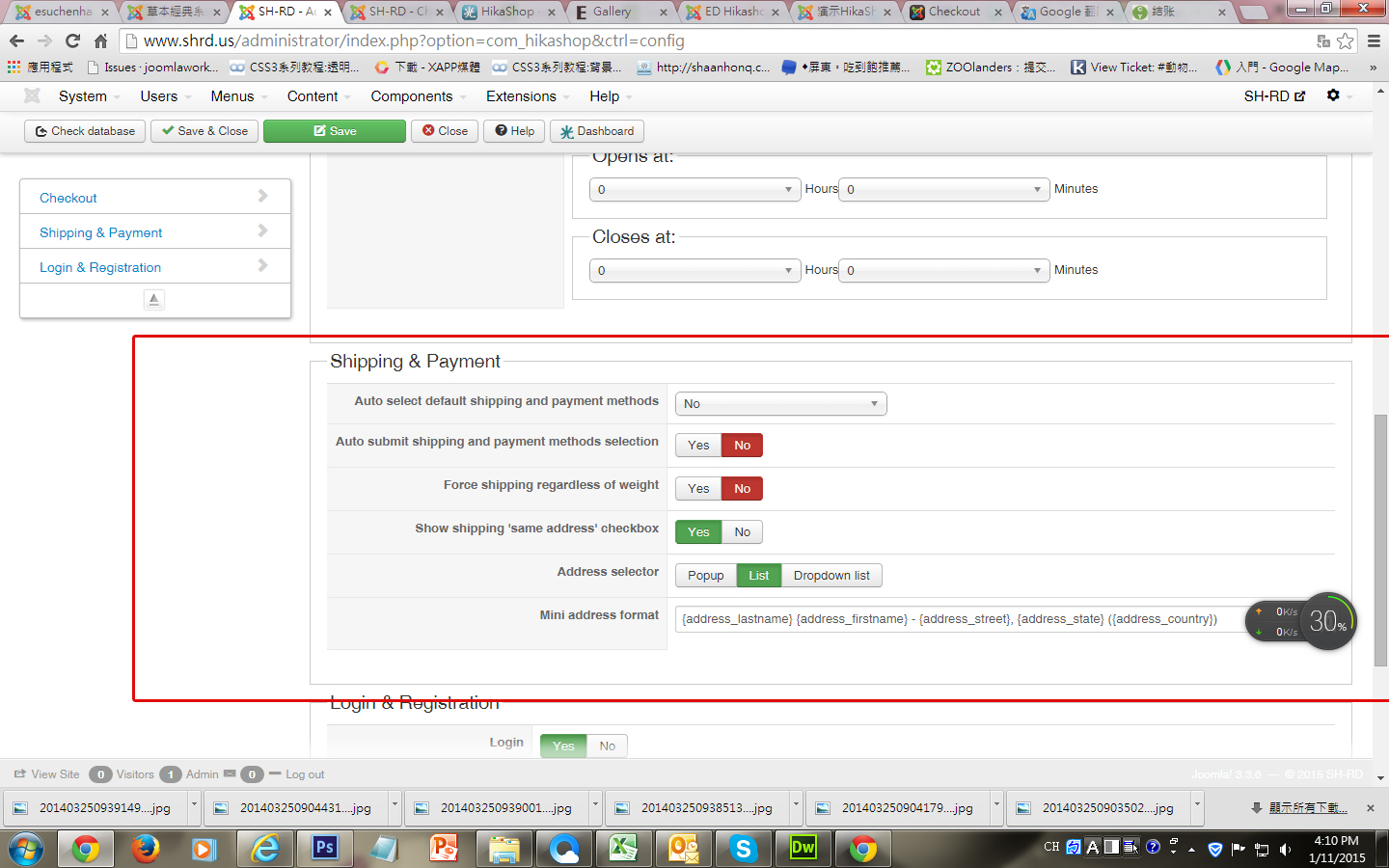

Meanwhile you may try to disabling Auto-selection and/or Auto-submission of shipping and payment (see 112.jpg). If there is no problem with the restrictions of your shipping method, this may fix it.

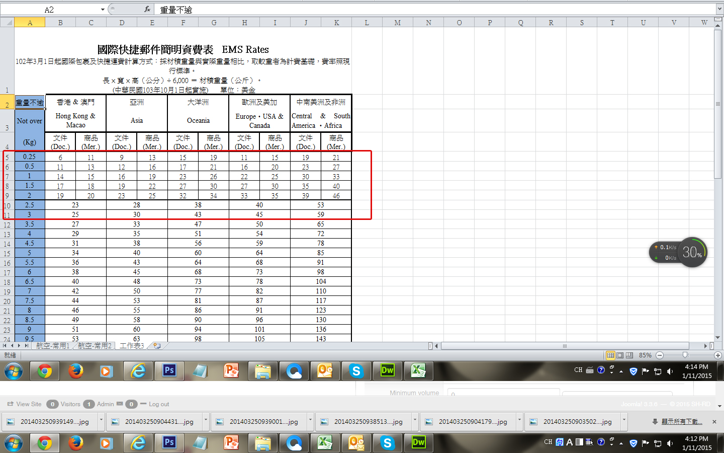

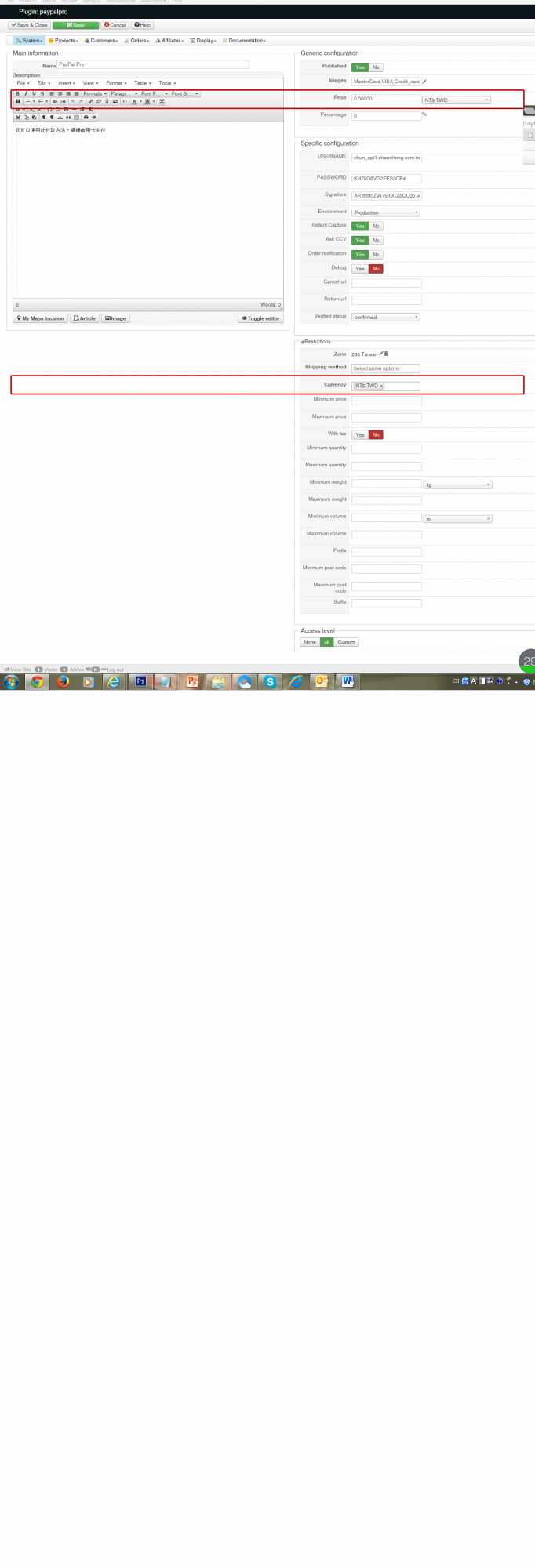

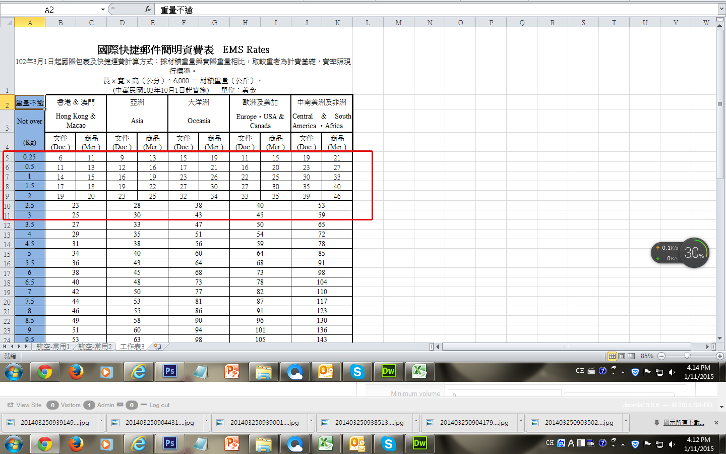

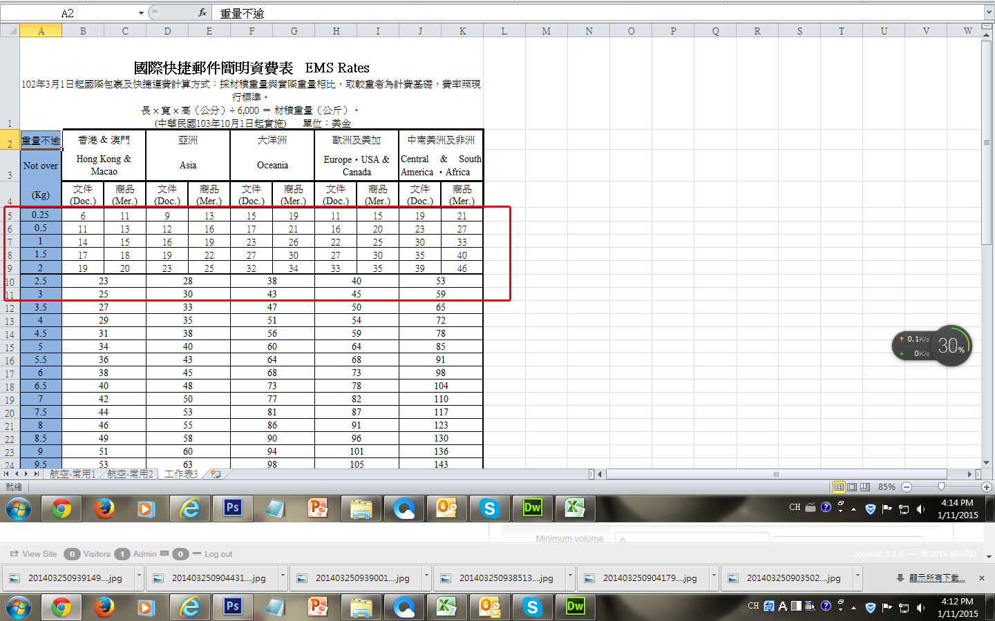

  • Posts: 11
11 years 8 months ago #186086
I have turned off
to disabling Auto-selection and / or Auto-submission of shipping and payment
Freight still can not show :(

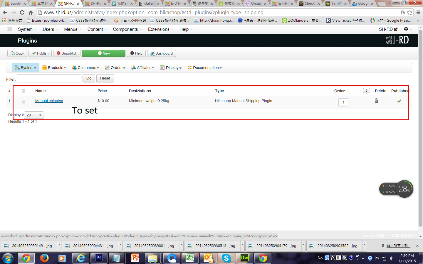

Or
0.25kg -3.0kg shipping?
(EMS)
Or
Please help me
Or
Tell me
a test set shipping
You can show up in the set
I need to
First test correctly showed off
shipping
Please help me :(

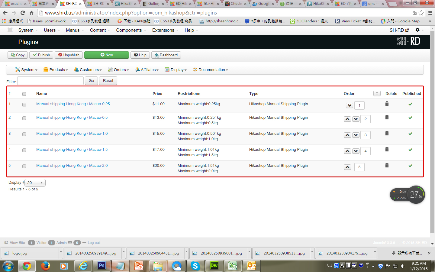

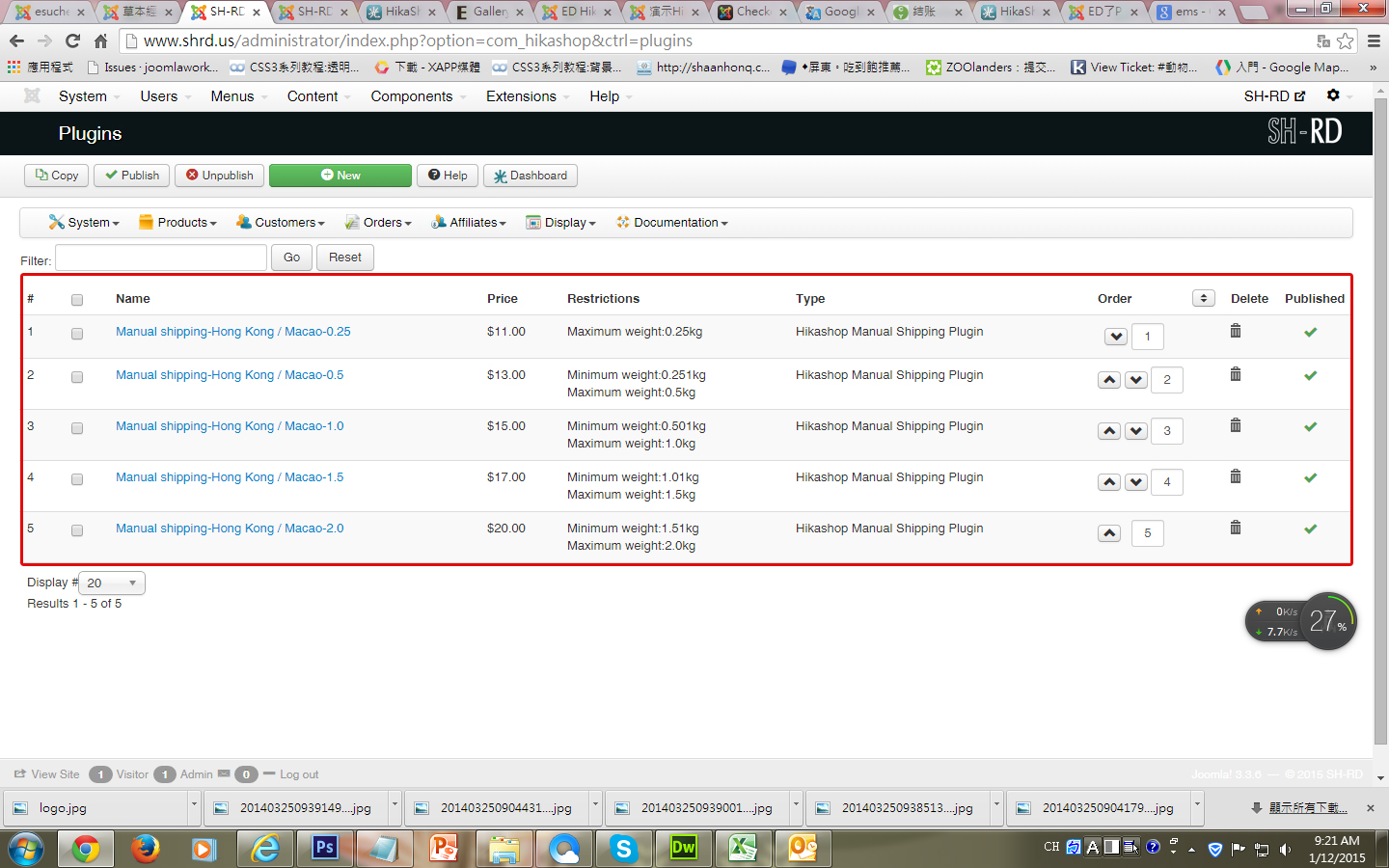

  • Posts: 2143
11 years 8 months ago #186090

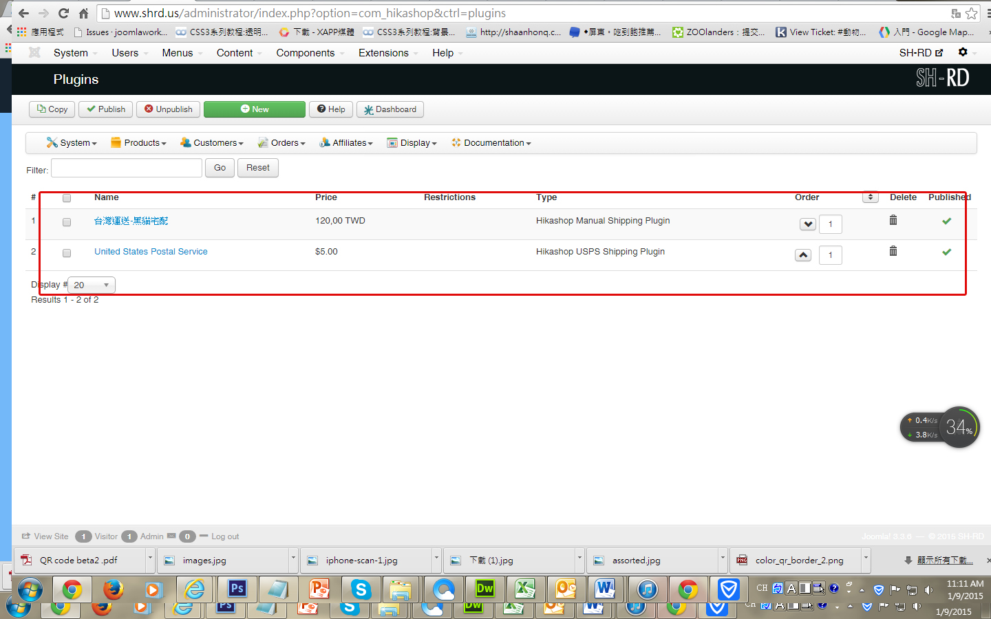

1. I trust you have entered weights for your individual products. Please double-check.
2. Keep in mind that if there is a product (or multiple thereof) in the cart where its weight (or the total of multiple products) is outside the weight restrictions set in the shipping method's configuration, the system will be unable to find and display a shipping method in the checkout.
So, you'll need to configure multiple shipping methods each with restrictions set so the entire range of possibilities is covered, e.g.:
a) min 0 to max 0.25kg -> $11
b) min 0.251 to max 0.5kg -> $13
c) min 0.501 to max 1.0kg -> $15
... and so on, and then maybe
x) min 50.01kg -> $150
... or whatever you prefer for your customers.
3. Also, please read this FAQ: www.hikashop.com/support/faq.html#ship

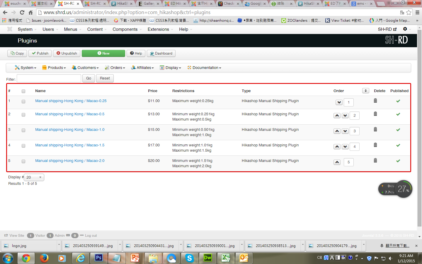

  • Posts: 11

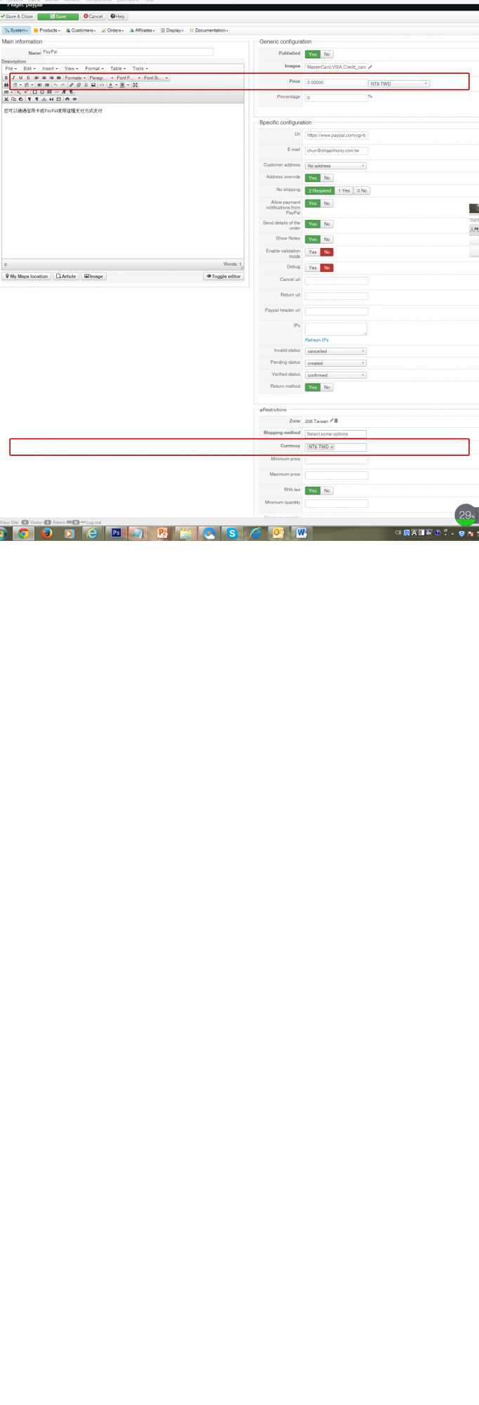

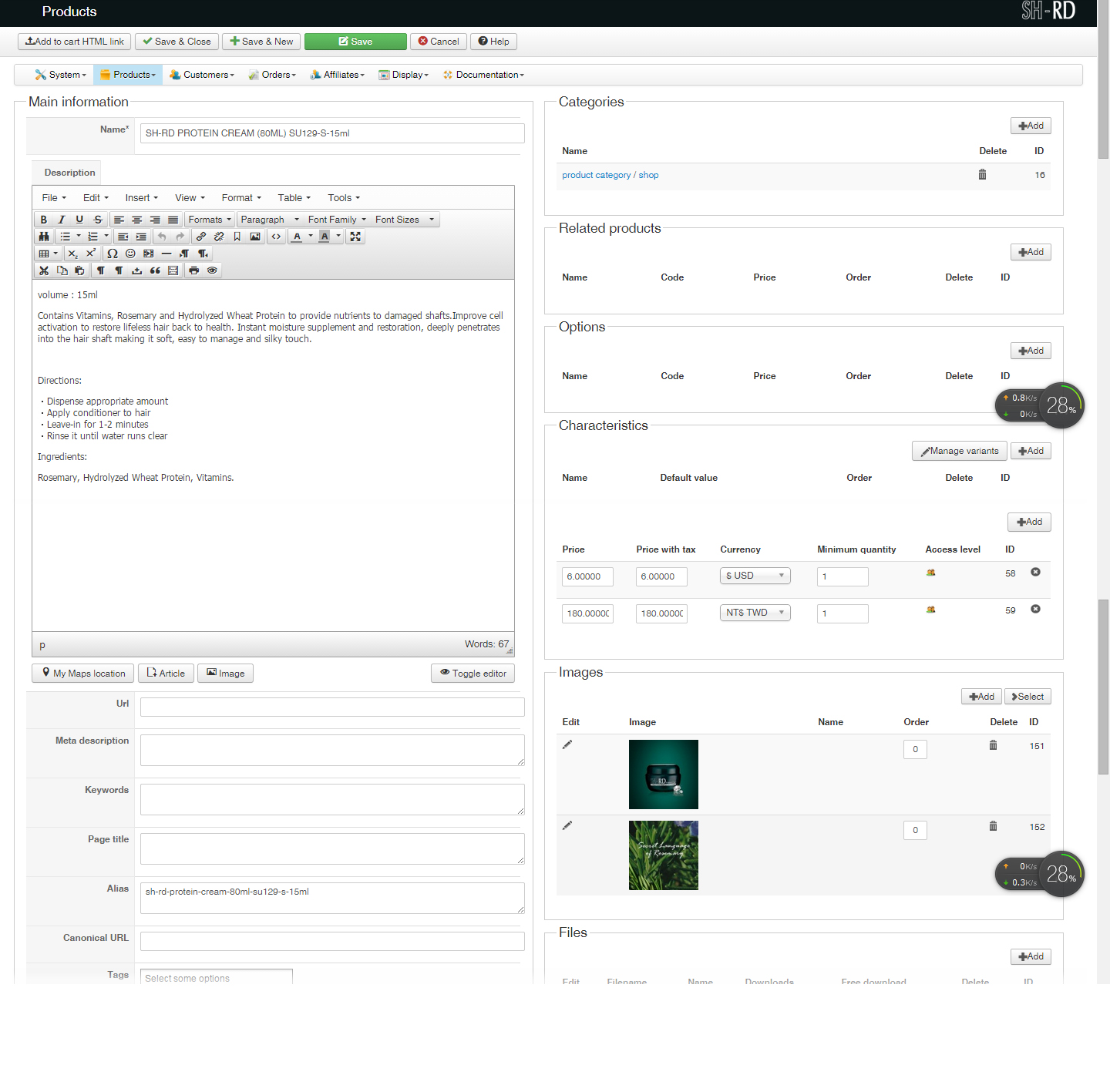

11 years 8 months ago #186193
images 0.1jpg
I have set kg! Freight Shipping methods
But
Product Set
I can not find
enter the weight of the option(images 0.3jpg)
For example, $ 6 products, weight 0.25
I should set which page
Let checkout
can show
Shipping methods
my web shop :
www.shrd.us/index.php/en/blog/categories...am-80ml-su129-s-15ml
  • Posts: 11
11 years 8 months ago #186196
I should
How to set
Product Area
Individual event
Product weight
Shipping methods:

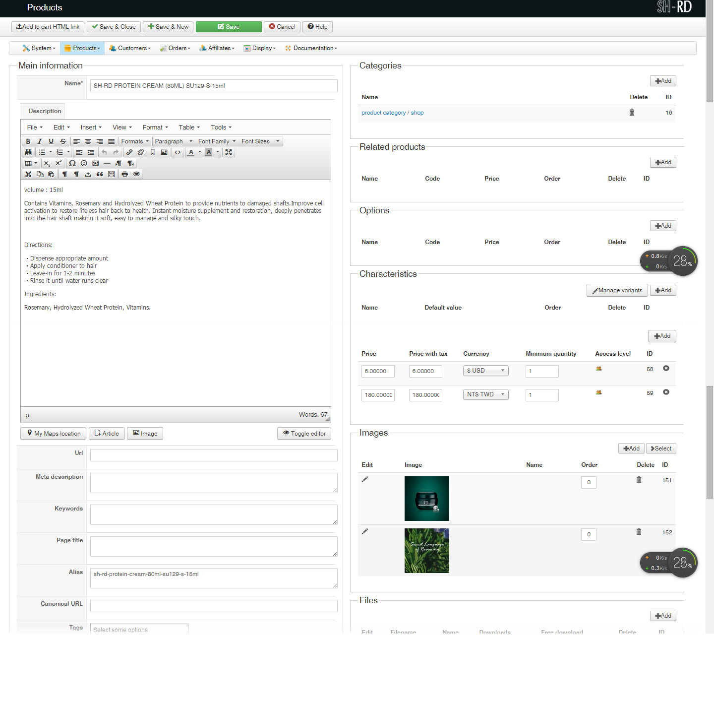

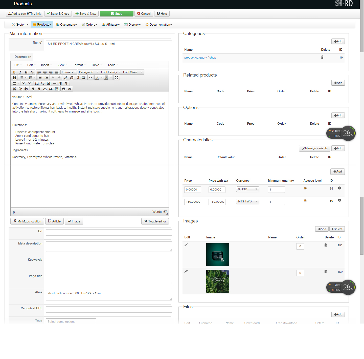

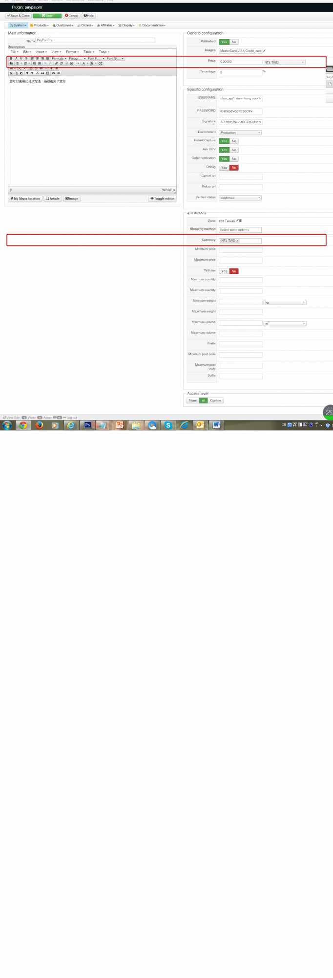

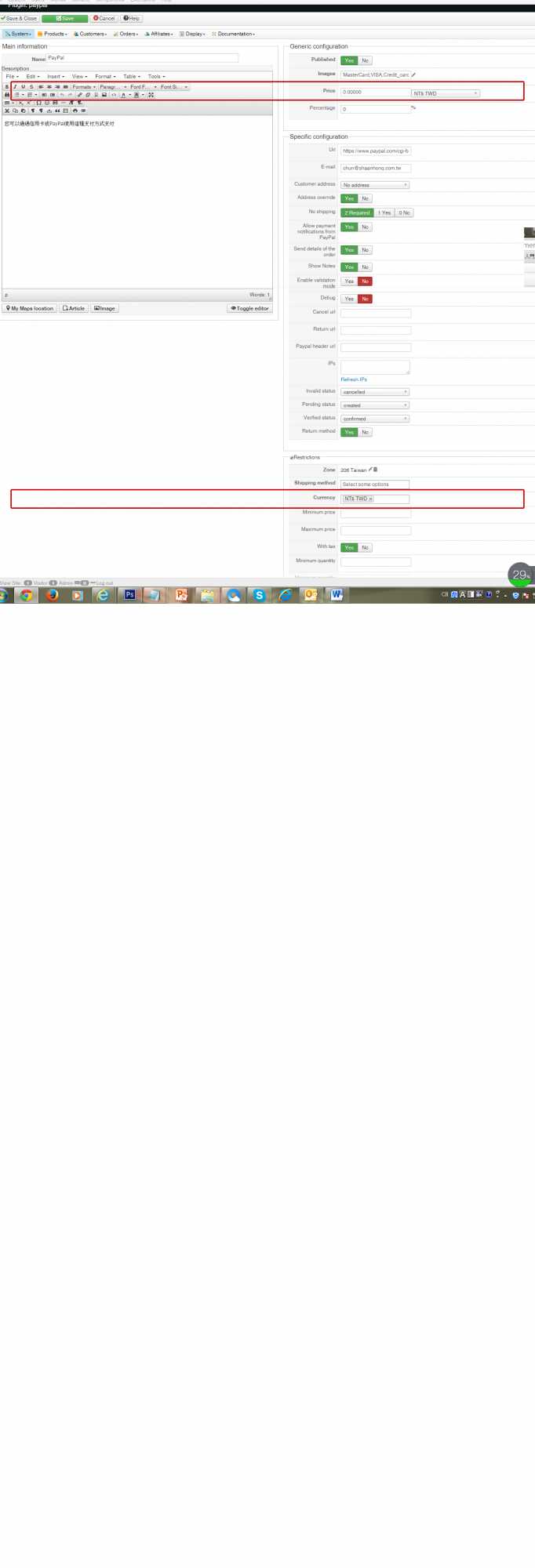

(5) Check that your products have a weight, otherwise, the system will not display any shipping methods as it will consider the products as virtual goods.
I can not find a location to set the weight?

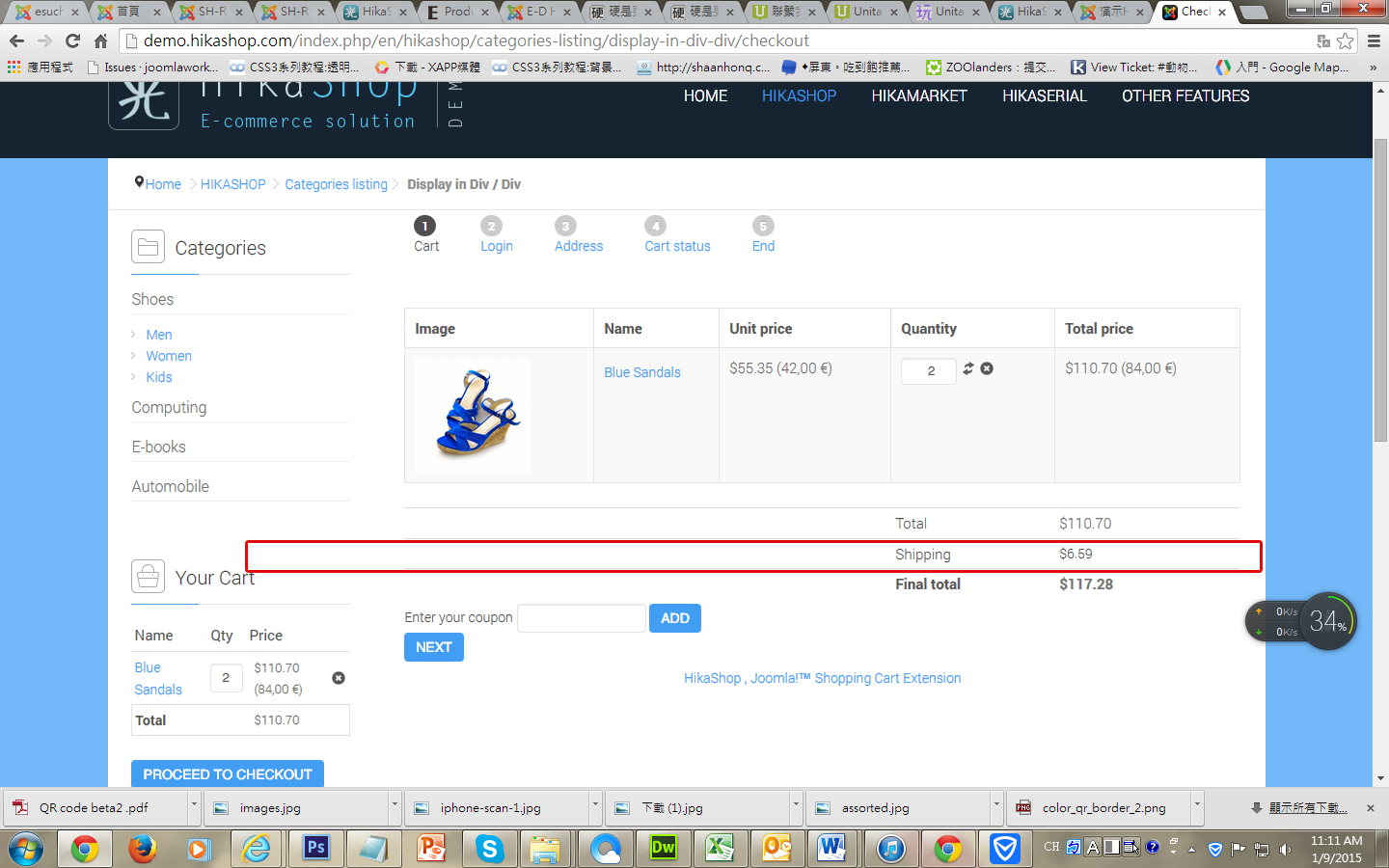

  • Posts: 11

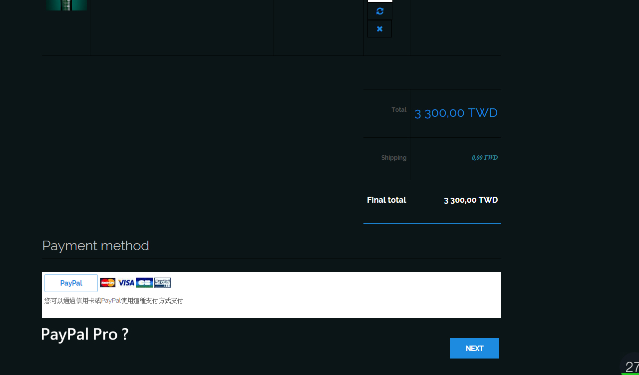

11 years 8 months ago #186220
Hi :cheer:
Shopping showing a freight
But
How to set
Shopping amounted to?

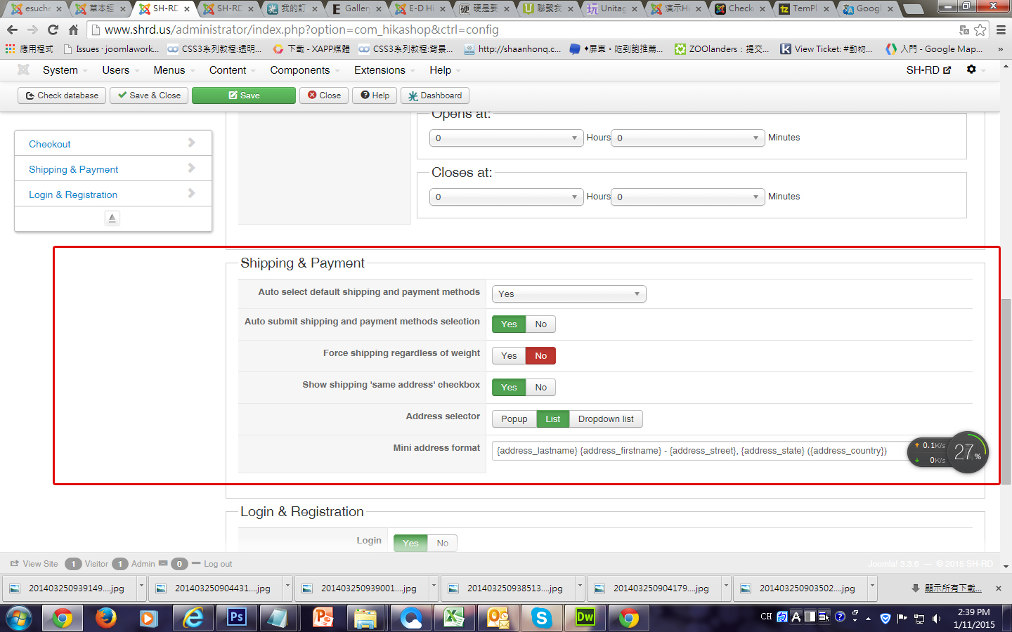

  • Posts: 2143
11 years 8 months ago #186232
1. In 03_...jpg, your screenshot is cut off too soon again. Further below, you'll find a dropdown "Product type". Set it to "Shippable goods", then you'll see the "Weight" field, and you'll be able to enter product weights.
4. First you'll need to set zones for Asia etc, each including the countries you want (-> System -> Zones). Then you can set additional shipping methods with shipping price $0.00 for free shipping without any weight restrictions, but with restrictions to "Zone" and "Minimum price".
So, according to previous examples:
aa) Zone "Asia" & min price $100 -> $0
bb) Zone "Europe/USA/Canada" & min price $150 -> $0
... and so on.
Eventually you'll need to put these new "free" shipping methods first in the order of all shipping methods.
Eventually you'll need to add a zone for your existing "non-free" shipping methods, e.g. HK/Macau.
Eventually you'll need or want to set "Auto-select default shipping & payment methods" back to Yes.
Just think what you need, then use logic with general configuration and the restrictions to set things up so that all you need is covered.

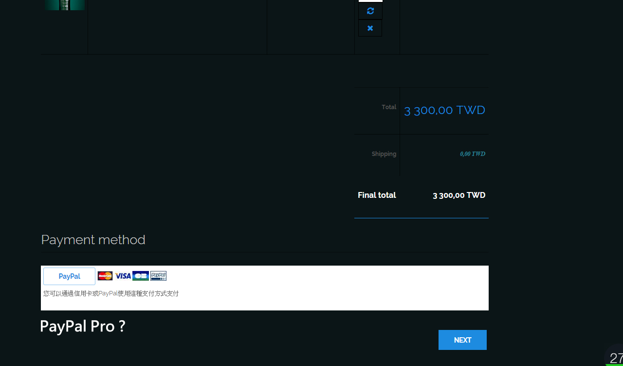

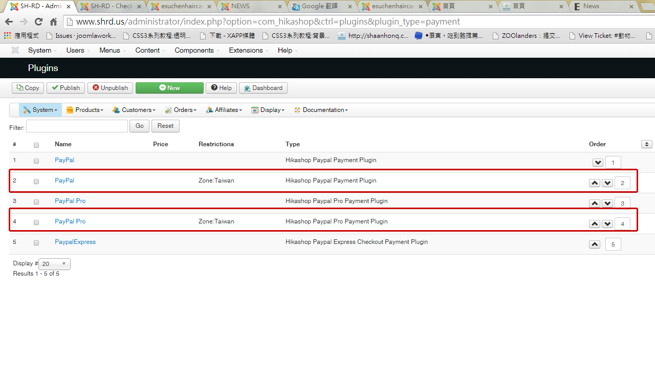

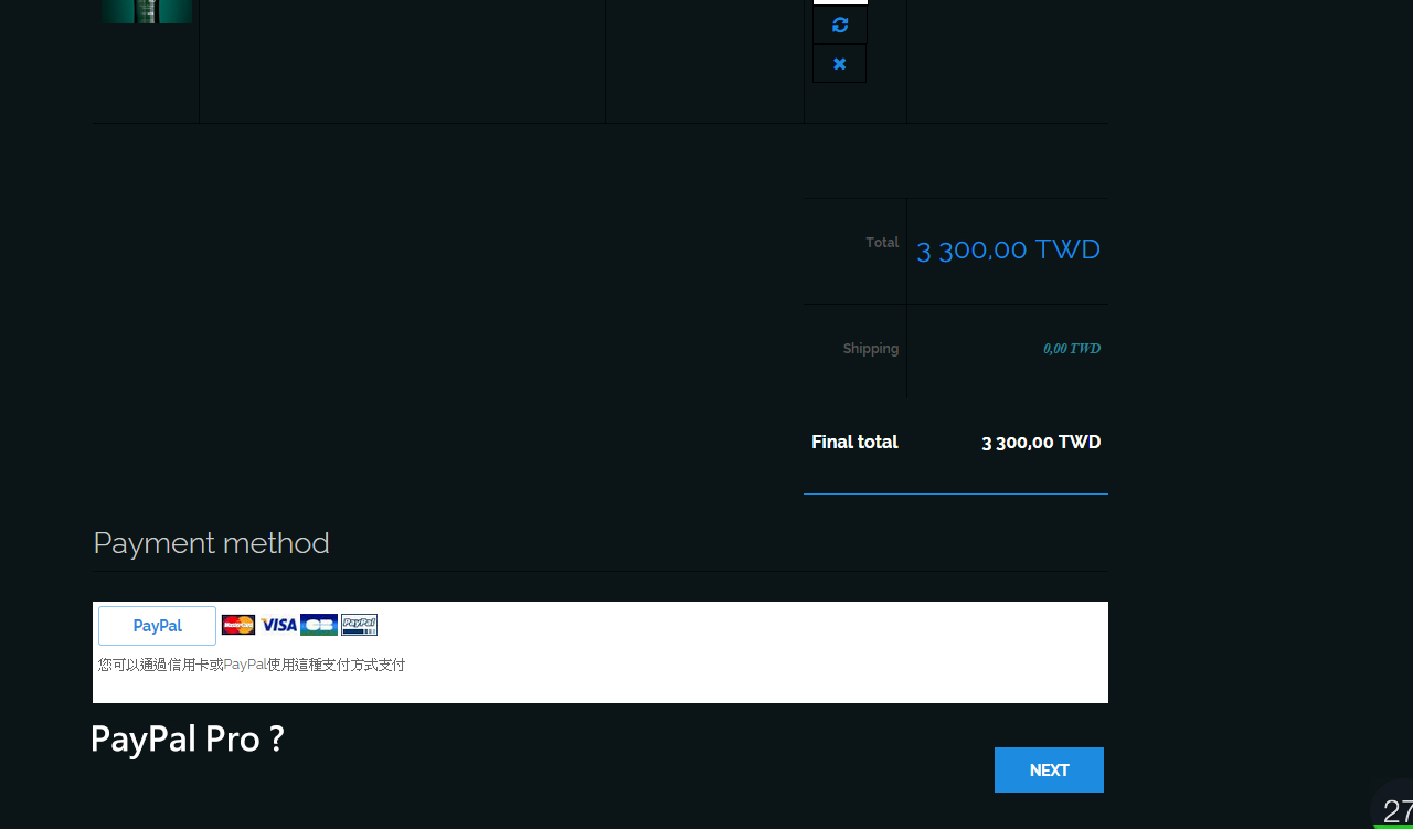

  • Posts: 11

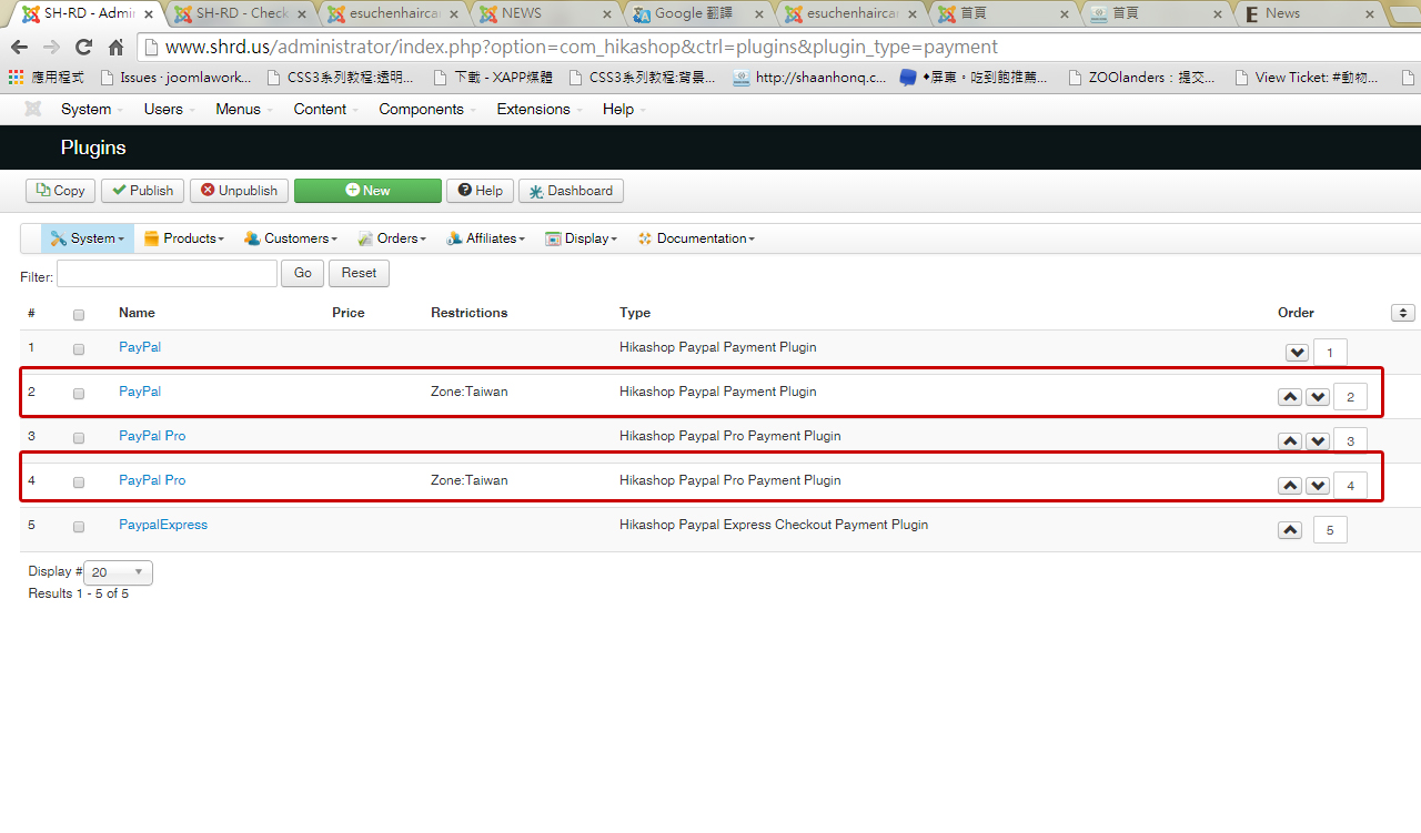

11 years 8 months ago #186565

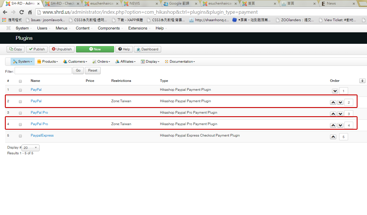

1. About TWD
Payment Pay PAL POR does not show up (already set)
Will be displayed in USD
How is it
Show TWD
2. How to set
Shopping Payment
Limit the area
Such as
The US can not buy
This function?
11 years 8 months ago #186668
1.
Following each step of the "Payment methods" section of the FAQ will probably help you :
2.
Restricting all your shipping methods or payment methods to a zone different than "US" will do the job.

11 years 8 months ago #187344
1.
Sorry, here is the link to the FAQ : www.hikashop.com/support/faq.html#paym
Restricting all your shipping methods or payment methods to a zone different than "US" will do the job. " ← How To Set ?
How to limit?
Which plugin?
By Creating a custom shipping zone via "Hikashop->System->Zones", adding in it every country but not US, and then by using that custom shipping zone through the "Zone" option of your payment/shipping method configuration page.
